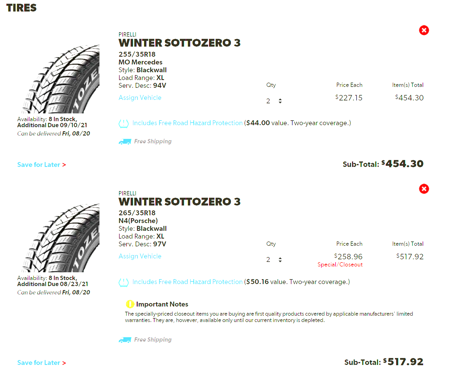

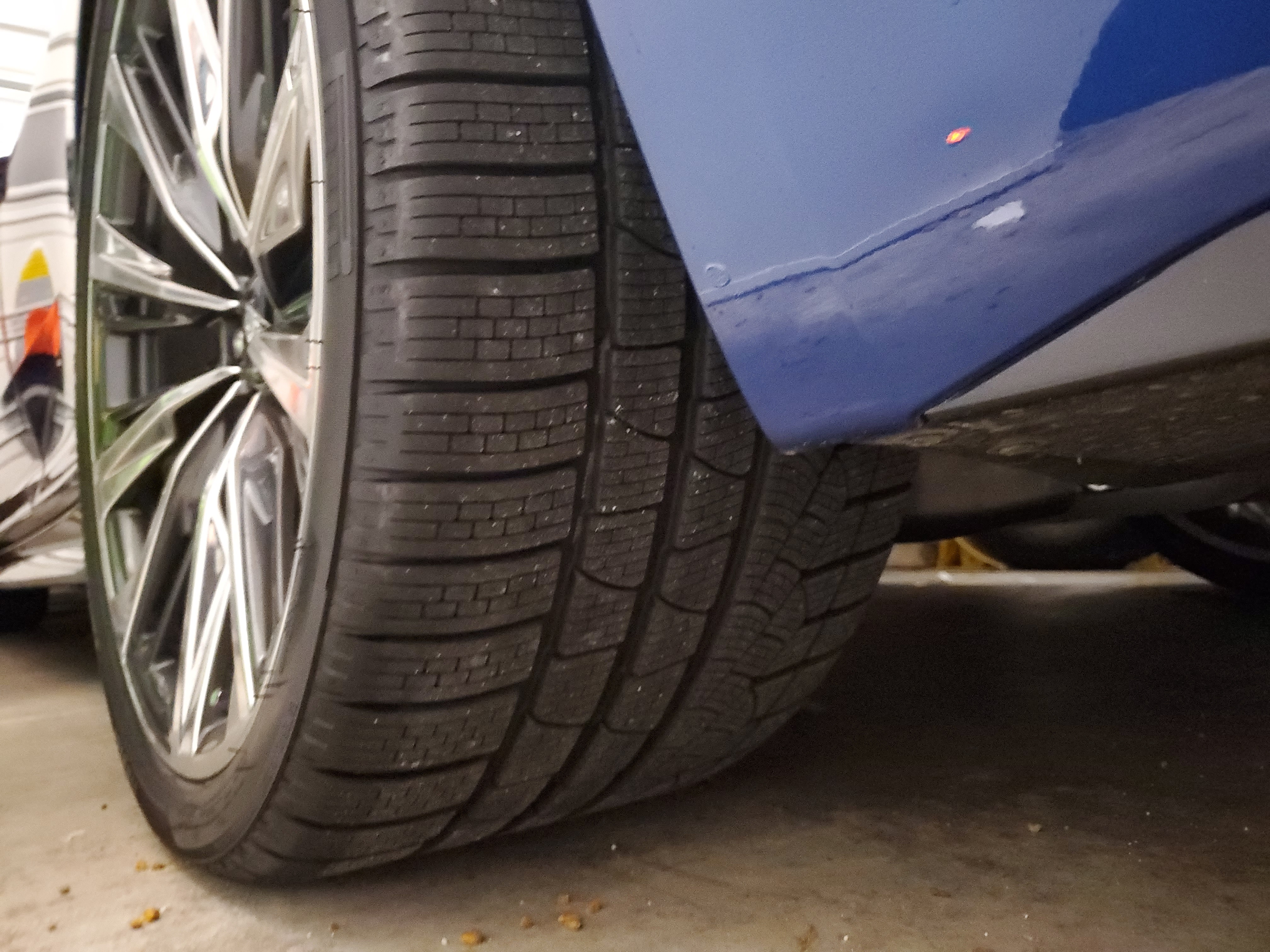

I did get the sottozeros installed on my 5. 265/35 front, 295/30 rear. I talked with a person with tirerack who ultimately indicated its the best of the bad options, and the mixed Porsche/Mercedes specs, while not ideal, should be fine as it's not AWD. There was an additional follow-up confirmation from tirerack before shipping as well. Tirerack did an awesome job overall.

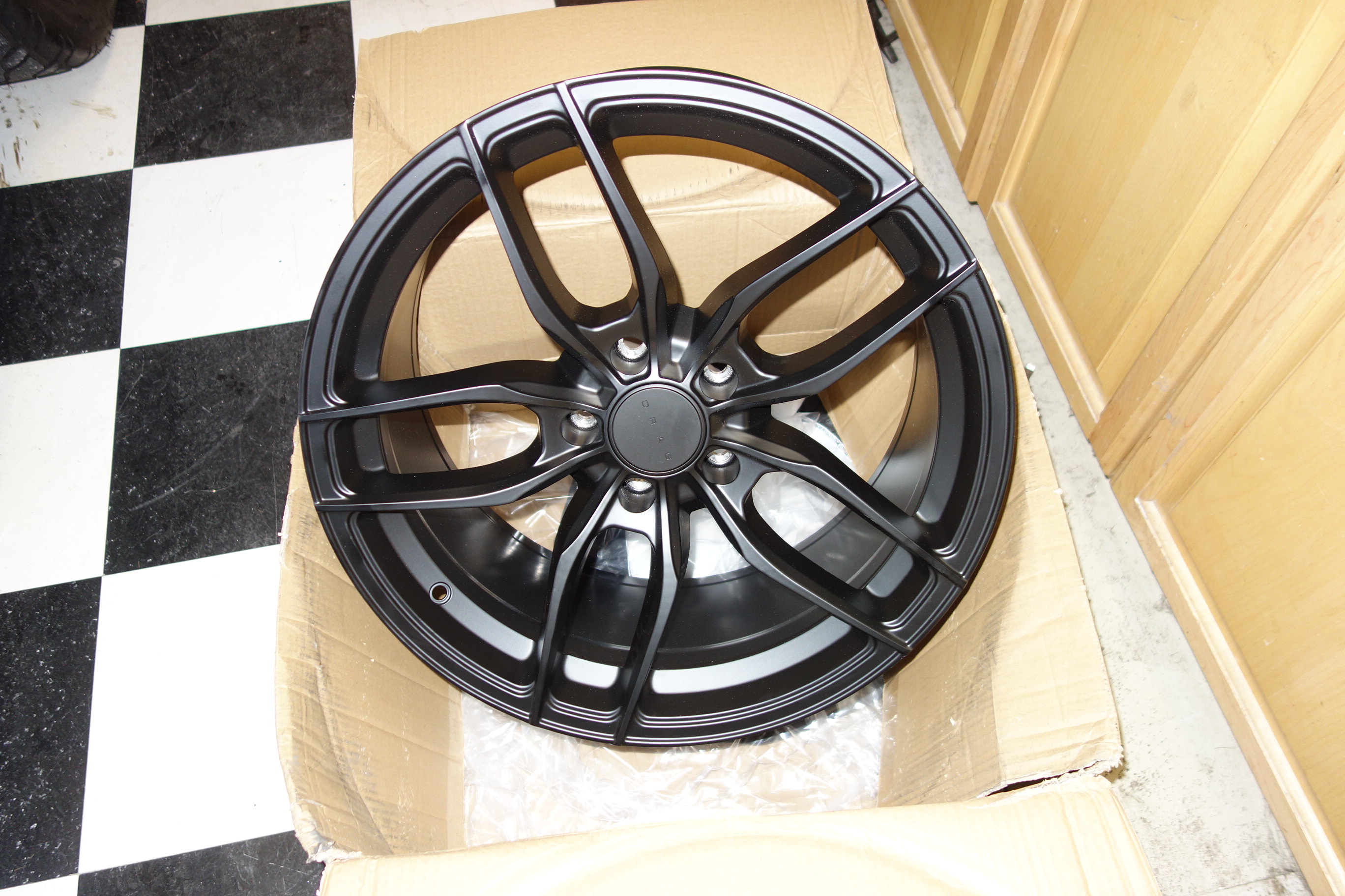

Good news!! I found relatively inexpensive wheels that fit CT5 BW!!! they are 19 x 9.5. the hub diameter is big, so could use a hub spacer ring to make perfect. i plan to use the same wheel on all 4 corners, with 275/35 snow tires. more info to come regarding model number, offset, etc. but very exciting!!! i also think they look nicer than factory wheels, but a lot simpler. yes, they are made in china, but i'm not even sure where to find made in USA wheels at this point...
I’ll post some pics tonight or tomorrow with full details. Unfortunately sometimes I have to work to provide the means for what’s really important (snow wheels and tires). Sorry for the delay!
to sum up, stock CT5 BW wheels are 19x10 (20mm offset) in front, and 19x11 (50m offset) in rear. i think the center hub measures about 66mm. i could be off on any of these -
here is the DR-80 wheel that is 19x9.5 the center hub is much larger than stock. centering ring optional but suggested. the bolt pattern is 5x120. technically GM uses 5x120.65mm. Audi and others use 5x120
