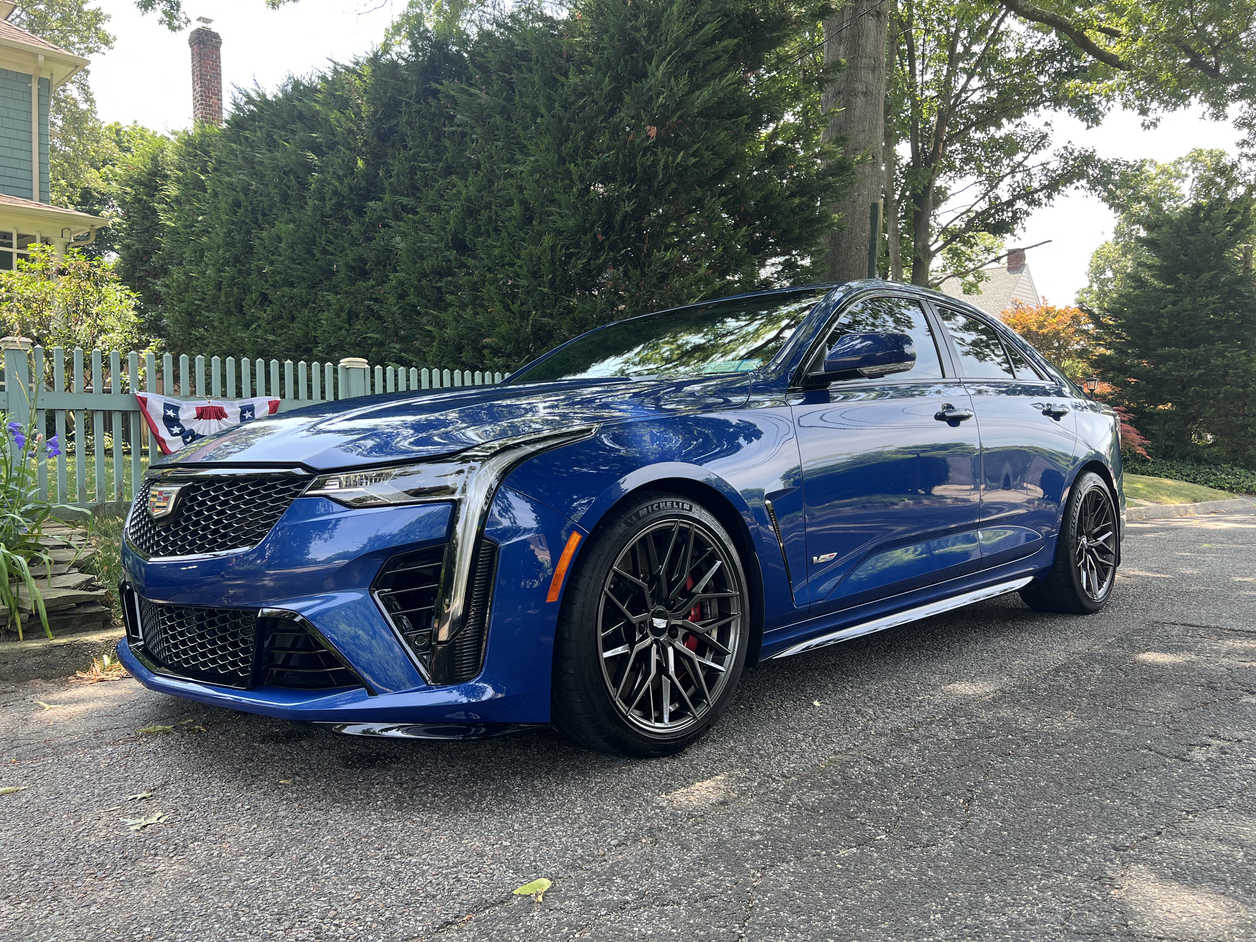

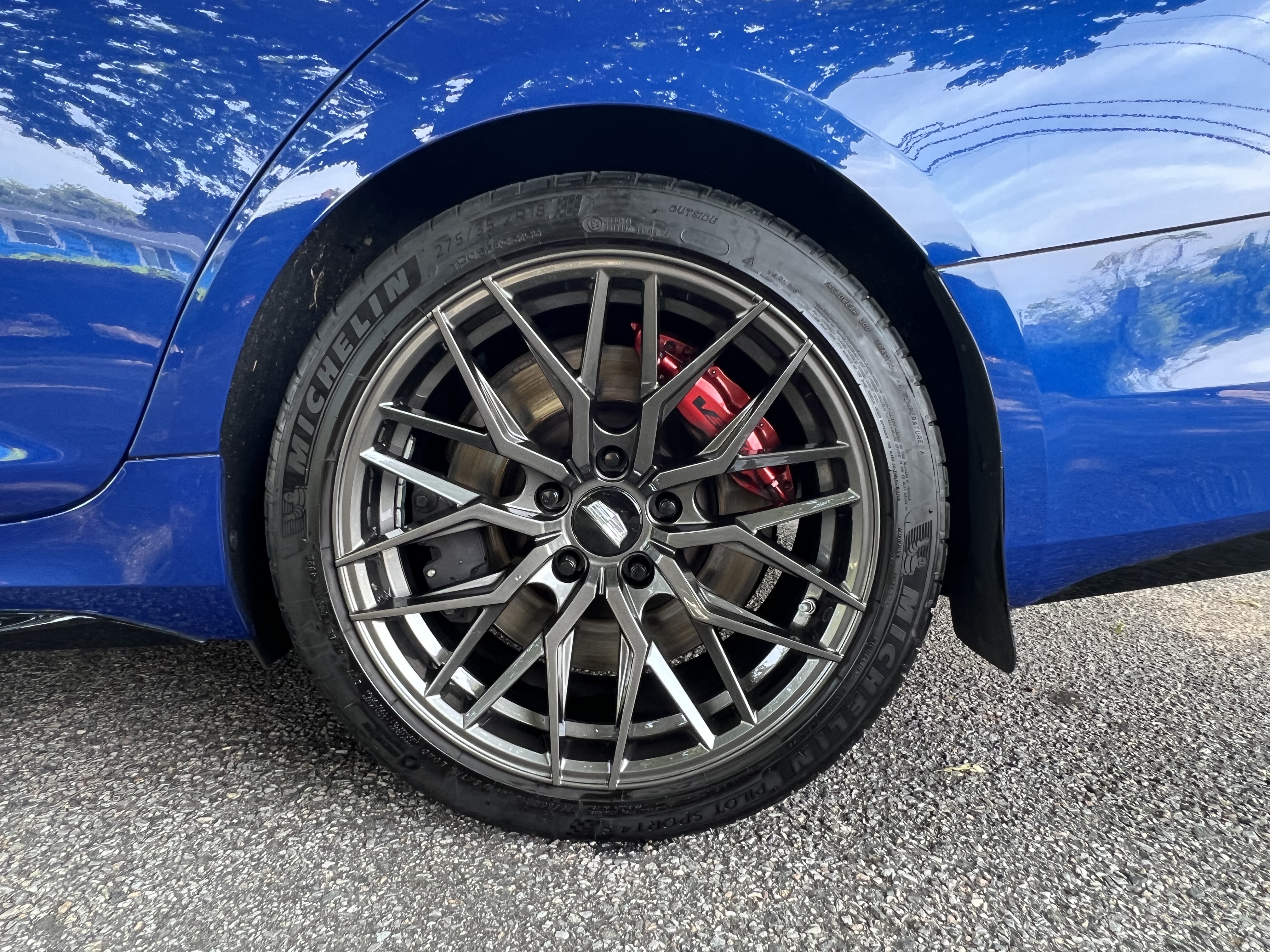

Hello All - I finally got the time to wash my car after having my new VMR V802 anthracite wheels installed.
I’m hopeful this post can answer the questions I had throughout this process for others.

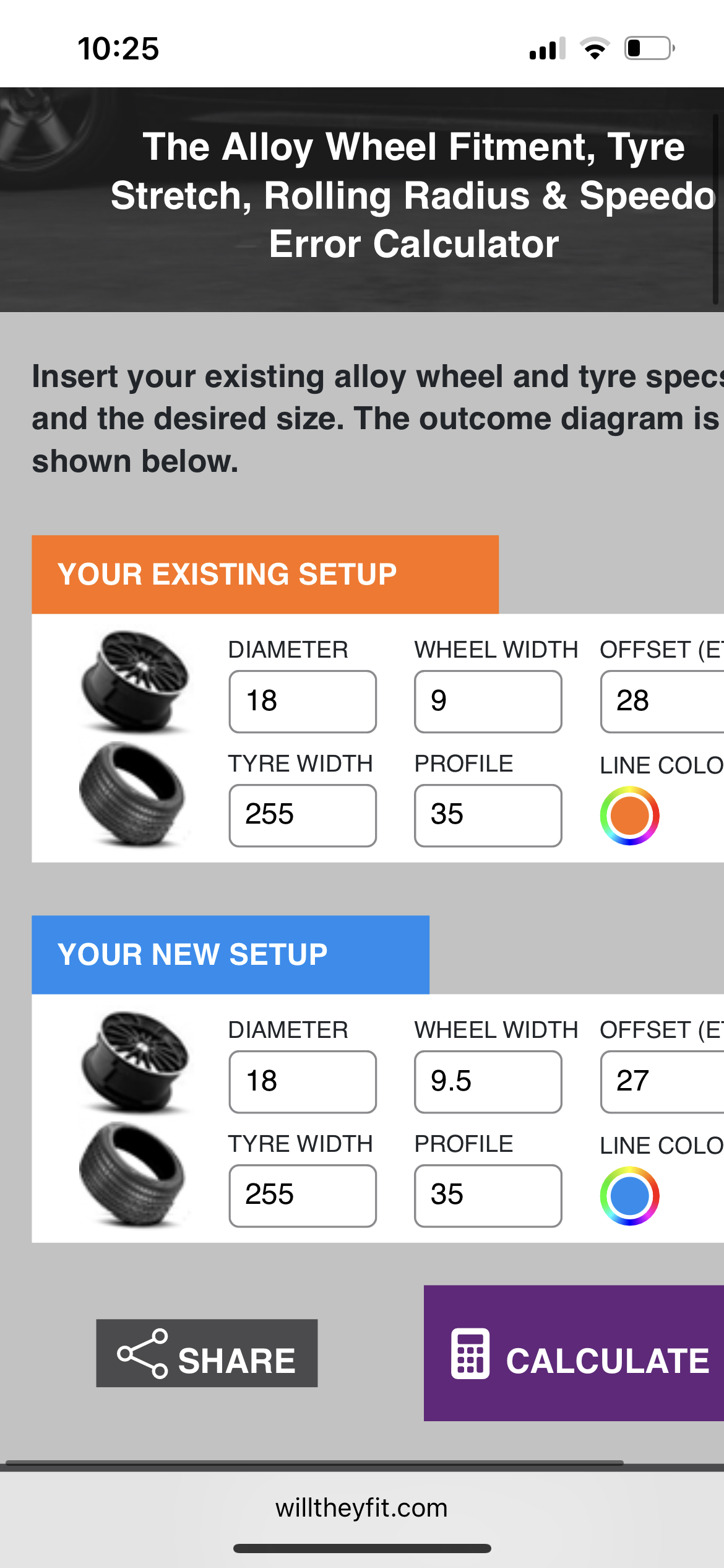

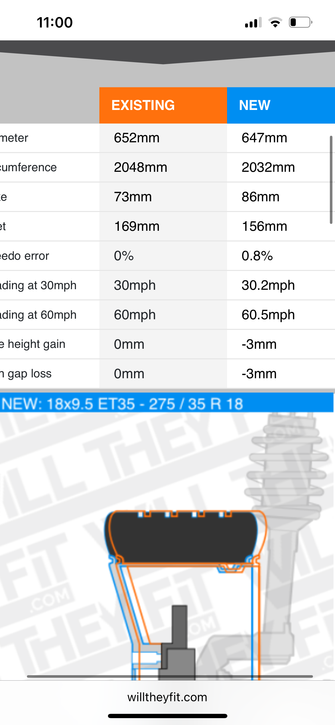

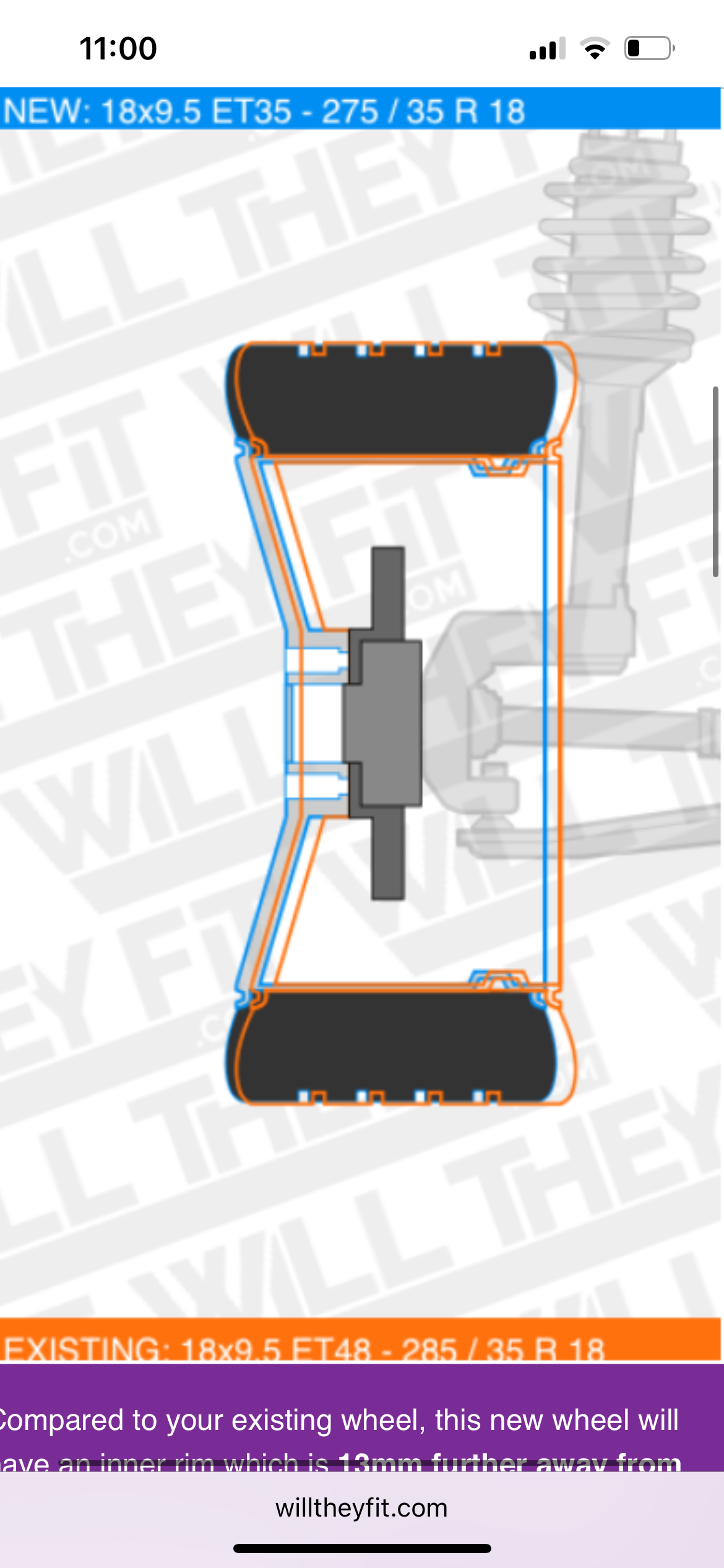

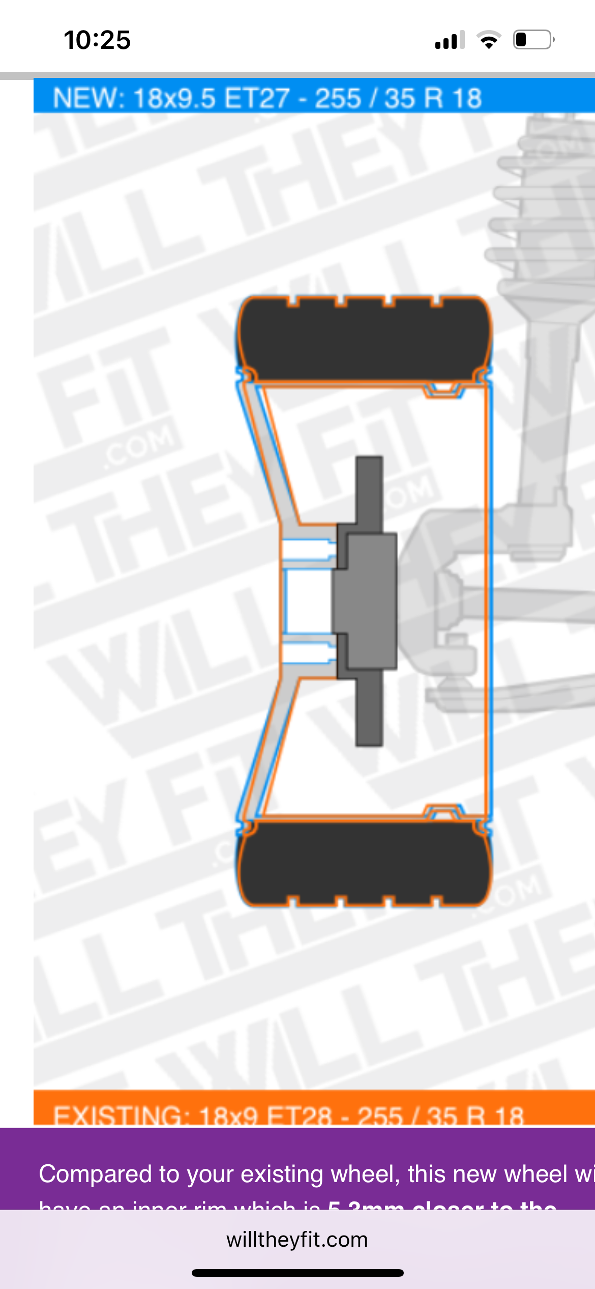

There wasn’t much information available on sizing when I was looking to purchase wheels to use with the 18” OEM tires but Brandon from VMR (Velocity Motoring) was incredibly helpful in the process.
VMR didn’t offer the exact size wheel to match the unique 4BW OEM tire sizes. What I ended up going with was a square wheel setup with the staggered width OEM tires. All four wheels are 18x9.5 et 35. The fronts are 1/2” wider than stock which still let me use the OEM tires with a minor amount of stretch. Once these tires need to be replaced I may try to find wider ones for the fronts.
The offset ends up with a more aggressive stance which I like but caused some issues that needed to be worked through. Again Brendan from VMR was very helpful with this as was my local tire shop. My local shop was also patient which was very helpful!
The rear wheels are offset 11mm less than stock and sit slightly wider which I like. These installed nice and easy with no rubbing or fitment issues.

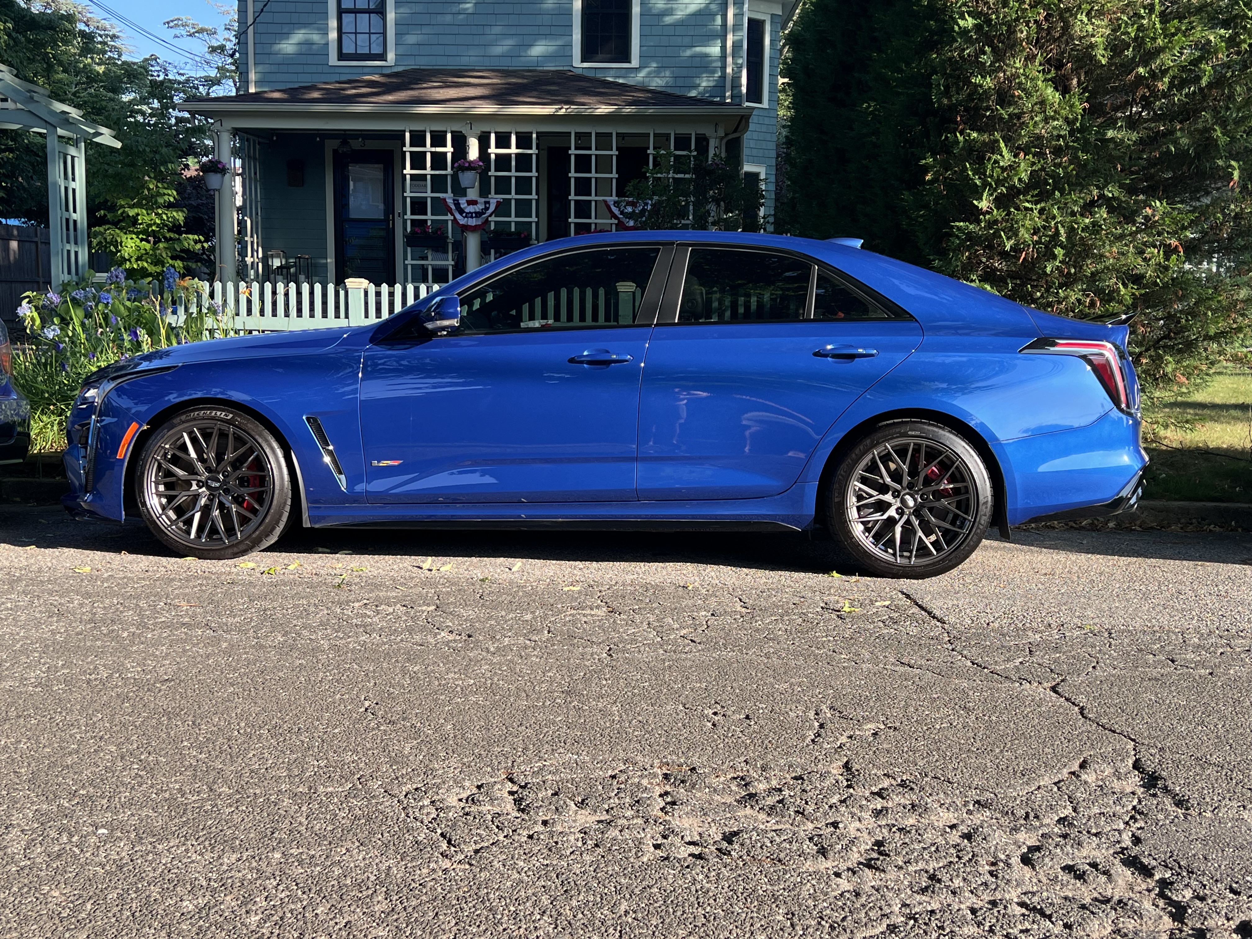

Originally I agreed with Brendan to try a 10mm hubcentric spacer along with some deeper milling for the lugs on the fronts to get the slightly wider stance I was looking for, but with that large of a spacer, the new lug nuts that came with the spacers did not have enough thread exposed to safely install the the fronts.
12mm C8 Corvette Camaro Hub Centric Wheel Spacers 1/2 Inch 5x120 66.9
Going with some trial and error I ordered 8MM spacers.
Amazon.com
With the 8MM I was able to get the wheels put on at the shop and had just enough thread for the lug nuts to secure the wheels.
After accounting for the change in wheel diameter and difference in offset. Those sit nicely as well a little wider than OEM. They just clear on the inside and have no issues fully turning the wheels even with everyday driving.
I know the changes I made probably aren’t improving the driving experience, but for me how it looks is more important on a daily basis. I trust the Cadillac Engineers knew what they were doing, so If I were to ever track the car I would get a third setup that better matches OEM spec specifically for that purpose.
Although I’ve been driving in the limited thread engagement with no issue for the last few weeks, I’m still not comfortable with how little thread is engaged so I ordered a new set of bolts that I still need to have swapped out, but I don’t know if that will give me future trouble when I go to put the winter setup with the OEM wheels back on. I think the extended thread lugs that came with the 10MM spacers should make the longer bolts work with the OEM wheels.

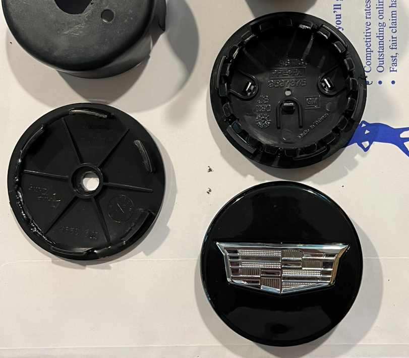

In addition to the wheels and tires info, I couldn’t live without finding a way to get OEM Cadillac crest/shield (which is it?) center caps to work despite having a different center hub size. I saw in another thread someone tried to make an adapter by cutting out Cadillac sized (66.72mm) holes in BMW sized (68mm OD/66.5 ID/clips) center caps. After scouring the internet for aftermarket caps in the size I needed that matched the OEM look with no success, I opted to go the custom adapter route as well.
							 ebay.us
					ebay.us

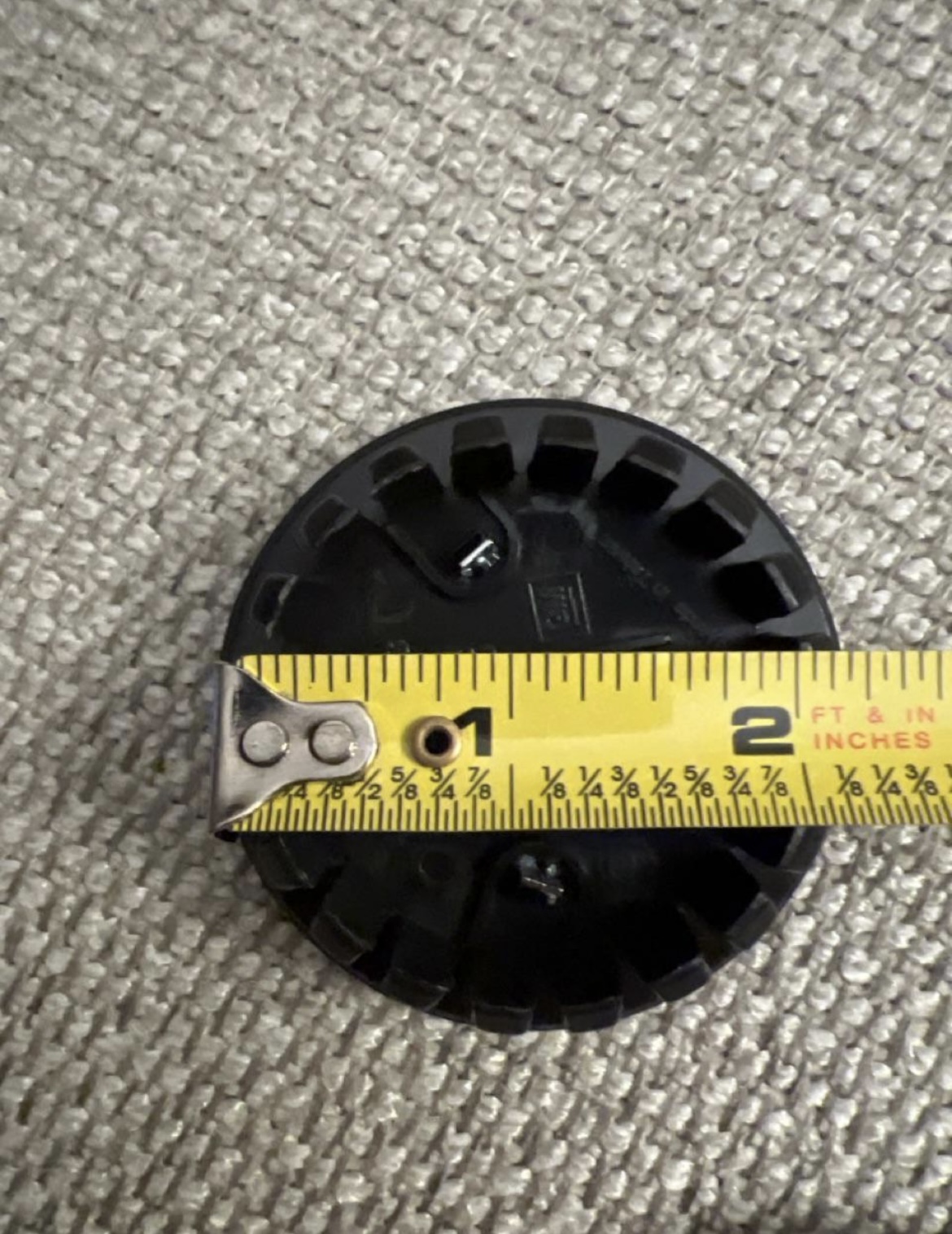

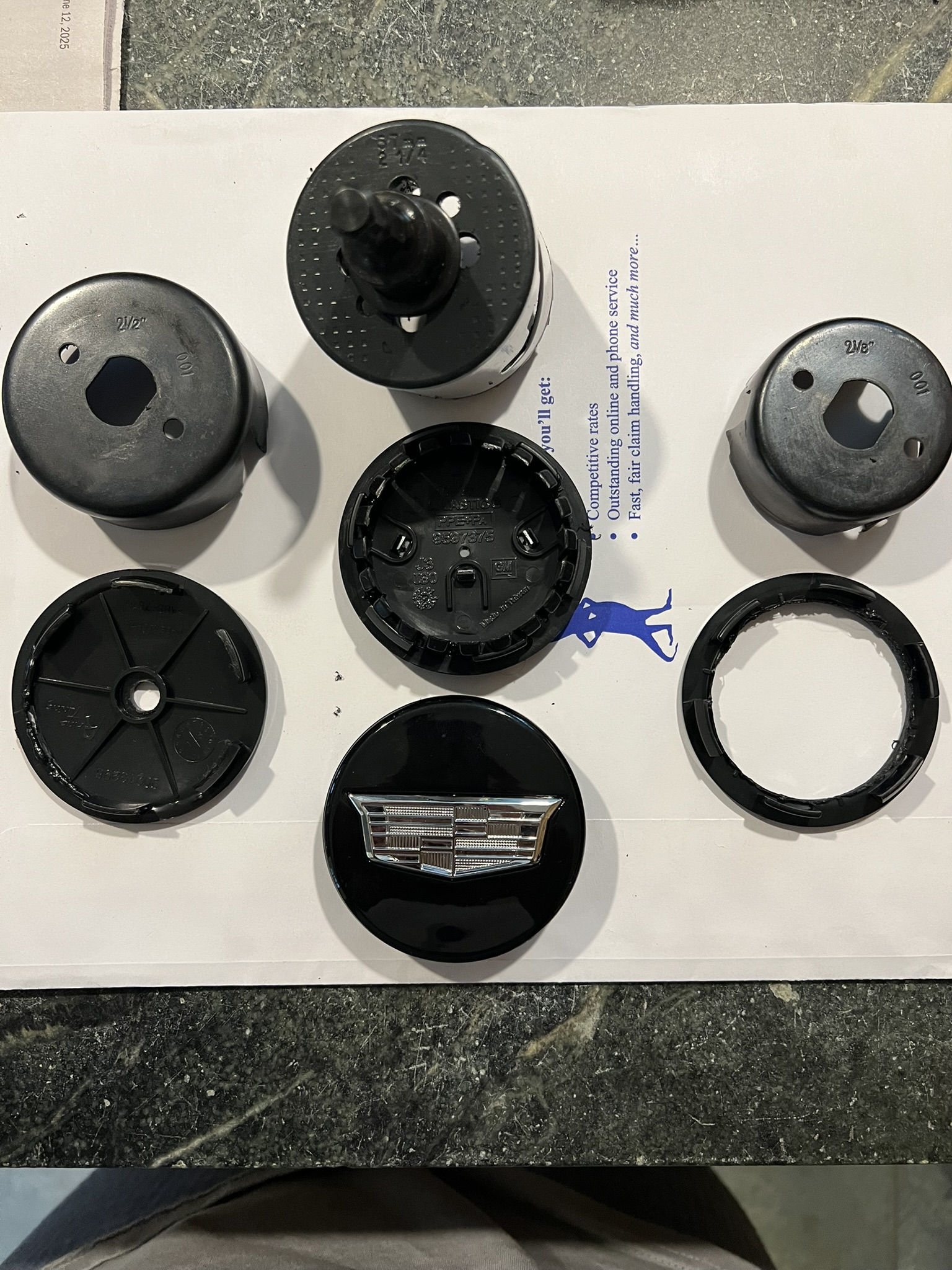

I used a 2-1/4” hole saw to cut out the center of the friendly priced bmw center caps to receive the Cadillac center caps. Because the clips are meant for a deeper engagement, like the other thread I saw I needed to glue the Cadillac caps into the homemade adapters. The user who wrote the other thread used Hot glue but I opted to go with gel style crazy glue which worked well and a few weeks later now are still on the car with no issue.
