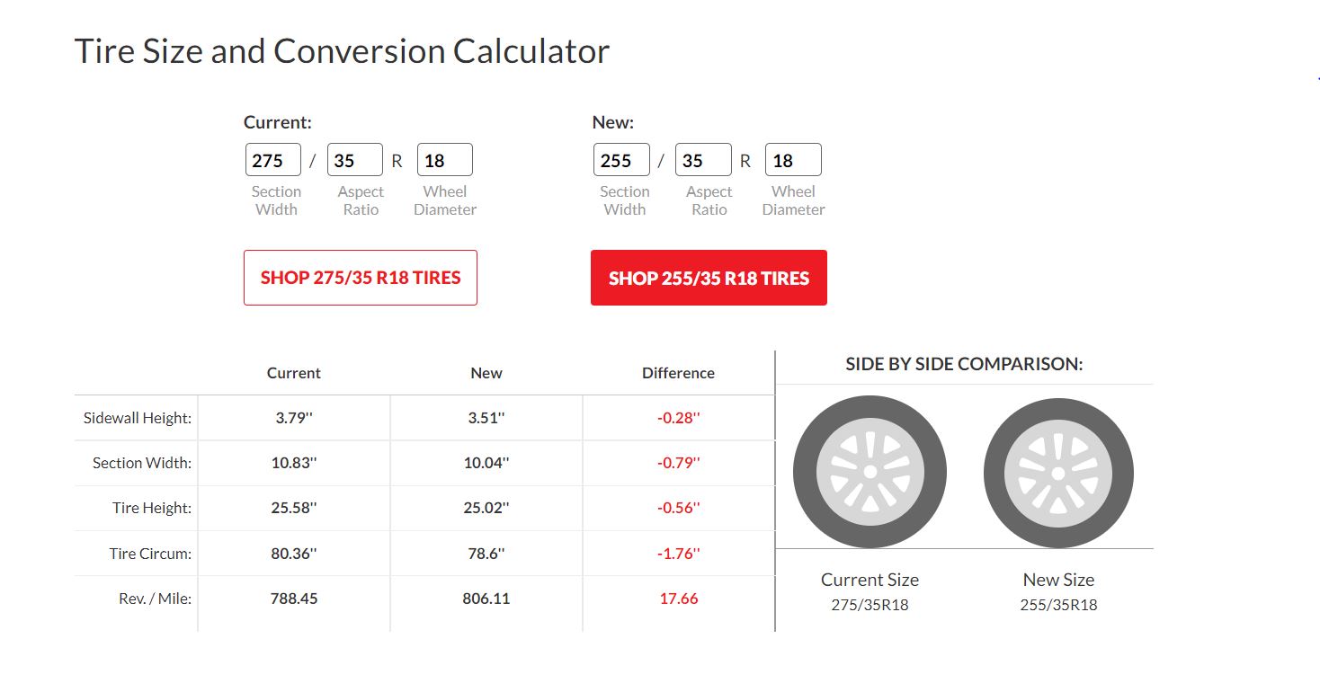

Was thinking of going to a square setup for the Winter in Germany since my driving will def be less spirited (So much Snow). Do yall think a 255/35R18 will fit fine on the rear? I did it with my BMW M235 but to be honest I am not super versed in tires. I went on discount tires and got this info but was hoping yall could help me parse it out. I am pretty sure the rear wheels are .5" wider than the fronts.
Sure, you can do it and a 255/35/18 can fit on a 9.5" wheel. Nokian makes the R3 in 255/35 and 265/35. So you can get a top tier real winter tire in a square setup or slightly down sized rear.
True I could always do slightly downsized also. Good call
Was thinking of going to a square setup for the Winter in Germany since my driving will def be less spirited (So much Snow). Do yall think a 255/35R18 will fit fine on the rear? I did it with my BMW M235 but to be honest I am not super versed in tires. I went on discount tires and got this info but was hoping yall could help me parse it out. I am pretty sure the rear wheels are .5" wider than the fronts.View attachment 5360
Speedometer will be a little off but it should be ok. At 65 you'll actually be going 63.6 MPH.
