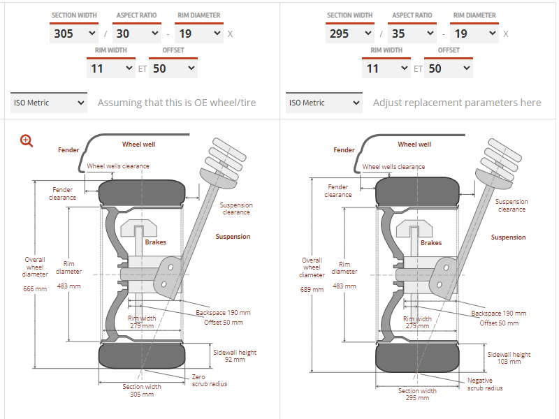

Honestly I missed that suggestion back in the beginning but looking at the specs on tire rack those rears are a good inch taller than the stock sizes. Are the taller rears and shorter than stock fronts going to cause any issues with the electronics?

so 295/35-19 won't screw up the computer compared to a 305/30-19?
Front to rear od is important hence go 265/35 front and 295/35 rear. Similar reduction front as rear. Winter tire thread tends to be larger so if you go same size as stock 4s you will wear/touch on some spots of wheel liner possibly so again I would recommend one size down in width unless all the OD information is available to you.
Can you elaborate sorry dont have tire rack handy but a 295/35 is an inch taller than a 305/35?
I don't understand the vehicle systems enough to know how this would affect things, but here are the stats.
My apologies I typed 305/35. Yes that makes sense so look at the 295/30-19 sotto zero tires they are $370 on tire rack. 26.1" OD vs 26.3"stock.
