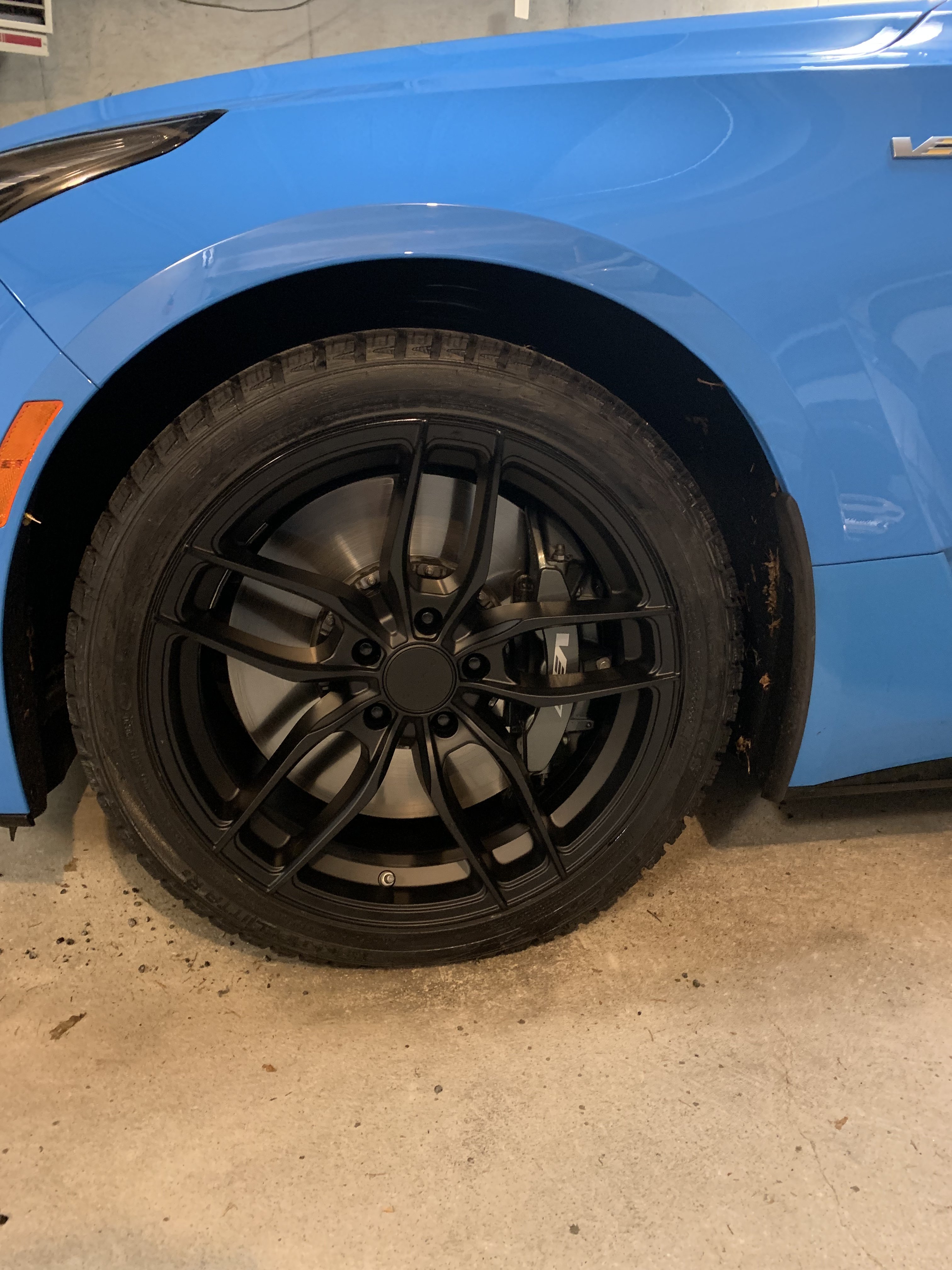

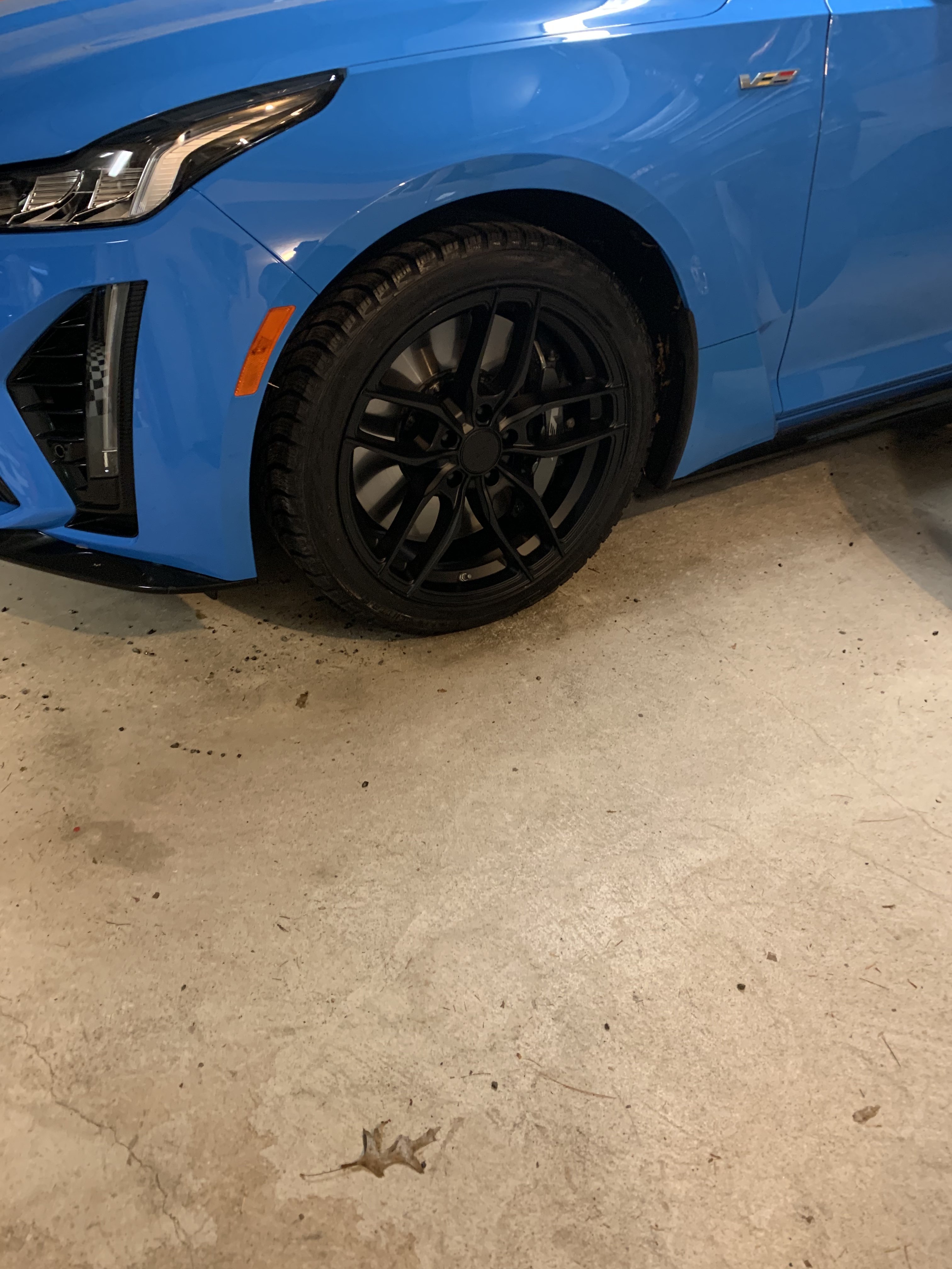

here is what i have - (i will let you know once mounted and driving to make sure there are no surprises but i mounted up one on front and rear in my garage already)
wheels drag wheels DR-80 19x9.5, 5x120 pattern
tires nokian hakkapellitta 275/35-19 - i only could find them from one vendor on amazon although they are probably available lots of places earlier in season. i found simpletire.com nice to work with the year before
sensors - GM 13538760
sensor nuts - GM 13581557
need smaller lug nuts than stock. i used cal custom 754003B
tires made in russia, sensors made in UK, wheels made in china, lug nuts probably china too
couldnt find anything made in USA for wheels, tires, or lug nuts

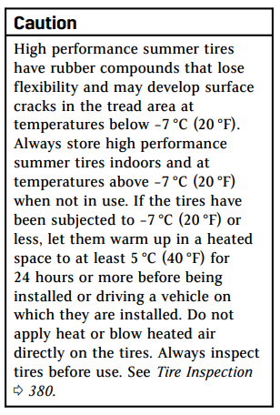

Below warning is from page 370 of the 5BW owners manual which mainly warns of use and storage below 20 deg F. We have driven it while temps are in the 30s, all local driving and mindful not to put too much stress on the tires. There's definitely reduced traction at those temps. But I've inspected the tires a couple of times now, and see no signs of sidewall cracking. Also, my garage is well insulated and even when outside temp drops below zero, I've never had my garage drop below 39 deg F. And worst case, I have built in heaters that I can flip on and keep the temp as low as 40 or as high as 85.

they're ok - not my favorite but i do like them better than stock ones - should be easier to clean!
