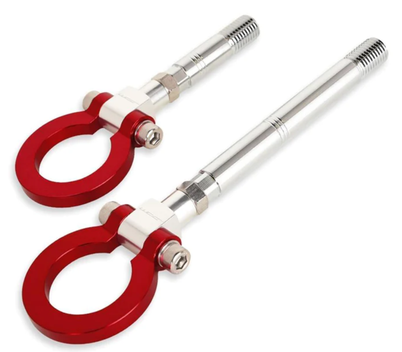

I am looking for information of CT4-V BW tow hook specs? Will C8 Tow Hooks work? I do not want to use the ugly factory one when running track sessions.
Well yes and no. I do not want a big metal rod sticking out of the front and rear bumpers. I think that the best option is the fabric hook or one where the loop folds. I also want to have a front and rear installed.

If you want a nice one, just contact a company with the length, shaft size, tpi, and thread pitch and one can be made. V2, 2016 v3, and 2017-19 v3 all appear to be different so I'd guess the c8 may not fit.

The 5BW tow hook has left hand threads for some reason, so there's that. Also, I couldn't even get the rear tow hook receptacle cover out of my bumper with a rubber trim removal tool. I just had to make sure I didn't get stuck nose in in a sand pit on track.
