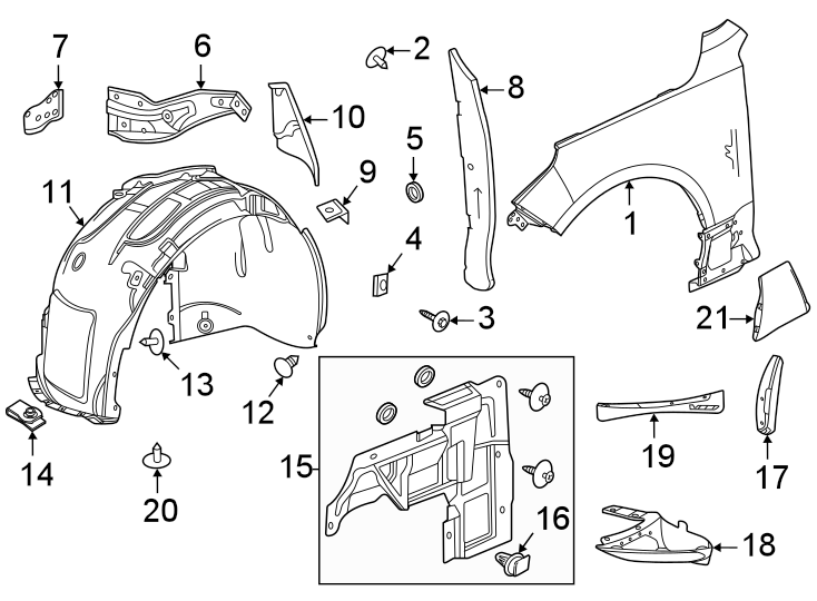

Part #18 is pre-installed in the front for std splitter, part #19 is pre-installed with the CF lip.
When I got the CF lip later I had to purchase part #19 and swap out part #18

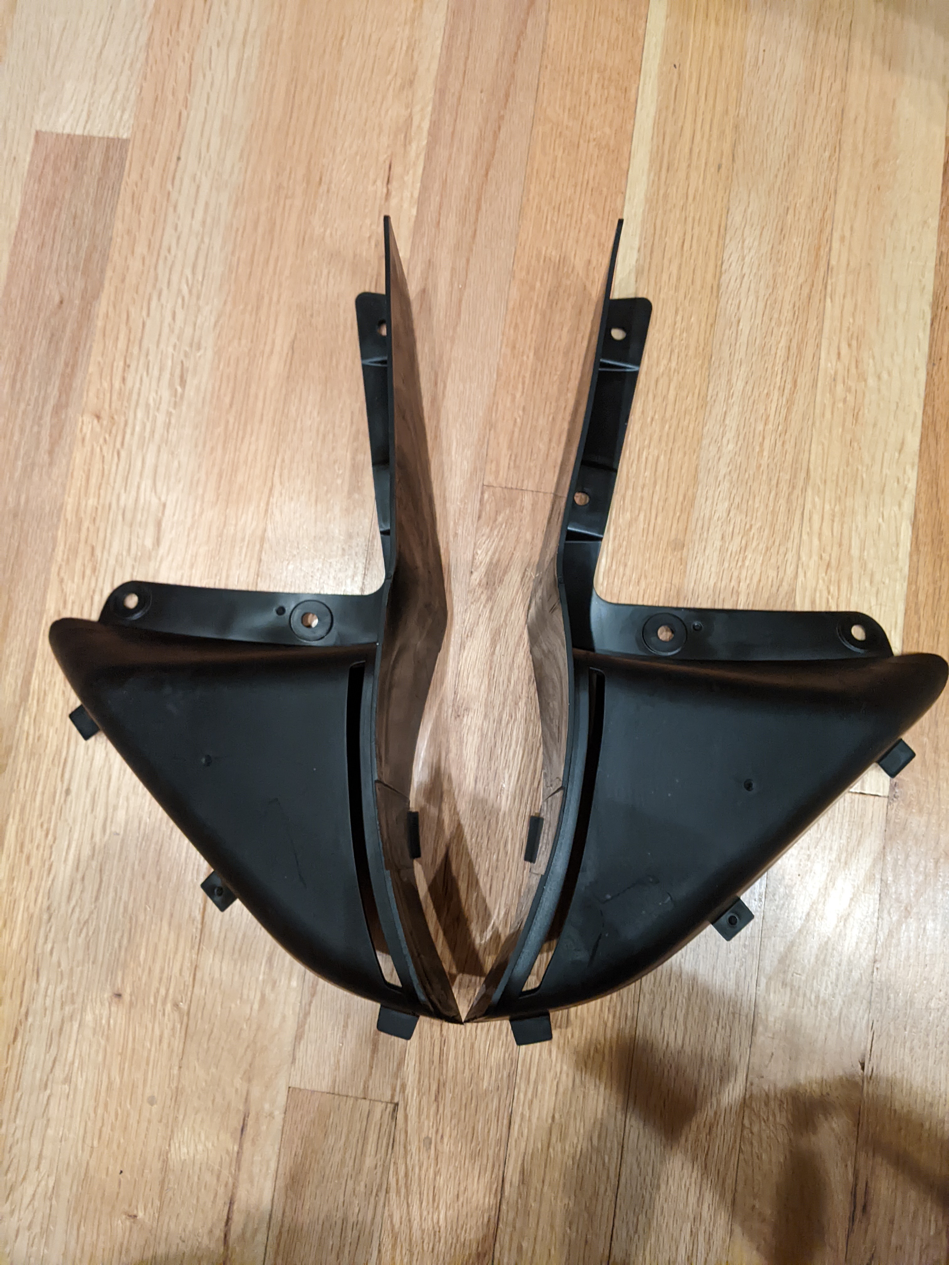

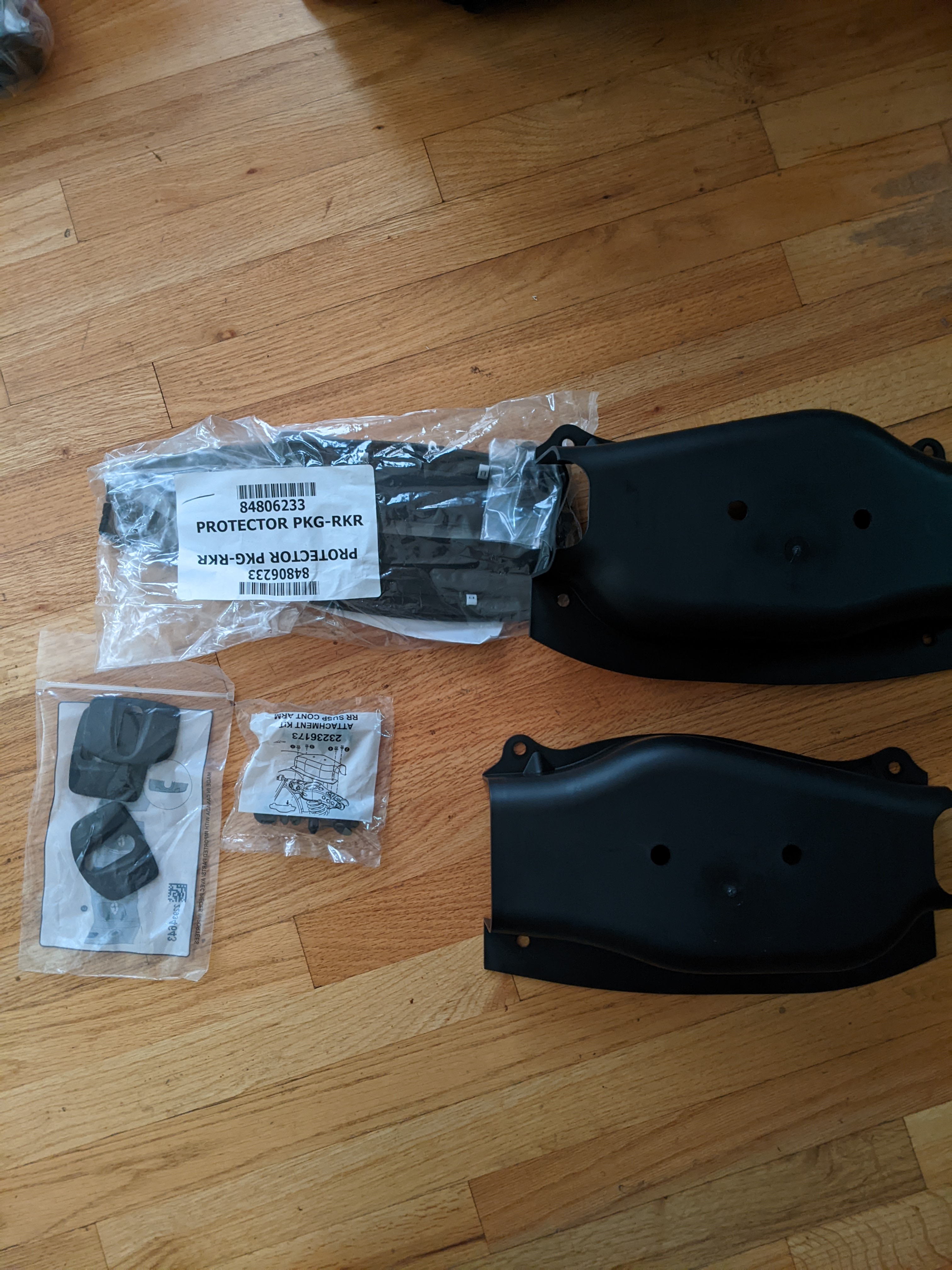

These are the parts I had in my trunk since the dealer did not install anything.
That’s interesting. I installed an OEM CF splitter and although I bought #19 I ended up just putting #18 back on. I’ve heard various people say different things about #19.
@rubberduck Now I am curious....is #18 required with CCBs? They were never installed on my car....they were in the trunk. When I got the CF front splitter I installed #19. If anyone has CCBs AND CF splitter could you check if #18 and #19 are installed? Didn't think that was possible
Actually rewatched the Savage Geese Science Fiction video where they explain a lot of the tech stuff with shots underneath the car....it clarified everything....so it's part #19 with the CF lip and the CCBs have an extra dust protector below the control arms.

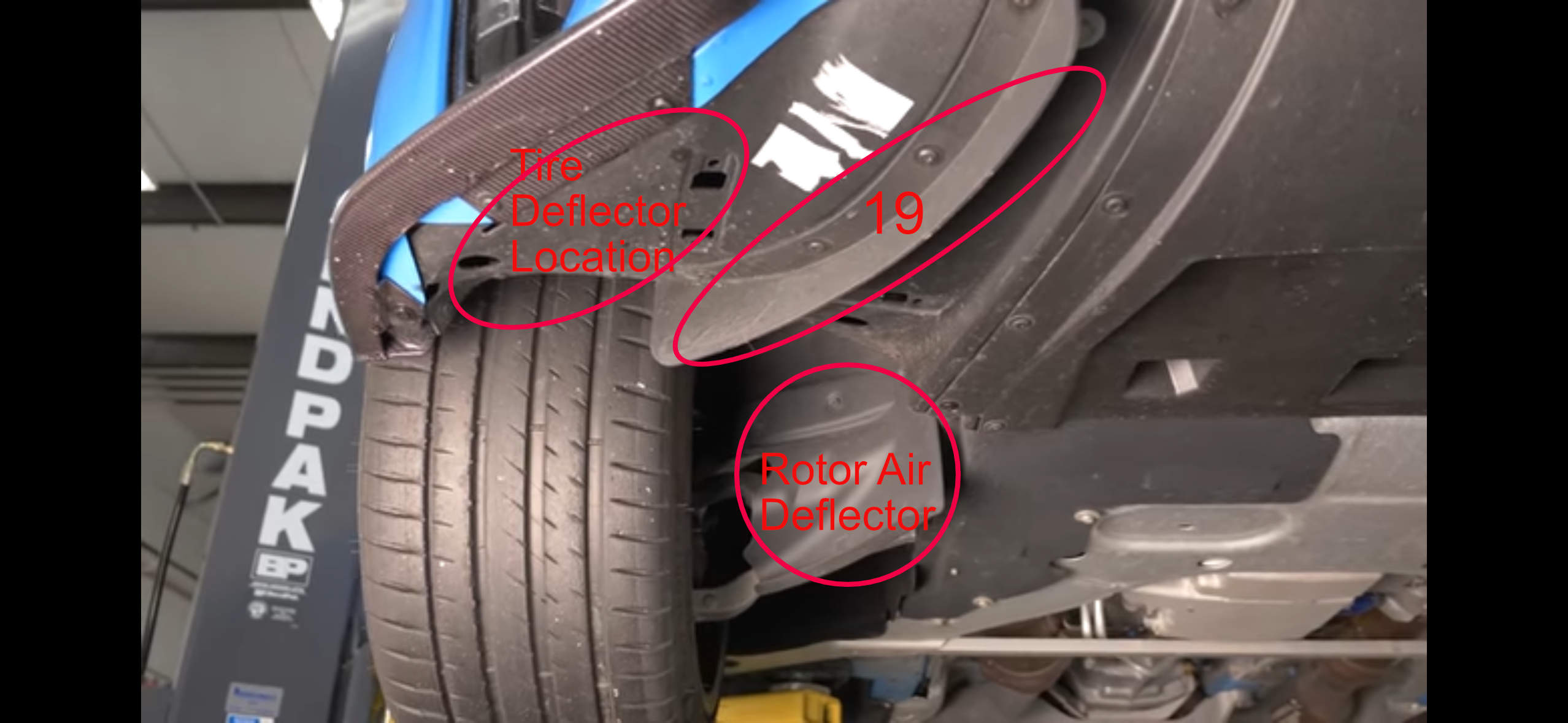

Thanks. This is extracted from 9:53 mark and it does not show the tire deflector, but since these are not installed at the factory it's still possible they could be intended. I think I like the tire deflector for street use as it may limit larger objects (like cardboard) from entering the wheel well. The rotor air deflector I definitely would not use for street.

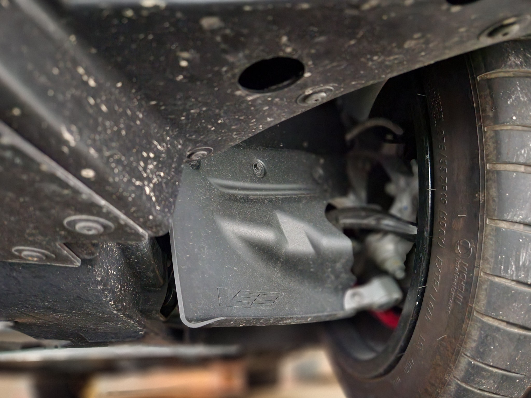

FYI the rotor air deflector came pre installed and Savage Geese highlighted that as additional protection for the rotors. Are you saying you removed those and also replaced 19 with 18, or have both 18 and 19 installed? It will be good to see what others who have CCBs and CF splitter have underneath. @jwolf99 would you be able to to share a picture of your setup? Thanks
My rotor air deflectors were in the trunk with all the other parts and no instructions. I installed 18 which is the tire deflector. You can’t install 18 and 19 at the same time because there is physical interference. It would be interesting to see what a CF1/CCB car has installed and what was in the trunk.
Given that GM and dealer PDI is all over the place with this stuff I’m not sure about anything. I had them installed at one point, but after looking at them, it seems like they would just direct debris right into the rotors. After all, they’re supposed to direct airflow into the rotors.
You have a point ....I pmed you with some feedback I got. In the Savage Geese vid they highlighted these as additional protection. I have those installed (not by me) btw and the dealer did not pdi my car.
