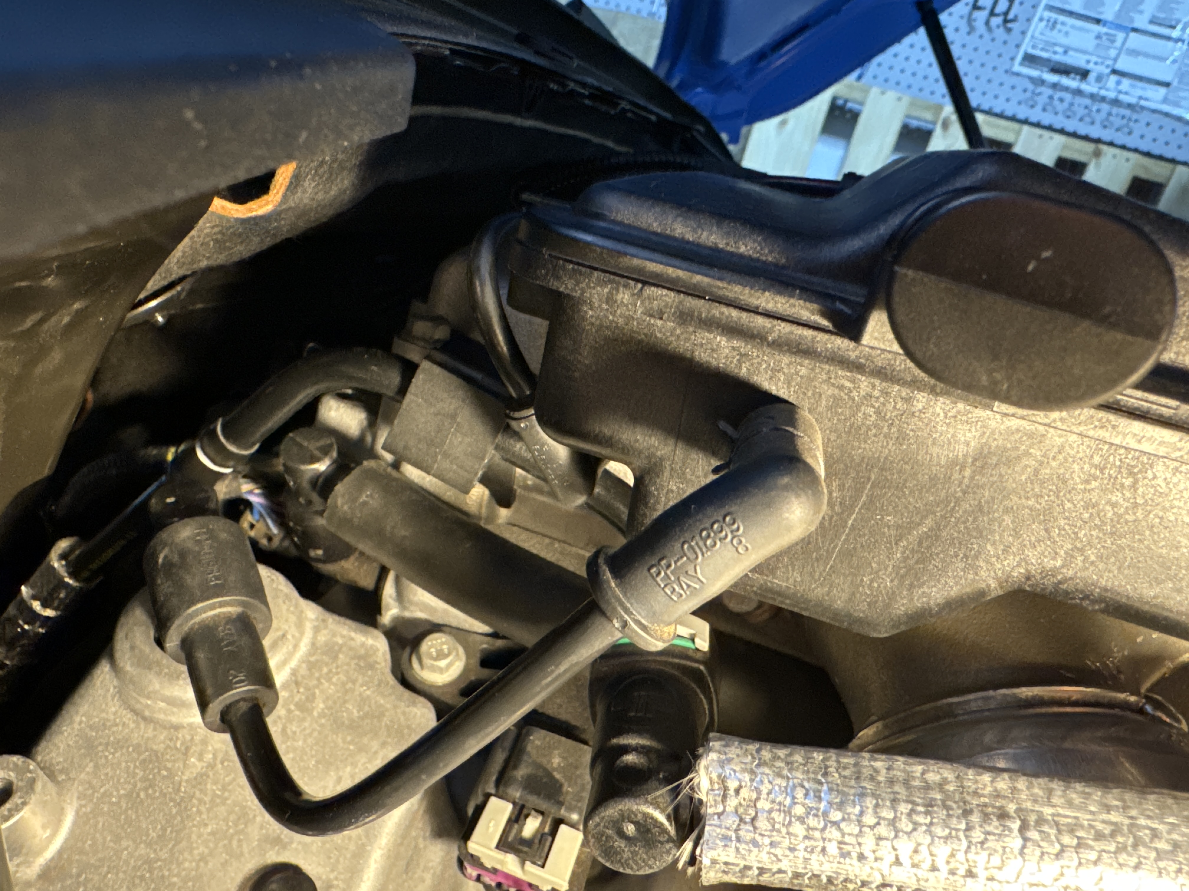

My guess is that you left a fairly well hidden vacuum line off. Check out the article at the bottom of this page for a one minute solution.
Close! It was the line on the passenger corner of the vacuum assembly that wasn’t seated right. It was making me crazy! You got me on the right track. Thank you!
The one hidden behind the one mentioned. Hallelujah!
That's the one that gets us all. Nice work!

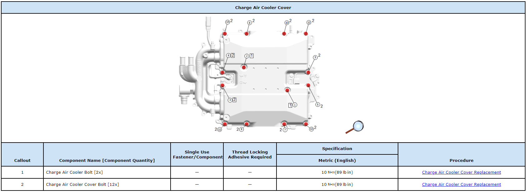

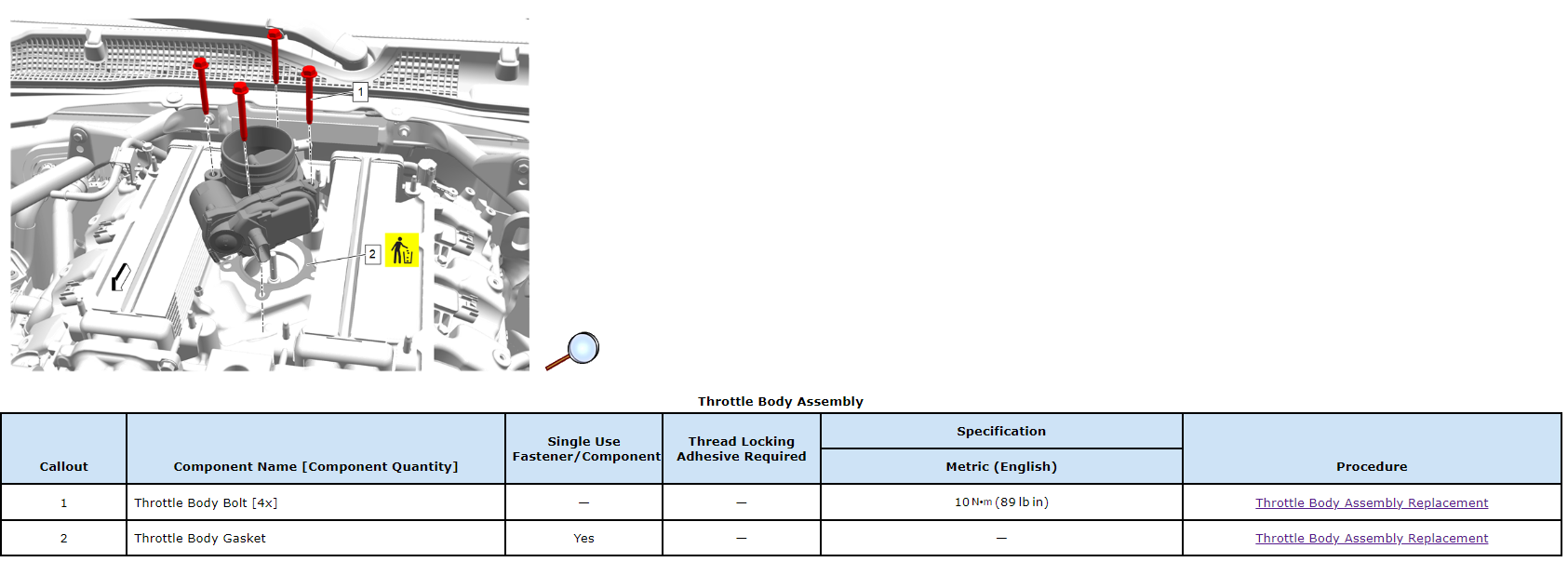

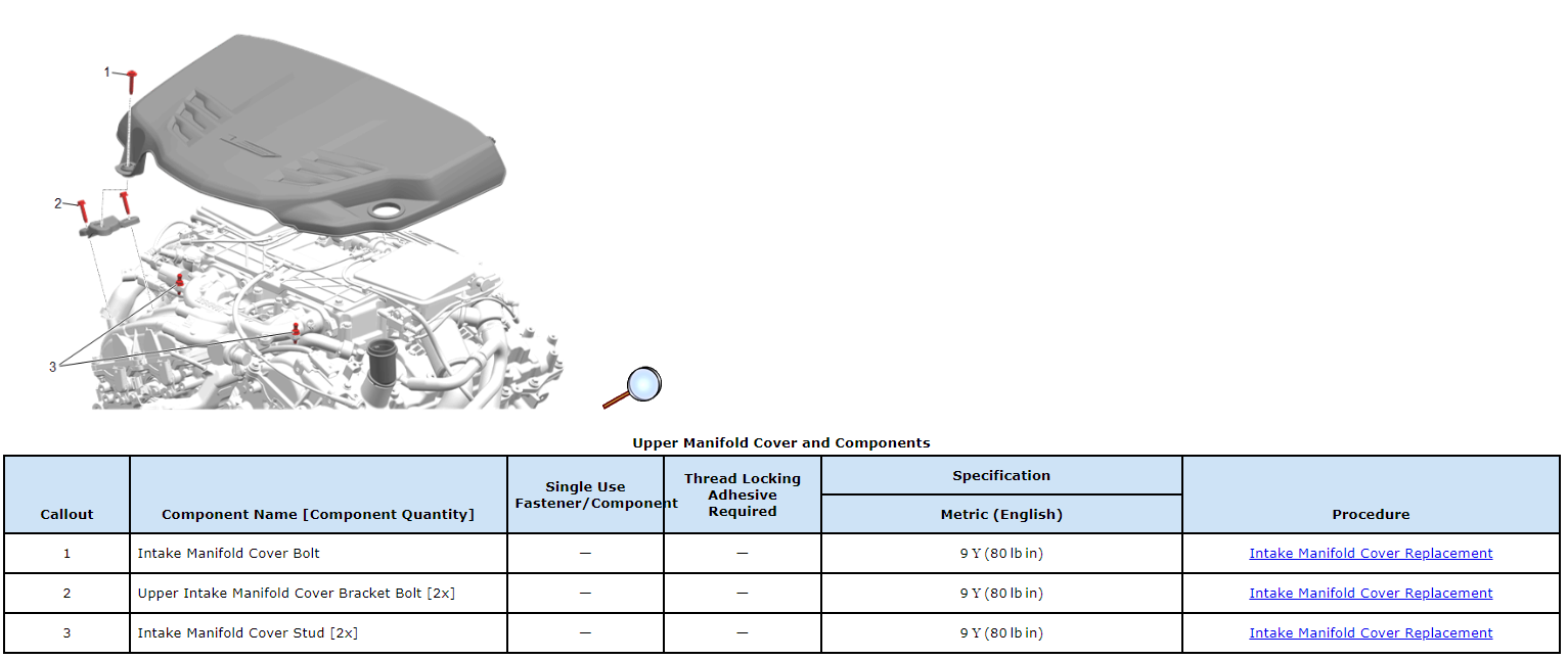

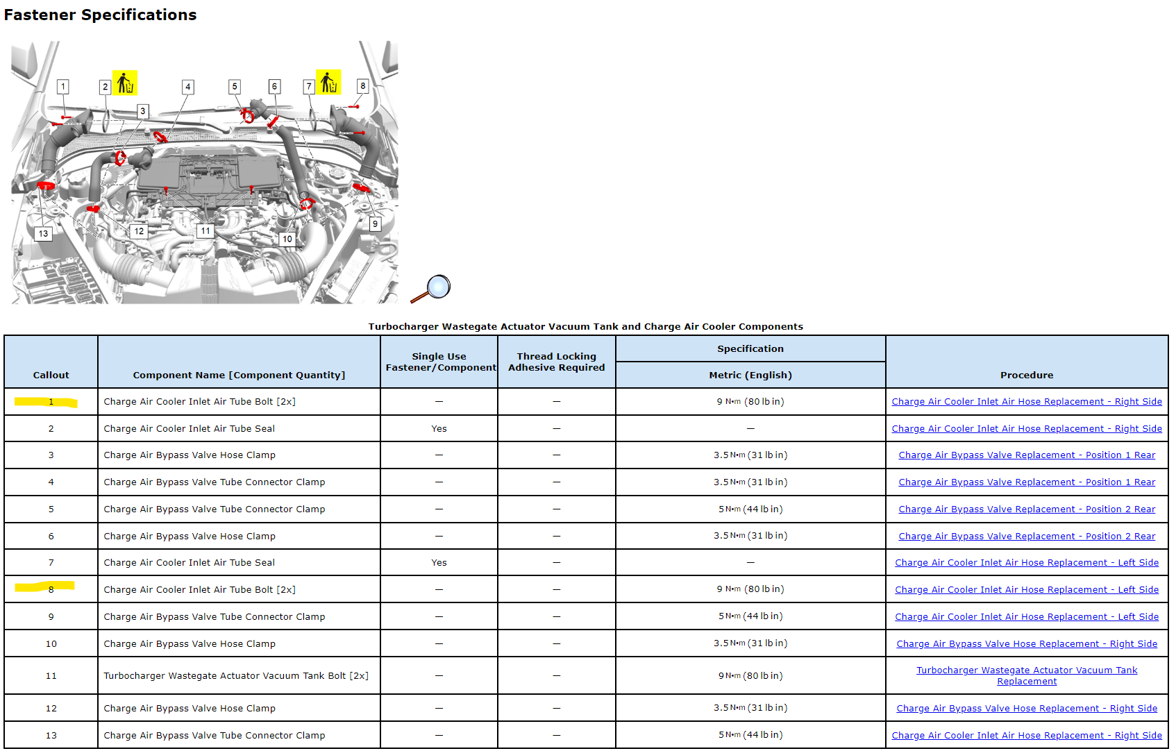

I'm hoping for a not-so-cold day in the garage to install mine. Here are the service manual fastener specs for the Air Cooler Cover (and sequence), Throttle Body and Charge Air Cooler Inlet bolts.
