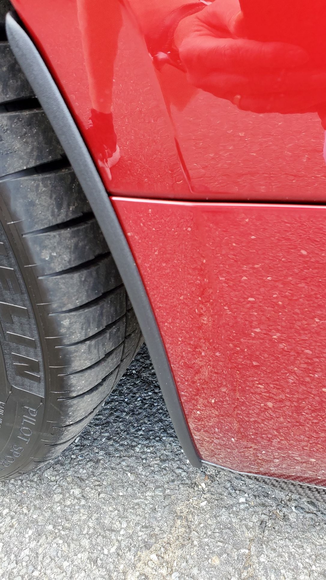

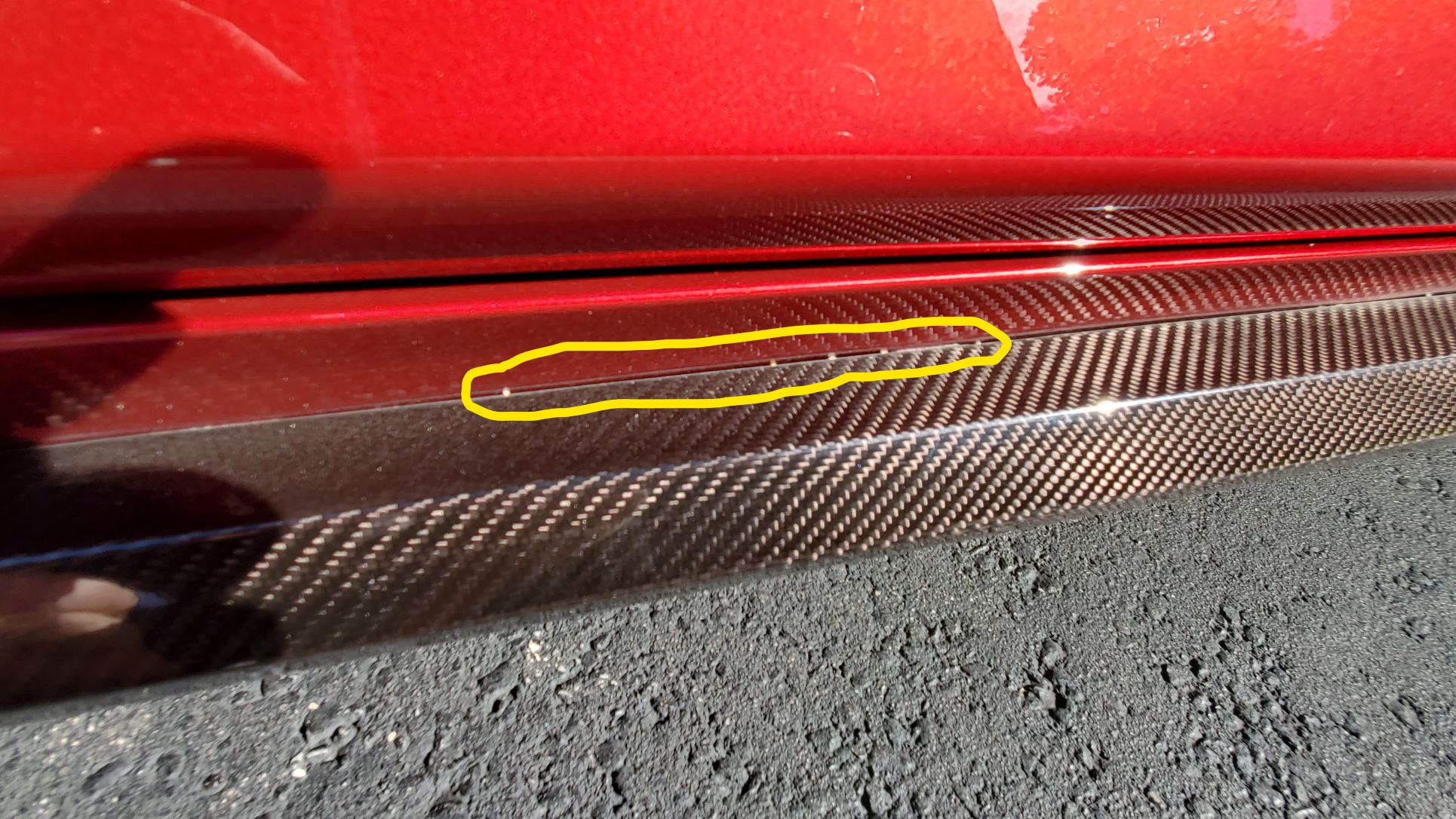

Are the rock guards noticeably different between the 4BW and 5BW. Photos are of my infrared 5BW and an electric blue 4BW that was at the dealer when I picked up my car. The 4BW seems like it would block more. The reason I ask is that after my 35 mile drive, a fair amount of sand and small pebbles kicked up and got caught between the door sill and CF edge. Should the 5BW have a wider rock guard to prevent this?

I've not noticed that yet but I'm going to drive mine a lot tomorrow so I will check for sure.

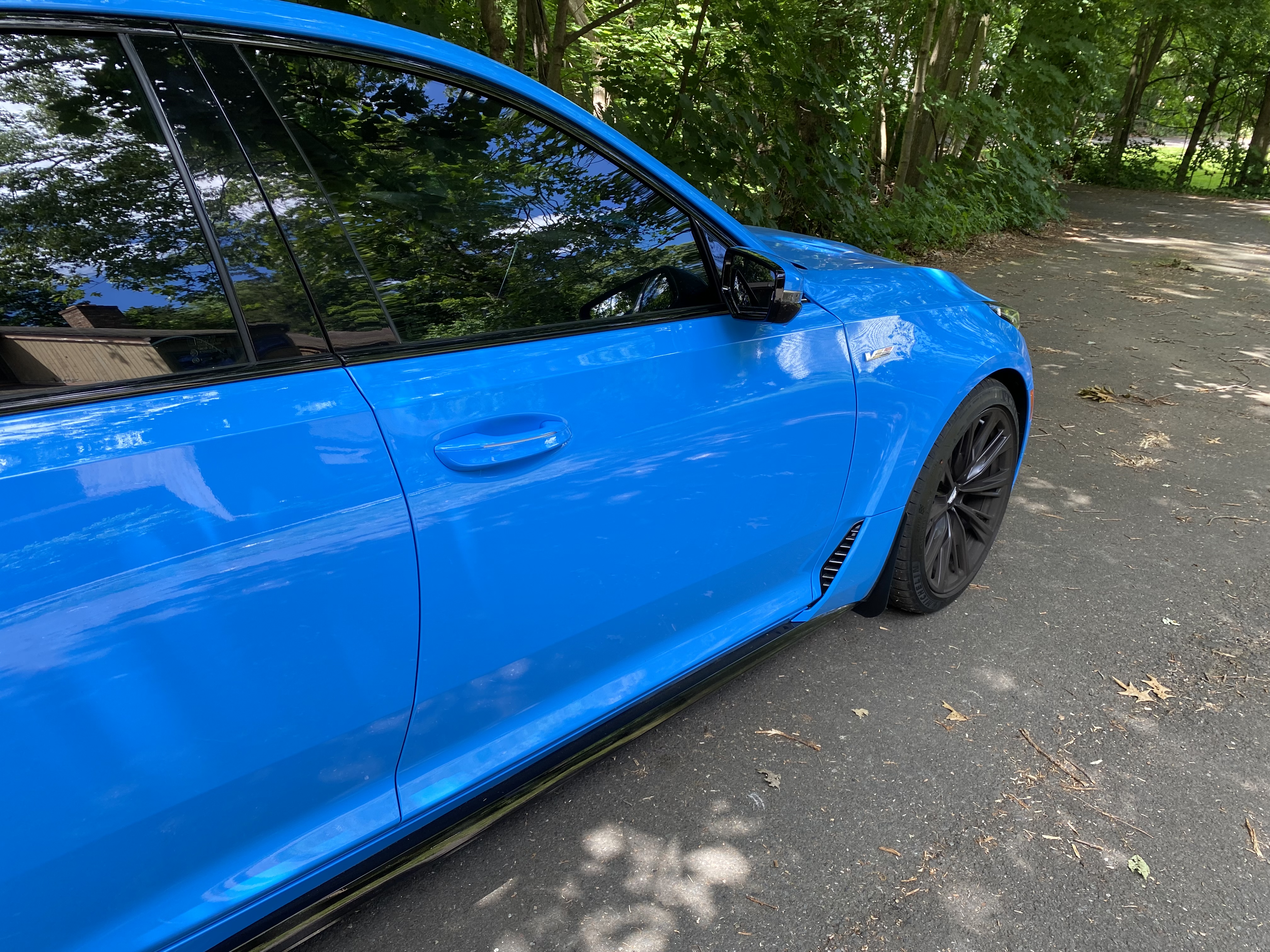

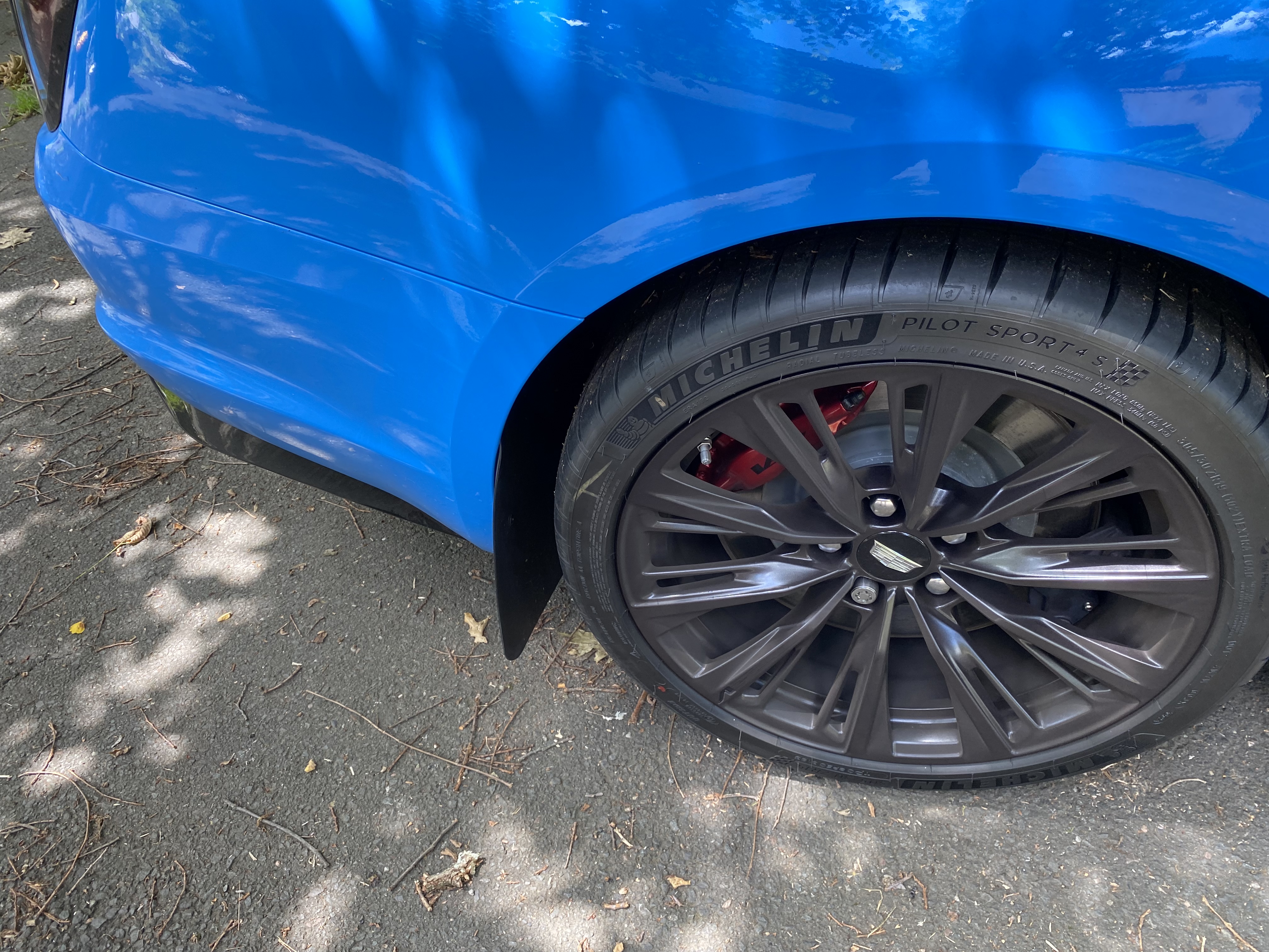

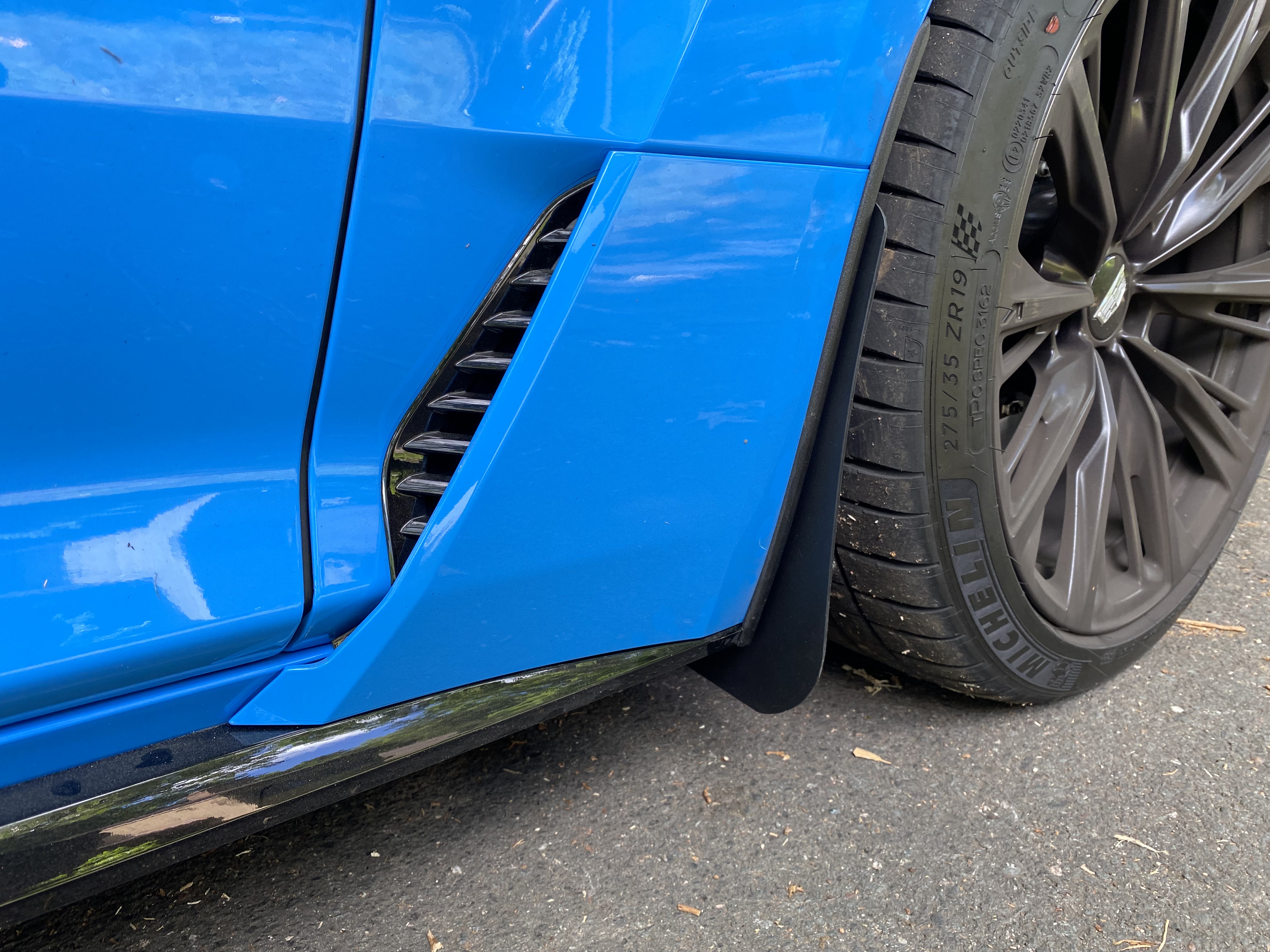

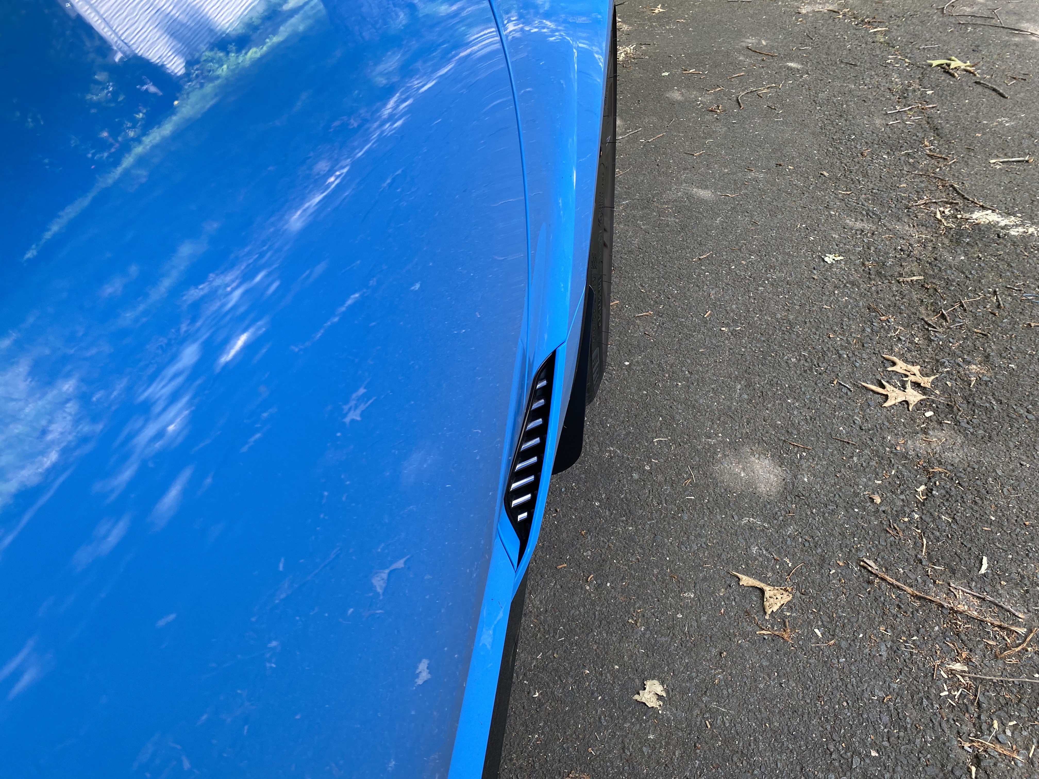

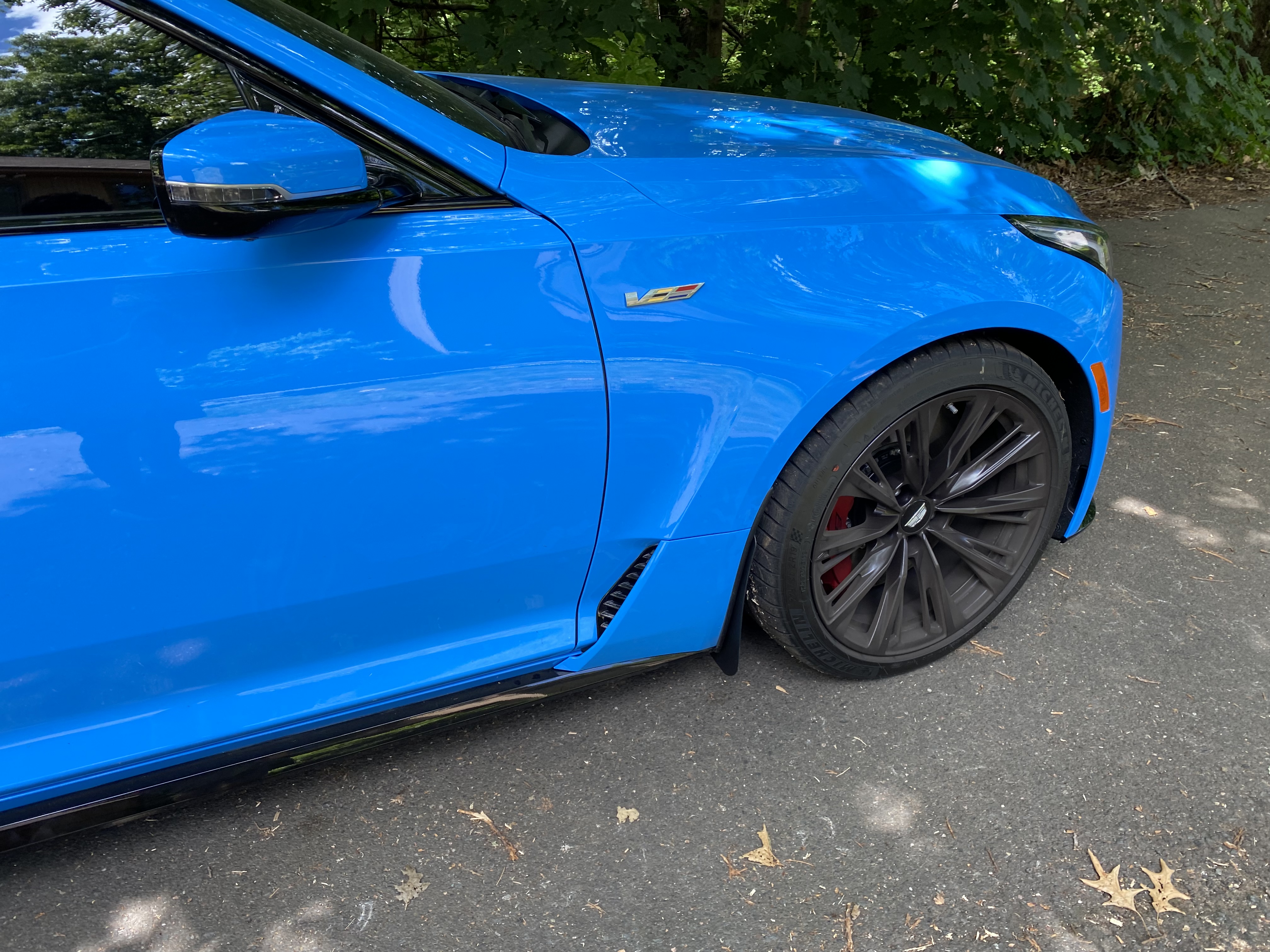

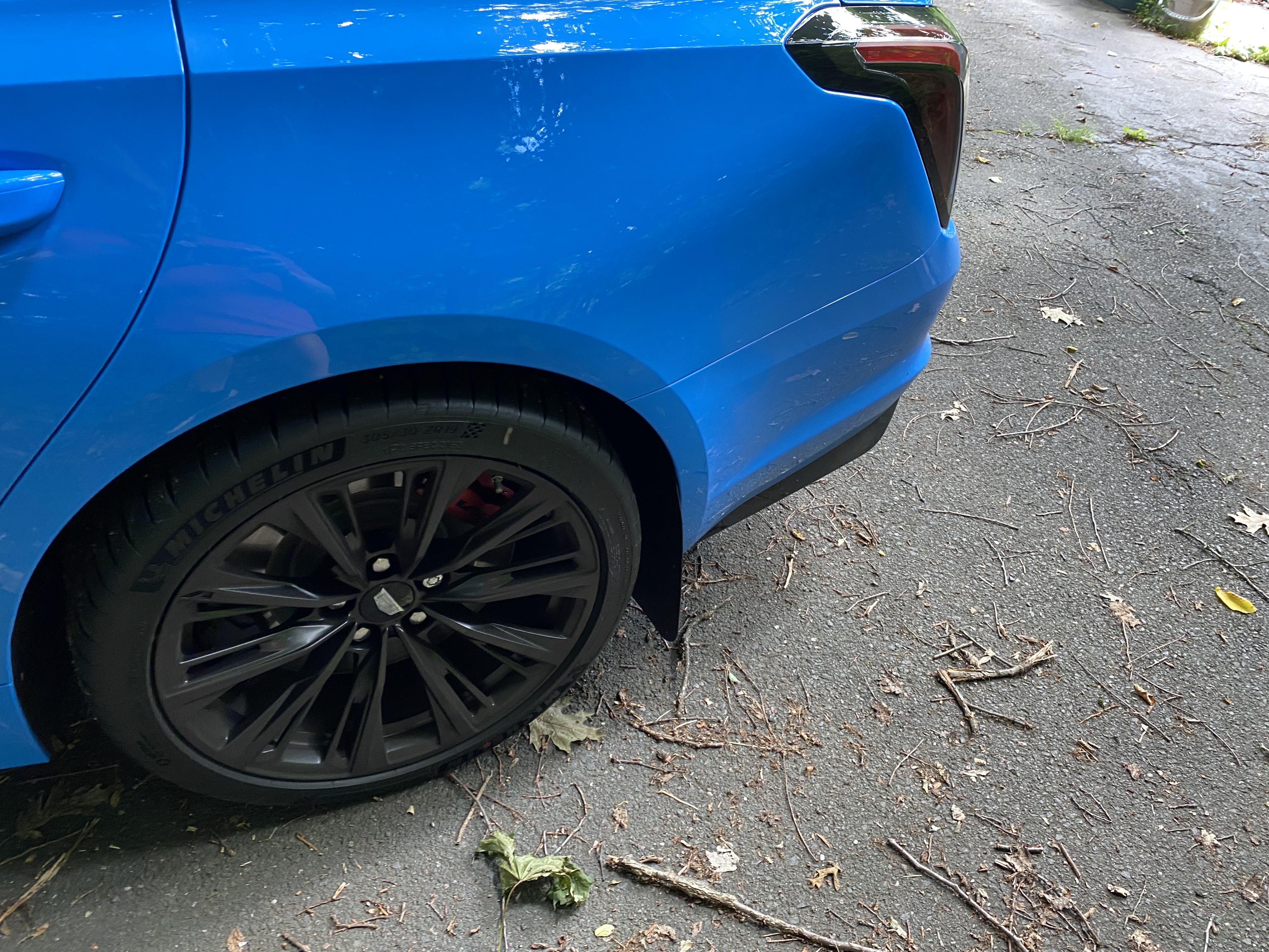

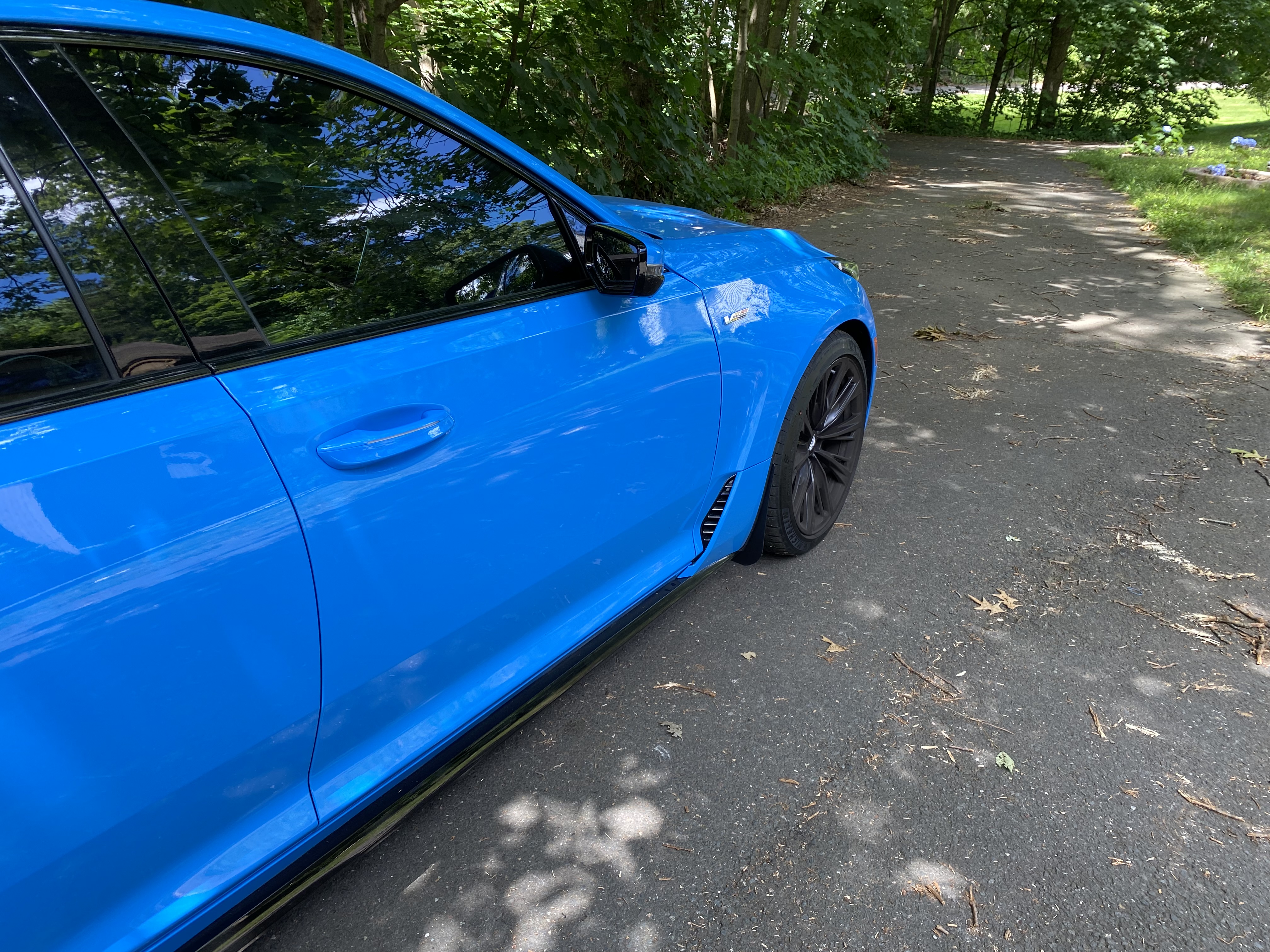

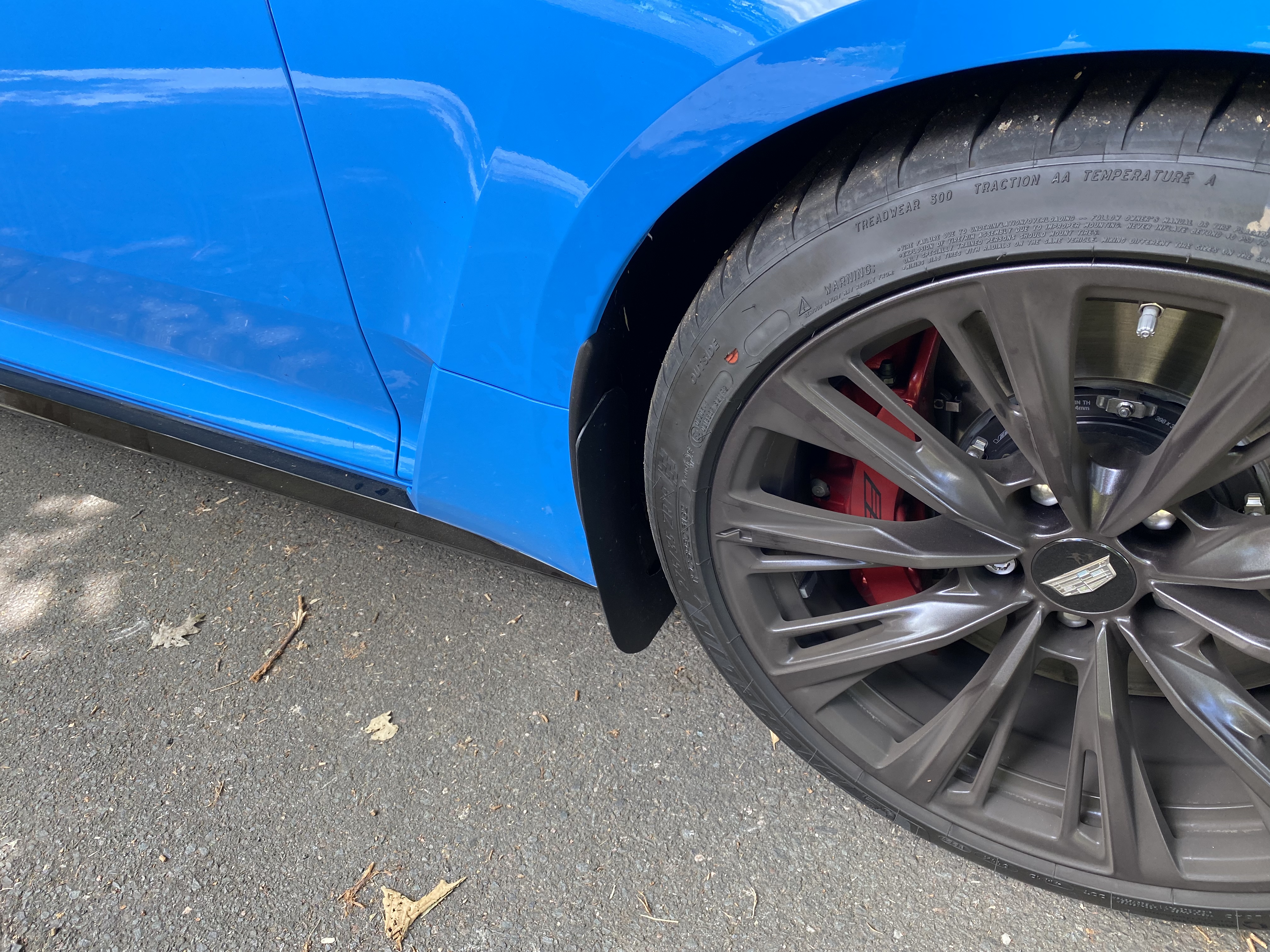

So I put on some rock/splash guards on the CT5.
Basically inspired by the Tommy Garage rock guards that I bought for my wife’s X3M.
He made a nice little video on them.
Anyway people on the X3m forums we’re talking about how much they liked them but one person said that basically he just gets the super cheap 18 dollar ones on Amazon and cuts them and drills them and supplies the rivets and up charges them 1000 percent.
I tried to see it there were ones for the CT5 in a similar form but didn’t see any so I just bought the cheapo ones off Amazon and cut and drilled them myself.
Basically there are 2 torx screws on the rear fender that can come out easily with a T4 Allen key and then I used a paper template to map out where I should drill some holes in the flap and cut the flaps to a reasonable shape. In the rear I probably could have gone much shorter but they are the same distance off the ground as the fronts.
For the front there is already a plastic small guard held by a single T4 screw. I wanted to use this screw to secure the front flap but it’s too short. I could have probably bought some longer ones to hold it but was too lazy. So decided to see if 3M double sided tape will hold it as the rear spoiler is just secured this way. For the front flaps you have to cut down much of the material on the inside or else it won’t clear the wheels at full lock. Also I placed excess trimmed flap pieces to level the surface on the preexisting front guard so the flap will sit evenly. I placed them to extend on the sides to cover the tread but not the sidewall.
I haven’t lost one yet and I’ve taken her up to some..decent… speeds.
