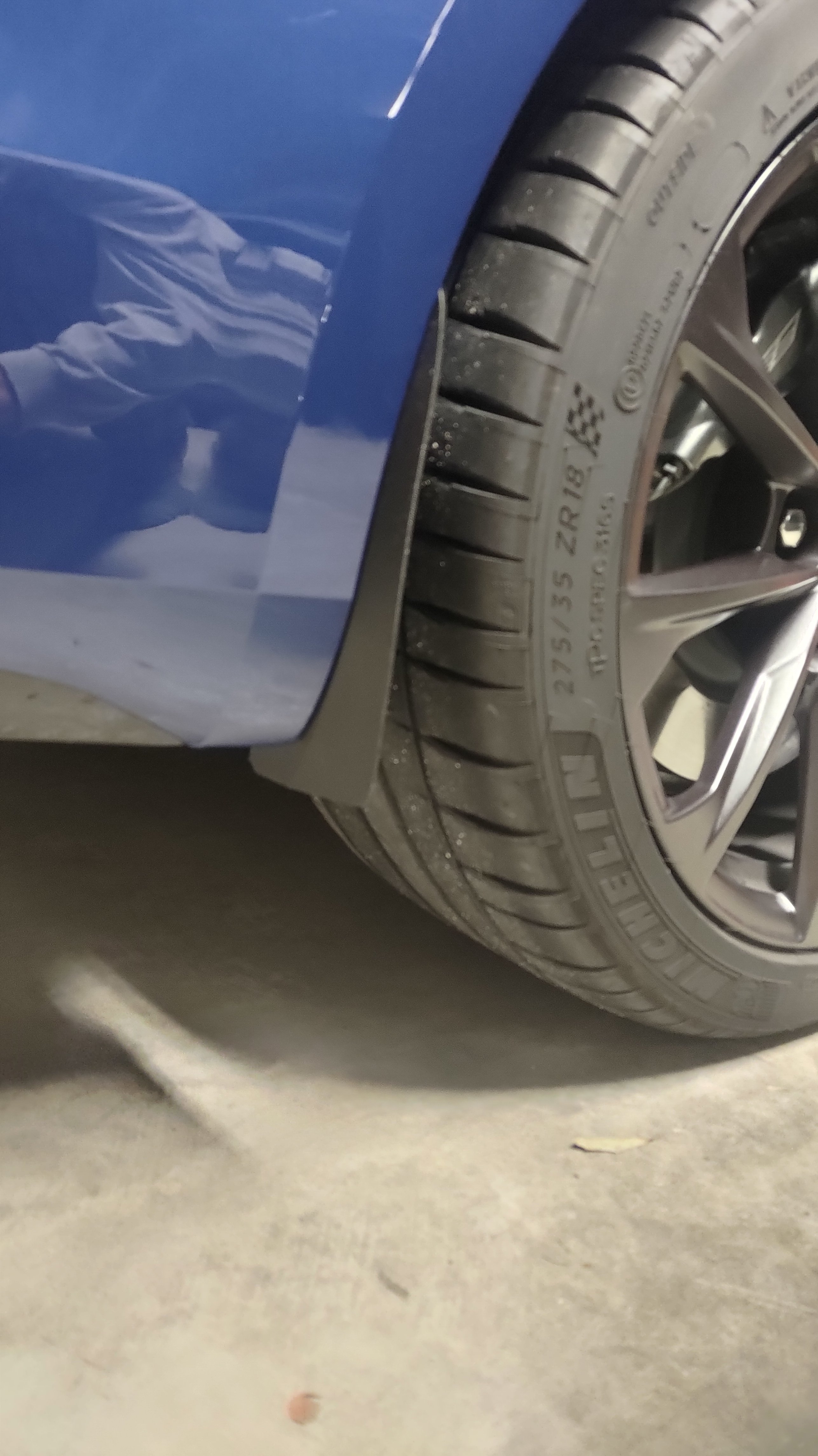

Are you all worried about the minor flex these have damaging the paint if they move around?
I installed them today and noticed they flex just a bit when pushed, even after tightening all 3 bolts.
The gap at the top is not great but I think I'm going to 3d print some "plugs" for that, assuming there's no paint damage risk for the main flaps.

It might and nothing the trusty buffer with some compound couldn’t fix.

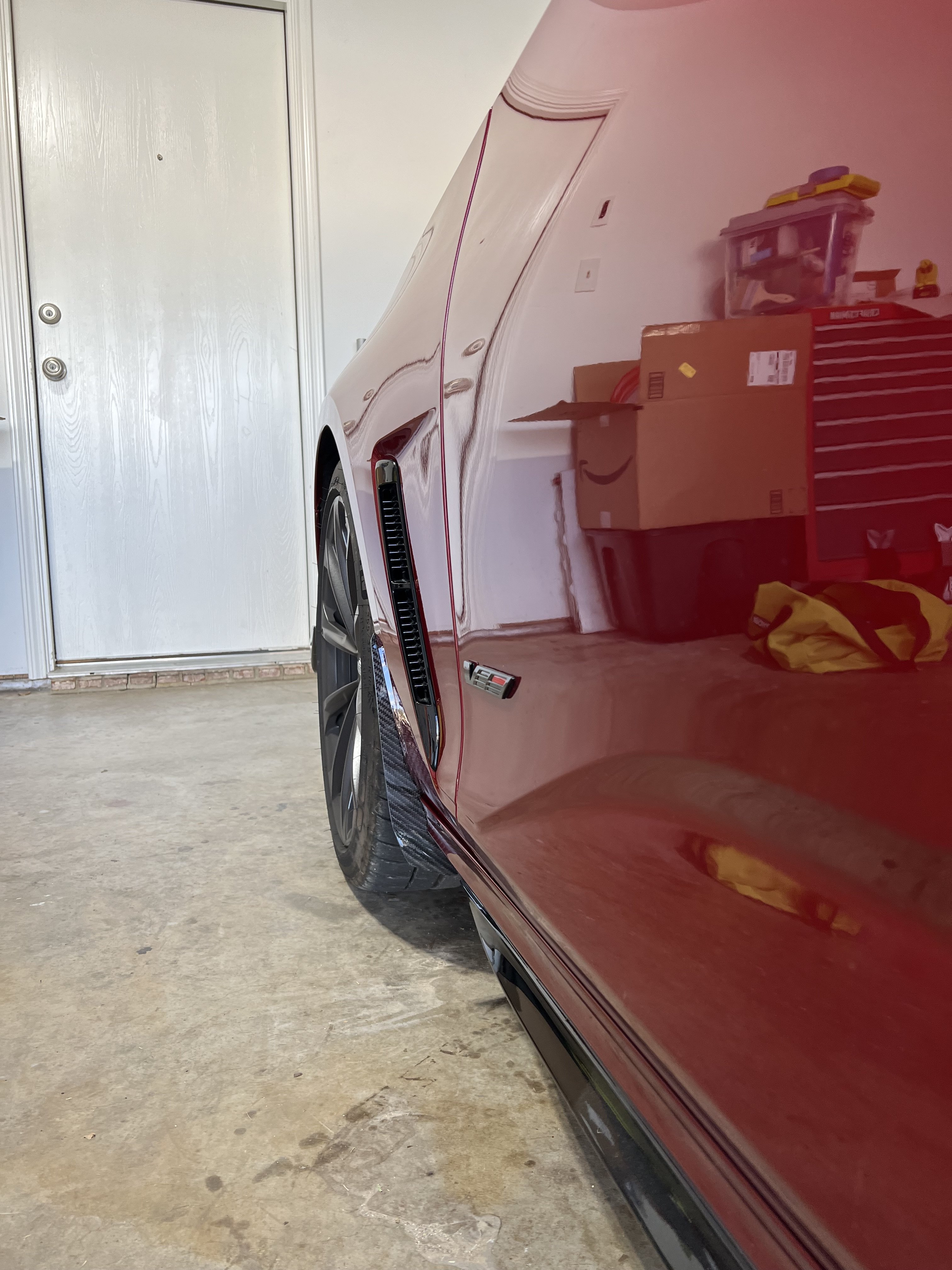

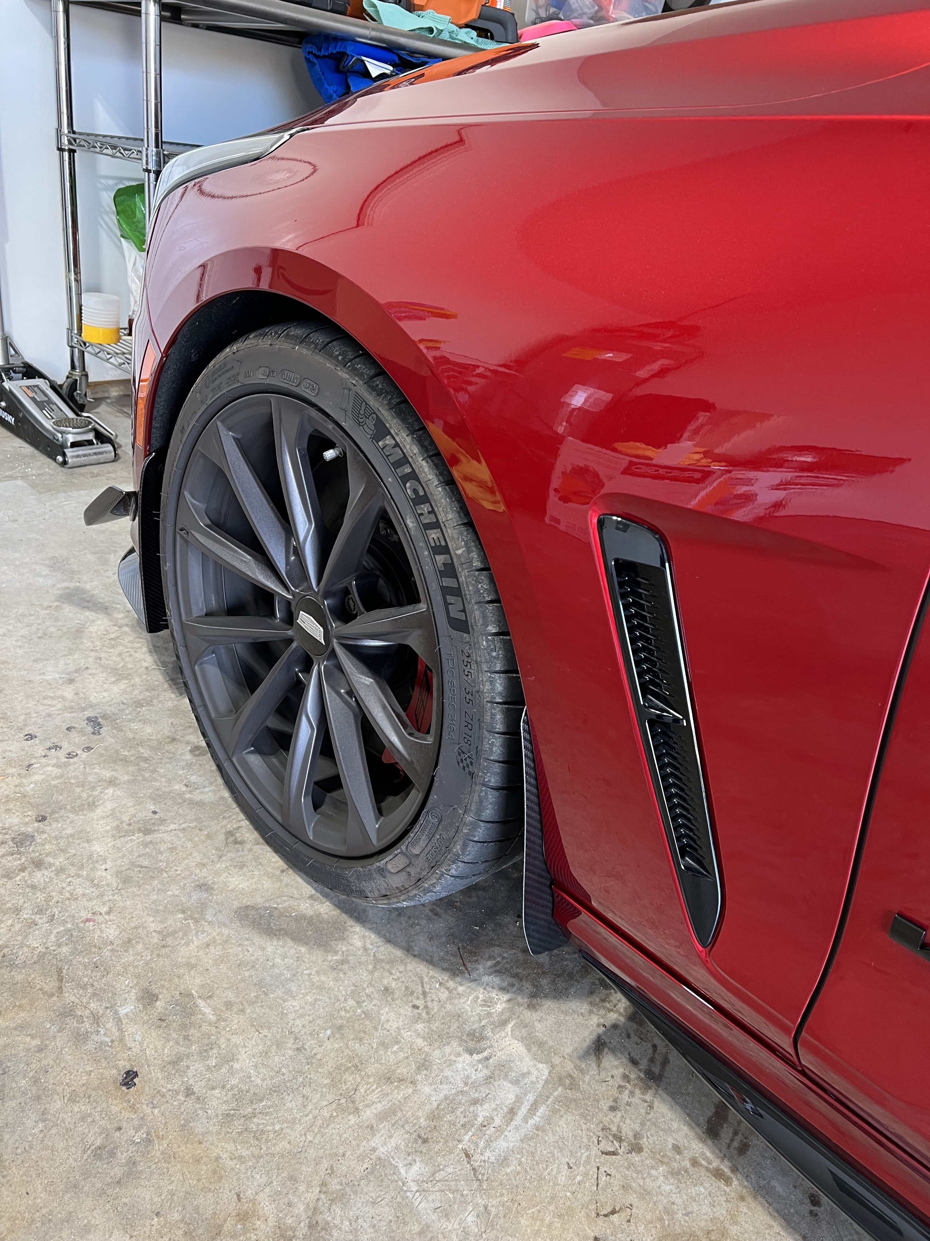

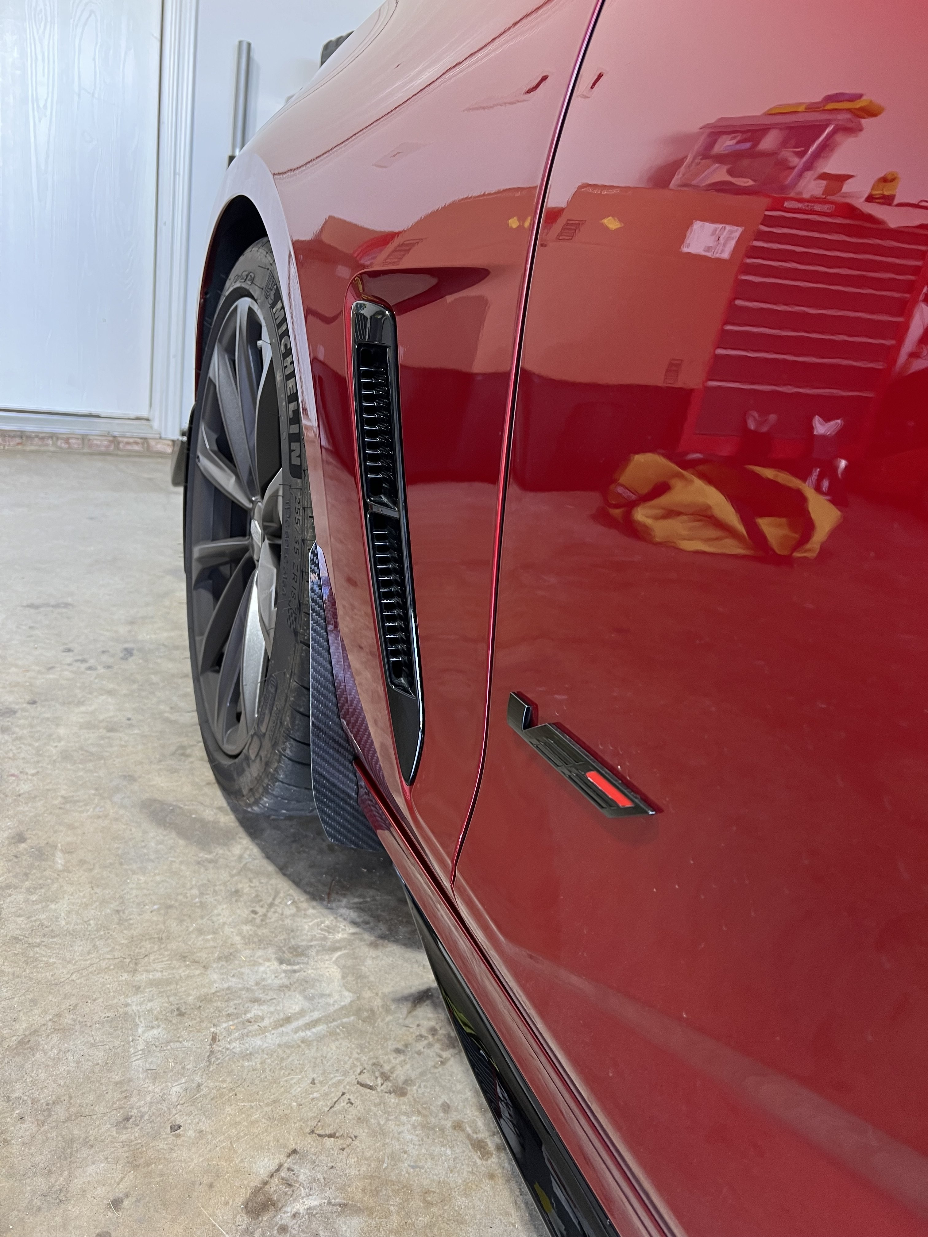

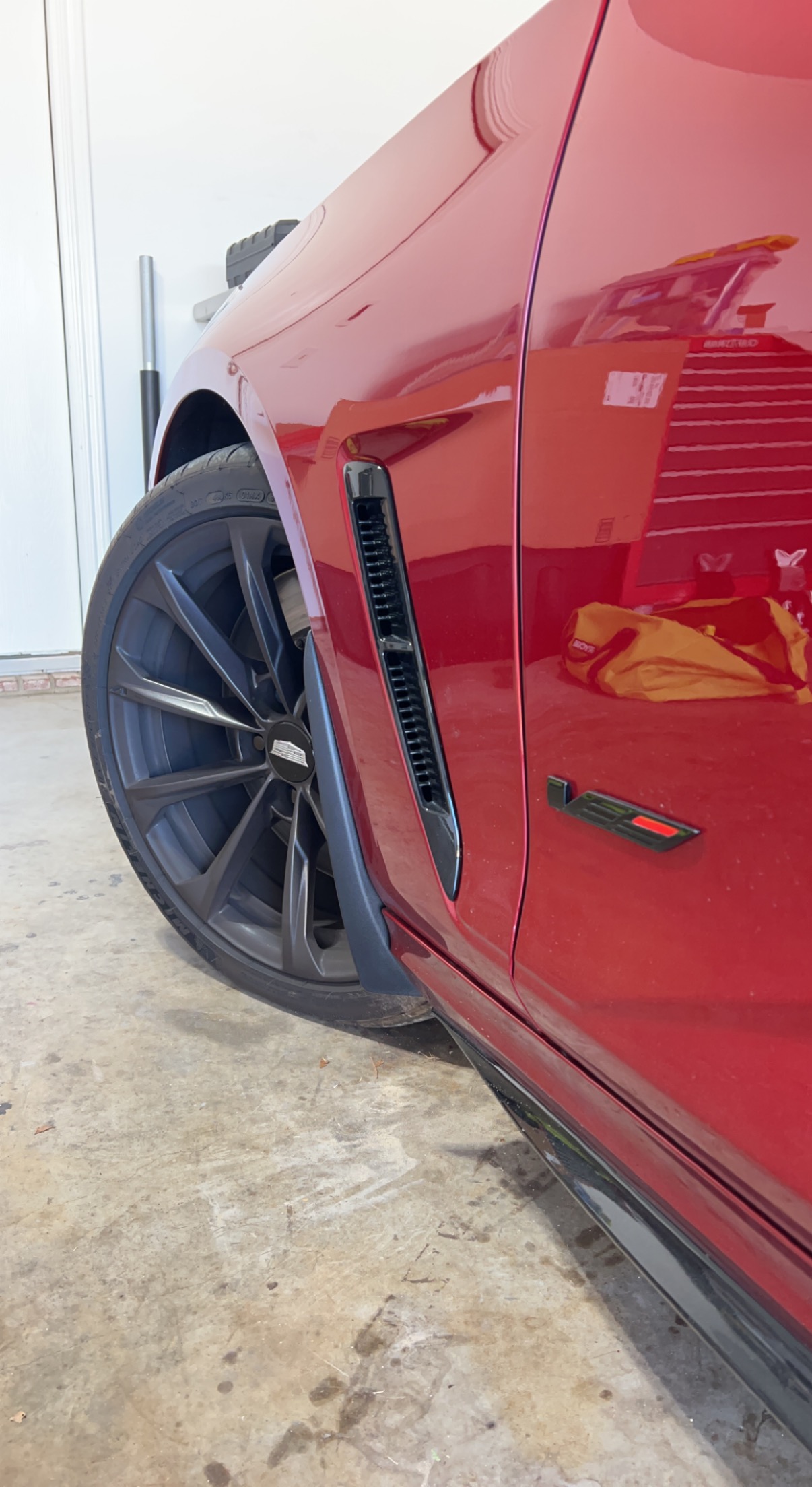

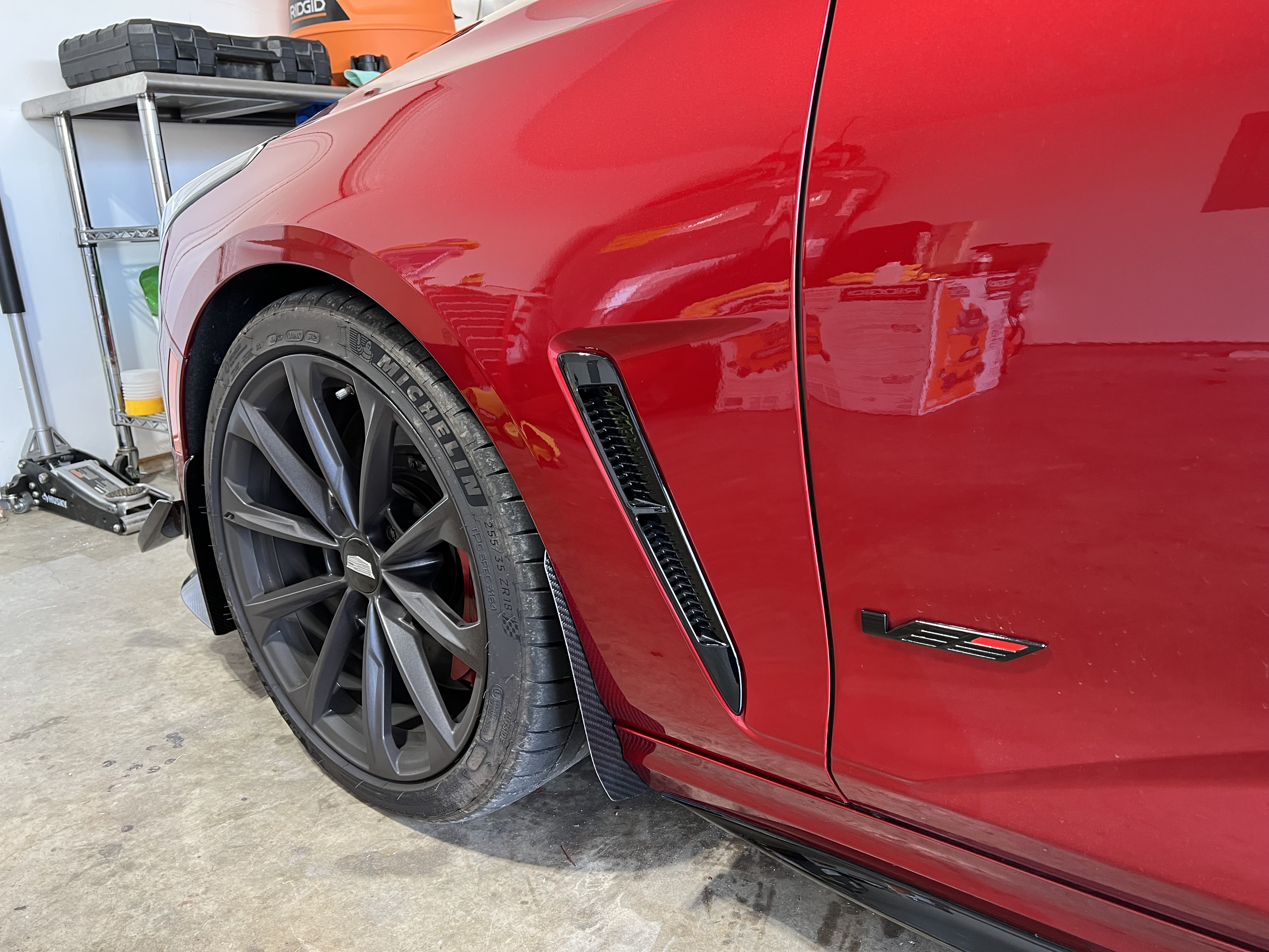

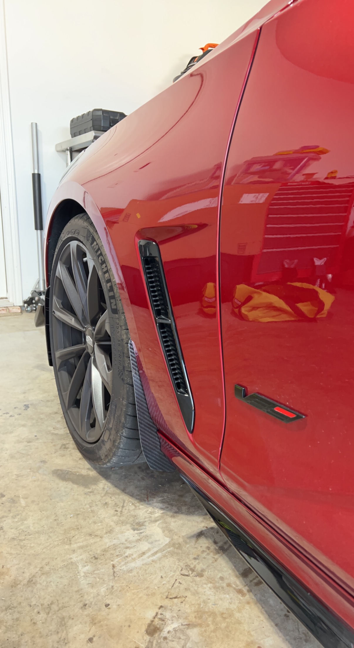

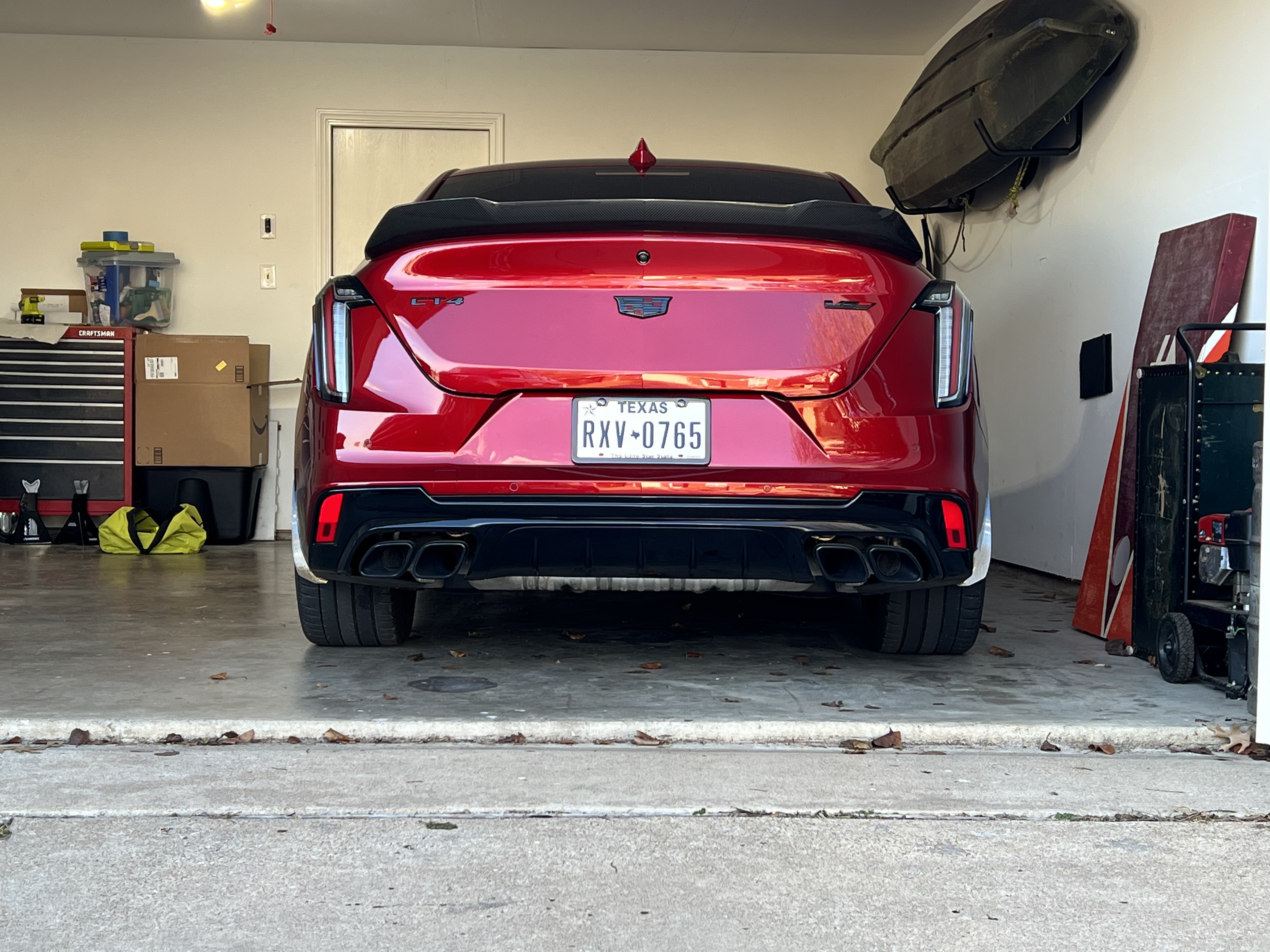

For anyone on the fence about ordering The Original Carbon Guards for the CT4, here are some pictures. Install was a bit nerve wracking because of the double sided tape and how sticky it was once it was tacked, but I really like the overall look of them with both the front and rear installed. My only complaint is that the edges aren't really sealed, so they look matte and unfinished. However, normal people just looking at the car probably wouldn't even notice. I also included a picture of the black plastic fronts that came installed from the factory for comparison.

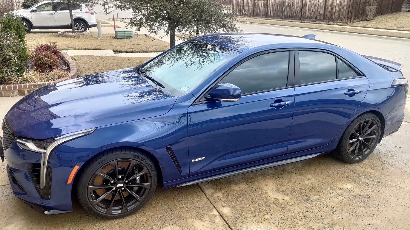

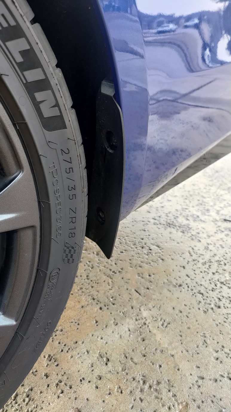

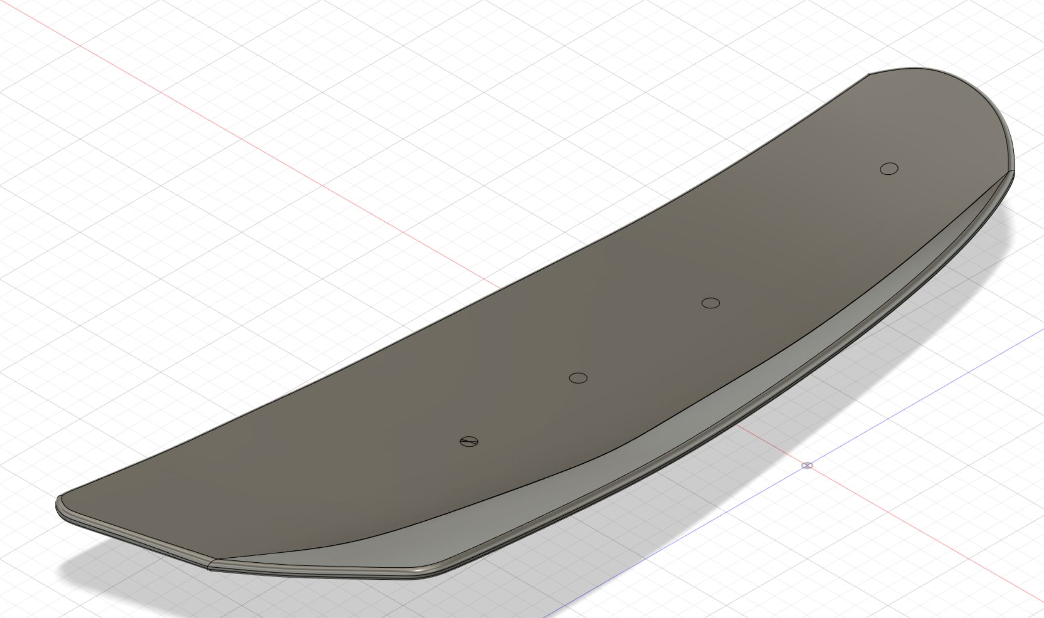

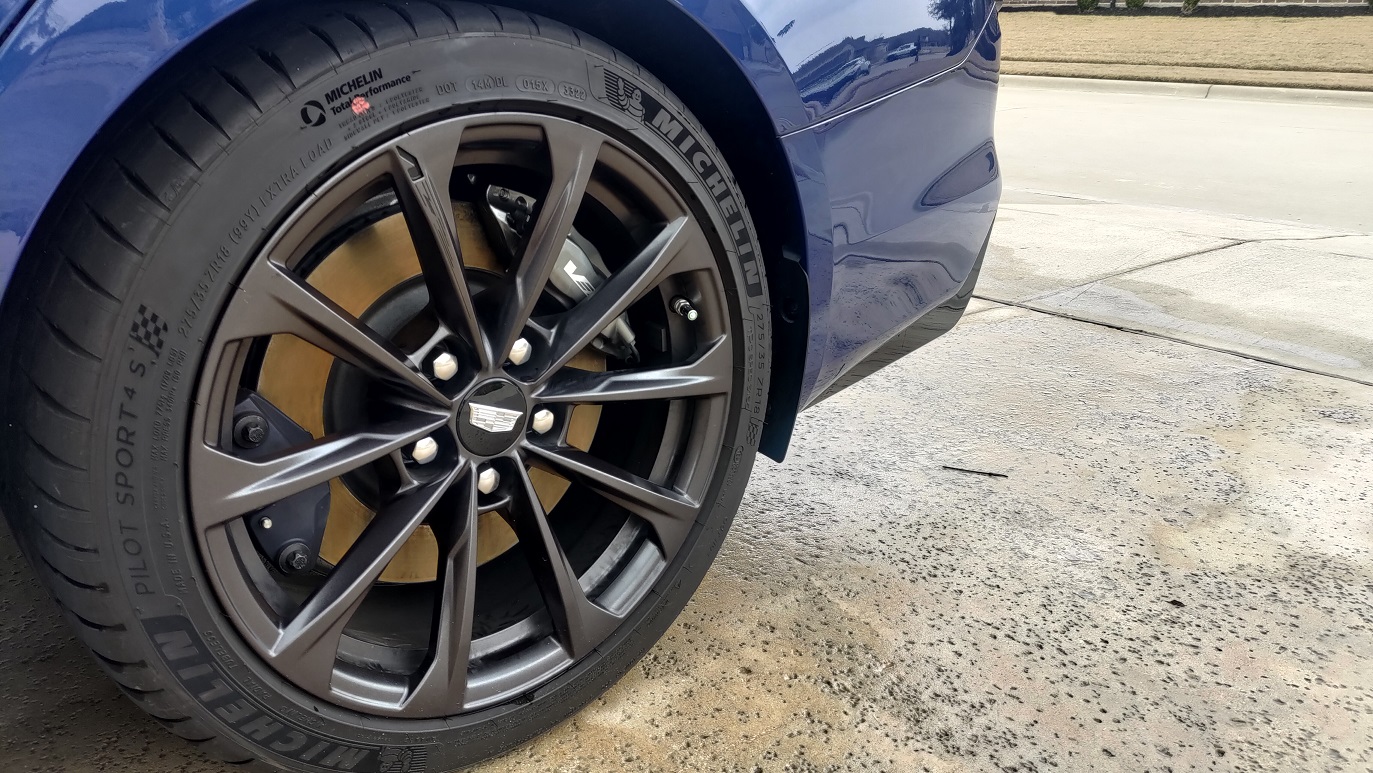

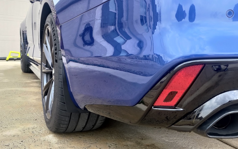

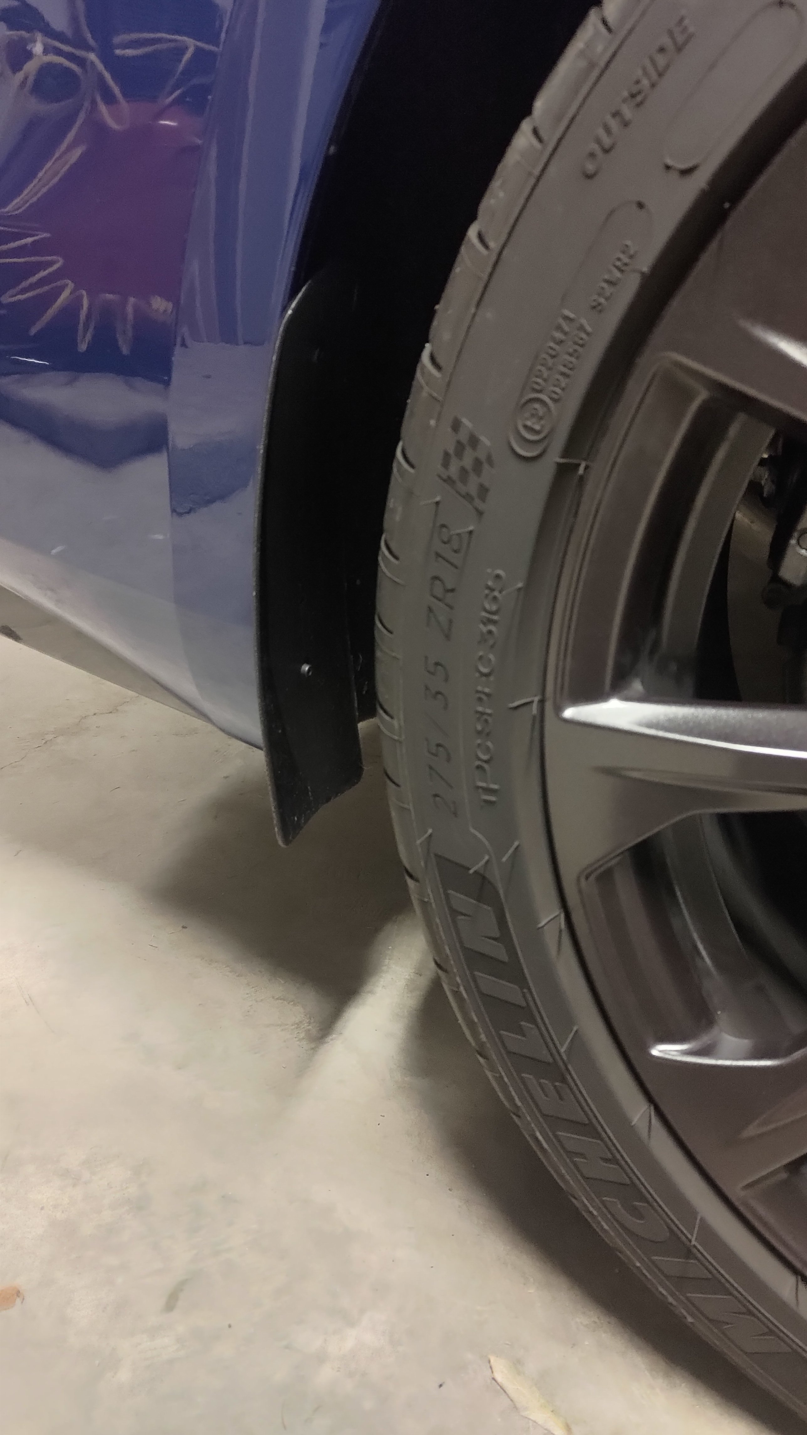

Trying my hand at some custom flaps I modeled up and 3d printed. I've spent more time tweaking them than I'd like to admit, not sure if I'm happy with them yet. Suggestions?

I actually think those look pretty good!
I like them. Small enough that they fade away, but sized right to do the job. Nice work!
Looks very good. How do they compare to the OEM fronts? A good match would be key, ie texture and distance they go up the wheel well.
Thanks! I tried to match the style of the front guards, I think i was somewhat successful. Mine don't go as high as the fronts because I think the front ones go excessively high and I have print size limitations. Texture is a work in progress, I'm using smooth PLA now but will switch to ABS or ASA when I'm happy with them which should match the color and texture of the fronts more closely. The smooth glossy PLA I'm using now matches the black flashing on the bottom of the car though, that wasn't intentional but a nice surprise.

Kinda hard to tell in the pics. Are these 2D or, 3D? I'm not a fan of the 2D ones like ZL1 Addons.
damn those look good! any chance I could get that .stl file? :)
Yeah I'd be willing to share the STL, but need to get it closer to a final state first though. Right now it's two pieces, one base adapter to bridge the space, then the flap part. Too much waste like that but easier to iterate prototypes.

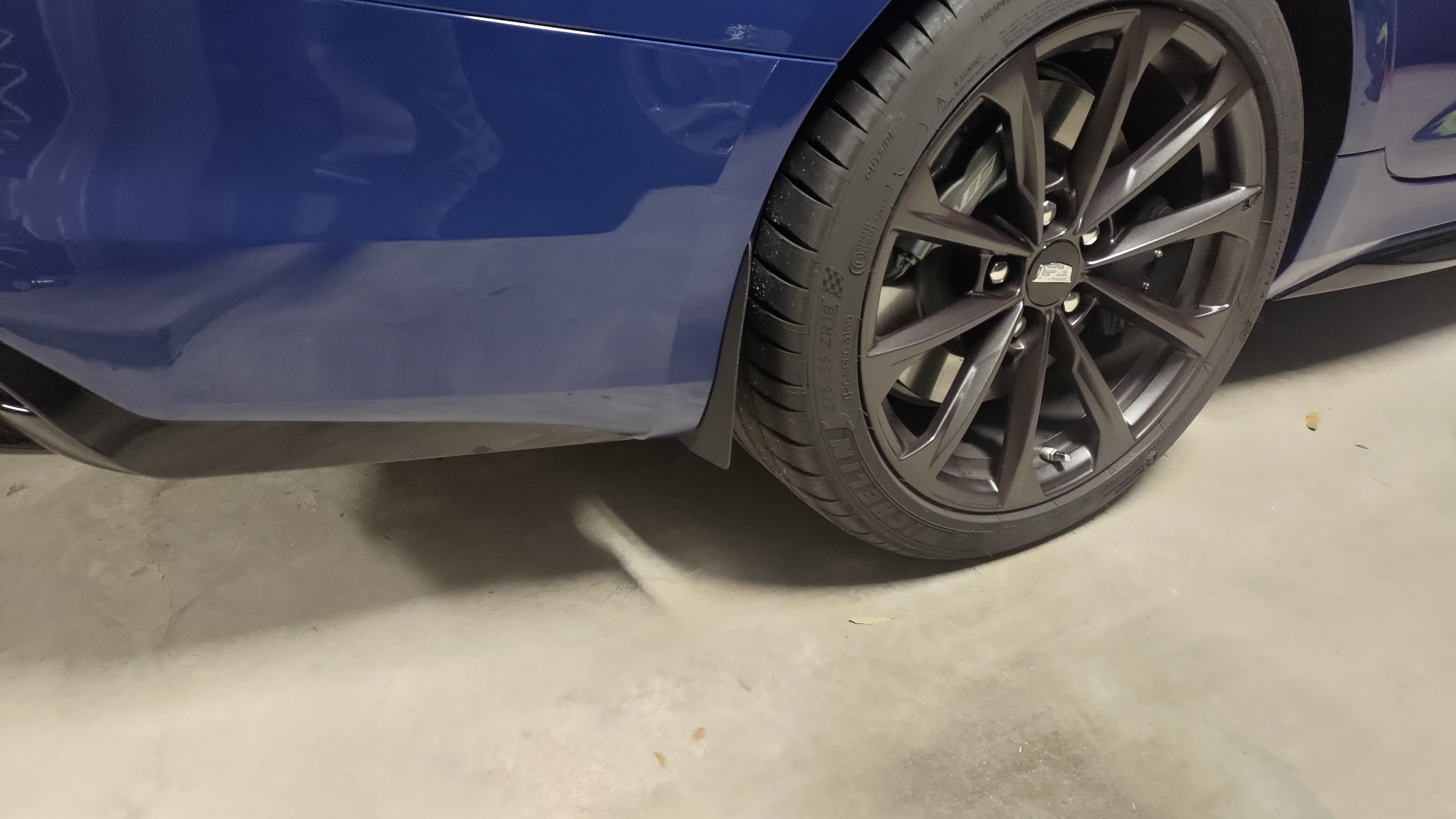

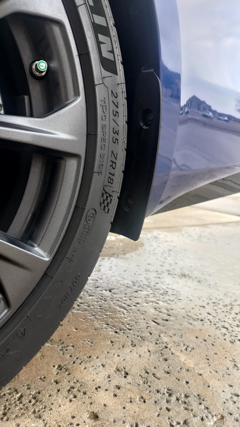

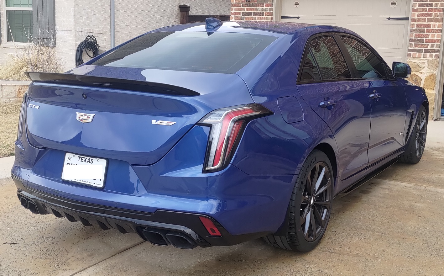

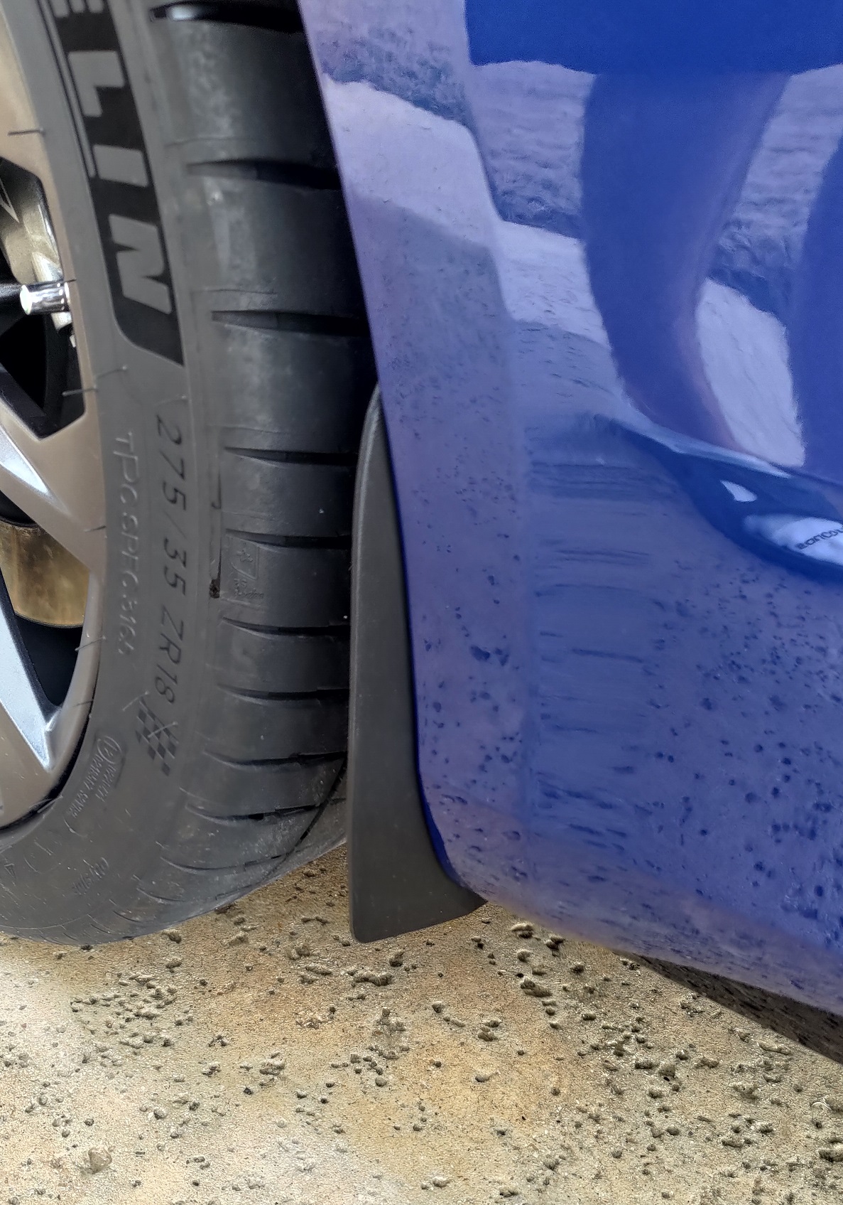

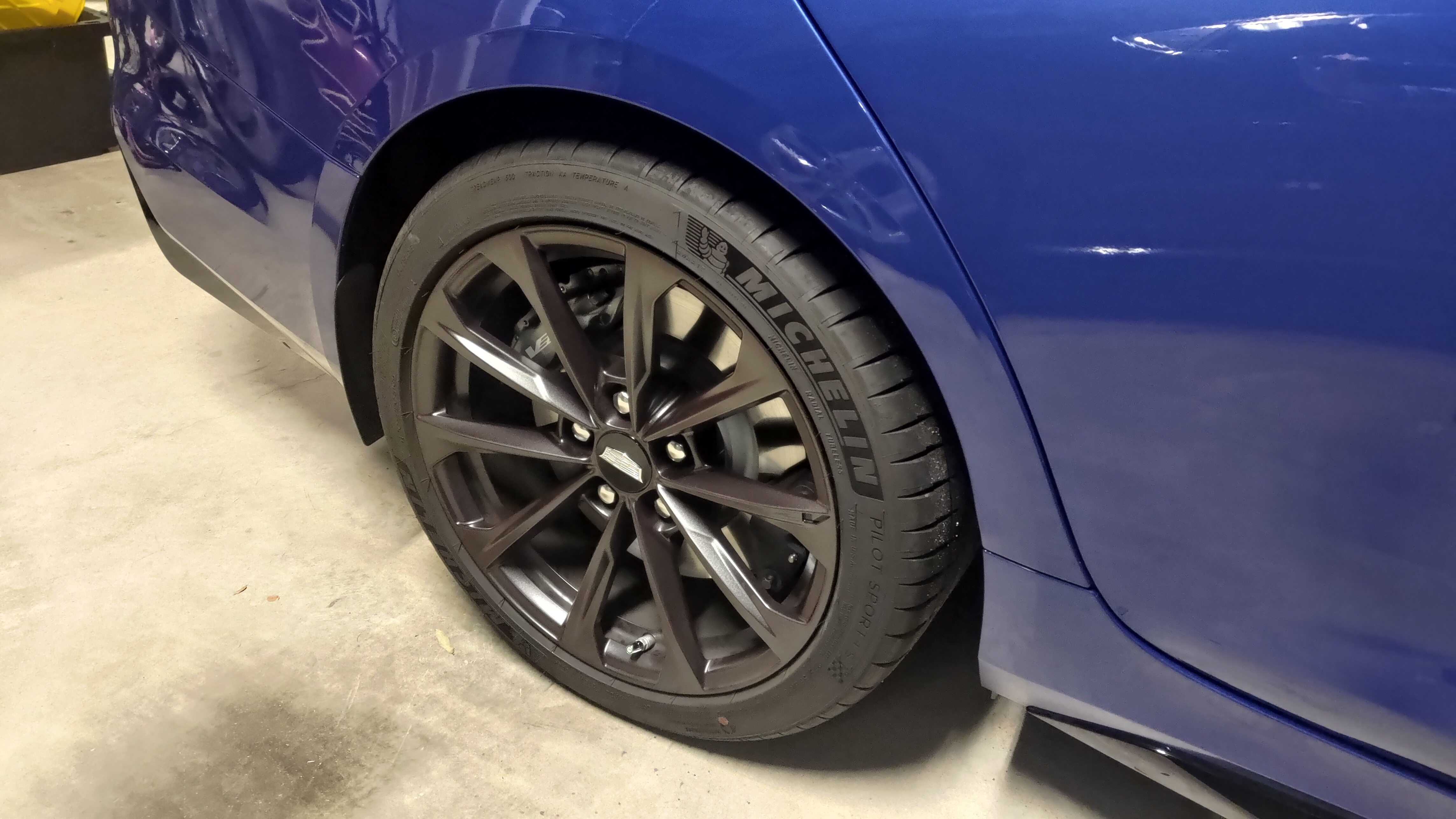

Ok, been out of town a bit and finally have a final* design done.
*it's still not perfect, especially the openings/countersinks where the screws go. I imagine they will fill up with dirt. If anyone knows what type of screws those are maybe we can get longer ones, if so I can reduce the countersink a bit.
I printed it with PLA for now. PLA won't last in the elements, I'm going to watch to see how it does. If I still like them after a few months I'm going to try ASA or ABS, or maybe even send it to a fab shop to get it done in nylon. We'll see.
It attaches in 3 places, one of them being on the bottom.
STL attached for anyone wanting to try it out. Print it with the inwards facing surface on the bed. Let me know if there's any fitment issues. Where these screws get screwed has some play it seems.

Thank you, these look amazing! I think you got the curve on the outer edge perfect. Also thank you for having the near twin of my car so I can really picture how it would look.
@Lithoss - three years later and your STL file is still being used. Had my BIL 3D print it. Fit perfect. Now just need to mirror for the other side. Thanks for sharing.
