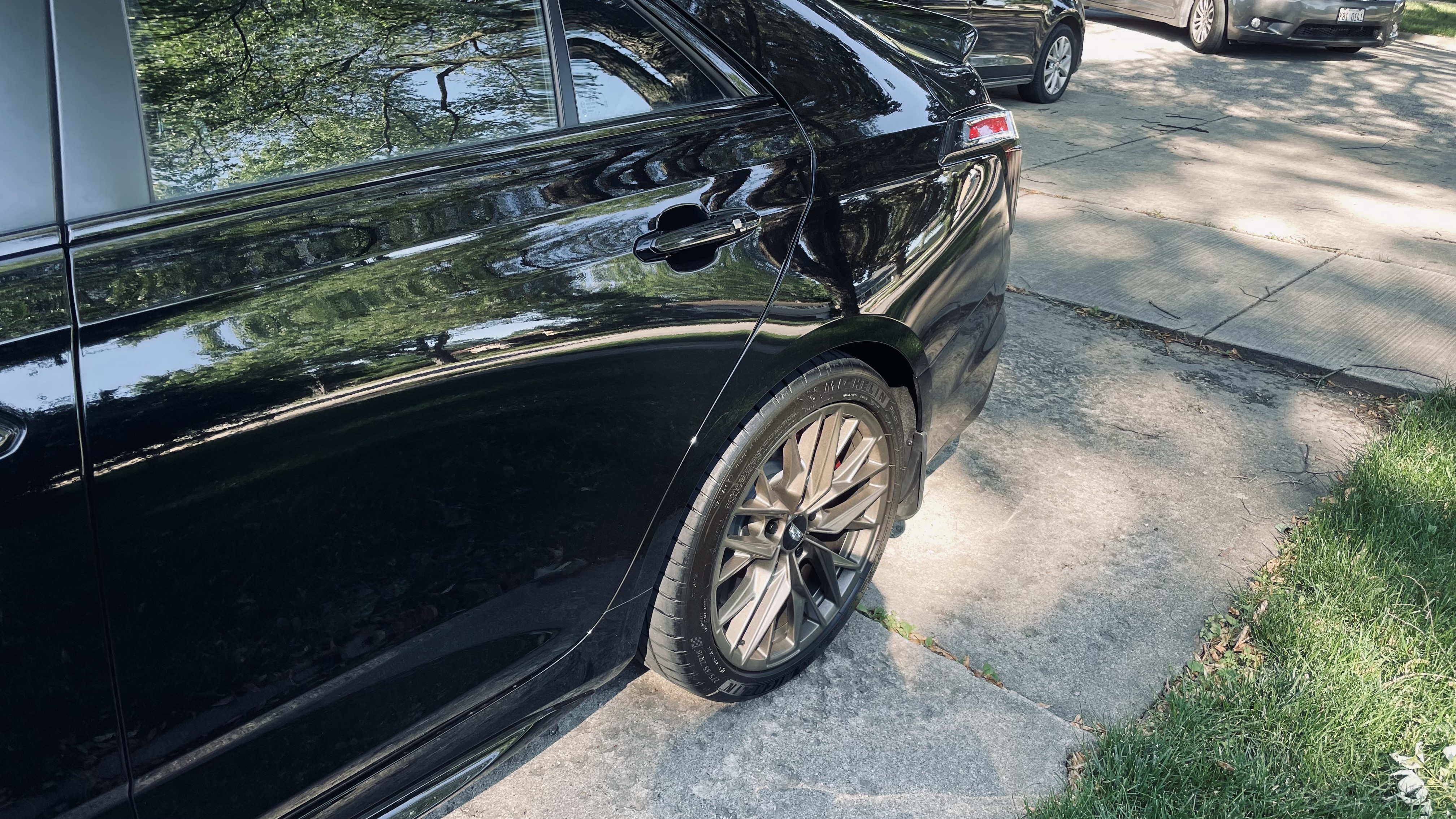

Installation: it's simple if you have the right tools, which I did and didn't. They are tiny T4 screws, three of them; two in the wheel well, 1 underside. The wheel well has almost no room, so you need tiny tools and or tiny hands to get the screws out... but I managed with my computer repair kit from iFixit and a small 4mm socket... the whole tiny 1/4 wrench wouldnt fit in there. Once you have the screws out, just hold the splash guard in place as you hand insert and tighten the screws back in. Repeat twice and boom done. They look good too!
Pic:
For those worried about rocks, especially in winter, rear splash/rock guards are great. Good news is, any rear splash/rock guards for a regular CT4 will work on the Blackwing... and the front already has it.
Link to product I bought: https://www.amazon.com/gp/product/B08834LGH7/ref=ppx_yo_dt_b_search_asin_title?ie=UTF8&psc=1
Comes with the front and rear, not sure what to do about the fronts I dont need.
Pic:View attachment 9576

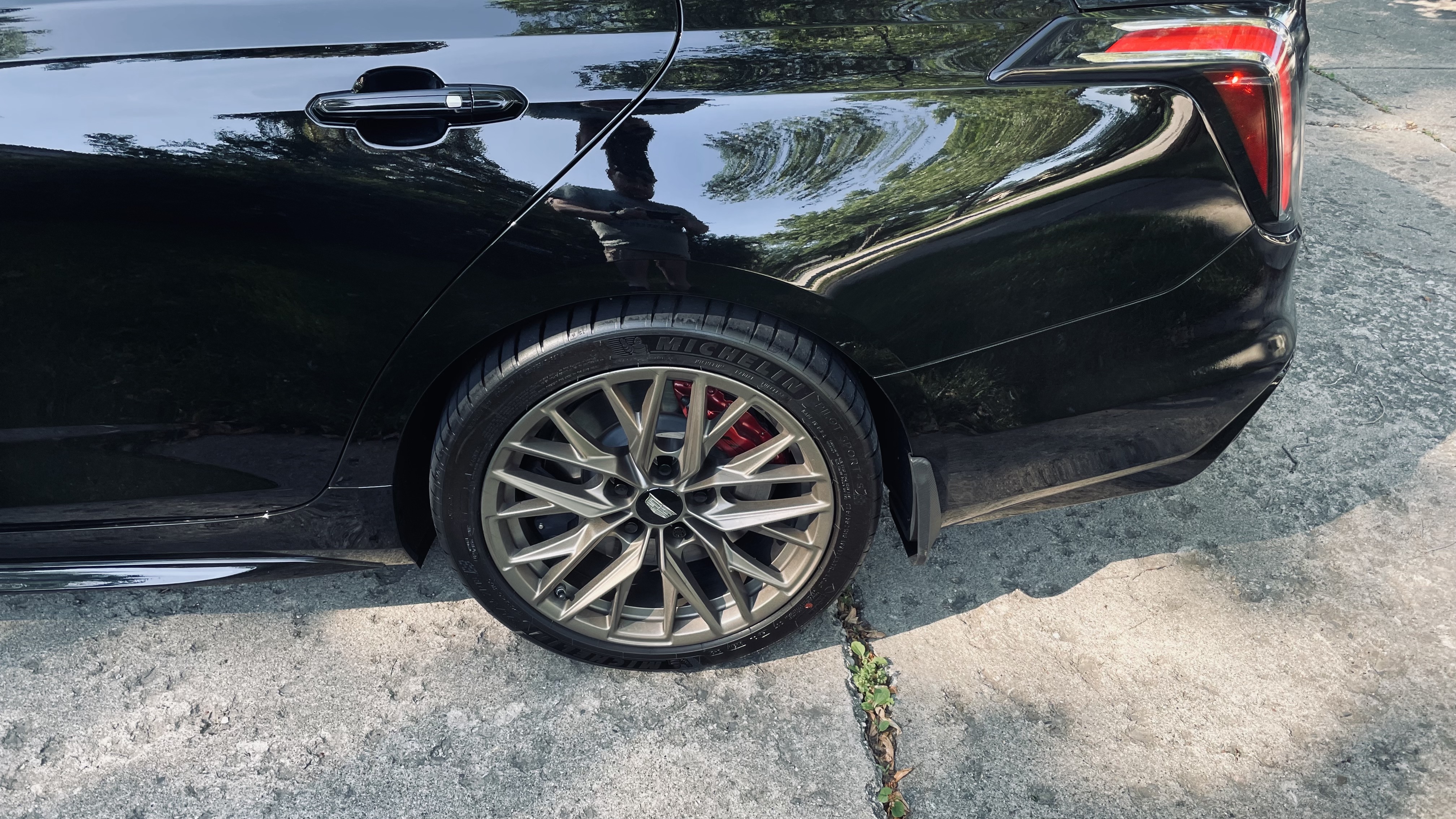

Purchased this same set of rock/splash guards from Amazon. Cheap purchase. Installs easily with right ankle screwdriver so you don't have to take the wheel off. Looks good, hopefully functional. The fronts did not fit like OEM so I chose to keep the OEM front rock guards, with these Amazon rear rock guards.

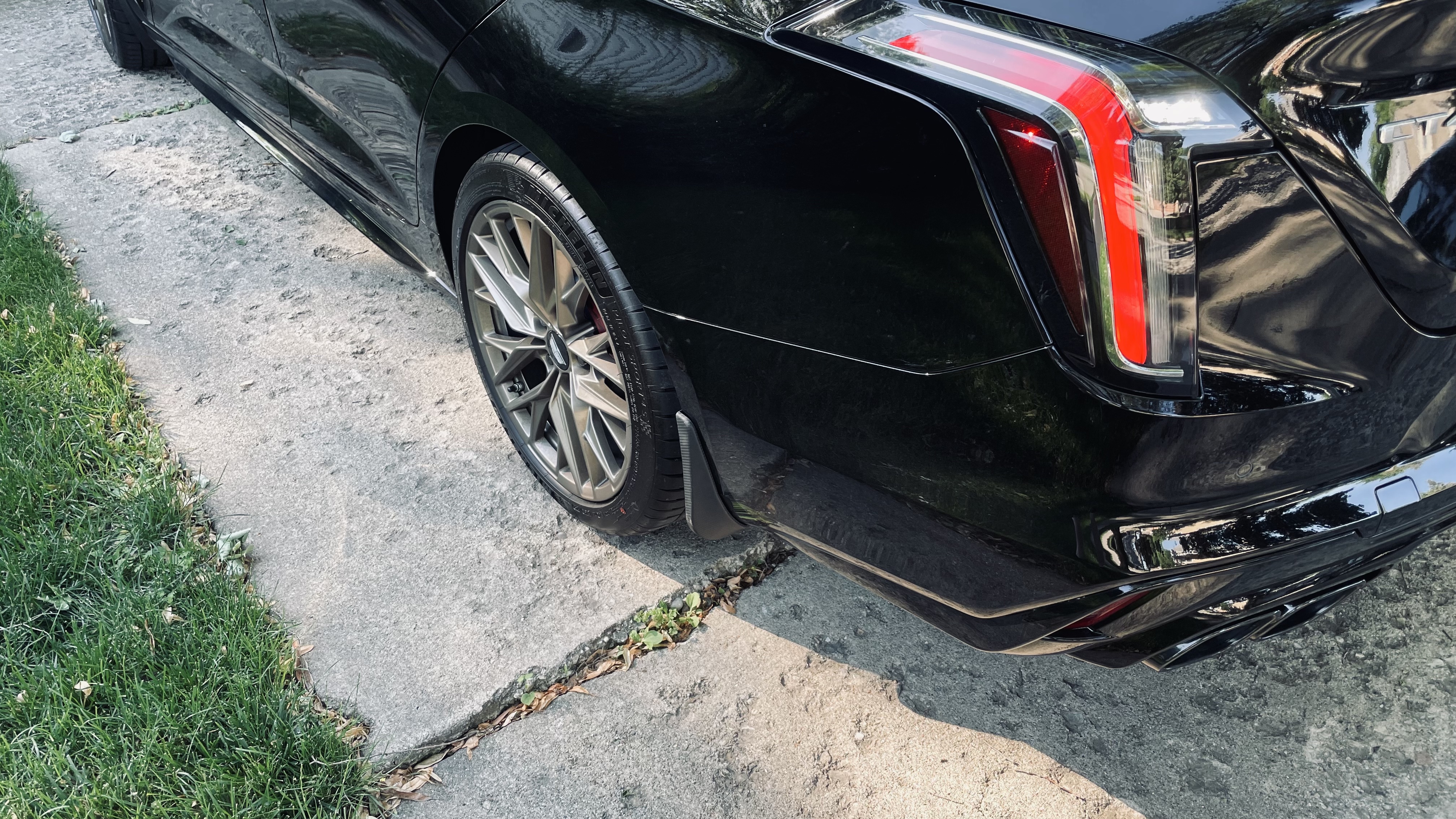

Rear splash guards holding up to Michigan winter's well, helps keep the rear lower bumper clean too. I purchased mine from Amazon, used the rear set only (front didn't fit anyway). Relatively inexpensive at $30-40, and easy install. I say go for it.
These look pretty good. When you compare the oem fronts to these rears are they close in terms of fit and texture of the plastic? Do the rears look like they could be oem? Looks like there is a bit of a gap between the guard and fender in that pic. Maybe just a shadow?
I tried them and didn't like it b/c of that gap. I'm bringing my car to zl1addons this monday so they can get the ball rolling on fabricating some for the ct4 bw.

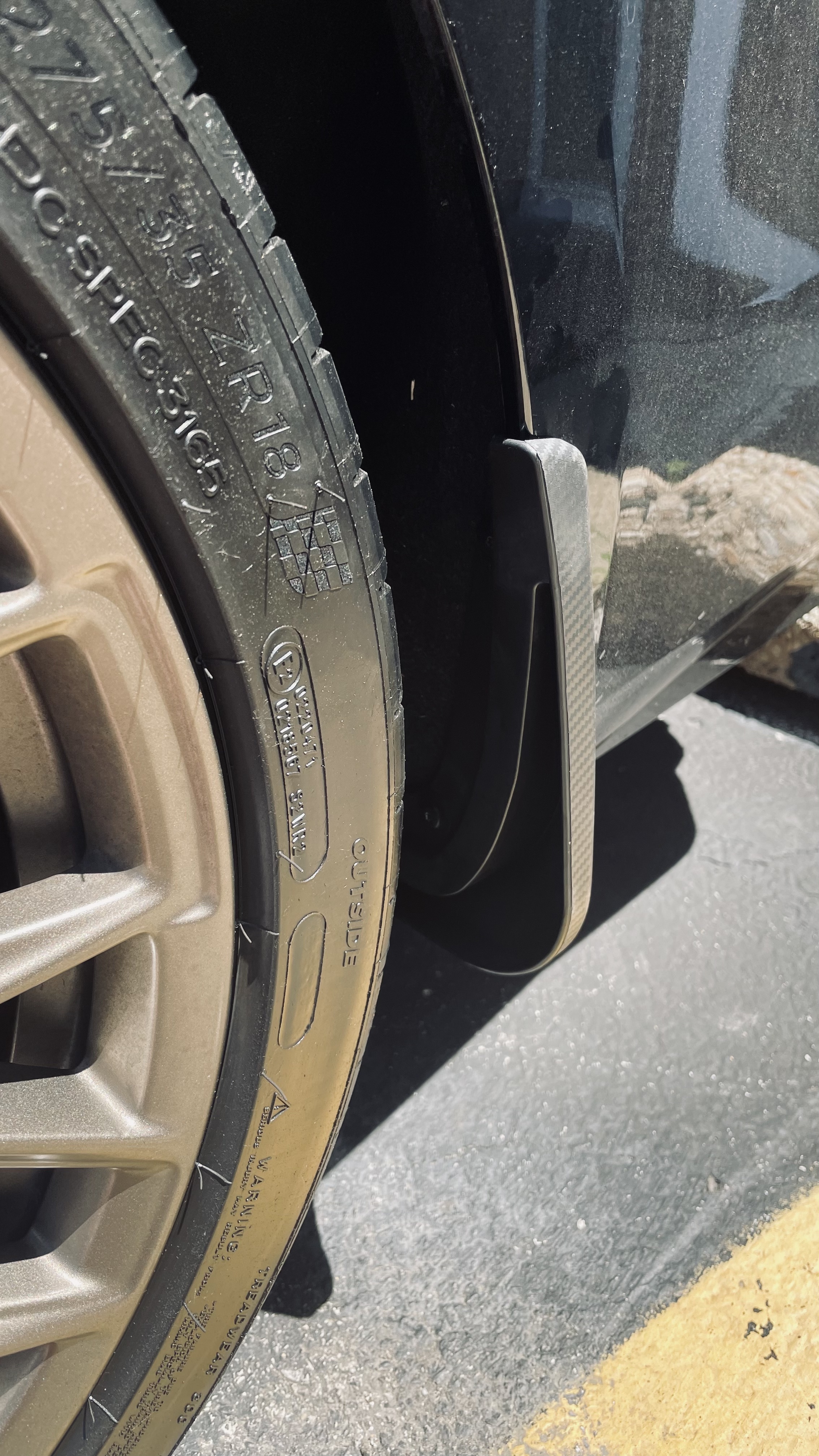

Have you guys seen the CF mudflaps discussed in this thread? A lot more expensive, but they do look nice.
They are these:
