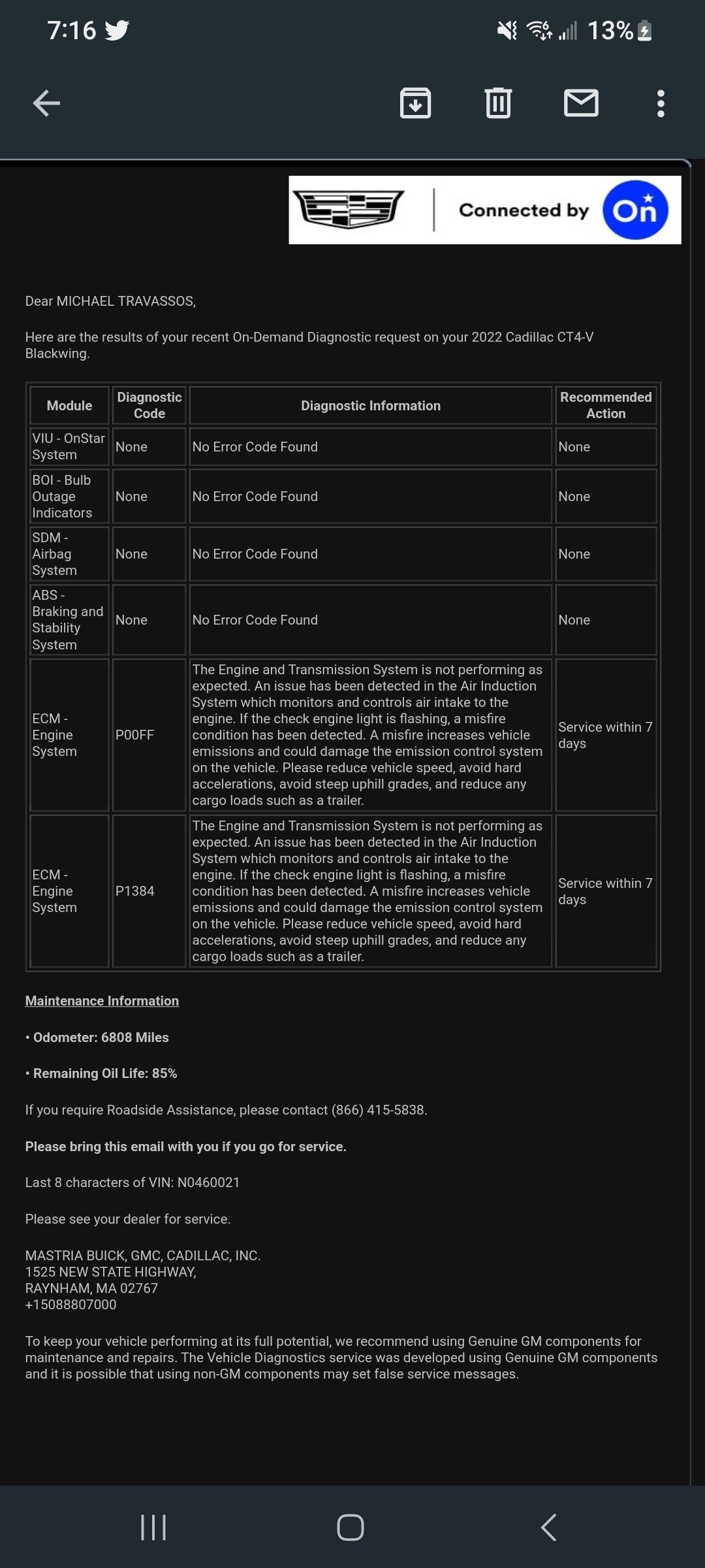

Well I started having issues with my ct4-v blackwing this morning.
My dash lit up like a Christmas tree,car was having a hard time starting.
Called onstar and I was told to not drive my car and take it to the dealer as soon as possible.
Well I get there and knowone cared or had a clue at first was told I had to make a appointment hell no I spent $80,000 I'm not leaving Called cadillac and I'm told not to drive it.
So now I'm pissed and made the dealer keep the car and got a rental.
I'm guessing cadillac had some pull because 1 hour later dealer called me telling me my battery shit to bed .
So then they had it replaced and now the car it 100% fine with no issues.

Good it all worked out at the end. Perhaps the GOAT pen killed some cells...
Just out of curiosity, was there an over the air update recently installed or did the car sit for extended period of time? Glad fixed, but what a pain.
Mine sat about 5 months after being built. I have had no battery issues. I bought a tender for it, but have not yet hooked it up. The longest I have gone between starting it up is 2 weeks, and it had no issues.
In the first part of the read, I was thinking battery or power issue. That is the first thing you should suspect when greeted with multiple lights out of the blue (and the slow start). Glad it was that simple.
