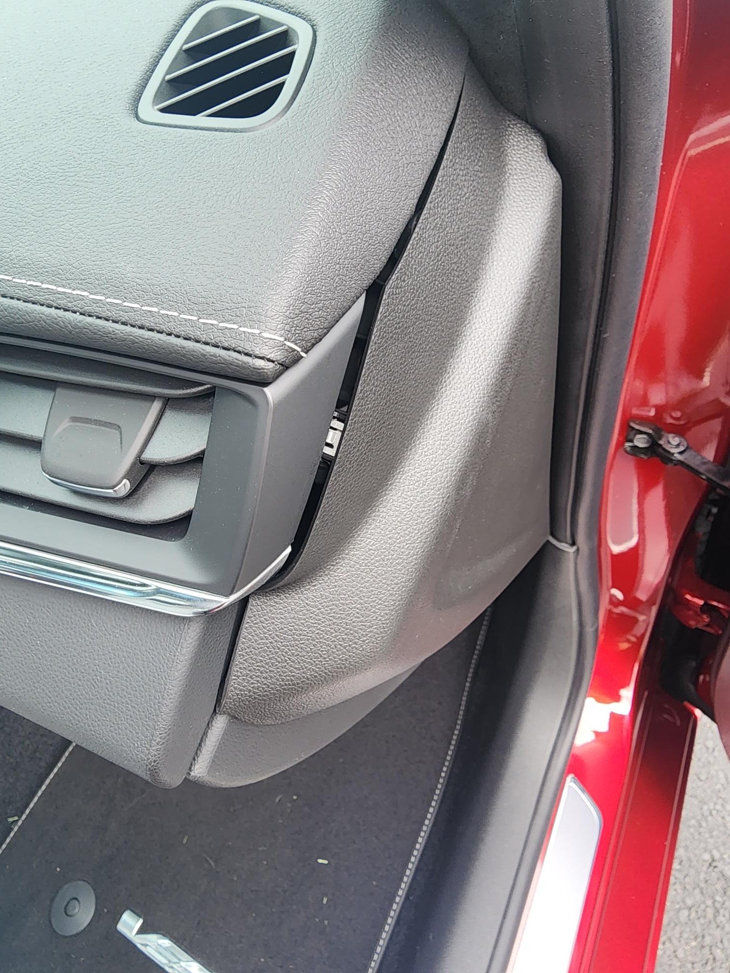

Picked it up yesterday, noticed it today. Tried fixing it but it won't latch. I'll try to solve the creaking on the driver's side next.View attachment 25442
I would try and remove. Make sure none of the clips are backwards or bent.
Wow. Is this brand new or used? That’s pretty bad
Brand new! It was received by a dealer that did the initial clean/prep and then picked up the next day by the dealer I purchased it from (dealer/order trade). Essentially it was missed by the factory and 2 dealers. 🤨 This is our first domestic car and I'm already worried.
I don't feel like messing with it and have the dealer blame me for making it worse. They shop isn't too far and I have to go to that part of town for work tomorrow anyway.
That was my exact thought. Hope they get it squared away for you.

Warped panel, dealer ordered a new one. I'm glad I didn't hit it too hard with my purse . :LOL:

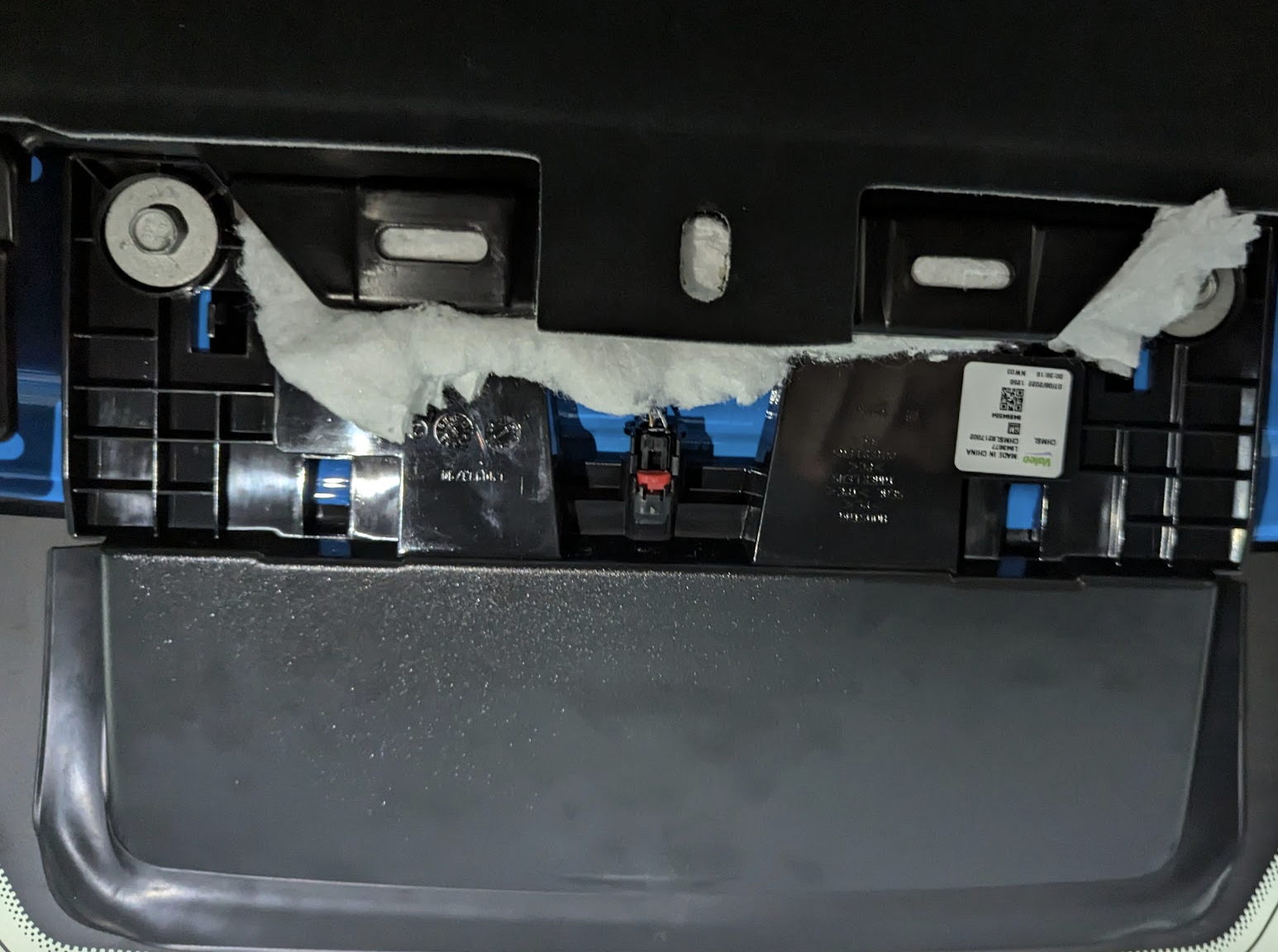

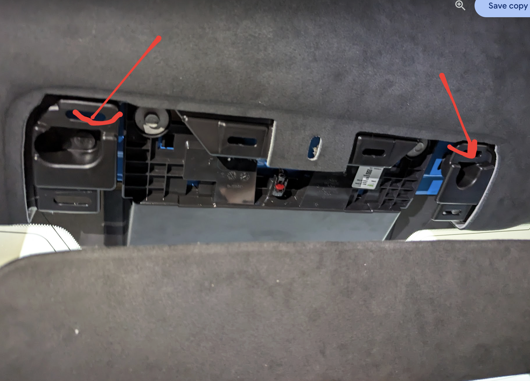

I was able to solve this one.
The trim around the third brake light is separate from the rest of the headliner, and just pulls out with clips.
Once under there, the plastic bracket holding the third brake is visible. It's bolted to the roof of the car and didn't move much. However, a separate black plastic bracket attached to the headliner surrounds it, and that was just held up with clips.
Pull down on those (red arrows), and you can see the underside of roof and the inside of the headliner. There's some dynamat-y material holding down the wires to the antenna that had come loose. I wedged some spare foam rubber between that and the headliner.
Finally, I sandwiched a strip of Thinsulate between the headliner bracket and the third brake light bracket (second pic).
