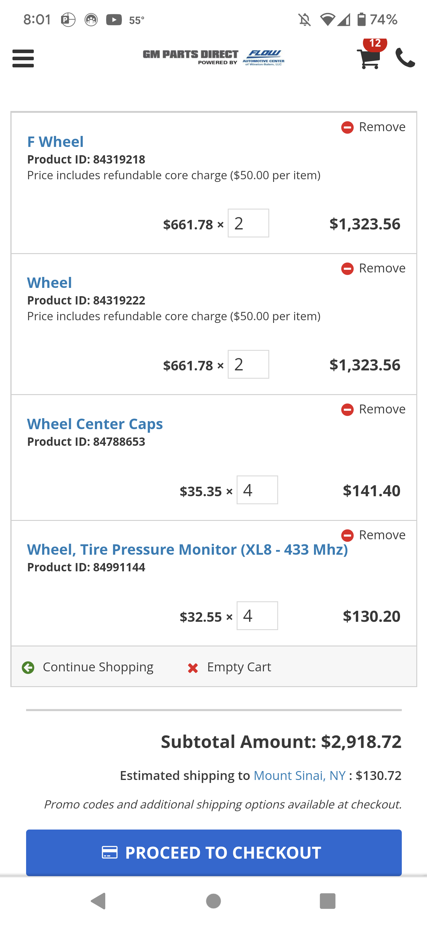

Actually found this in GM parts direct....are these the right part numbers?

@Mirza Grebovic recommended a size down for the fronts as well so 265/35/19 ? I am still debating getting OEM wheels but need part numbers for tpms, nuts, wheel center caps etc
I ordered these for TPMS as per @jkg earlier in this same thread. They seem to be working fine:
sensors - GM 13538760
sensor nuts - GM 13581557
I posted all the wheel PNs based on what my local parts counter told me. If I were you, I would triple check, though, b/c the gmpartsdirect site (and others) confusingly say "Blackwing, 19 front, graphite drk q63" and "Blackwing, 19 rear, graphite drk q63" for those parts even though everywhere else I look, Satin Graphite is Q61.
I just swapped the center caps over from set to set, took no time at all - and I ordered a set of black lug nuts from the Cadillac accessories site since they were on sale there.
Thanks yes I saw that too...sent them an email asking to confirm. I also saw several part numbers for tpms ...yeah I guess I could transfer my existing wheel center caps

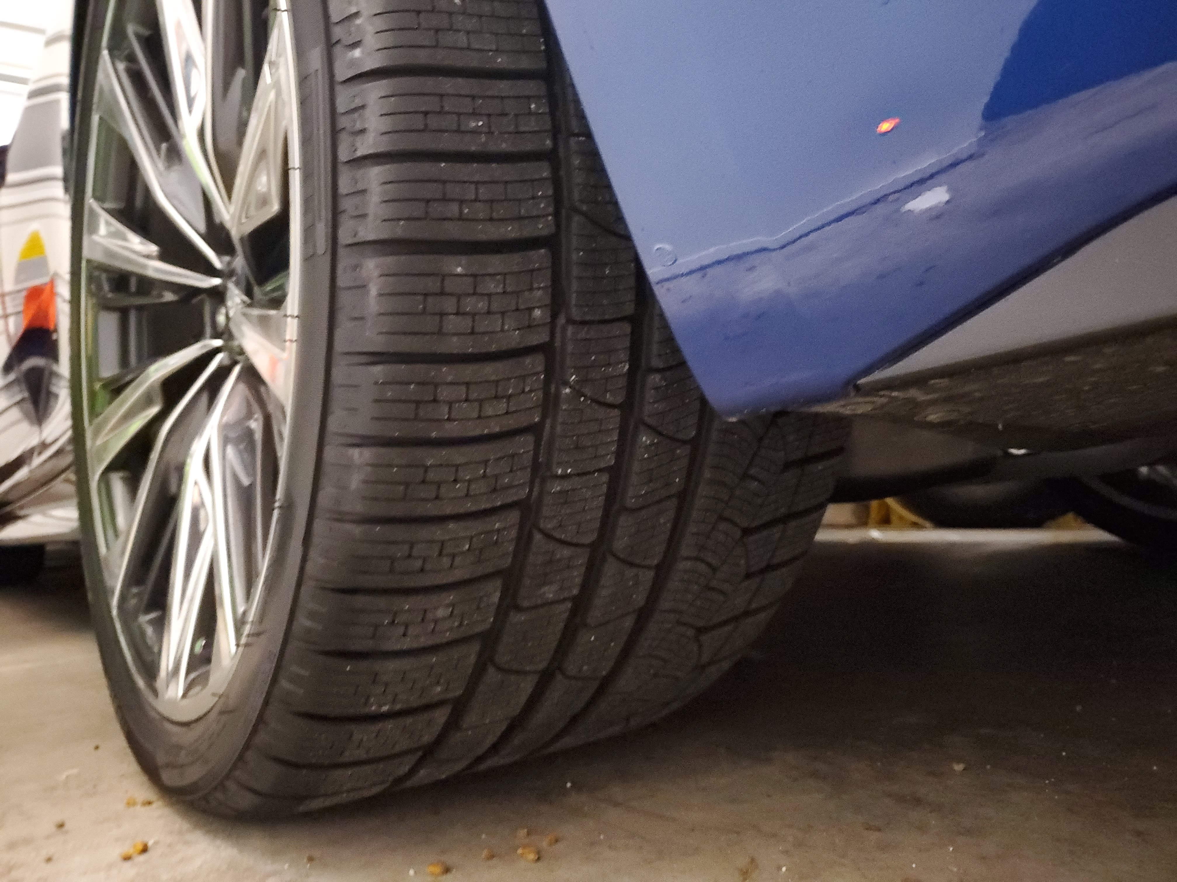

The 295s fit in the rears fine. I ended up getting 265s for the front.

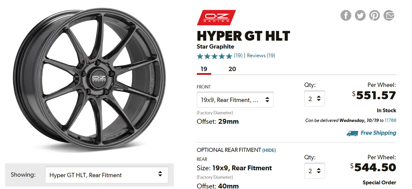

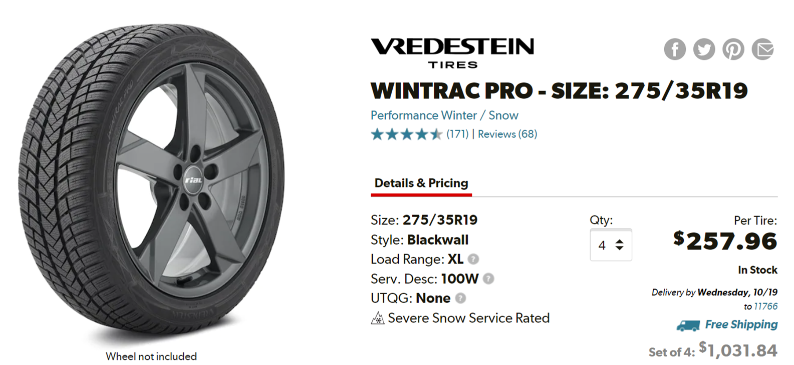

I think I am going to go with this set up...if anyone has tried this could you message me? Dealer said they would not install it since these are aftermarket. I have installed a square winter setup on my V2 when I had it back in 2012.
I'm going to be doing the same (+/- optional rear fitment). I got a guy right around the corner from me to pop them on.
Actually tire rack said if I am going with square fitment I should not go with optional rear...so same wheel front and back (19x9 ET 29) with 275/35/19. Also the only option in the rear that showed up was 19x10 ET 32 ...
Good wasnt even thinking it until I saw it on yours... and would have checked with them first. They were great with both of my ss winter set ups.
