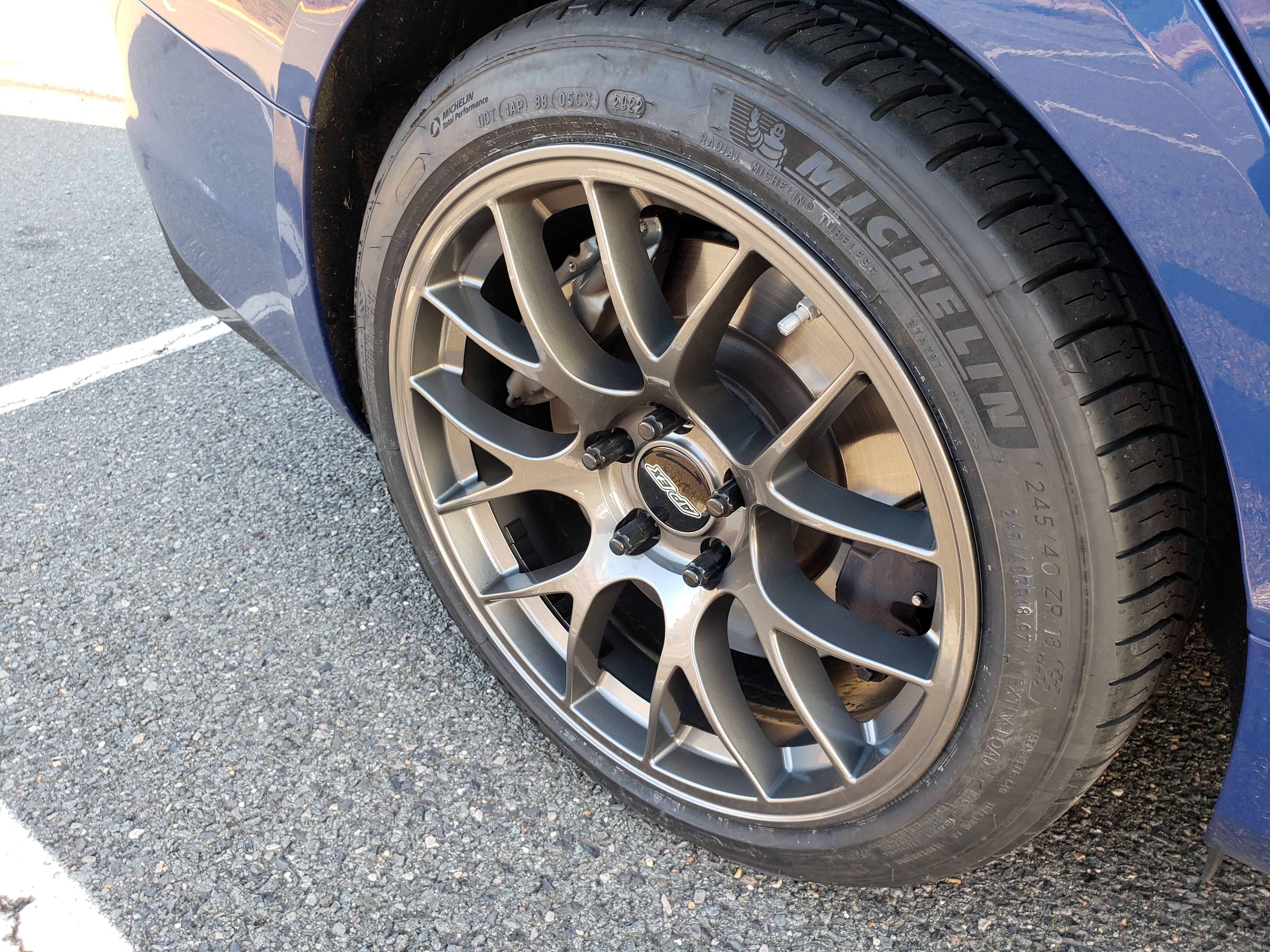

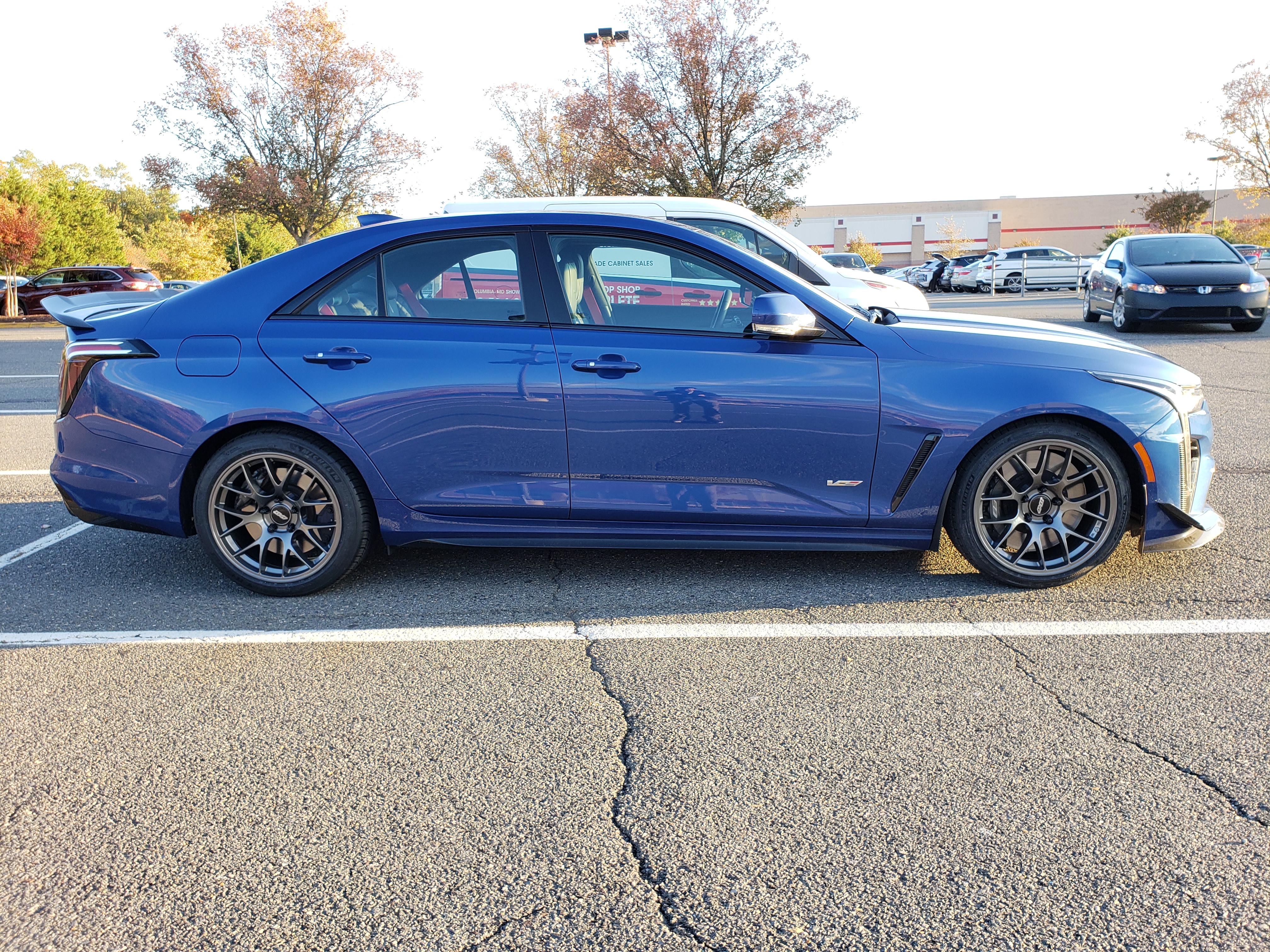

Hey everyone, new to the forum and kind of cross posting from Cadillac Forums, but figured that I would share my 4BW winter setup with you all :)
I opted to get 225/40 on 9" and 245/40 on 9.5" Michelin AS4s, with Apex wheels. I got OE TPMS and had no issues relearning them. These tires are skinnier with higher aspect to maintain OE diameter, so shouldn't mess with the wheel speed at all.
Heres the parts list, also NEVER BUY FROM GMPARTSDIRECT!!! Get the TPMS sensors and nuts from RockAuto!!!!
Wheels, spacers, lugs, TPMS:
The 3mm spacers are for the fronts to bring to OE offset
TPMS Module PN: 13538760
TPMS Nut PN: 13581557
Tires:
Let me know if you have any questions!!!
Obviously the tires are skinnier, less grippy, and it's cold, so grip is slightly reduced in hard turning and hard accel. Car still feels balanced and maintaining OE diameter is great. Skinnier tires are a bit better for inclement weather too. Overall for daily commute, driving experience is unchanged.

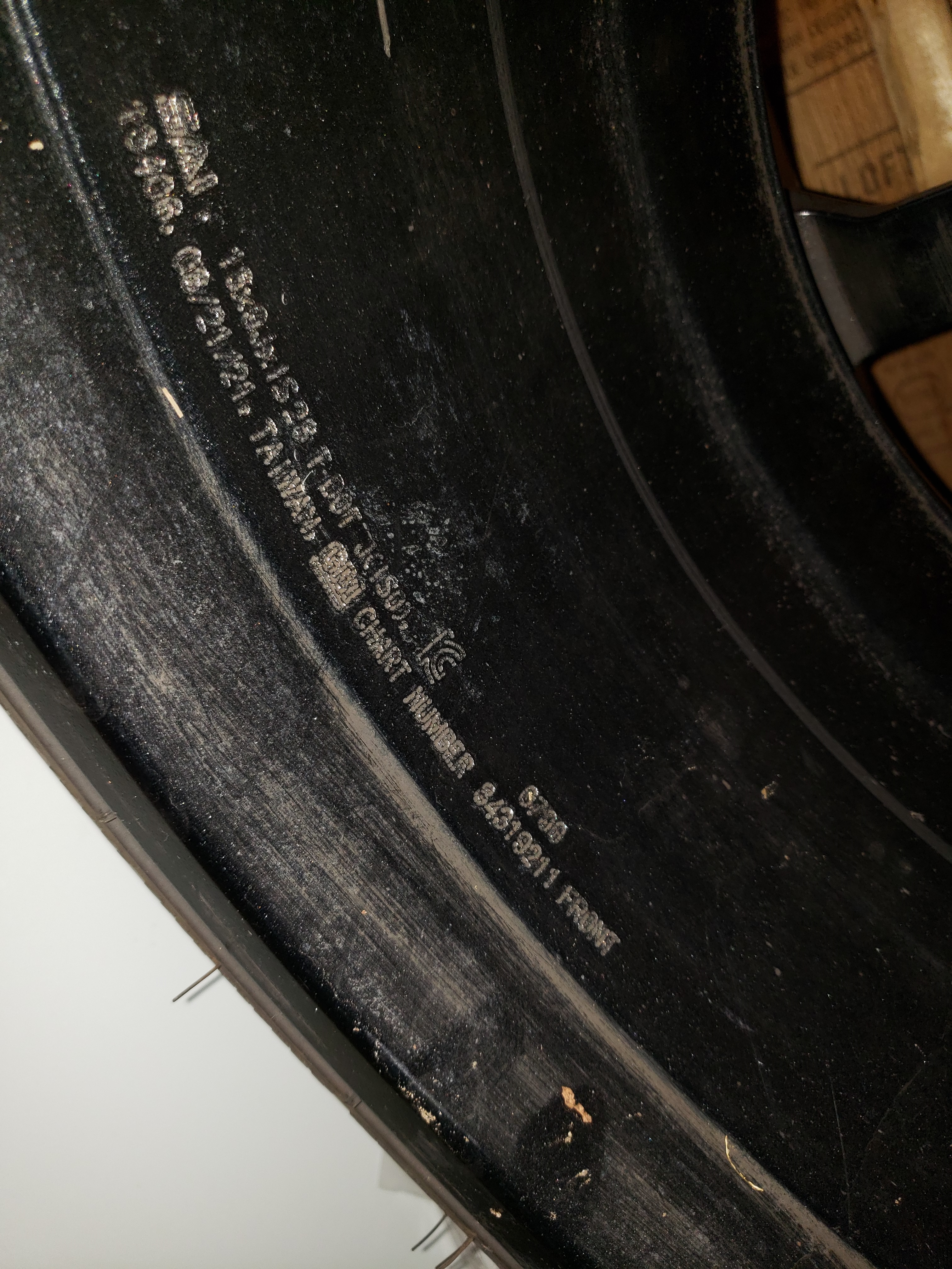

Also included are pictures of the markings of the OE wheels
OE Specifications:
– Center Bore: 66.9 mm
– PCD: 5x120
– Wheel Fasteners: Lug nuts
– Wheel Tightening Torque: 190Nm (140ft-lbs)
– Thread Size: M14 x 1.5
– Trim Production: [2021 .. 2022]
255/35ZR18 94Y 9Jx18 ET28
275/35ZR18 99Y 9.5Jx18 ET48

Great post and info. A few questions as I am considering the exact same set up.
Are those the bronze finish? Did you run this all last winter? Why didn't you go 9" in the rear with a 245 tire?
Thanks!
Thanks!
Nope! Those are the Grey/Anthracite finish. The rears didn't come in Bronze unless you get the forged ones. This is the first year that I am running this setup, and I wanted to be as close to OE wheel size/offset as possible.
If the 255/275 35 AS4s were available/in stock, I would have bought those instead. Winter in NoVA is not particularly harsh.
The 225/245 40 tires are at the "maximum recommended wheel width" from Michelin, are XL rated, and maintain overall OE diameter by <1%.

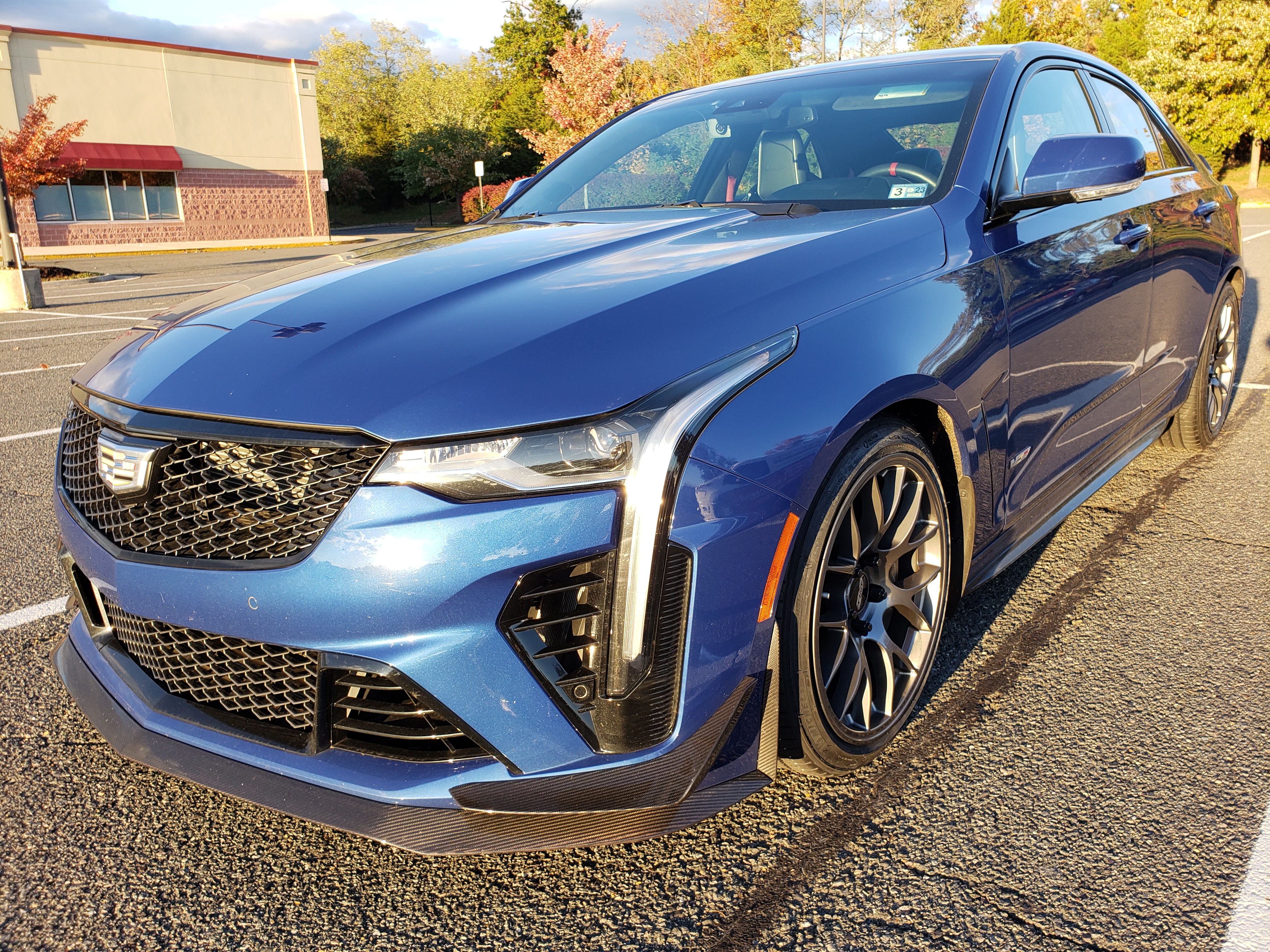

Same wheels as Novakin, but Conti DWS06 plus in 255/35 and 275/35. I have another vehicle for the small amount of snow we get so I opted for a/s instead of dedicated snows(since there were no good choices anyway). The rears don't have xl load designation, but for mild winter street use it shouldn't be an issue.

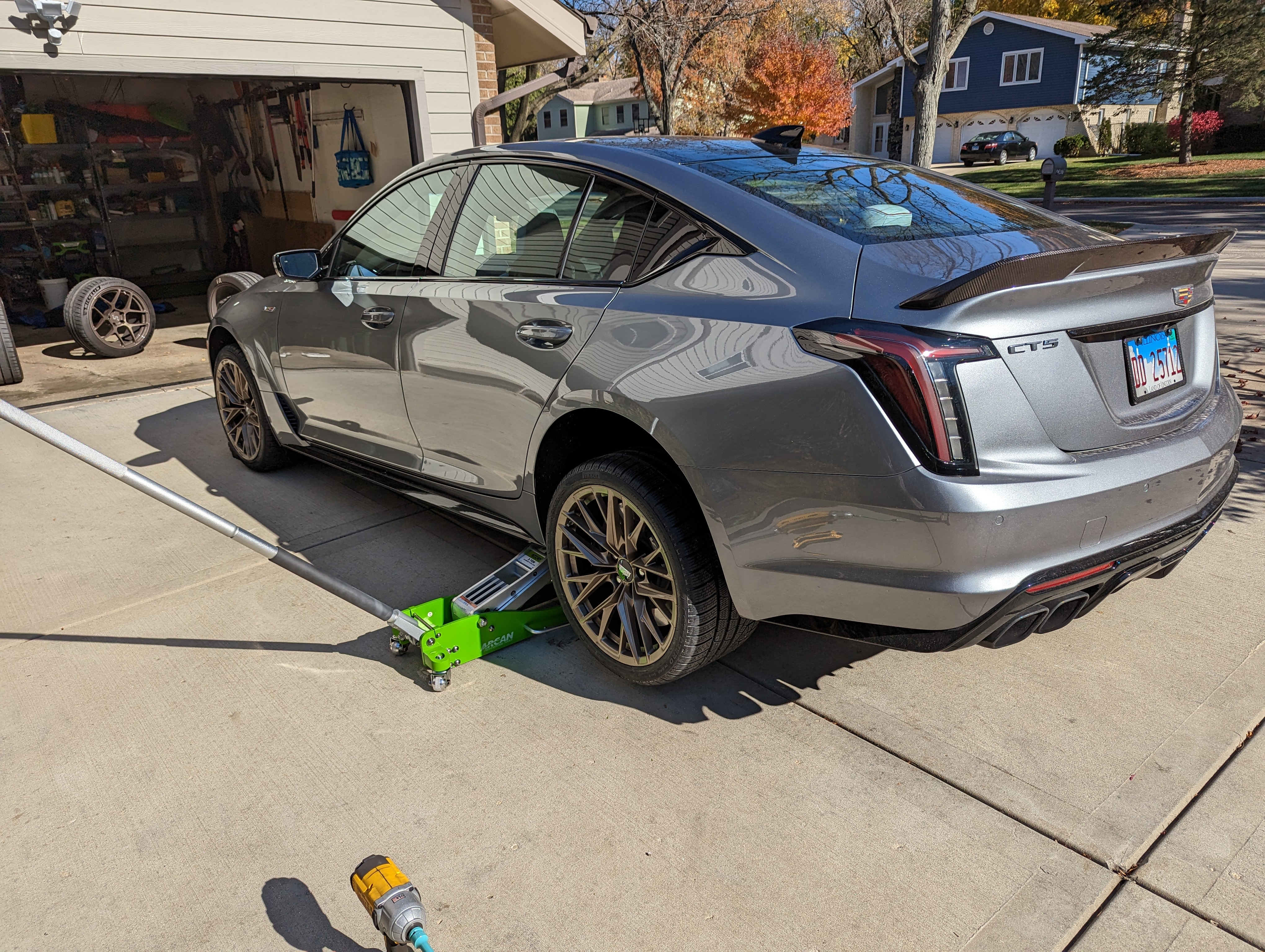

Update, after some hemming and much hawing, I opted to go with the the Michelin Pilot AS4's, 255/35/18 in the front and 285/35/18 in the back, since the 275's are unobtainium until well into the winter.
Very initial impressions are positive. They are noticeably quieter and more comfortable than the PS4S's, though the steering did lose a little bit of sharpness. I will say that - especially in the rear - they appear a good bit chunkier than the stock tires and are a bit less aesthetically pleasing in general, but they're also dirty and have that tire mounting goop on them so I'll reserve judgment until they're cleaned and shined up.
For those wondering, the 285's fit the rear wheels perfectly and the tire guys at Costco (who were all very excited about the car) said they had no problems mounting and balancing.

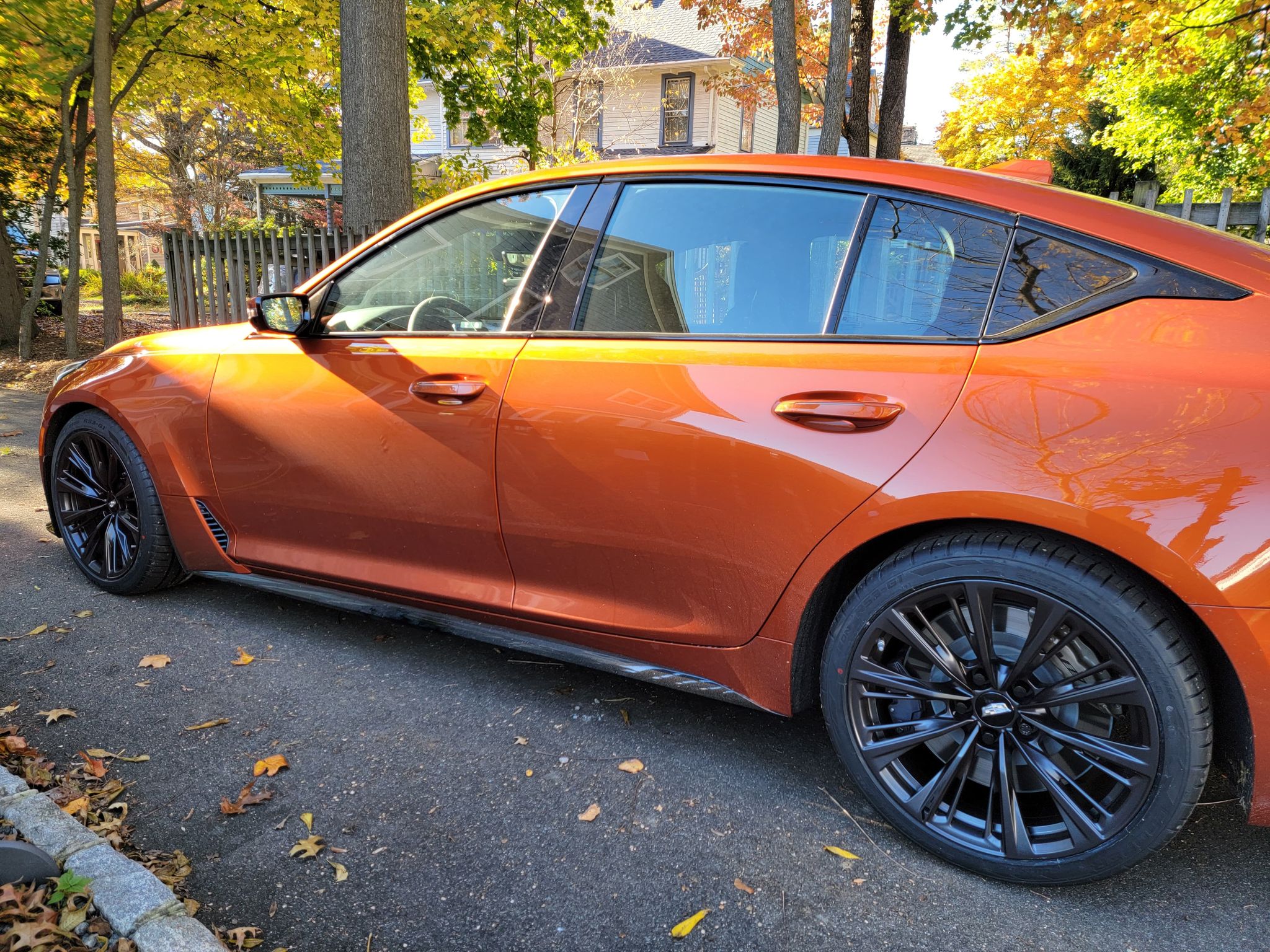

I was thinking of putting all seasons on my car (cooper tires) but decided to go with snows. As I posted before I went with Vredstein Wintrac Pros 275/35/19s square on OZ 19x9 hyper GLT wheels from tire rack. I probably put them on too soon (temps in mid 50s here but had dropped into high 30s last week) but they are working quite well with this car. Dry grip is great and wet grip is decent. Since the contact patch is less in the rears the car feels more squirrelly (kind of enjoying that a bit actually). With moderate throttle it is okay actually, turn in feels a bit less stable but that is to be expected with winters and narrower contact patch. Will provide an update on how it feels in really cold temps.
