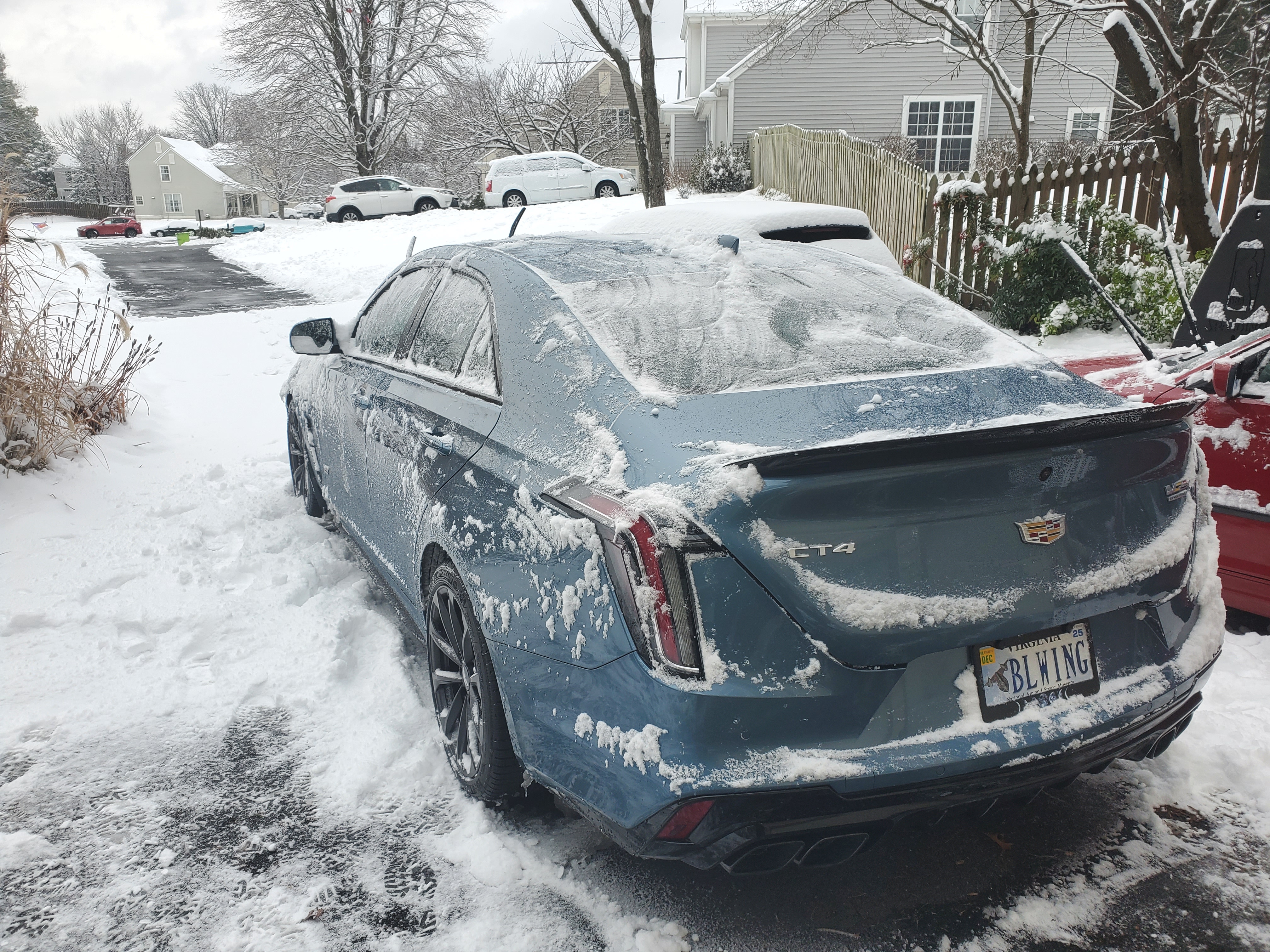

Swept snow off of it...drove it a bit in the snow yesterday...

Heh. Your license plate says blowing.
The other day my neighbor was looking at the car and asked - Whats a Bluewing?
Maybe he remembered that my name for the Audi S4 was the Blue Streak....

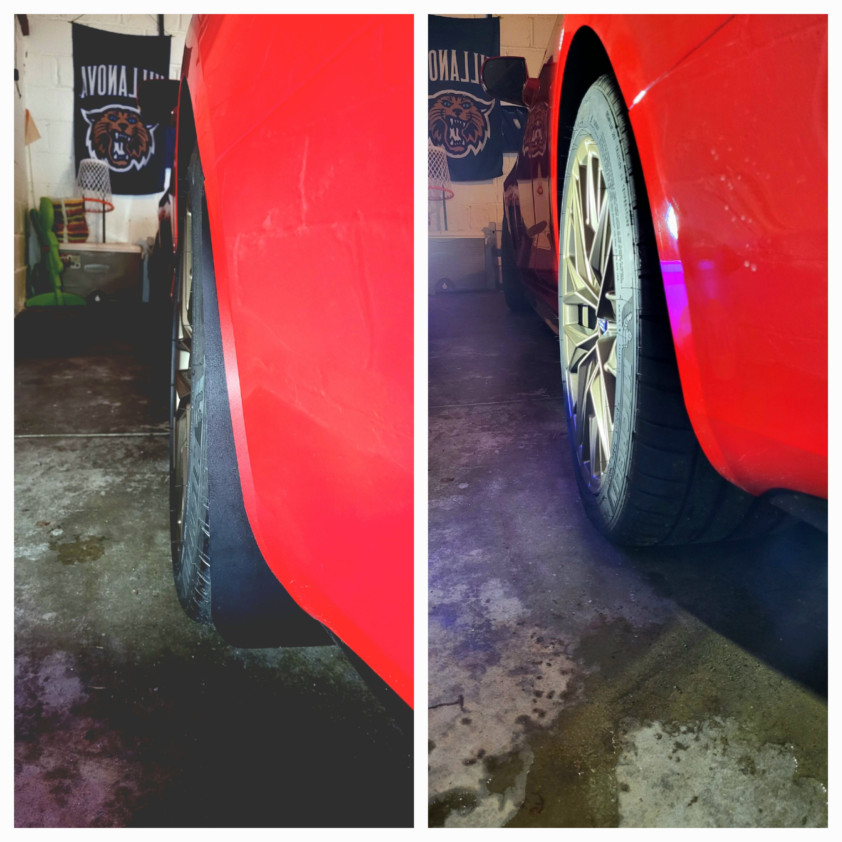

Installed rear rock guards by ZL1 Addons. Installation was pretty straight forward, but not taking wheels out added a small amount of challenge. Nothing, though, a wrench and fingers could not address 😅
Guards match the front ones well! Looks like car came like this from the factory.

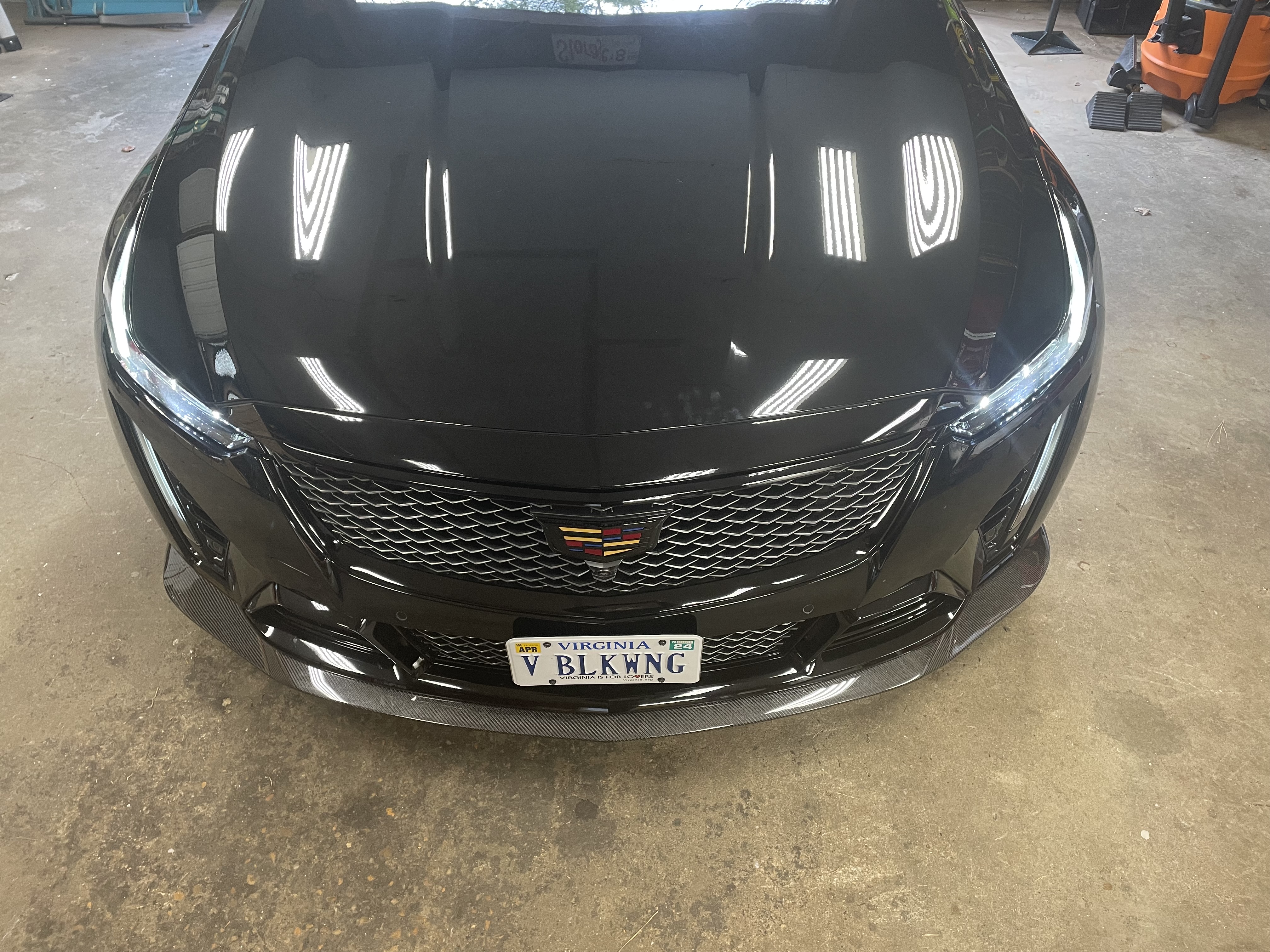

Decided to give this OE replica front splitter a shot. Made by Anderson Composites. Great fitment and the carbon seems good. Good option for any 5BW owners that didn’t get the CF1 package. (Way cheaper than sourcing the OE splitter and side wickers as well).
