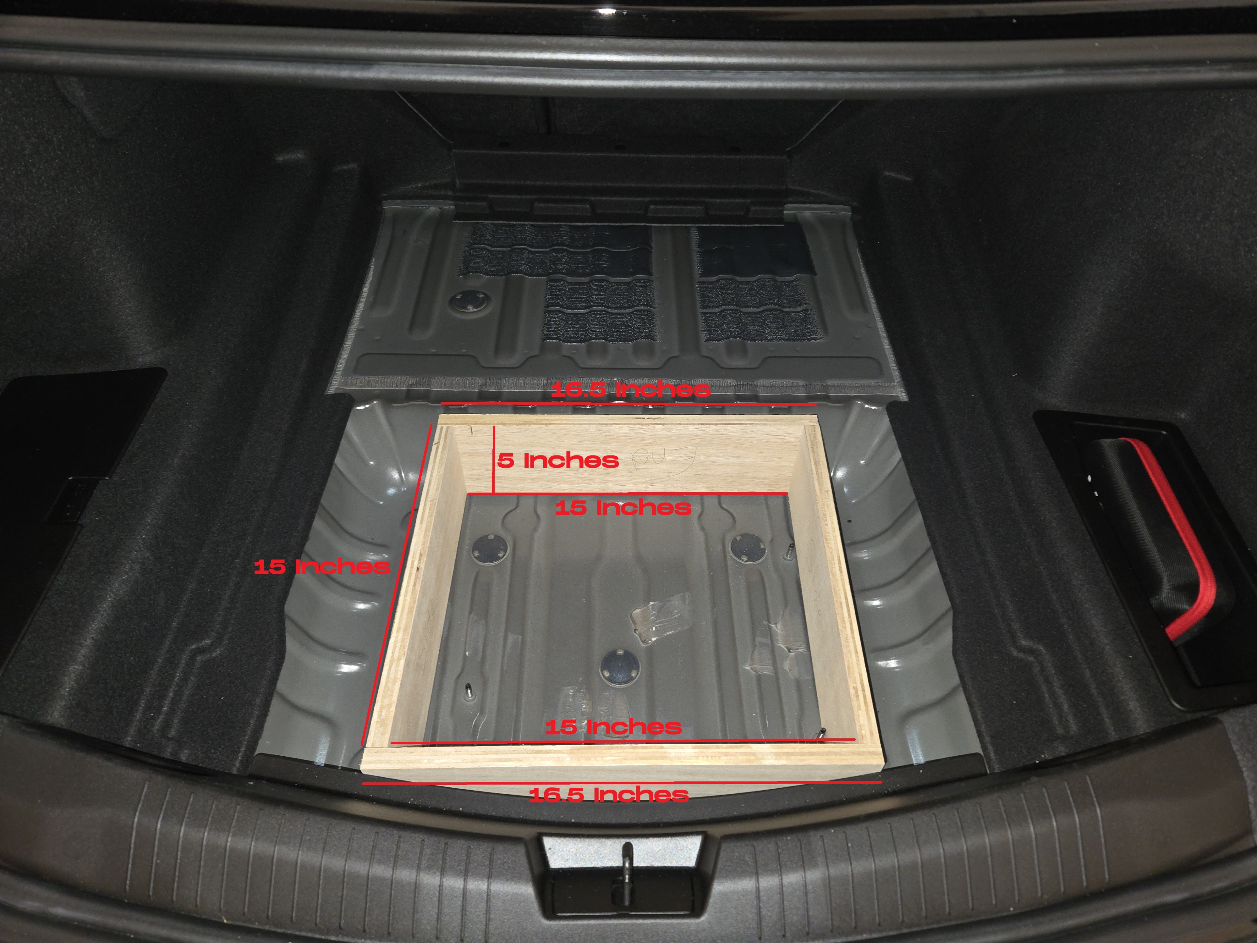

Step 1 was to measure what I was working with. I had length, some width and not much height.
Sub is 4.61" deep and requires about .65 cubic feet for operation
Building with 3/4" wood (I usually try to find birch for its cut quality and density.
I knew my height on the box was to be about 4". So my length and width needed to shift.
Max width (front to back ended up being 15". Sides I ran to 16.5 to cover the 3/4" thickness of the wood (that's what she said)
So I bumped the depth by an inch to 5".
Final Measurements are 15 long x16.5 wide (makes the box internally 15x15) and a 5" depth. Divided by 1728 for cubic feet =.651 cubic feet.
(15x15x5 = 1125 internal cubic inches)
(1125 cubic inches / 1728 cubic inches in a cubic foot = .651)

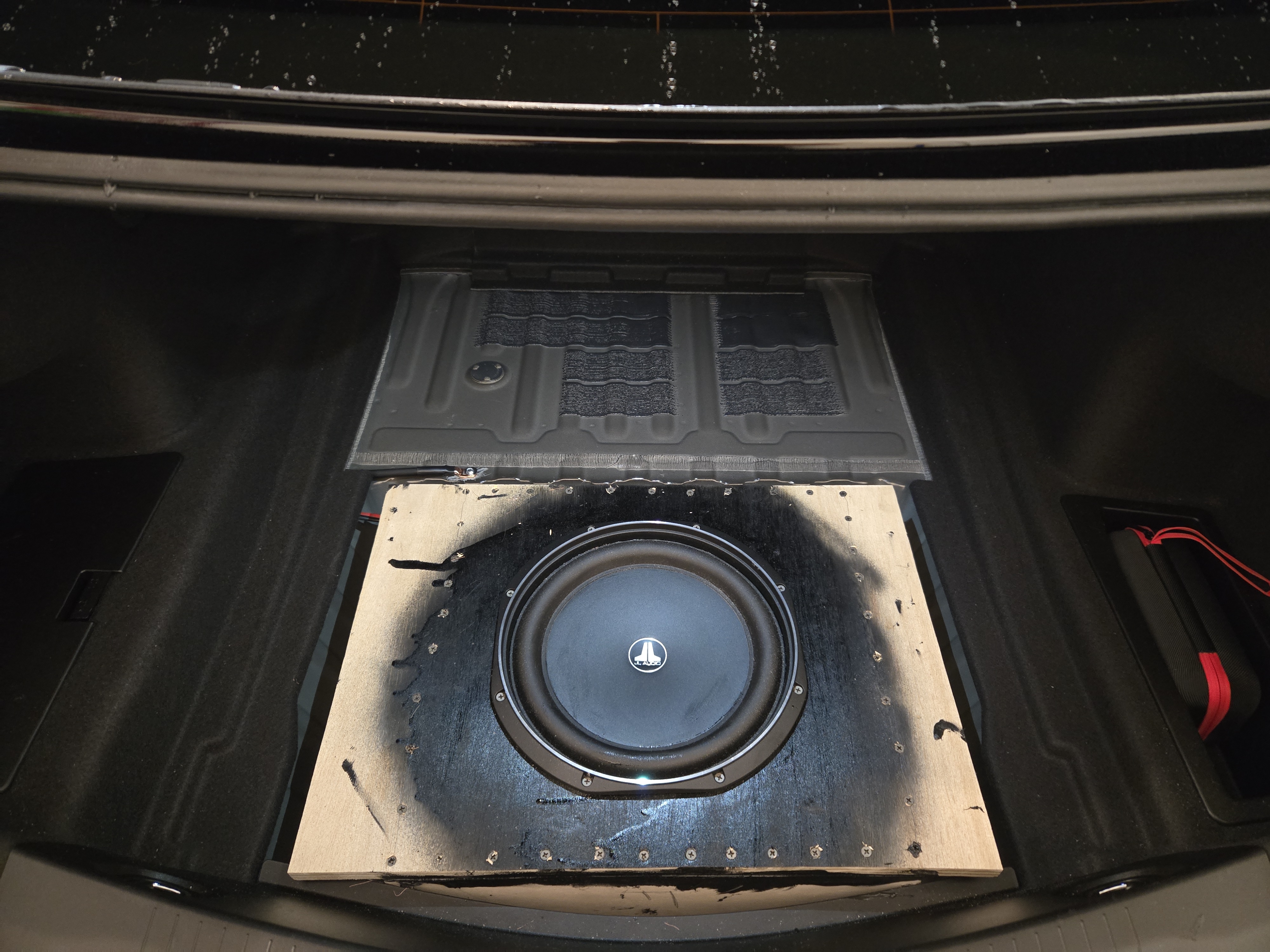

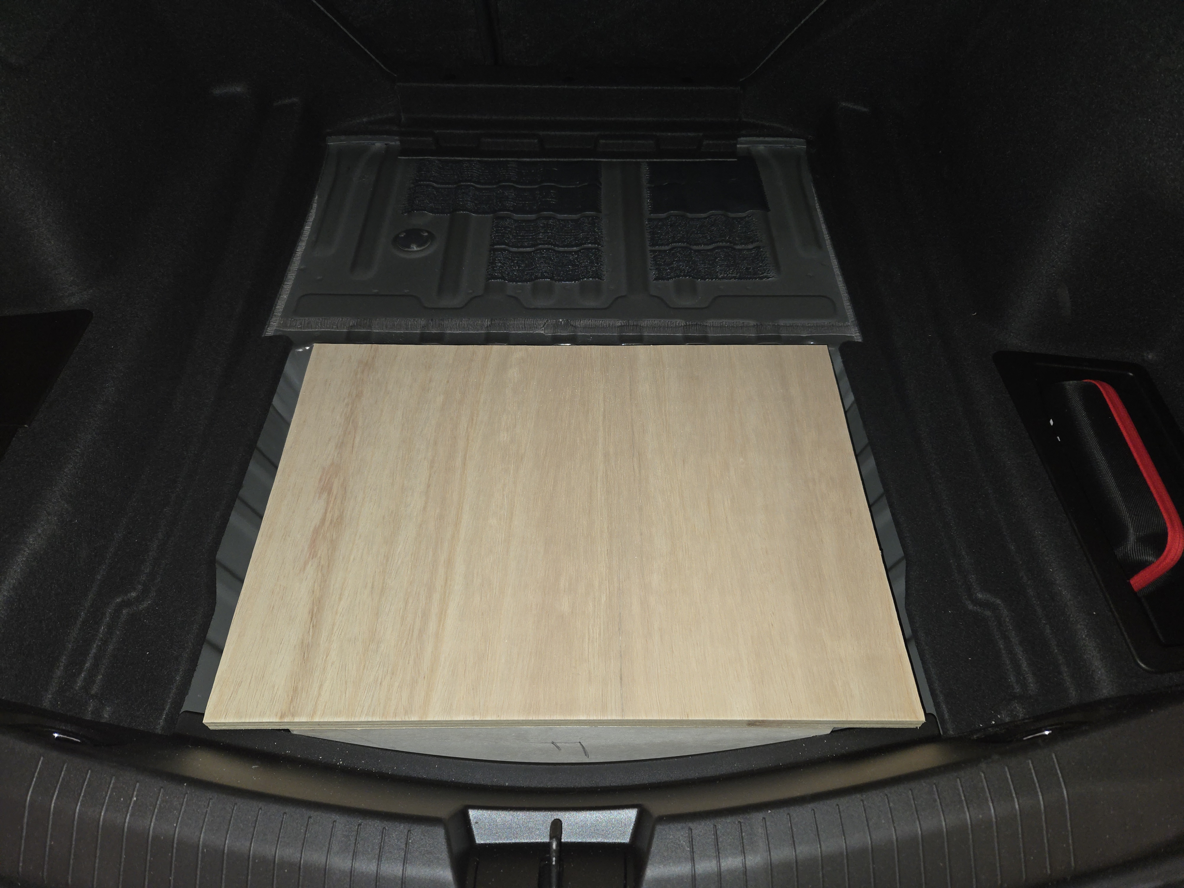

Next, cut the lid. And since I knew I was going to do a cover panel and didn't want cover panel screws to puncture the enclosed airspace and didn't want the gaps on the left/right to be flimsy under 1/4" cover panel, I extended the lid to 20" or so I think. I measured and centered it, just don't recall the size off the top.

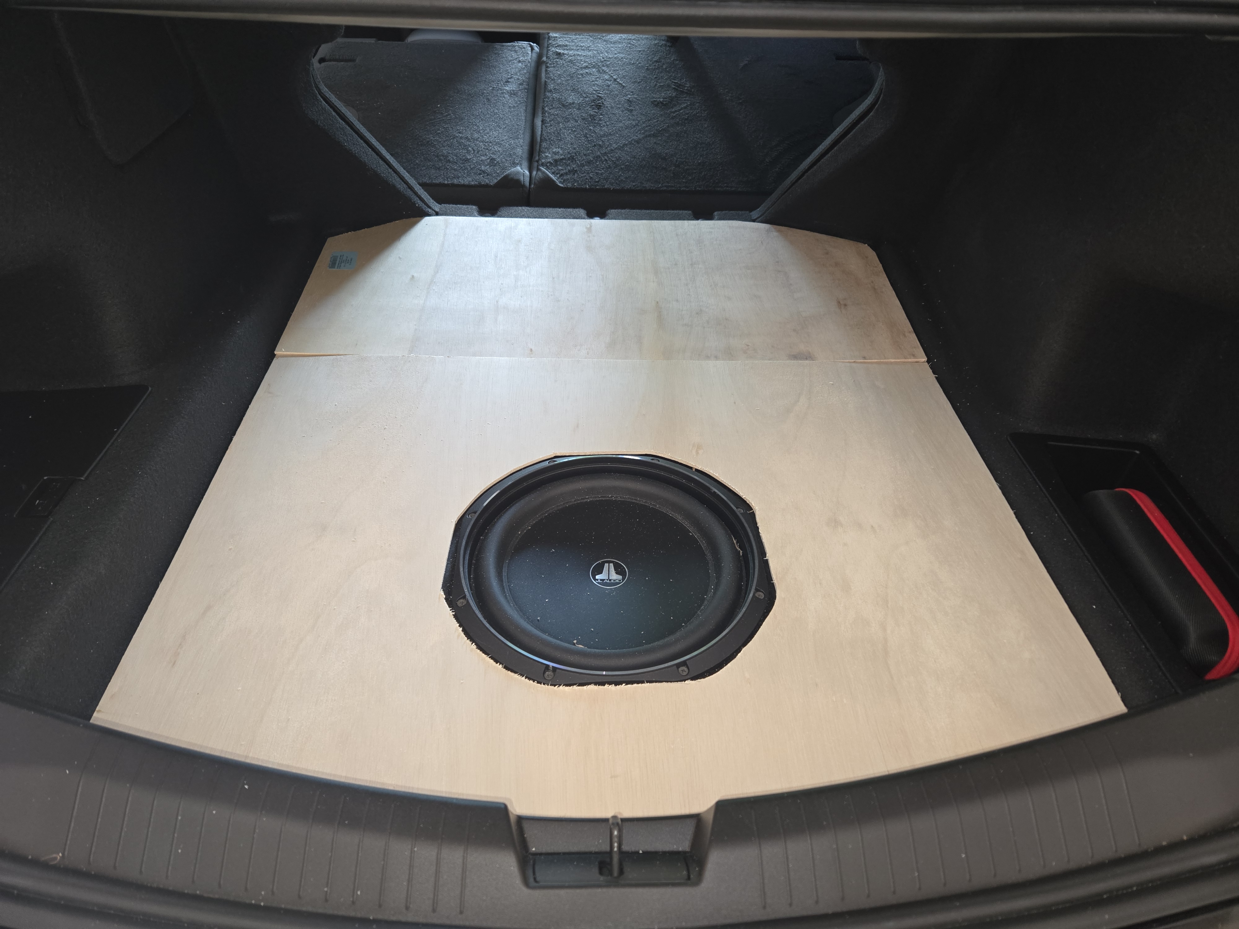

Next, cut the sub hole to make sure the depth was good to go before I secured everything. You can see my centering mark below the sub that lines up with the trunk latch.

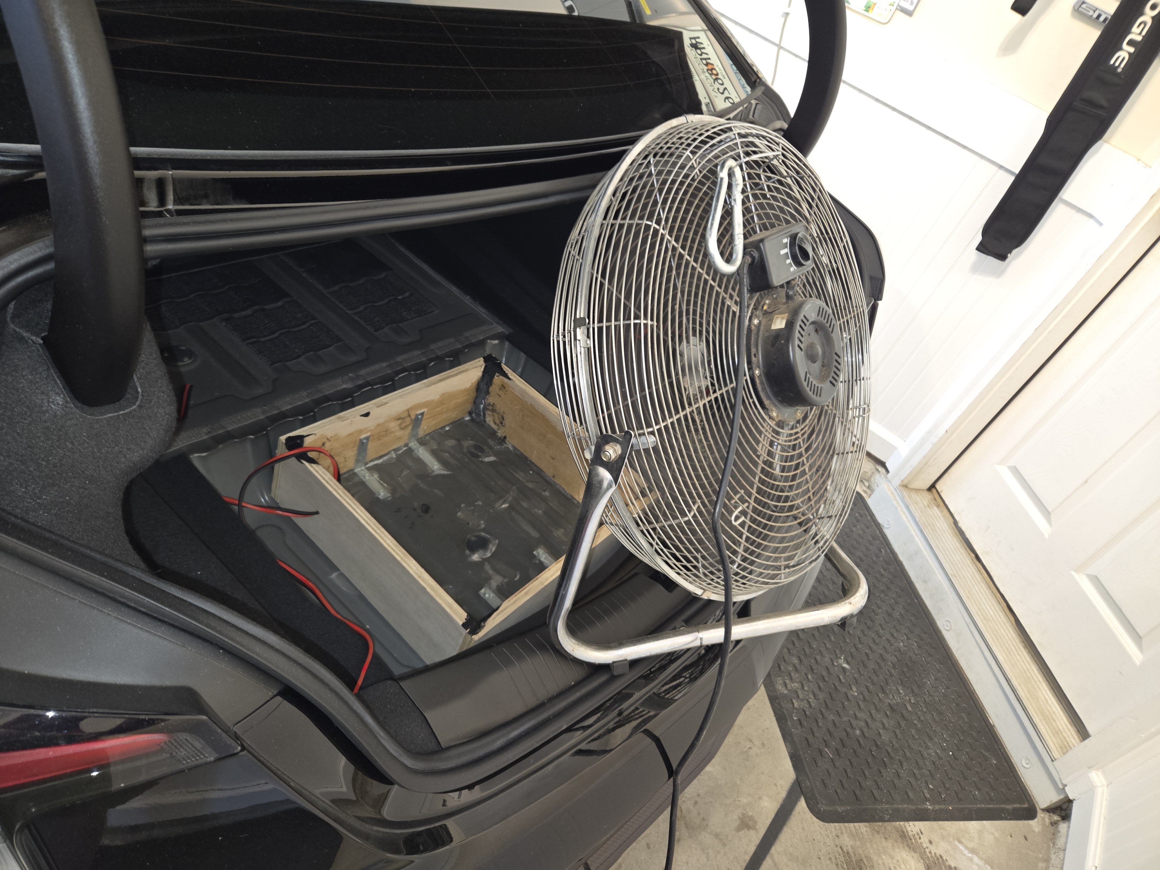

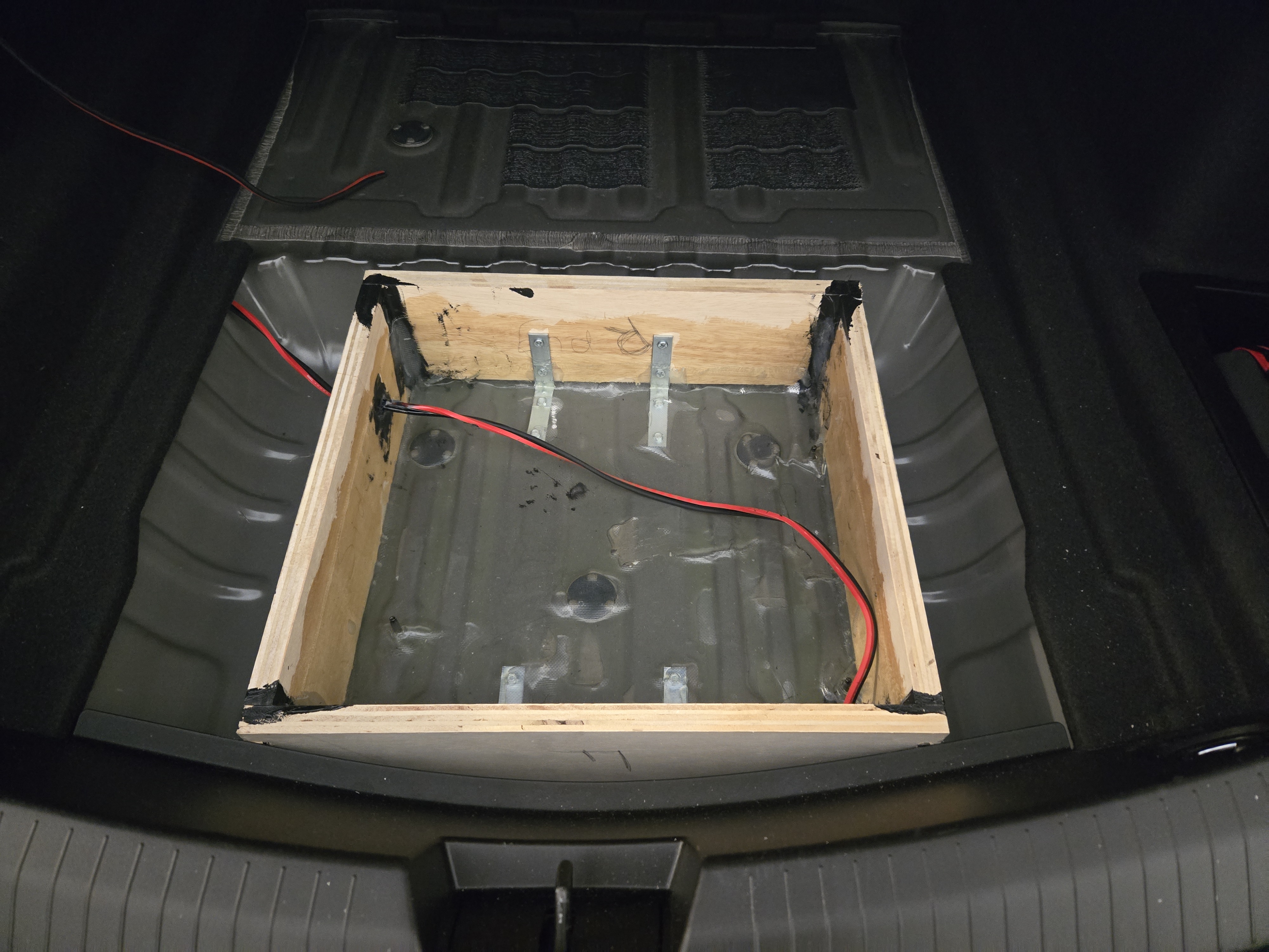

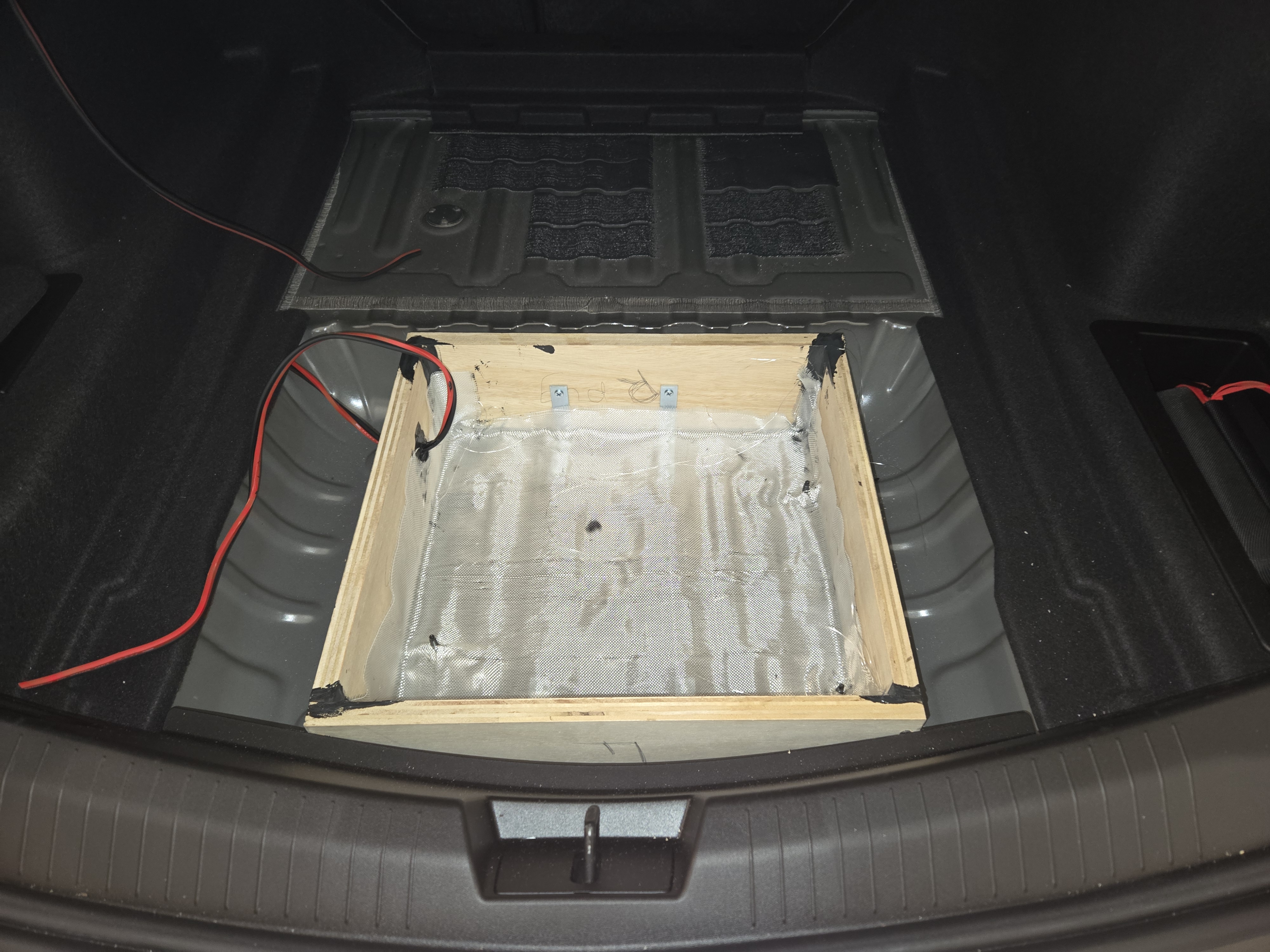

Next, I went ahead and assembled the 4 sides with 1 3/4" drywall screws. If you want to use longer screws you can, I'd recommend predrilling and/or buy a bar of soap and run the screw threads along the bar of soap. Helps them penetrate/seat deeper/easier. Then caulked up the 4 sides of the enclosure and drilled/sealed my speaker wire hole, knowing everything was to run on the same side of the car. Mounted the box in with 2" L brackets, self tapping 1/2" screws to the bottom of the car and just wood screws in the other pieces. I don't have a good pic of this, but you'll see it after the first layer of fiberglass. Then just cut and layed in the first layer of fiberglass.
****WEAR A RESPIRATOR FOR THIS AND OPEN DOORS****
Next, I mixed the resin and hardener and painted it onto the fiberglass layer, making sure to brush up towards the lid/top to make sure I'd get a good seal. Just make sure it's got coverage. Then leave the doors open and I put a fan on it to help it dry, but it sets up better if you have some kind of a heat lamp. I did this on a kind of cold rainy saturday, but if you can do it around 80 degrees it will set up nice.
I only did 1 layer on this because it set up nicely and looked really solid after one pass. Here it is dry, and you can see the mounts I used to secure the enclosure
Then, since I'm only carpeting a cover panel, if the cover panel isn't perfect, I spray paint around the sub opening, so it's not obvious if there's an odd gap in carpet. Paint will hide it enough for most peoples eyes.

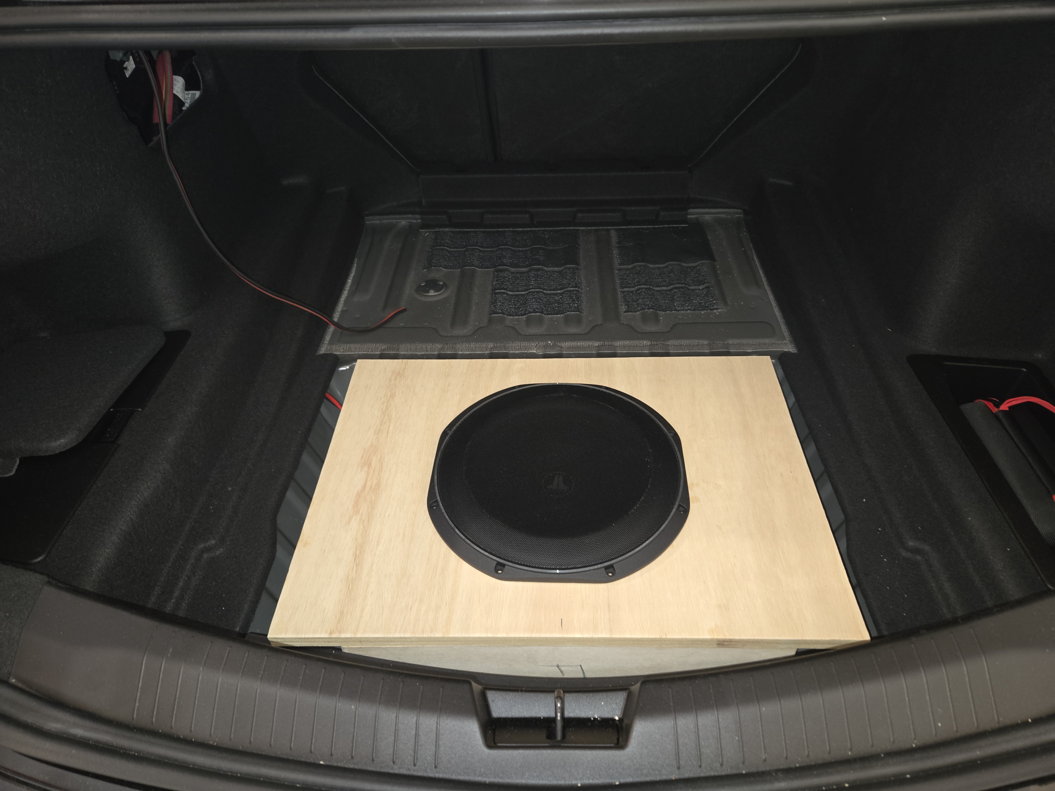

After this, put a layer of caulk around the edges of the enclosure and center/fit your lid, then screw it down using 1 3/4" drywall screws. Clean up the caulk that overflows the edges inside/outside so it's smooth and sealed and let that dry.

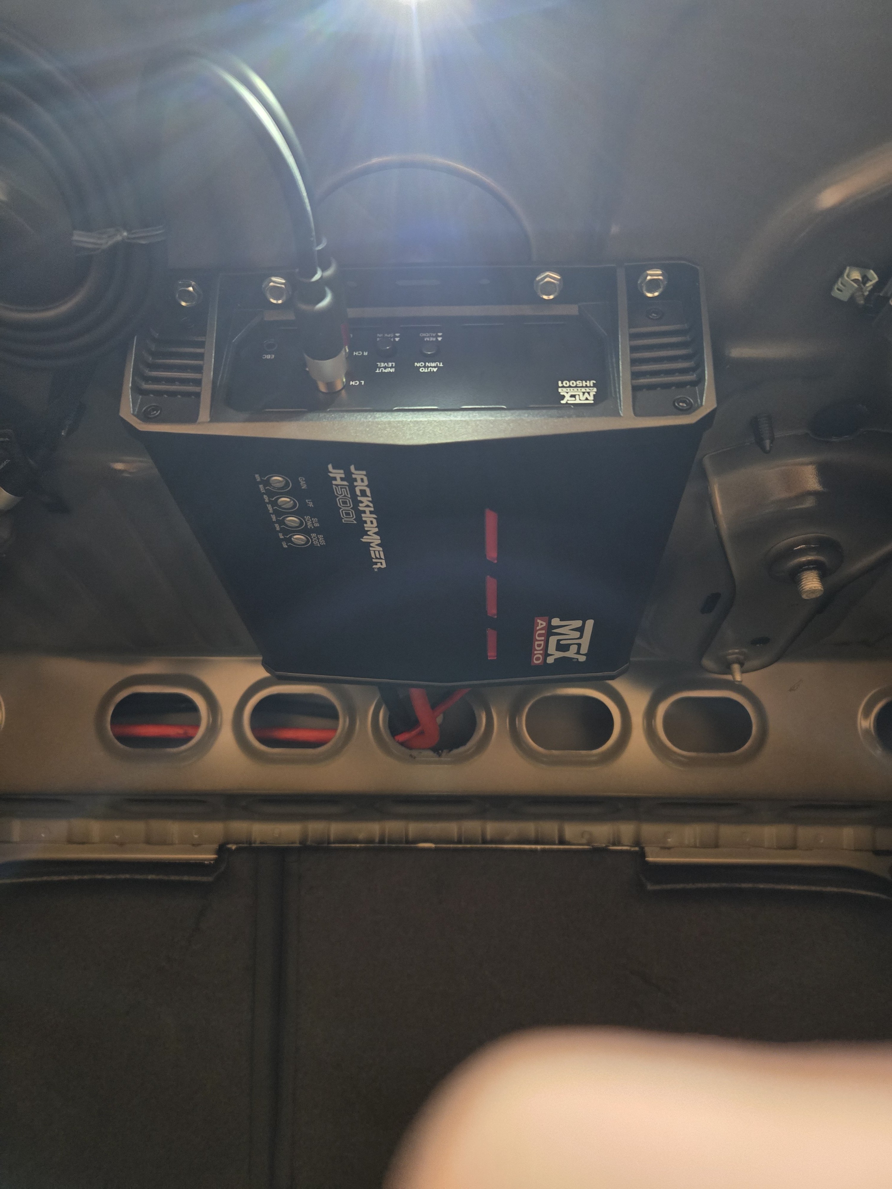

Ok, this looks pretty fugly, I agree. But hang in there lol. Next I mounted the amp. I was going to flush mount this too, but everything was running so shallow and tight to the car I looked upward and decided to mount it in on the roof of the trunk. There's about 1.5" clearance in most places and a fabric between the deck lid, so I used 3/4" self tappers and it's secure, no danger in any screws coming through the deck lid. Side note, I did tape around the edge of the hole those wires run through (power/ground). Also, for signal input, I unplugged the rear left speaker, cut the harness and wire both left and right channels into the left/right of this line out converter. Then just made sure those connections were tight, taped everything up and reconnected the speaker. I always have 4 gauge wire, so I installed the required 60 amp fuse, 4 gauge wire and was almost done.
Side note, battery is under the left side of the trunk there, so I removed a nut from one of the empty terminals they have, used some 4 gauge ring terminals and set that up. New amps also have signal identification, so there's not usually a need to run a switched power wire (check your amp first for this functionality). So then I just sanded a small 1x1" portion of the trunk and screwed it down. You can see my ground in the picture above, just off the top left side of the enclosure lid. The lid height over trunk floor protects it.
4 Gauge Ring Terminals with Heat Shrink: LINK
Converter for High to Low level inputs: LINK
Next, I tested everything, it all worked first try, so it was time to make it pretty. I knew the cover panel would be 2 pieces, so I went wide with the first piece and figure it would hinge further back in the trunk. Not a big deal, if the carpet doesn't secure it you can come back later and add some kind of a metal brace, but it's 1/4" wood, so I didn't want to rip it up too much.

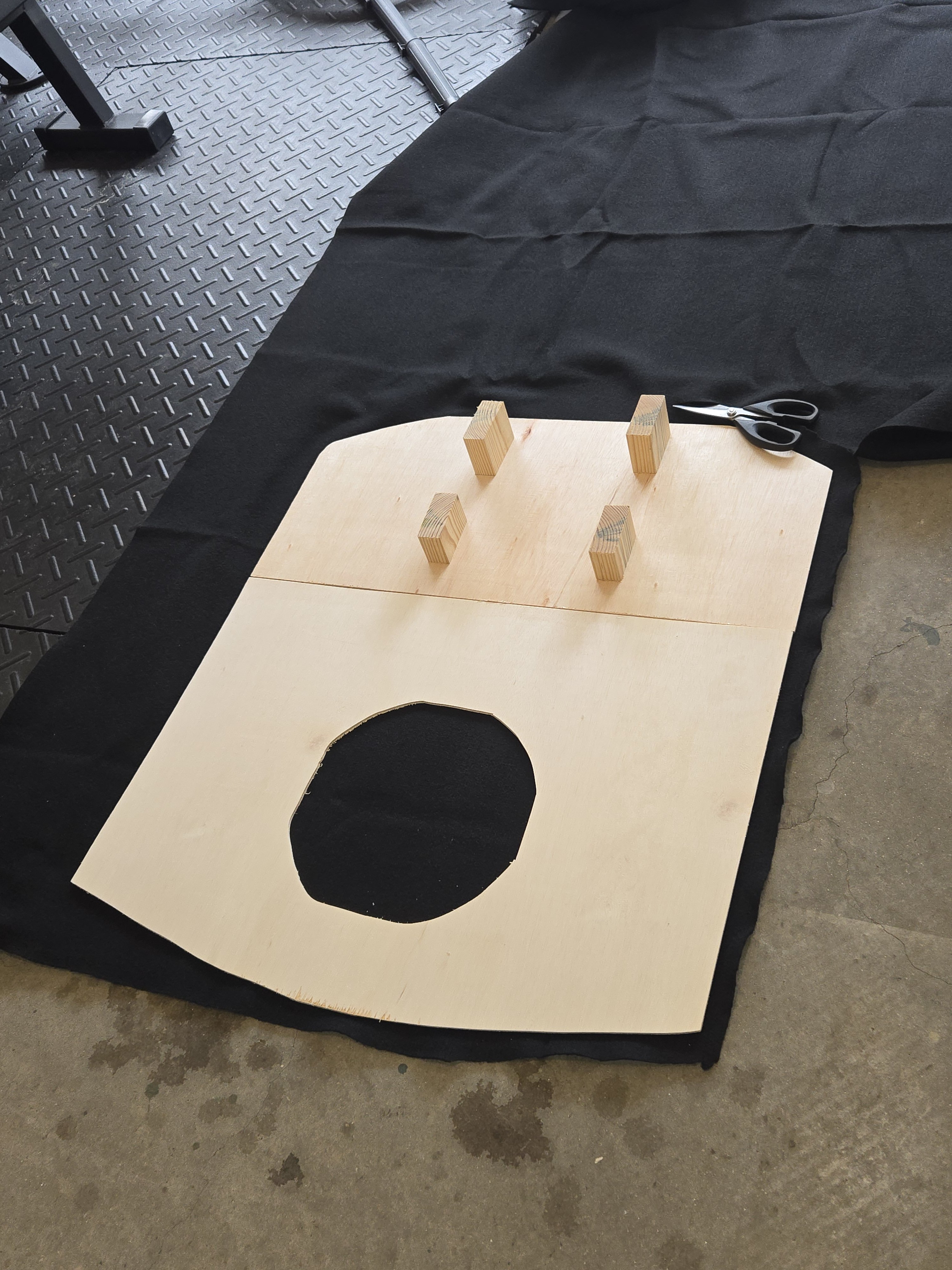

Used cardboard and the factory trunk mat to get angles drawn on the wood, then was off to cutting. This sub has an odd shape, 4 flat sides, 4 rounded sides so I had to guess at my cover panel hole. I did OK on that, the left edge needs a fix, so I'm going to recut the whole thing some day soon. So this is a process of draw, test, fit, draw, test, fit, etc.
This is where the black paint comes in handy for sure. Then I lay it down by the fire (Southpark Chef) and cut the carpet, leaving about a 1" portion on each side.
Worked out braces for the back portion of the cover panel because I want it to be somewhat still load bearing, have weight to hold it down and also be supportive, and since the trunk falls away towards the passenger area, to give it the flat illusion and support, had to cut some of these panels. PLUS, if you look in your 5V trunk, the carpeted areas on the left and right run UPward as it gets to the passenger area, so I wanted to meet that illusion but also cover what the car is doing underneath.

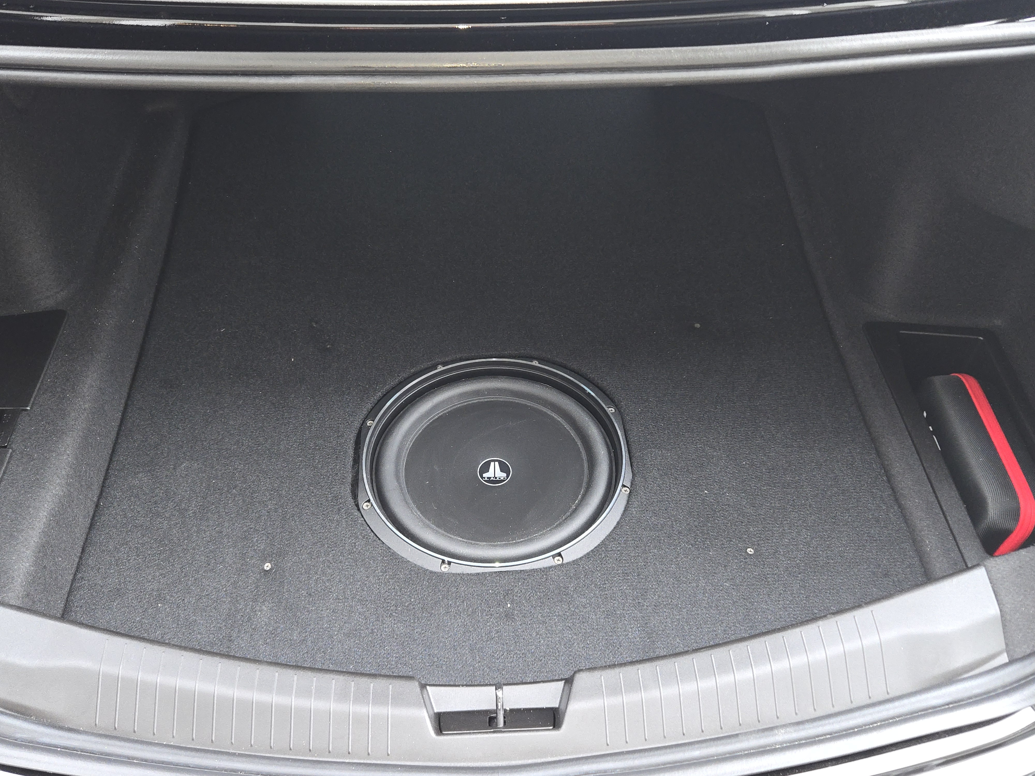

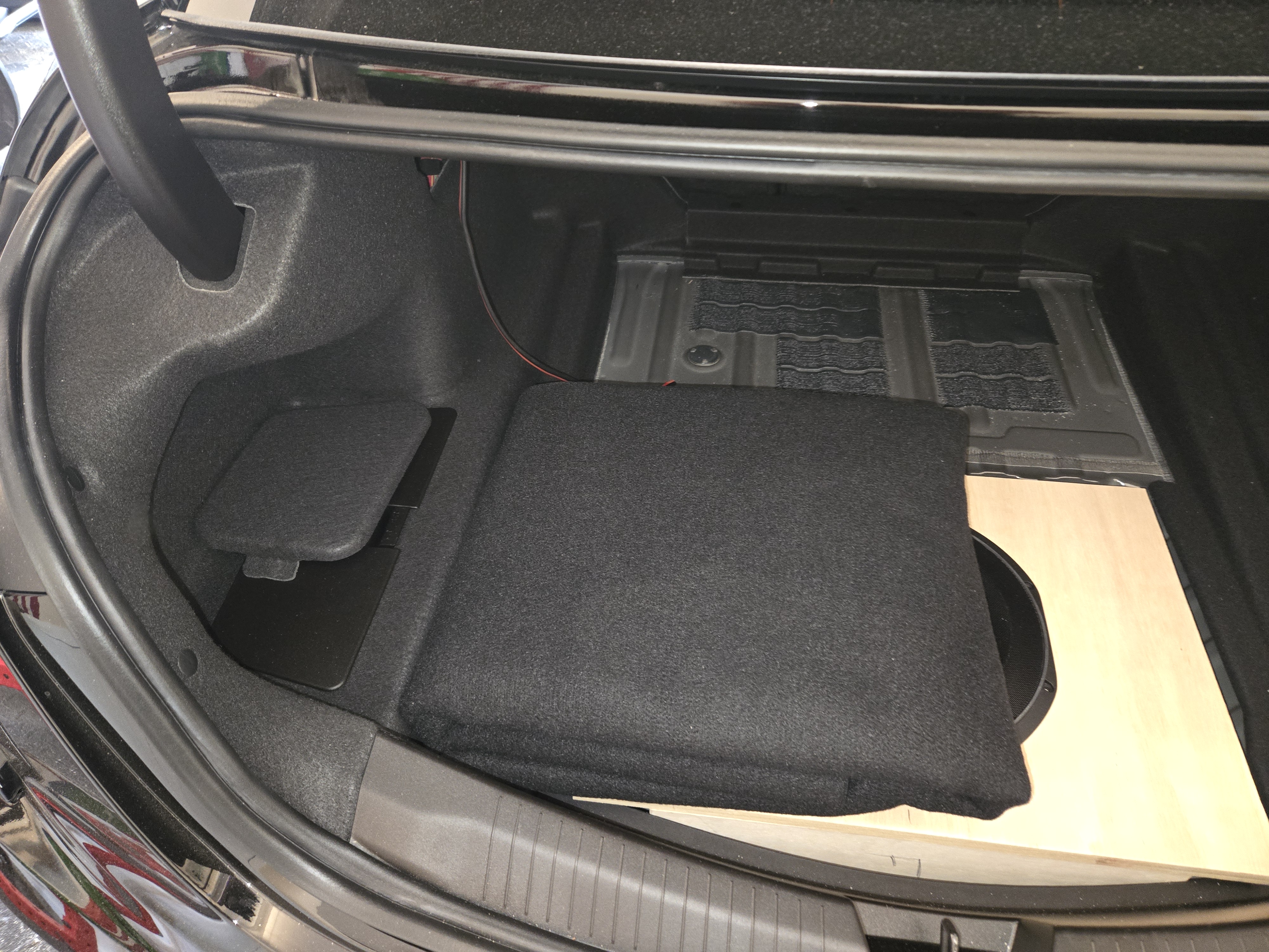

Then, you 3M spray glue the wood and lay it back down on the carpet. Fold the edges up and 1/4" staple them all the way around the edges, cut the sub hole, fold it and staple it all up and you get the final product:
Those 4 screws are in the extended sides of the lid that I left hanging over, but you can't see them now, just have to fluff at the carpet with your fingernail and the screws disappear.
Overall it sounds great, just have to play with the sub settings. I always turn the bass down on the head unit and let the amp and sub do all the work. Set it at 80 Hz low pass crossover and turn the gain up. I never mess with the bass boost or anything, it numbs down the punch. Anyway, there it is, I had some questions about it, so that's the write up.

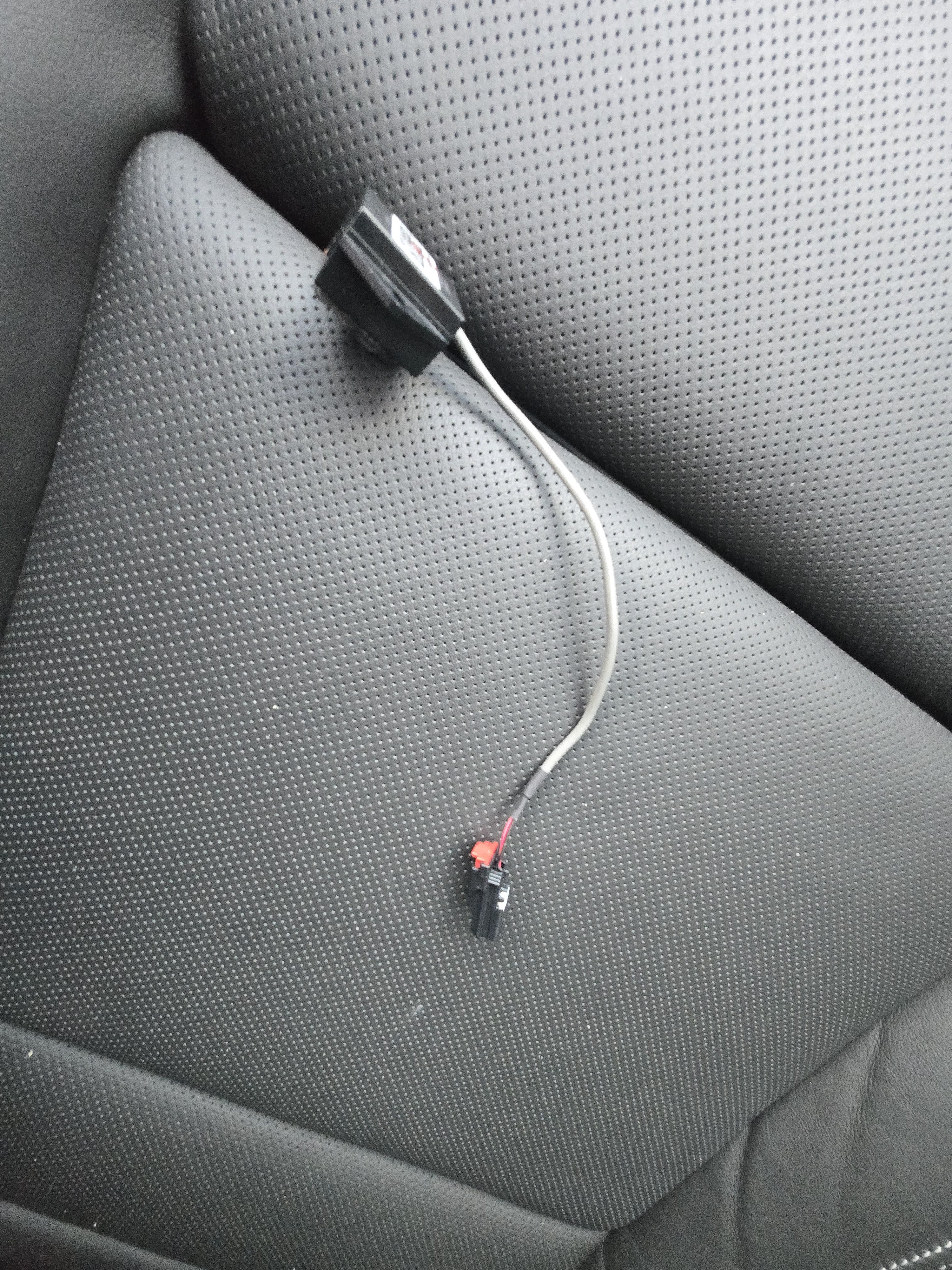

Adding this to this post too: ANC issue solved. I dont like cutting factory harnesses. I also read that on Older Vs if the ANC system sees a fault, it disables completely. There are 3 microphones in cabin. 2 of them are driver and passenger side just over your head, hidden under the grab handle at the top of the door. One is dead center between the 2 rear passengers.

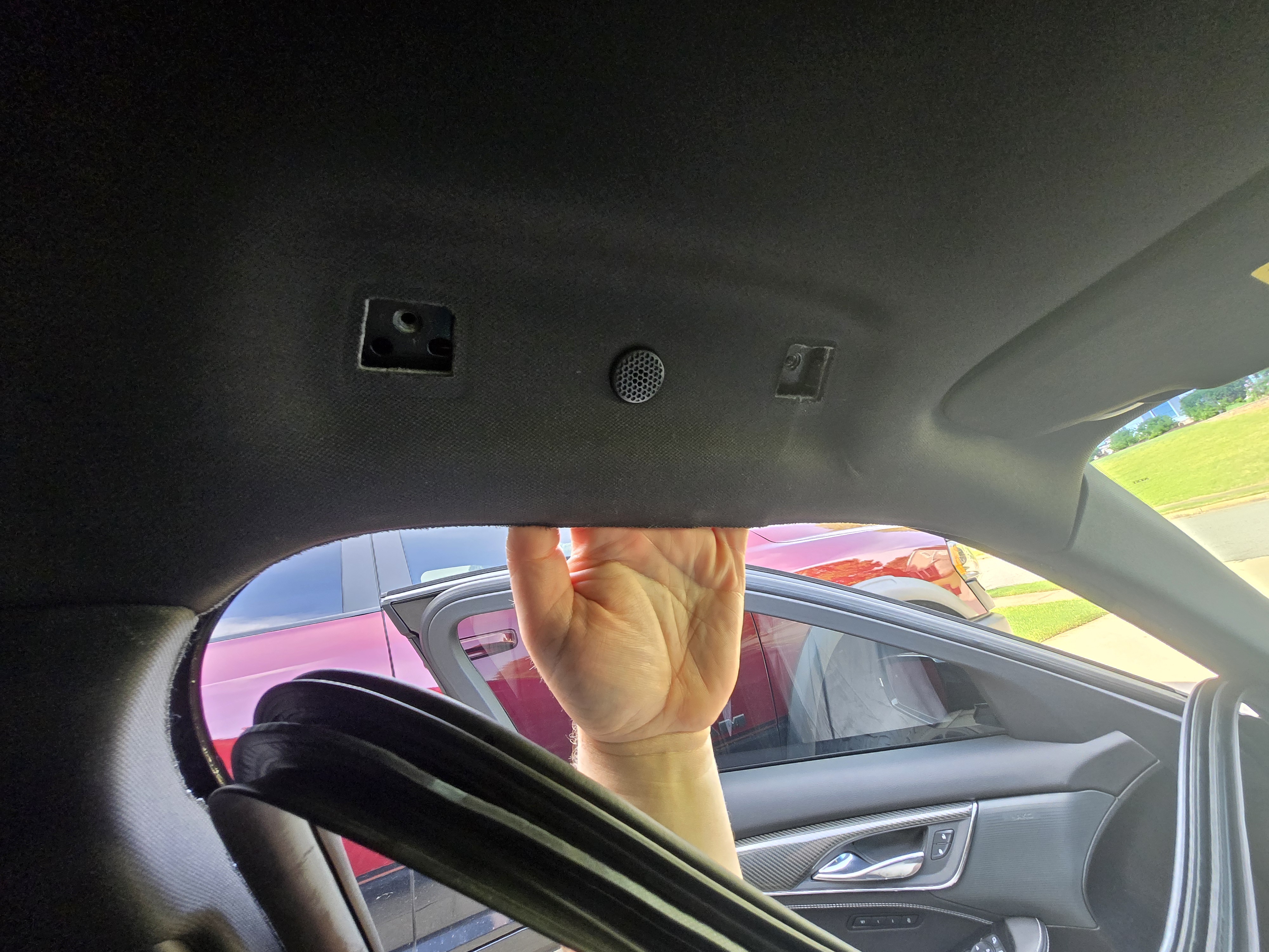

I wanted to remove 1 mic and test. I pulled the rubber door trim down, popped the 2 plastic covers off that hide the bolts on the driver side grab handle. Used a 5/32 socket and removed the grab handle.
Next, I carefully pushed my hand under the headliner and the mic sits in a little plastic cup, it just popped out and I kept gently pulling the cable and found the actual connector this mic attaches to. The mic has about 6 inches of wire then a plastic plug. I rolled the plug gently to unstick it from its adhesive and the gently managed to get the plug to appear in the front of the 2 holes that was occupied by the front of the grab handle. Once there I popped the red lever open and used a screwdriver to gently press the 2 sides apart.
Pulled the mic out, rolled the connector back in the adhesive it started in, put everything back and started the car. No noise from the sub. Took about 30 mins to figure it out, no cutting, easy to reattach later on.

Just did this last night. You'll want to remove the grab handle and sun visor to have enough room to stick your hand in the headliner (unless you've got small hands maybe). Not sure if its working as intended as i havnt had a chance to drive around, but ill probably update my build thread.
