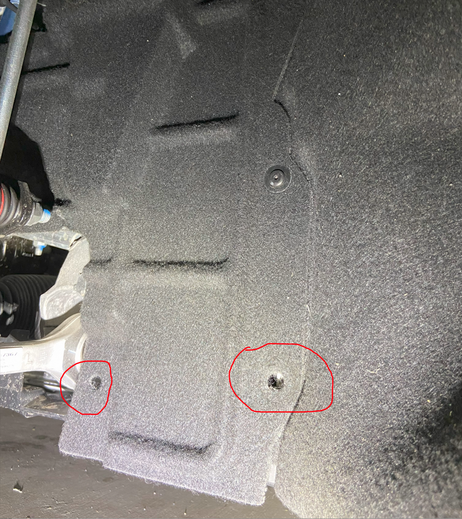

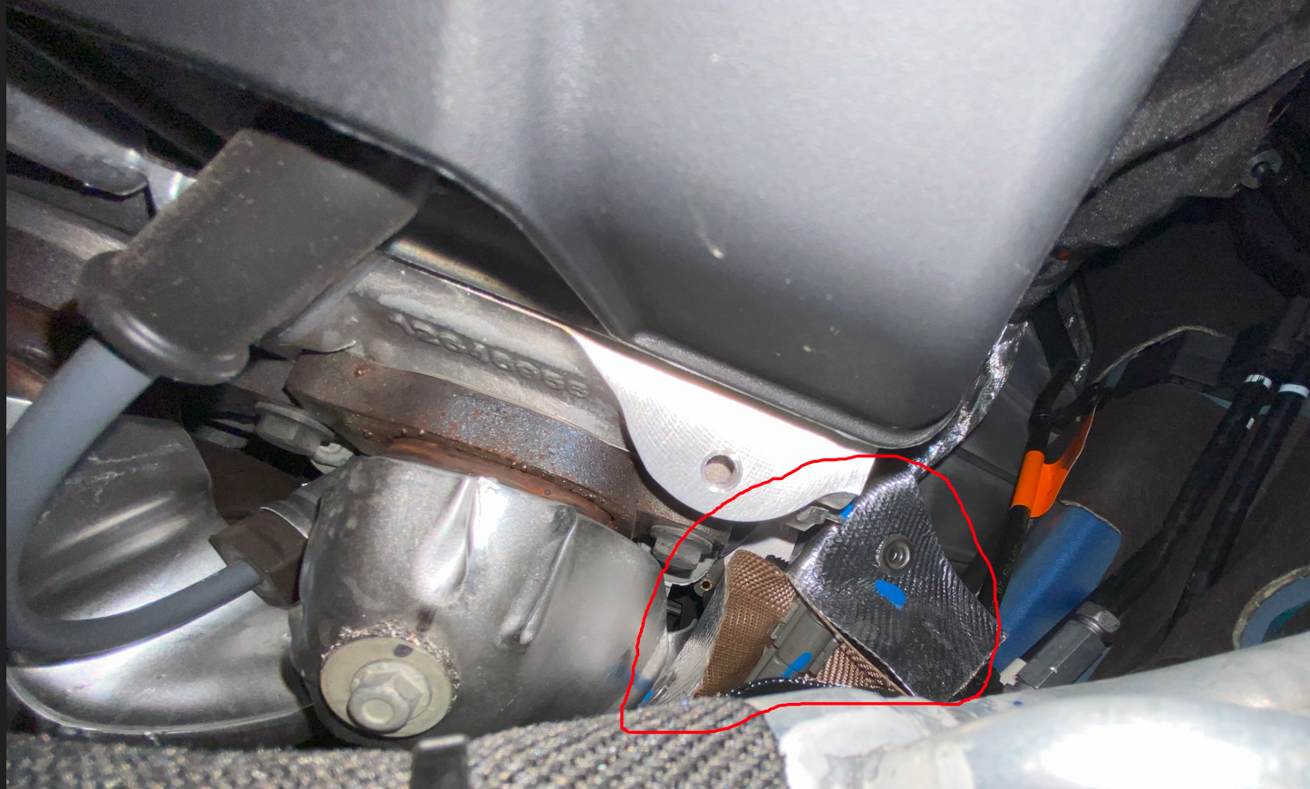

I read through the service manual again to see what else I need to check - turns out the clutch line needs to be disconnected and it says to cap the line to prevent fluid contamination. Given the complete lack of care that was shown on the rest of the job I am concerned brake fluid leaked and is currently dissolving the paint in the engine compartment. It is super tight in there and I could not really see much of anything (the clutch line connection or any spilled brake fluid). However I did find a heat shield that was not reinstalled properly. It is at the back of the left cylinder head. I think this is a heat shield for the O2 connector, but I'm not sure. Picture below.

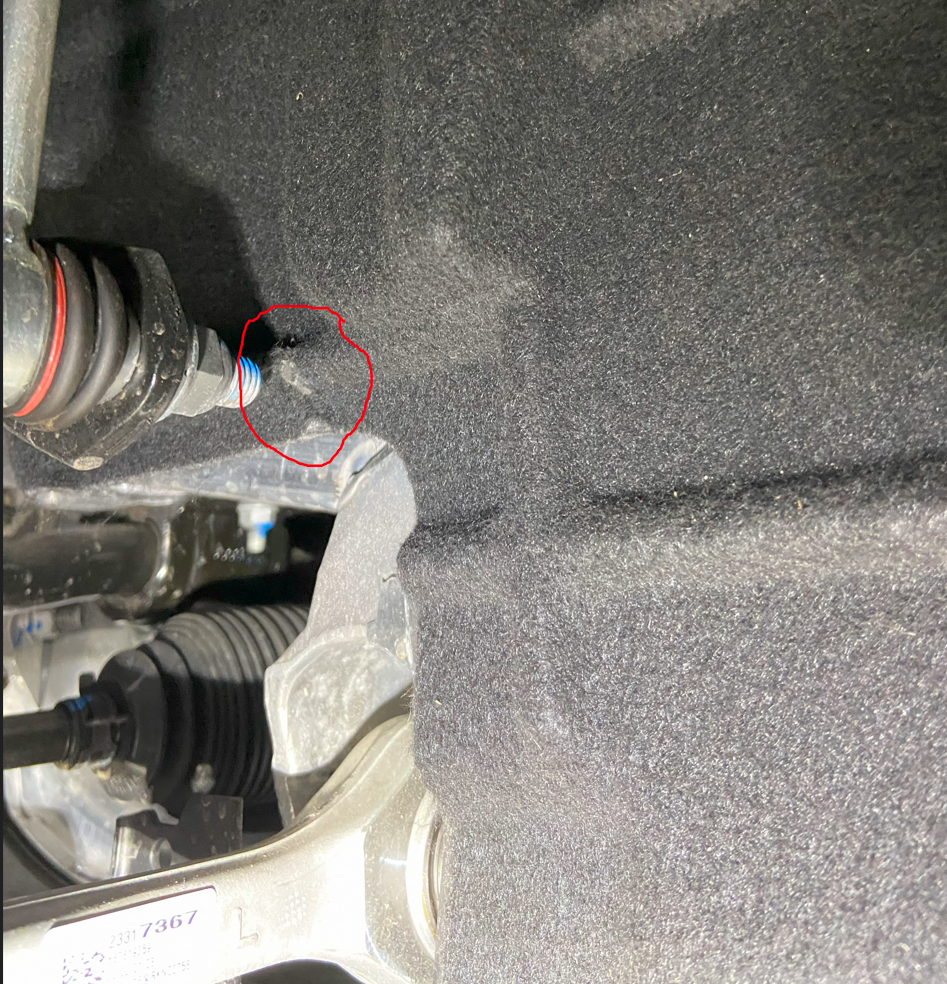

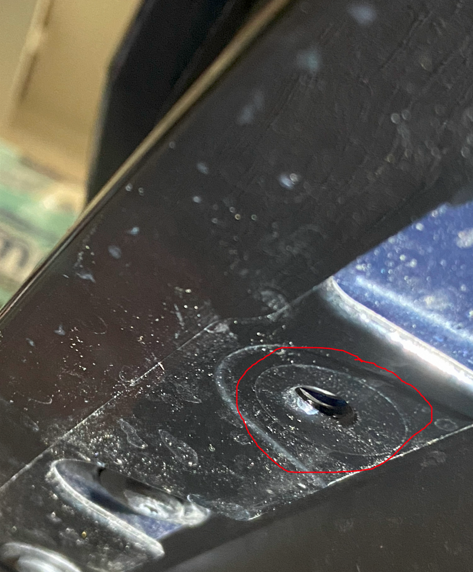

I also found more plastic fasteners that were left off, and some slight damage to the Engine Front Splash Shield. And, strangely, one of the front splitter plastic fasteners is missing - all I can think of is that they harvested it to use elsewhere. From the witness mark, it sure looks like it was installed at the factory.
There must be a bunch more missing fasteners that I just can't see - after all I'm just rolling around on the ground with a flashlight.
