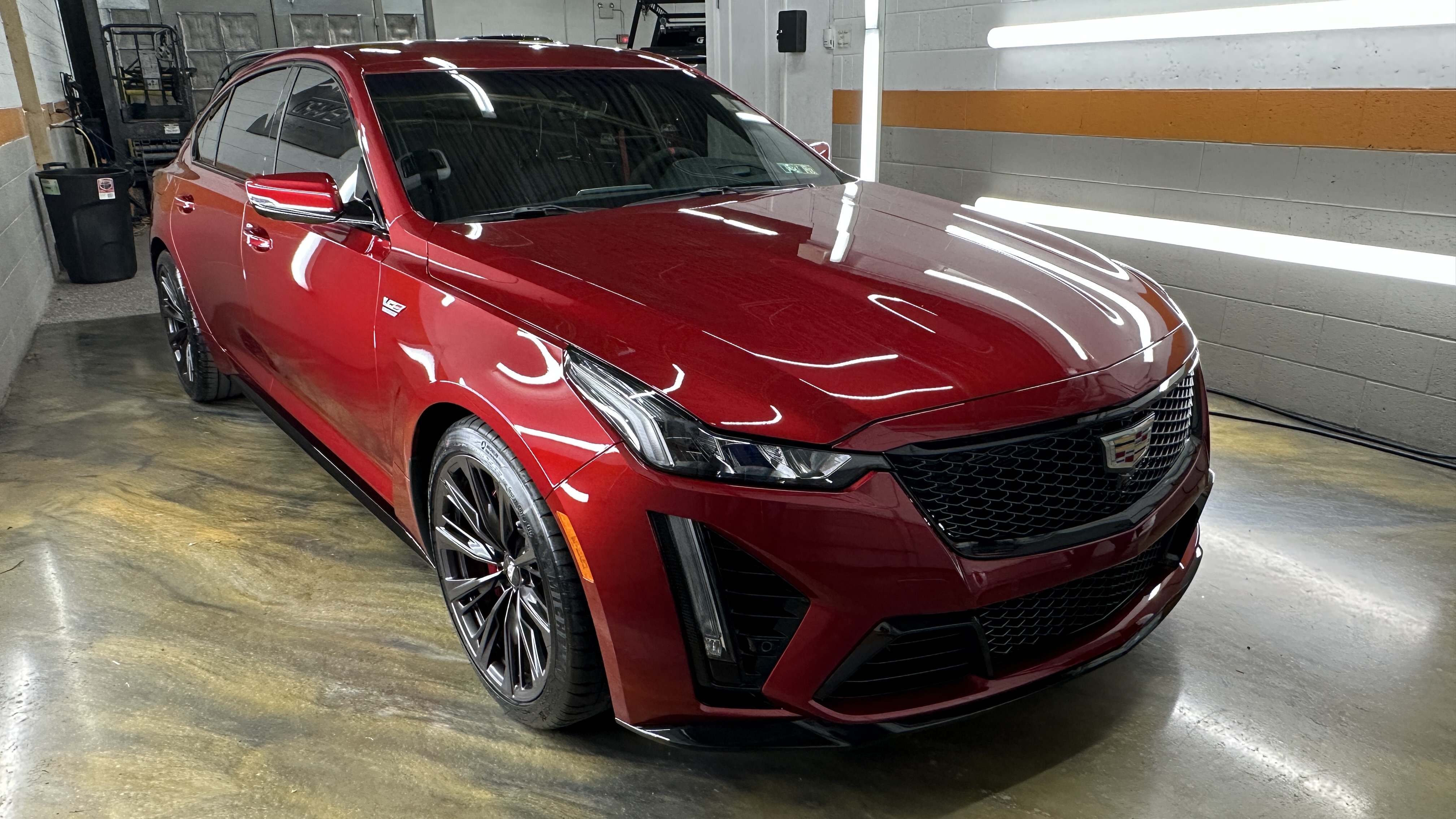

Picked it up from the detailer today! Just some quick phone photos, but hope to find some time for nicer ones this weekend before I get it too dirty. I was too excited to drive it.
Dang that is pretty!

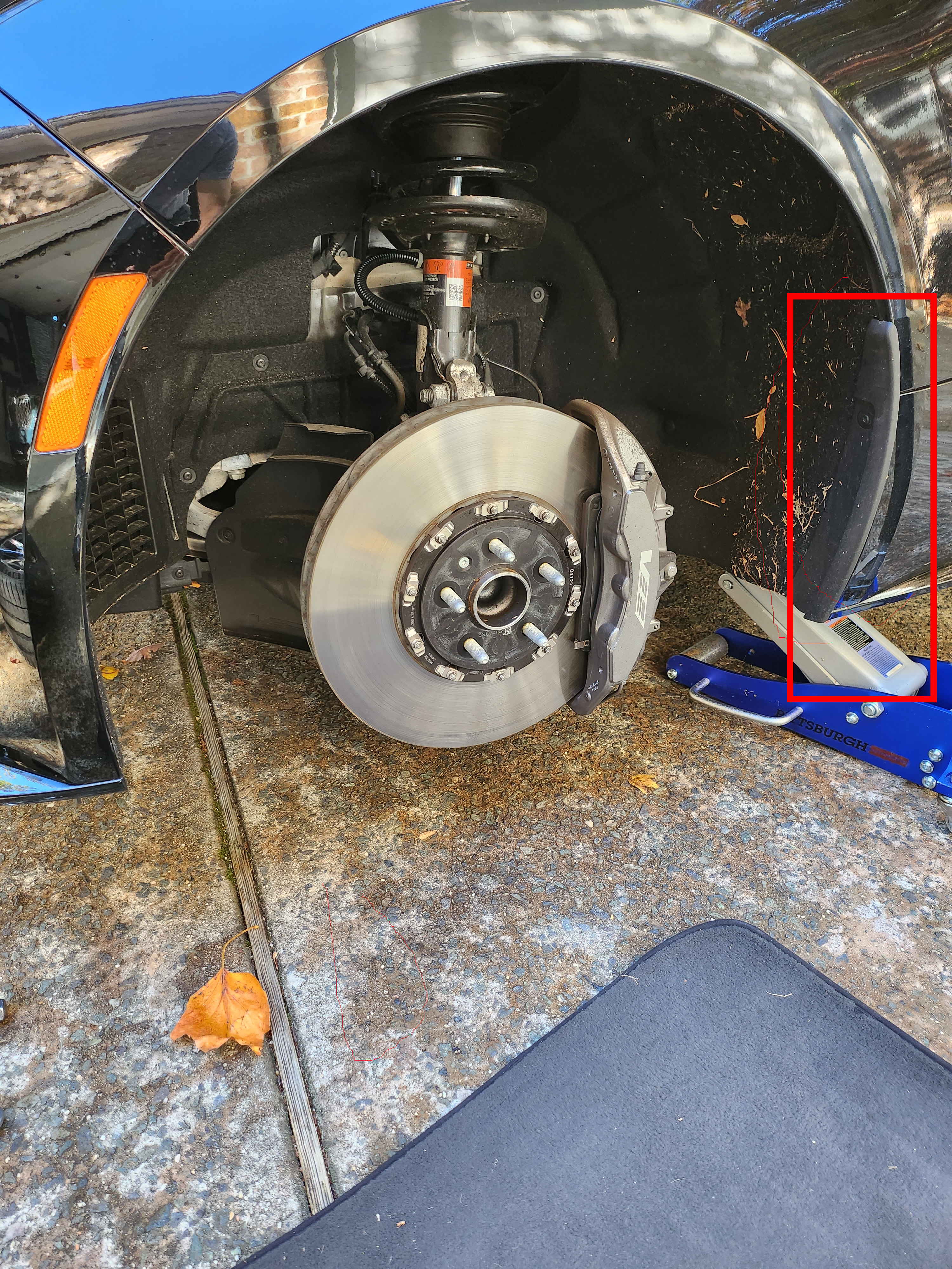

So yesterday I popped off the wheel (stupid camera photo makes the otherwise huge rotor look miniscule) and fixed that piece that I've highlighted in red. It was sticking out, so I had to enlarge the hole for the upper mounting bolt and adjust it properly.
I also washed the car (after I took the picture). It's black. It's a daily ritual (it seems). But dang, it sure does look good for 10 minutes...

That is pretty funny looking and how not even close that relationship truly is because the rotors are as big as tires I had on cars in the 80's

These carpet fender liners drive me crazy. I have so many pine needles on my property and they’re just everywhere on the liners.

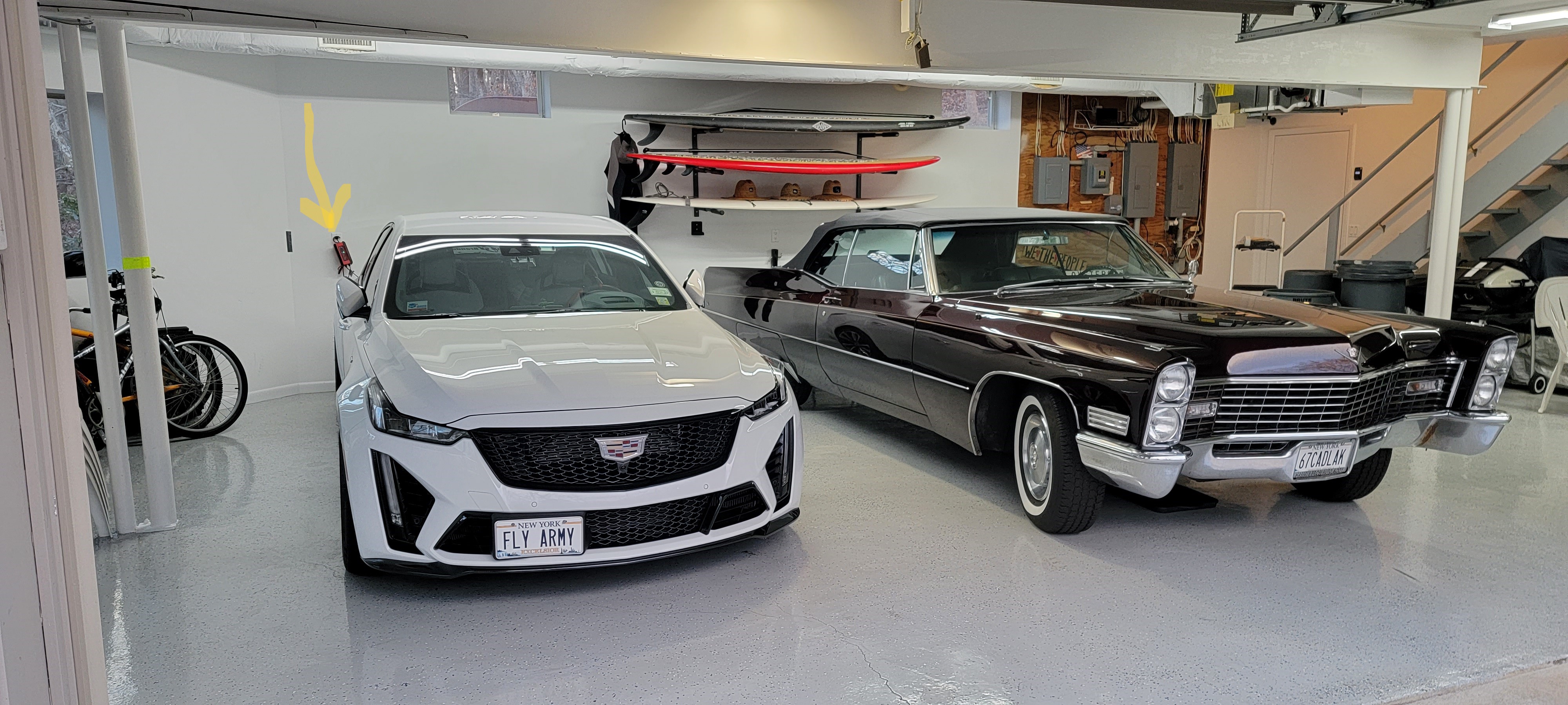

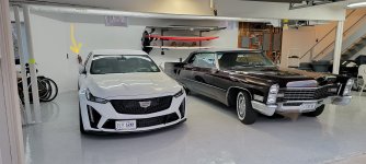

I took my 1967 deVille convertible to my local Caddy dealer to find out what's taking so long for my "ice chest/cooler" that I purchased from their accessories site for Cadillacs. Its been almost 2 months. I used my GM Reward points.

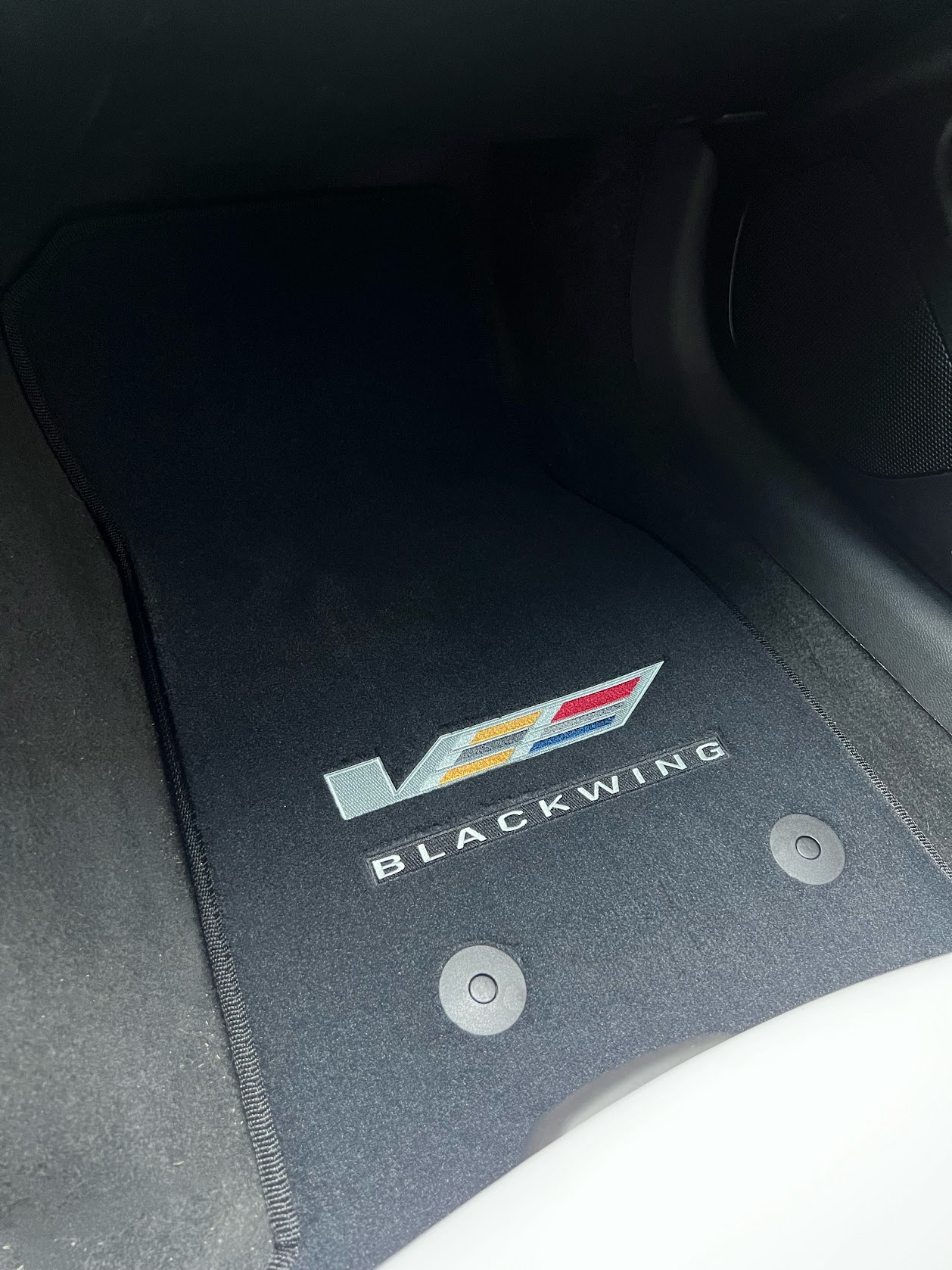

Lloyd Mats
Nice find. My Lloyds were great in the SS.

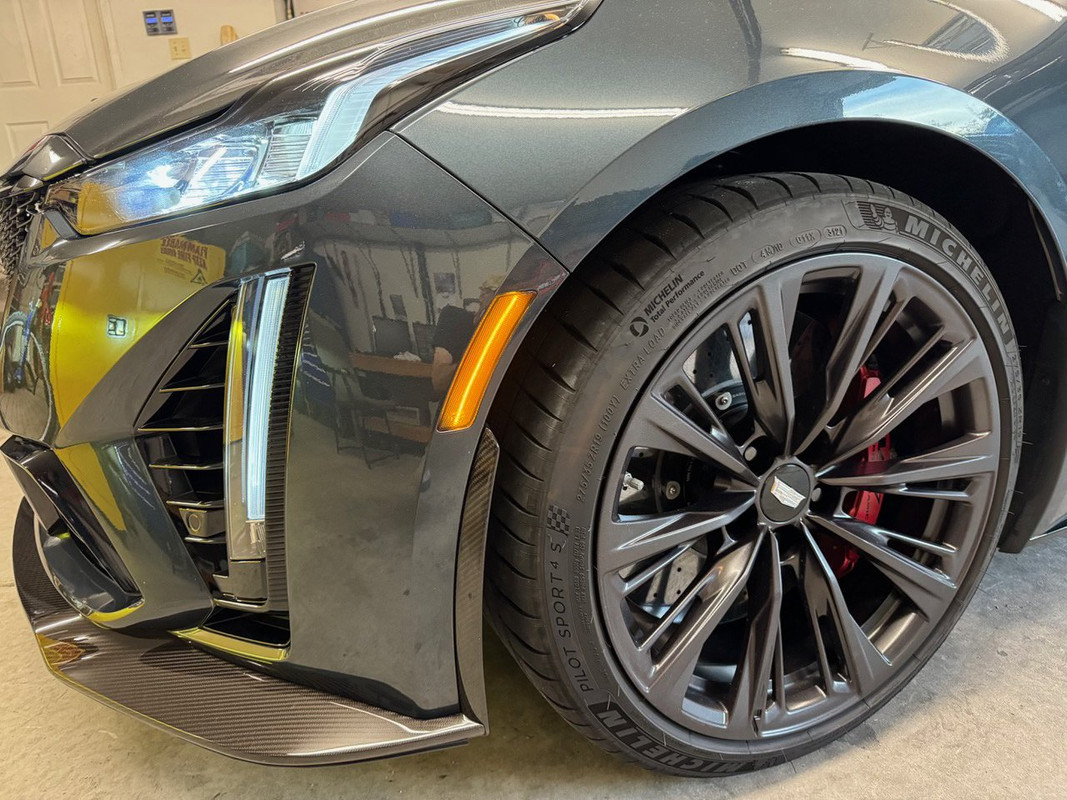

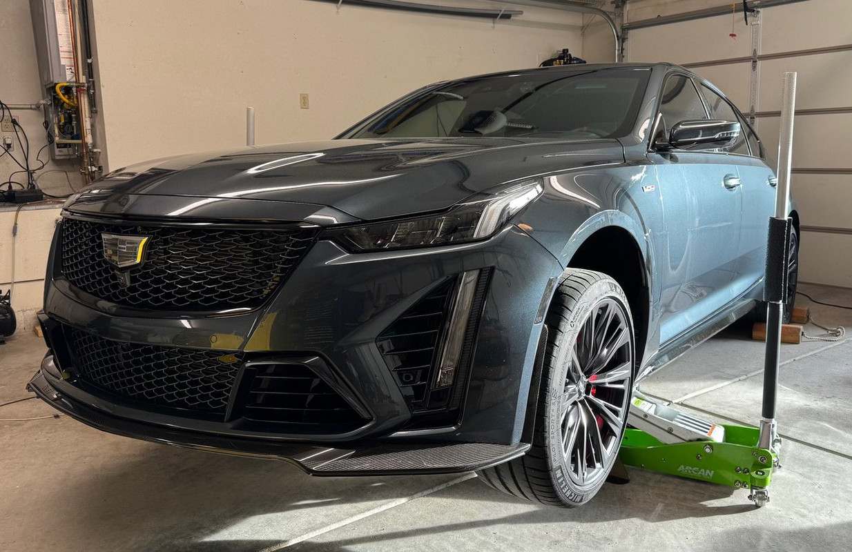

After one year of waiting for my local dealer ordered splitter to arrive I have completed the CF1 on my 5BW. Installed the OEM splitter (PN 84432226), wickers (PNs 84490400 and 84490401), and smoke/amber corner lamps (iJDMtoy on Amazon) for good measure since I had that area apart anyway. The lamps seem good quality and excellent fit. I went with amber LEDs since it matches the front turn signal lamp.
Splitter install is not complicated, but time consuming due to a large number of fasteners. Two of the plastic clips are a little tricky to install, but once I figured out a method it went quickly. I broke 5 clips out of 18 and the dealer wanted $8 a piece for them. I ordered some on Amazon and left the car on jacks for two days. I recommend getting clips (PN 11547341) ahead of time.
https://a.co/d/5oYTARL
I also installed the SLIPLO kit before installing the splitter. One kit is perfect for the splitter for full coverage. https://a.co/d/5rVlcGH
Very pleased with the result. The splitter makes a big improvement in appearance.
Nice work. I have scraped my non-carbon splitter a handful of times and think "so glad I don't have the carbon splitter". But it looks so much cooler, and even though I would not personally realize its aero advantages, I definitely see it as a detail that differentiates the best Blackwing builds. I have the spoiler, and at some point will get this part too.
Different parts on the US have vastly different road conditions. When I lived in LA I constantly had issues with scraping my S4, especially drive entrances. -They have very steep angles. In Arizona and New Mexico I hadn’t encountered issues with the non-CF splitter. But I installed the SLIPLO just in case.
I didn’t do it for the aero, just bling, and so far that expectation worked well for me.
