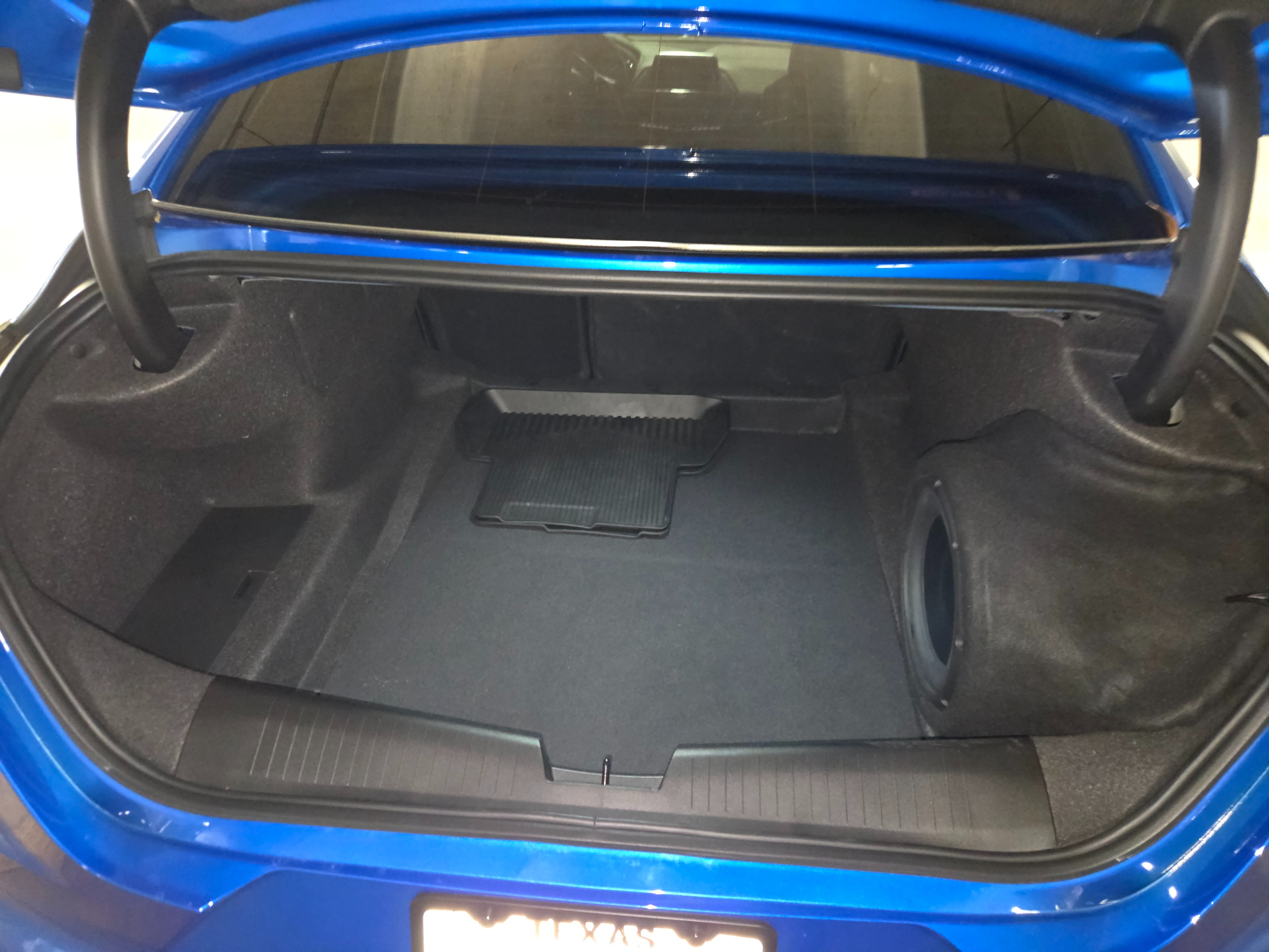

Just for reference I installed the LLJ harness into my vehicle with no sound system mods. The fake engine noise and stuffy ANC feeling was driving me nuts. I then drove 5 hours for some thanksgiving festivities.
I can now see why they had opted into using ANC the lack of insulation in the trunk makes the ride very loud and drony and the AKG speakers are complete ass.
The real exhaust note does sound good when you are accelerating but something about tour mode in 6th at 70 doesn’t resonate well and sounds boomy.
I think adding some light sound deadening so the trunk isn’t like some cavernous hole resonating would probably fix the issue, but again this is just my theory until I get around to it
Also if you’d like to test this out to see if it’s something you want to commit to you can remove F26 in the trunk fusebox to disable to amp and see how it sounds
