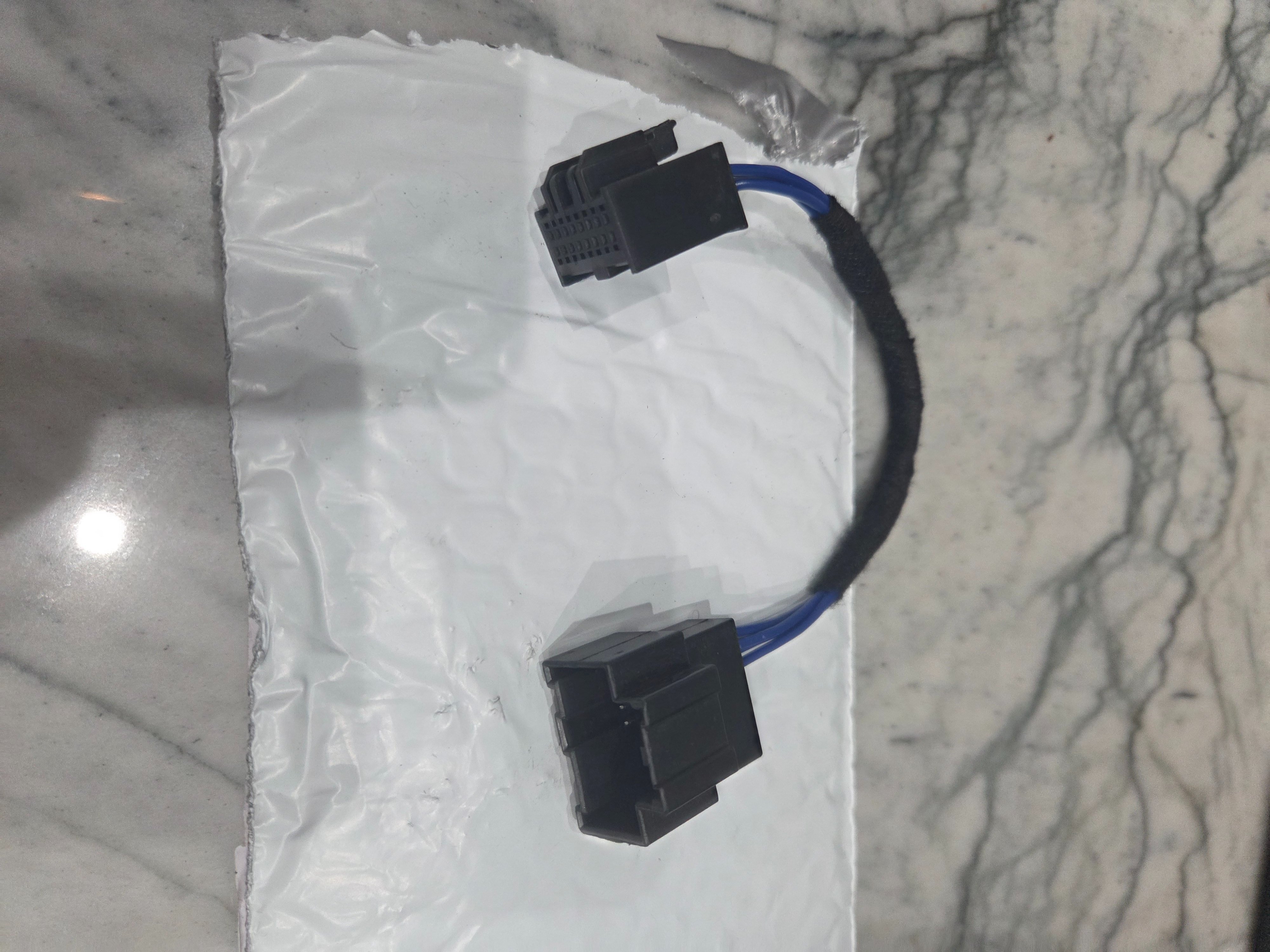

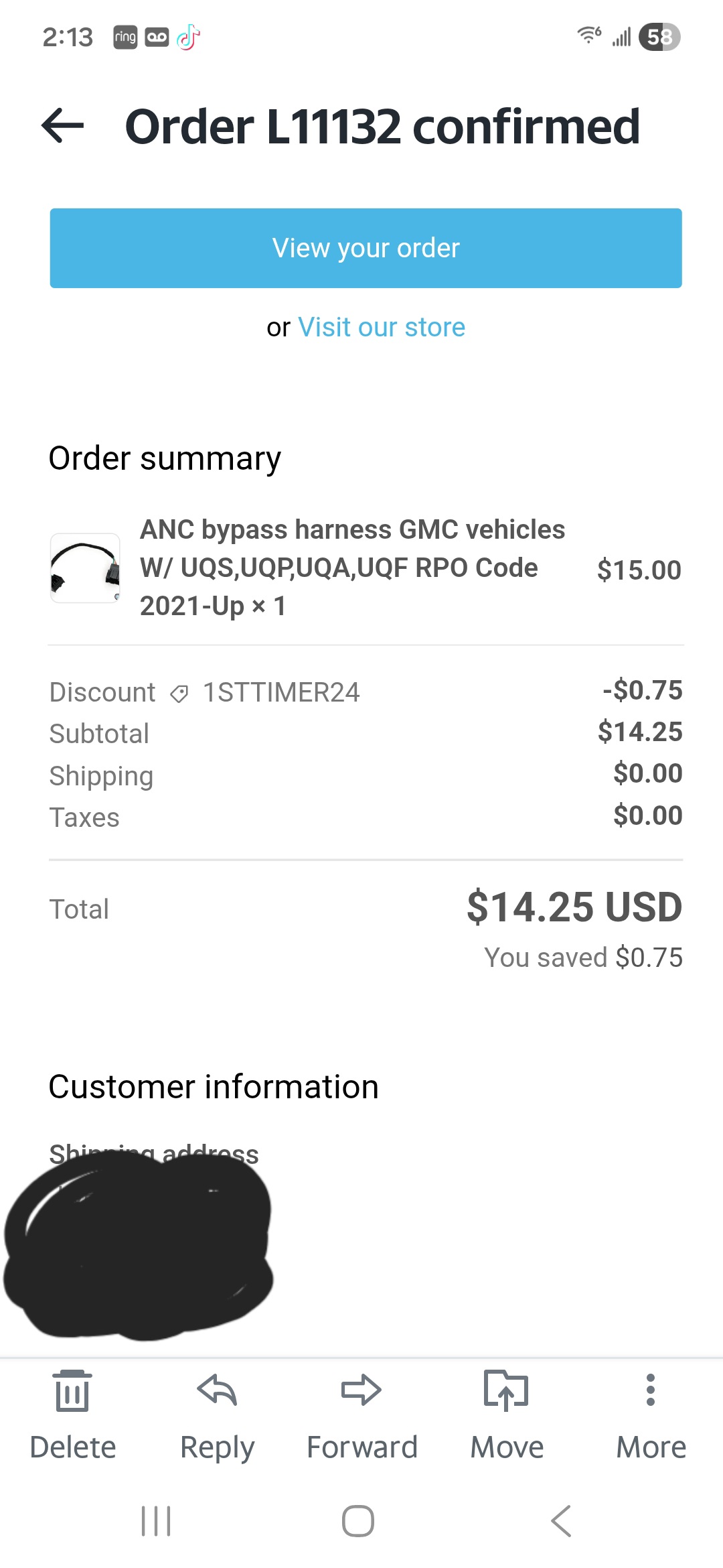

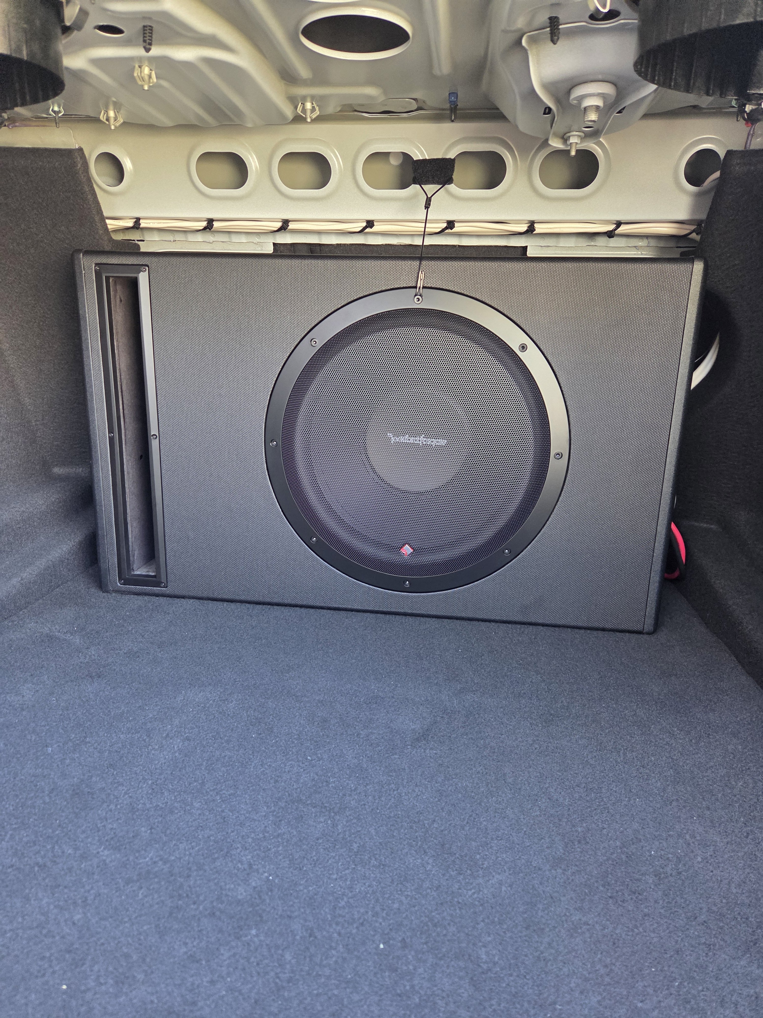

OK guys I installed a powered sub from RF. Hooked it up, tried it out and sounds amazing. Now when I get in the car it's droning very loud. So much that I had to turn it off. Im thinking it's the ANC. I bought the LLJ bypass but am really stuck on how it's used.
Wheni get to the amp, am I removing a plug altogether?
Do I plug in the bypass and then the original cable that I unplugged or does that stay unplugged...
Some help with maybe kid friendly explanation would really be appreciated.
Update, got it done and sounds great. Probably the only thing that could be better with the AKG.
When we installed the sub, it sounded very good. However, the first time I really used the car, there was a very loud drone... A loud constant bass noise. So loud I had to turn it down completely.
I had read that I needed the part so I had bought it but just didn't install it initially. Once I did the install, no more noise or droning. Car sounds awesome with just the added sub.
Which powered sub is that?
