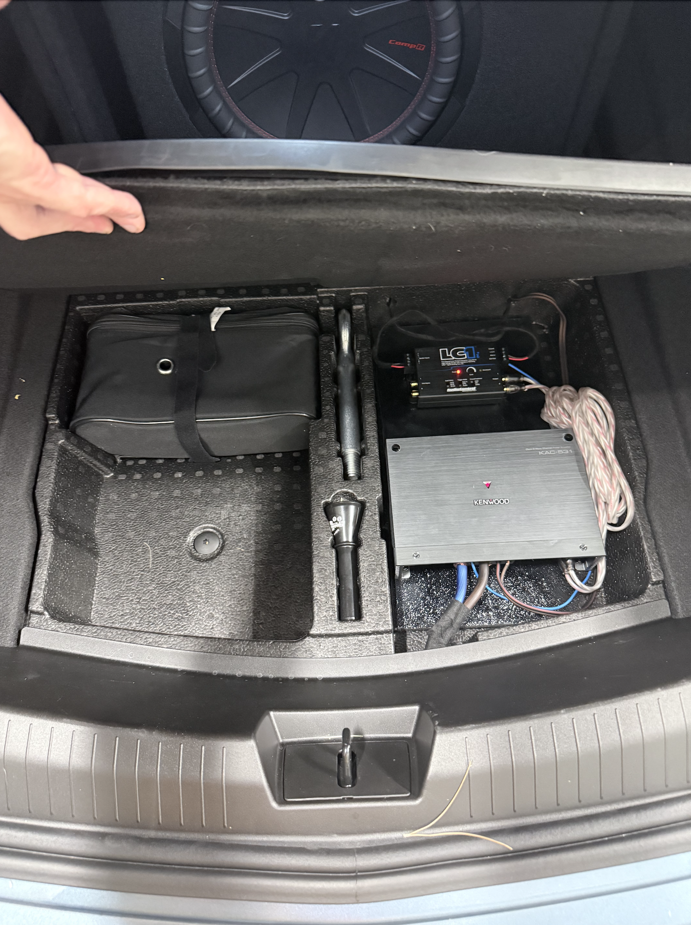

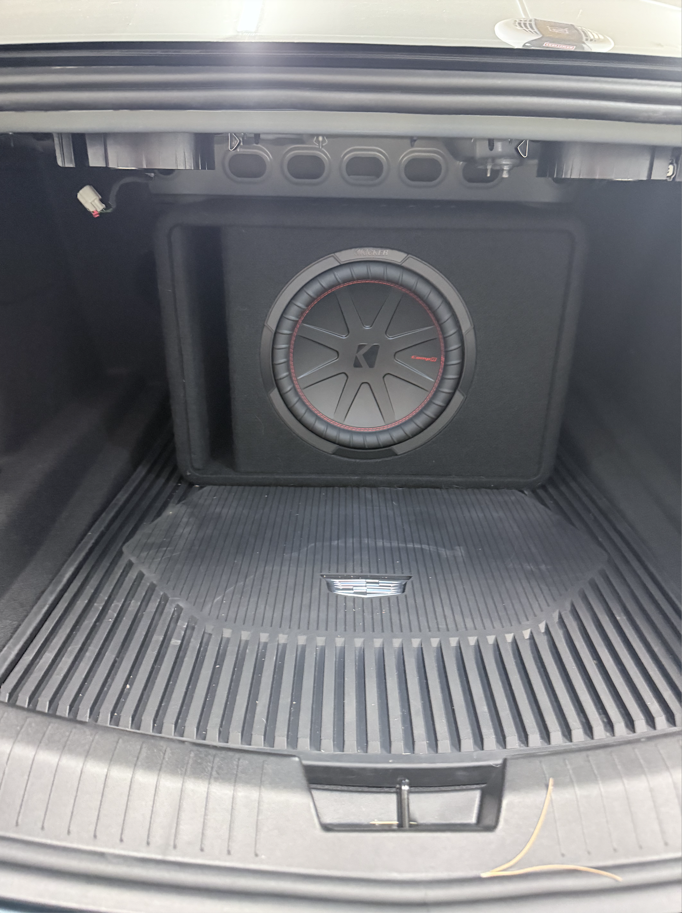

Just wanted to share some of my install - Need to wrap the harnesses and tidy it up a bit (got some shorter RCA's coming) but overall I am happy. Now I just have to go through the interior and clean up all the vibrations from the new sub.. haha!
I got a smoking deal on the sub / box from Best Buy as an open box.. The box fits within 1/2 inch from the top of the trunk in the rearmost position.
I ended up clipping my 5BW ANC wires - with enough room to resolder them in the future.
I tapped into the right 6x9 for signal to my LC1i. Works fine.
Once its cleaned a bit more I think it'll be nice and presentable..

Looks really good. How are you going to secure the box so it doesn't shift around when you drive the BW as intended?
Will a set of golf clubs still fit?

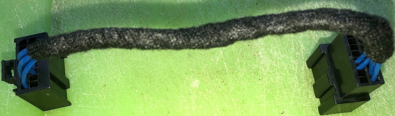

I ordered this one from LLJ and installed it over the weekend. It doesn't completely work. I noticed that sound inside the car was really muffled. With this bypass, my A-pillar tweeters are disconnected. Anyone had similar issues?
Contact LLJ directy. You may have plugged it in to the wrong slot, or they may have wired it incorrectly

I have been emailing them. They said it should be the correct harness. I sent over pictures of everything. Waiting on response now.

If things don’t work out. Check out my thread on my enclosure build. I have a section showing how to disable ANC without the adaptor
