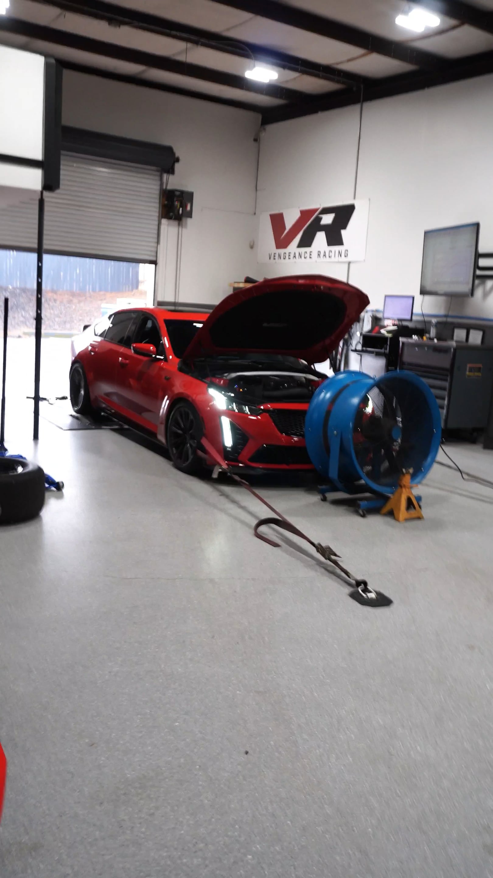

VR is not cheap but they're work is impeccable and surprisingly, there are quite a few things that are needed to go with a build like that most people probably don't factor in. But to answer your question, its roughly $23k, I chose to have the car tuned instead of letting the stock ECM adjust for the mods. I was told by VR that the stock ECM does a good job of adjusting for a lot of mods due to the global B architecture and I could have installed the blower and ran it that way without issues, but tuning the ECM would optimize it even further so the tuning was roughly $3400 by itself to unlock the ECM, dyno time, and HP tuners credits, plus the cost of the actual tune.

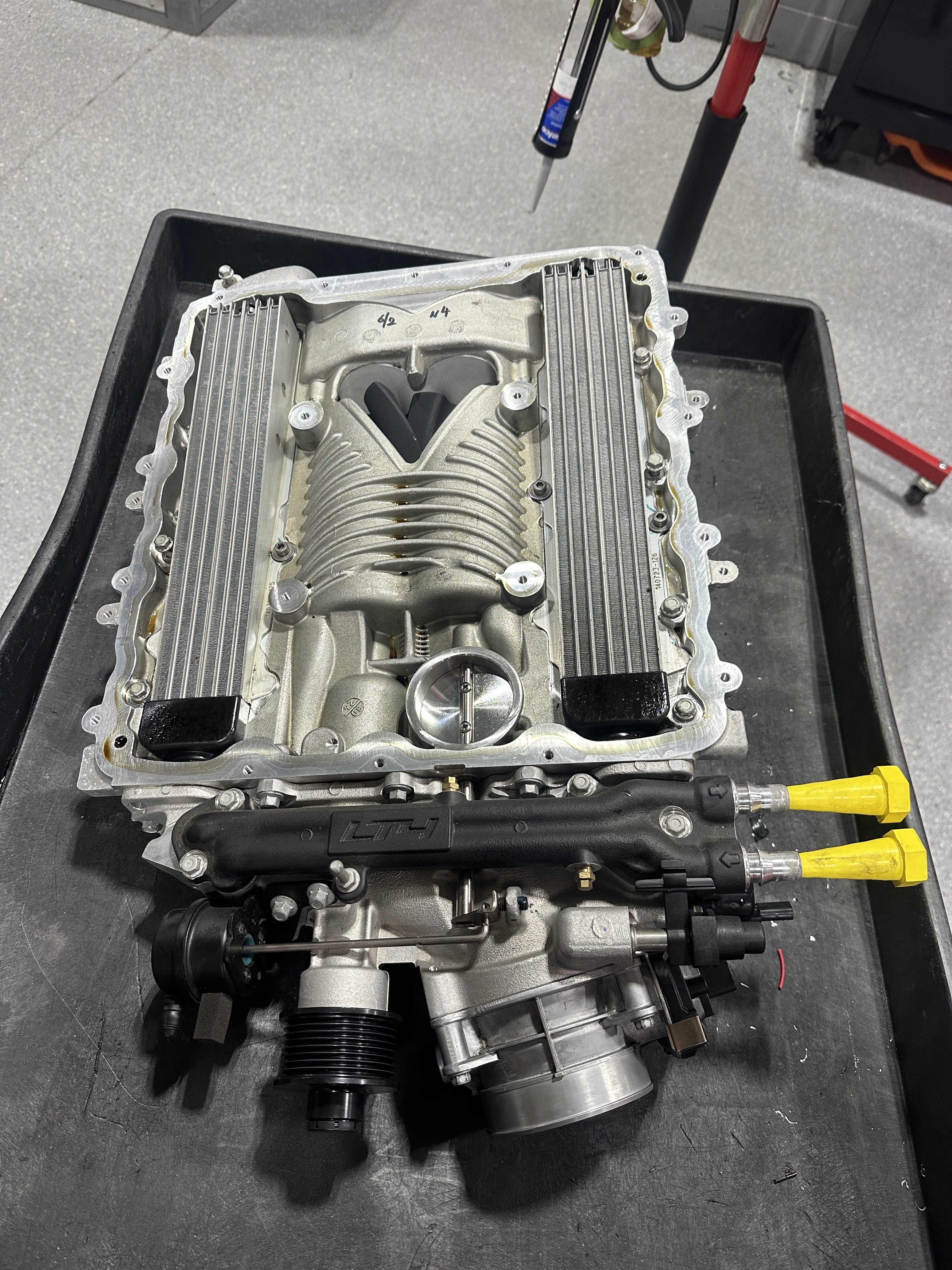

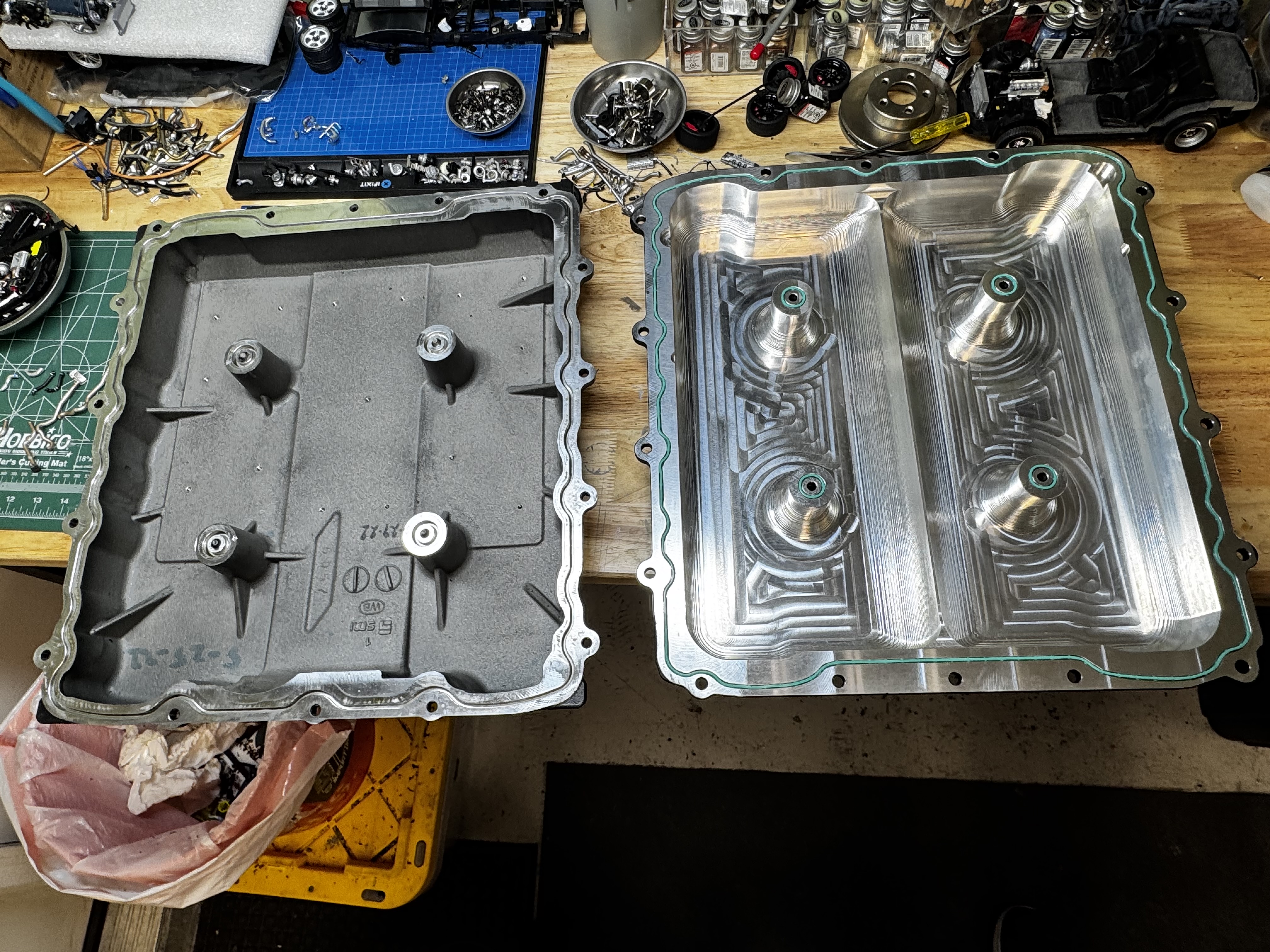

It's certainly cheaper to port the OEM blower and use a lower pulley but you're going to have to add a lot of additional cooling mods for the blower and even then, it will still run hotter than a Magnuson 2650 with no cooling mods. You won't lose any torque on the stock blower if you go with a Kong standard port and lower pulley. The Kong X-Port will give up some torque below 4k rpms but some people claim its hardly noticeable. I had a 2021 Camaro ZL1 before my Blackwing and it made 700whp with a Kong ported blower (Not X-port) and 9.45 lower pulley, 103mm throttle body, 2" headers and high flow cats, and supporting cooling mods for the blower. I never felt any loss of torque with the standard Kong port but they don't remove nearly as much material on the standard port vs the X-port.
Here's another pic without the blower lid. You can see how much larger the 2650 cooling bricks are compared to the stock blower.

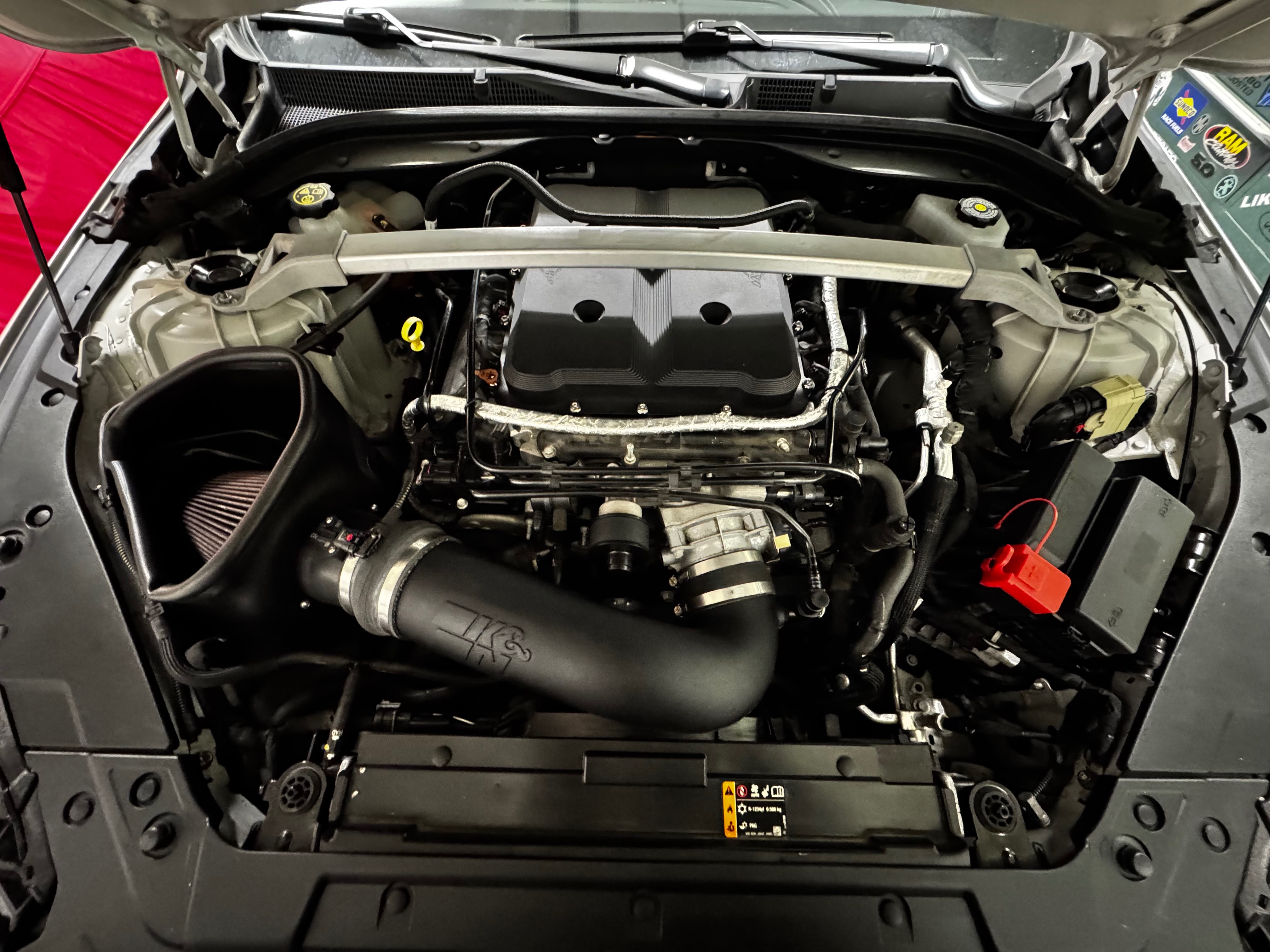

I popped the blower lid open to see what’s what, the bricks looked small, and while I was there, I removed the three plates. Week later I got a mpi lid and k&n intake

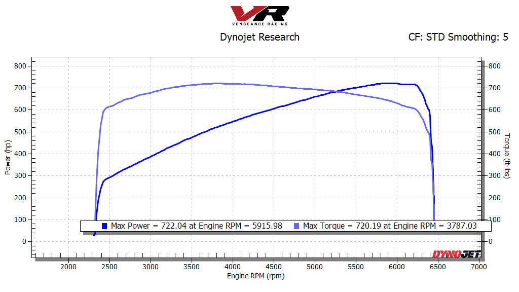

No extra cooling is necessary with the Magnuson 2650, at least with the stock 90mm pulley. If you really start to push the blower up into the 18-20+ psi range, it wouldn't hurt to have more cooling capacity.
What you stated is basically what I'm doing to get it as close to 700whp without needing headers and high flow cats. Magnuson 2650 blower, JLT 5" intake, 103mm throttle body, DSX aux fuel pump and Mighty Mouse Wild catch can, and ECM tune. It's pretty obvious how badly direct injections cars and really all forced induction cars need a catch can, look at the pic above of my stock blower with 9K miles on it. There's quite a bit of oil in there.
That’s a really nice torque “curve”. 700 whip on factory exhaust achieved! How does it feel on the road?
Feels great other than now I need to sort out the rear end wiggle. It was slightly noticeable with the car stock, but its more noticeable now with more power. It's a shame they don't make a rear cradle lock out kit like they do for the 6th Gen Camaro ZL1. The car has tons of torque down low, just over 150lb ft more than stock even at 3K rpms.
She's a monster, no traction in cold weather as I suspected. It hooks decent when its 70+ outside but when it drops below that, the Michelin Pilot Sport 4S just gives up. The car now spikes at 17psi of boost before it settles down to around 16psi.

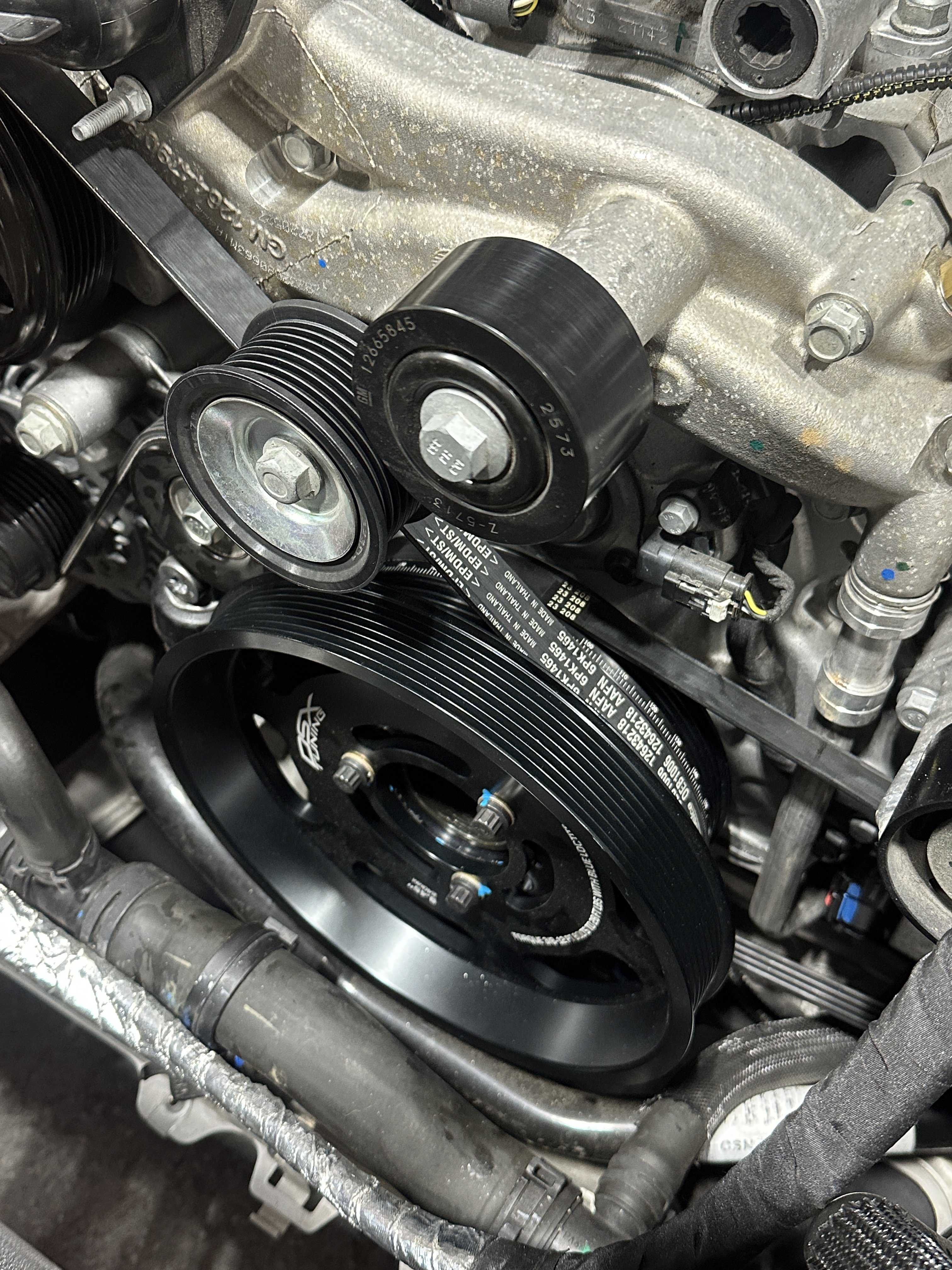

  • ATI 15% Overdriven Harmonic Balancer
