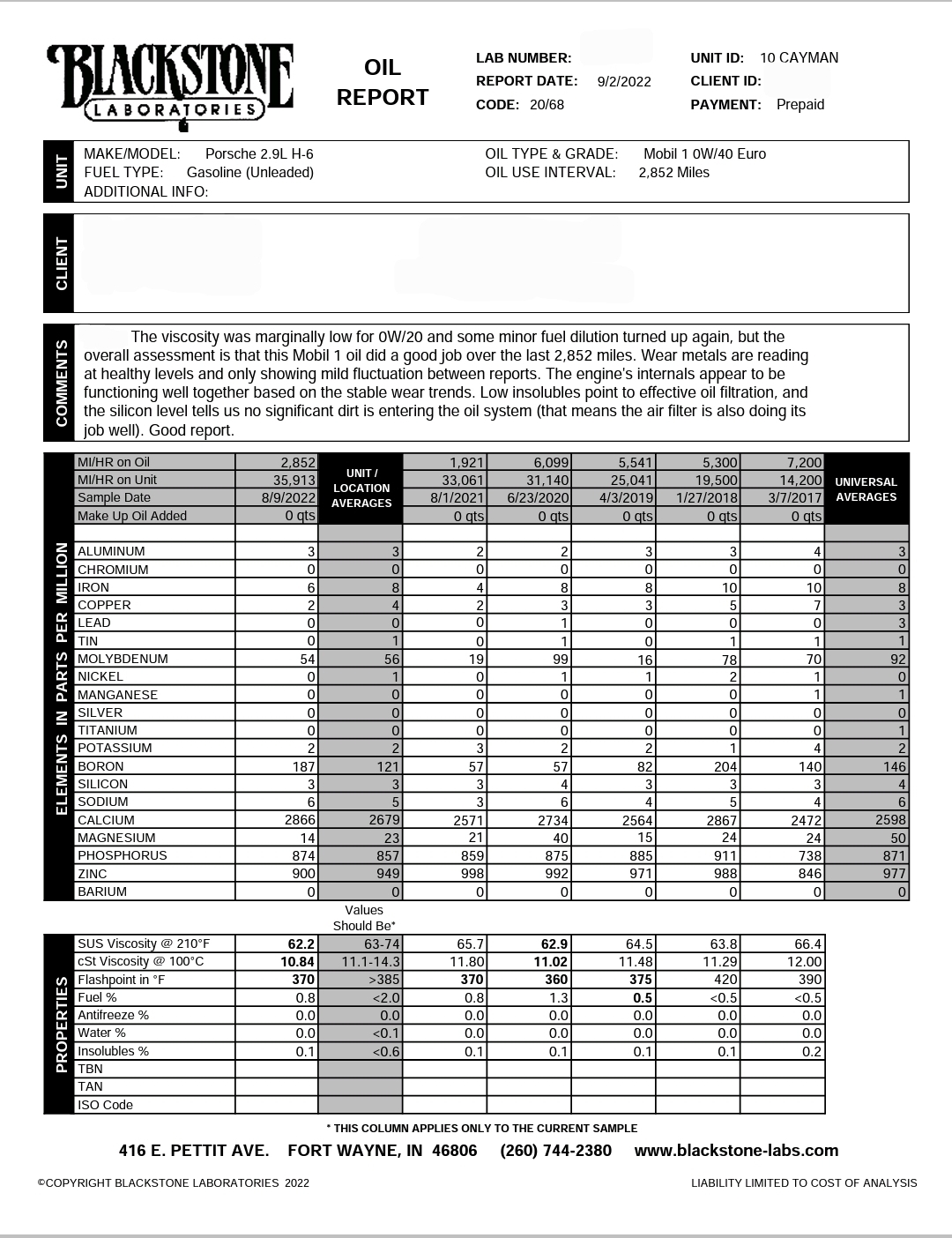

I Blackstone every oil change on all 4 of our vehicles and I have for 15+ years.
On a daily (daughters 2018 Accord), the Mobil is perfectly fine with 10k changes.
In my 'fun' car, I change based on hours run, not miles driven. But even then, every report says I could have run the Mobil 1 longer.

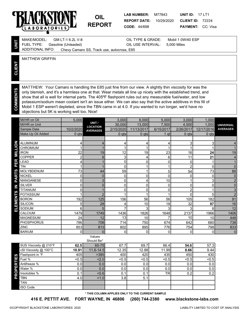

I daily drove this car from 2016 to 2020. I also tracked it in 2016 and autocrossed and spirited driving throughout the rest of the time. I did go over a year on some of the changes and the viscosity is in good range but I don't think it would hold out any longer than 16 months. Maybe if I was able to get 10k mi in year it would be able to hold. I have only bought my oil from Walmart on this vehicle so I have no basis. Either way it works for my mi and duration.
I was pleasantly surprised they said I could run longer with E85. I was always under the impression that E85 was pretty bad at diluting oil.

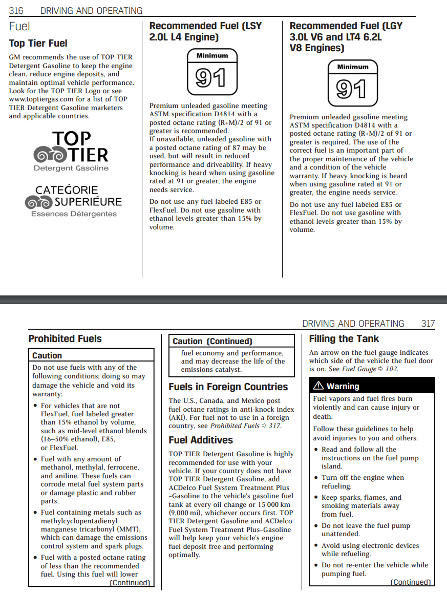

PSA - those 5BW owners who didn't read their owner's manual, it says not to run E85. In fact, it's even called a "Prohibited Fuel". 🛑

Why does the top of the spec sheet say 0/40wt and then the first sentence of the report say 0/20wt?
I have no idea. I questioned that myself. I think it's a Typo
Those numbers look PDG. Are you running an E85 tune?
