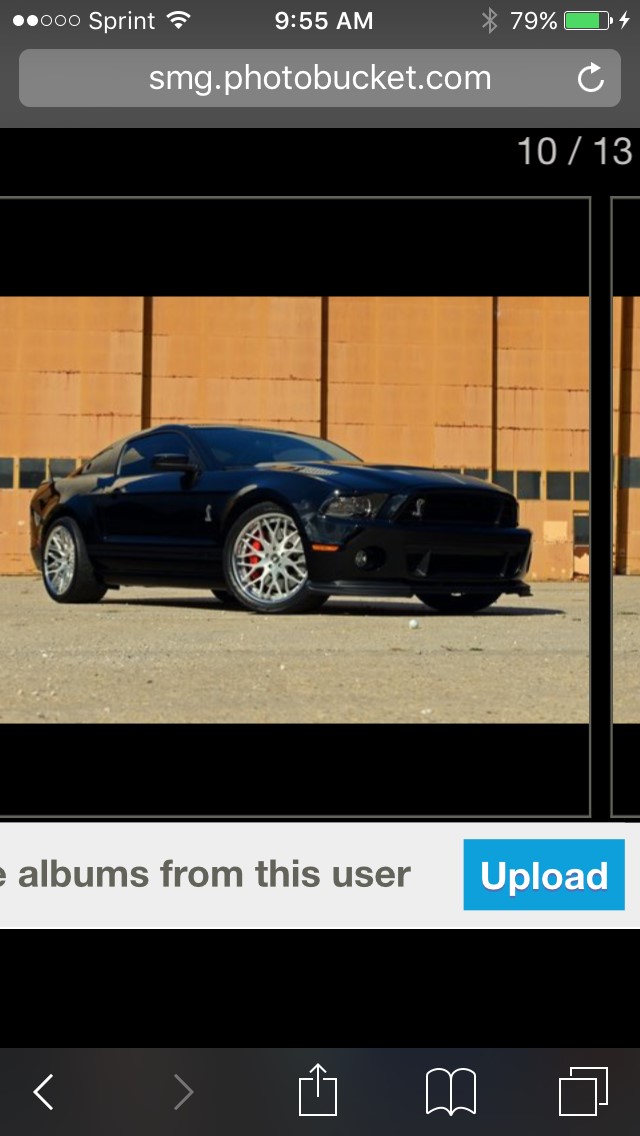

When I had my '14 cammed/built GT500 (845 WHP/Race tune) I would love to turn all the nanny's off and spin my 315's/R888's while going through 3rd gear at 100+. With 760 lbs of tq she would basically lite em up at will but went straight down the road. She was a badass bitch I tell ya.. LOL
