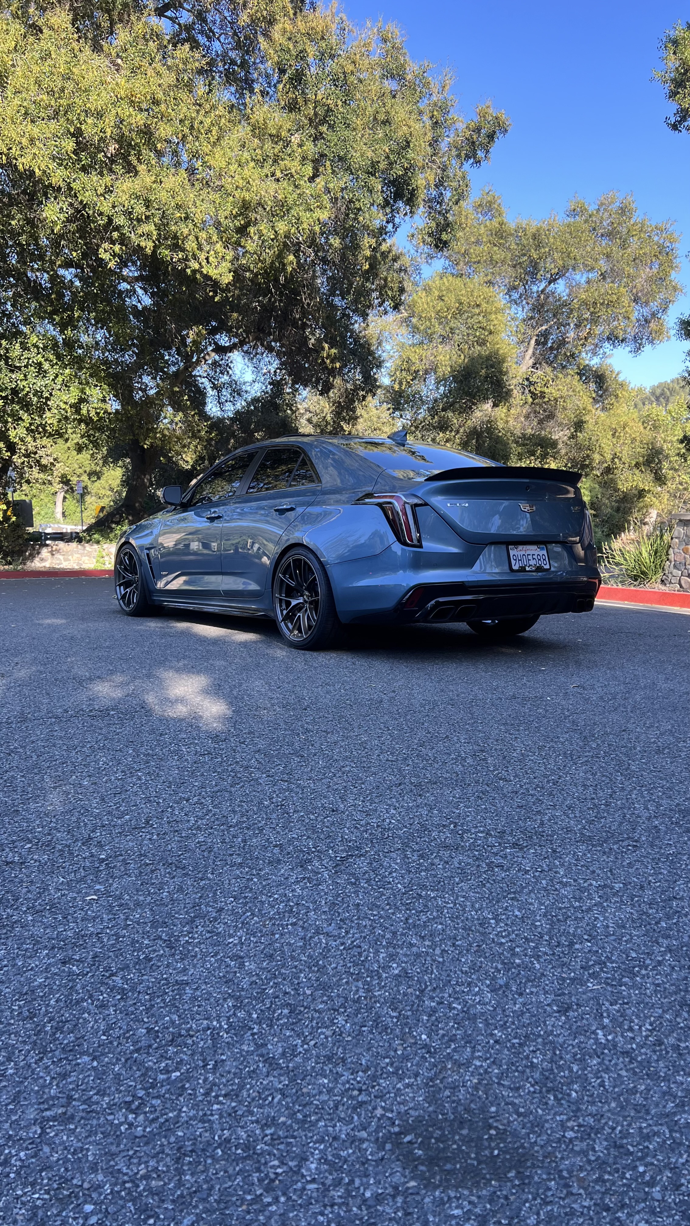

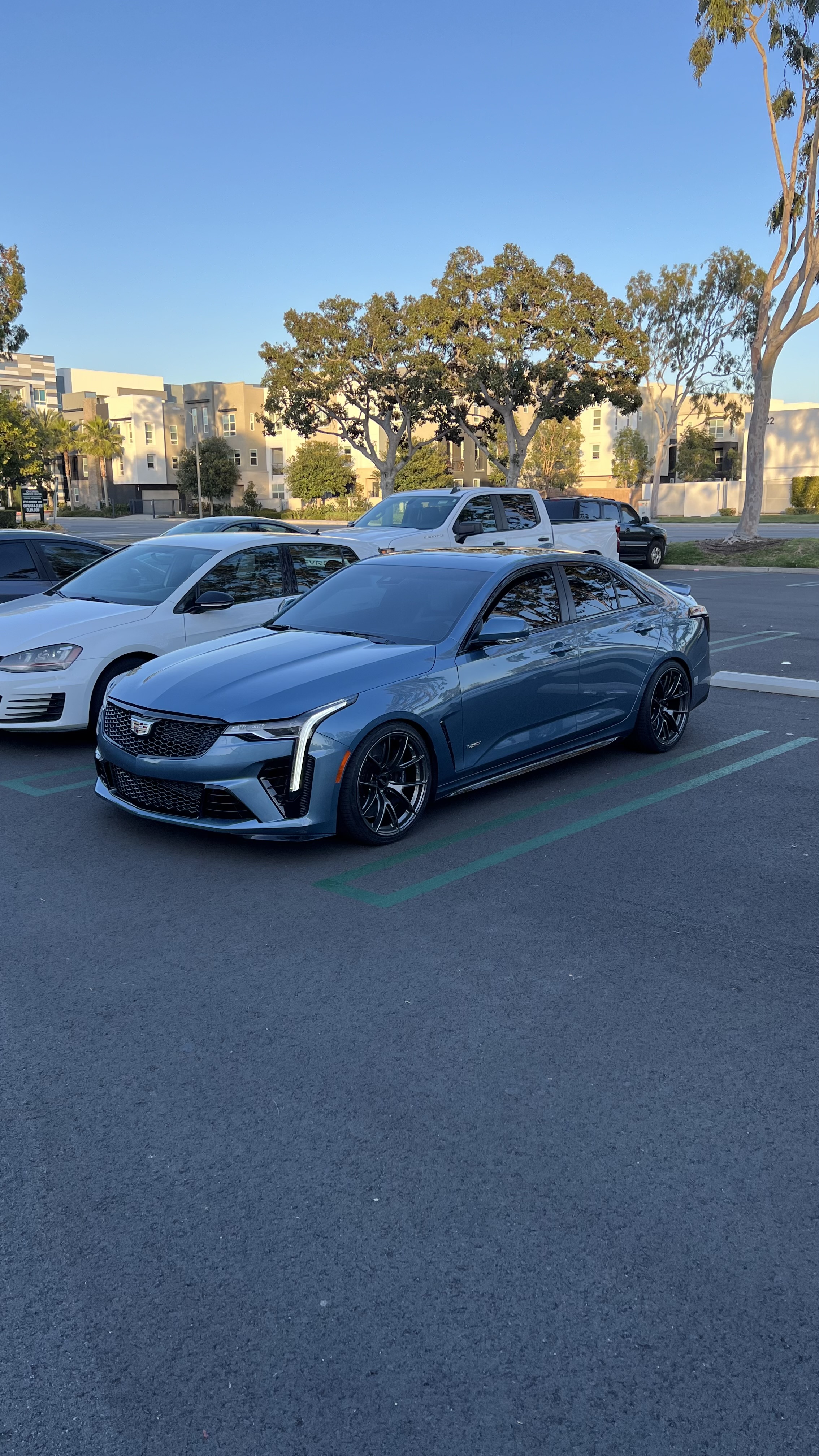

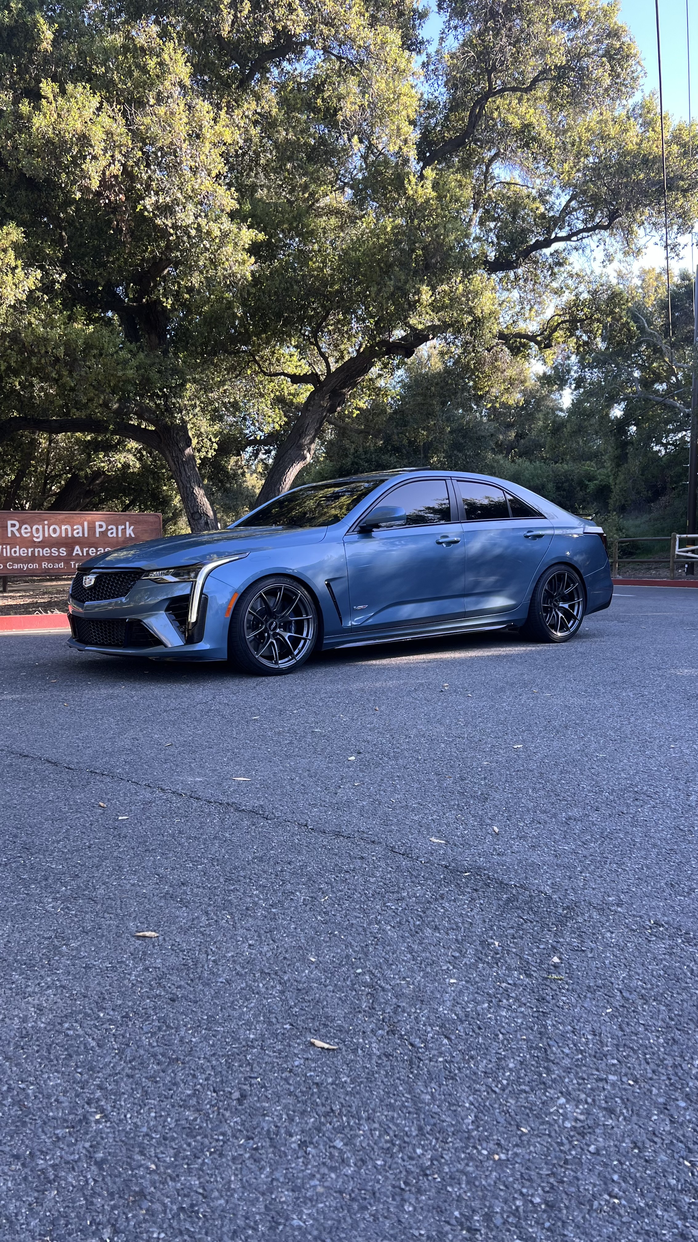

I recently just purchased a set of apex Vs5-RS in 19/9.5/et22 and 19/10.5/et44 and Toyo proxes sport summer tires. I took the car to the canyons on the first day of this setup and I feel as if the tires or tire setup is holding the car back from its factory performance in cornering ability’s. These new tires provide less feedback and grip on corners. To me it honestly felt a little floaty if that makes sense. Switching the weight balance from one corner to another didn’t feel great and is no where near as confidence inspiring as the OEM setup with swift lowering springs. Anyone have suggestions for a new setup to run with these 19inch wheels???

I'm glad to see the fitment looks great. Are you experiencing any rubbing while turning?
I agree with BimmerFan, you couldn't really ask for a better set up with the stock config, minus getting lighter wheels, which you have already done. I'd take the APEX wheels and throw the stock tires on them and call it a day.
Also, do theyse tires/wheels now stick our past the fender? Just wondering for when I order mine. Thanks
It’s perfectly flush imo it’s dosent stick out at all and there’s no rubbing while running a 265/30 and 285/30
