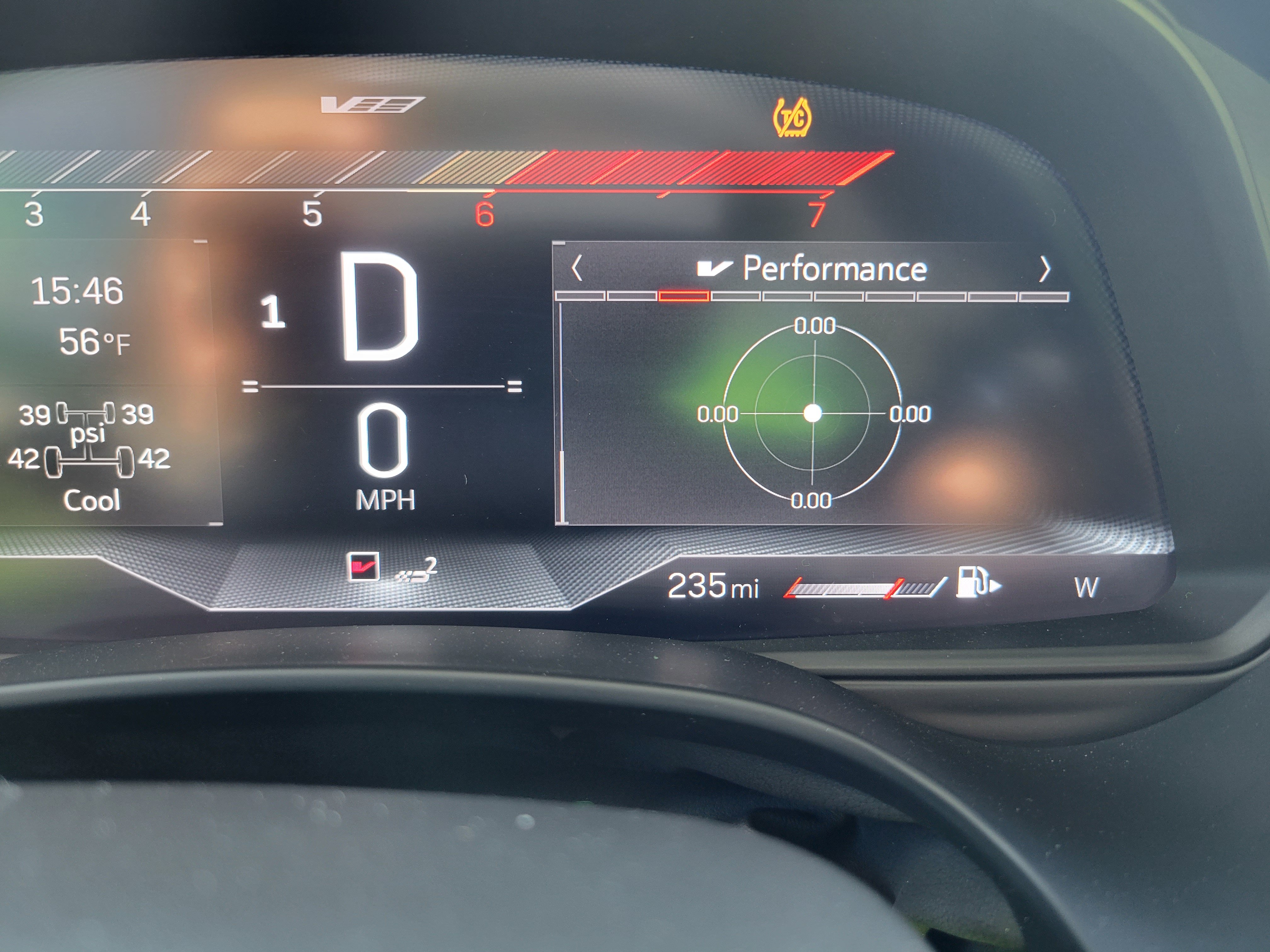

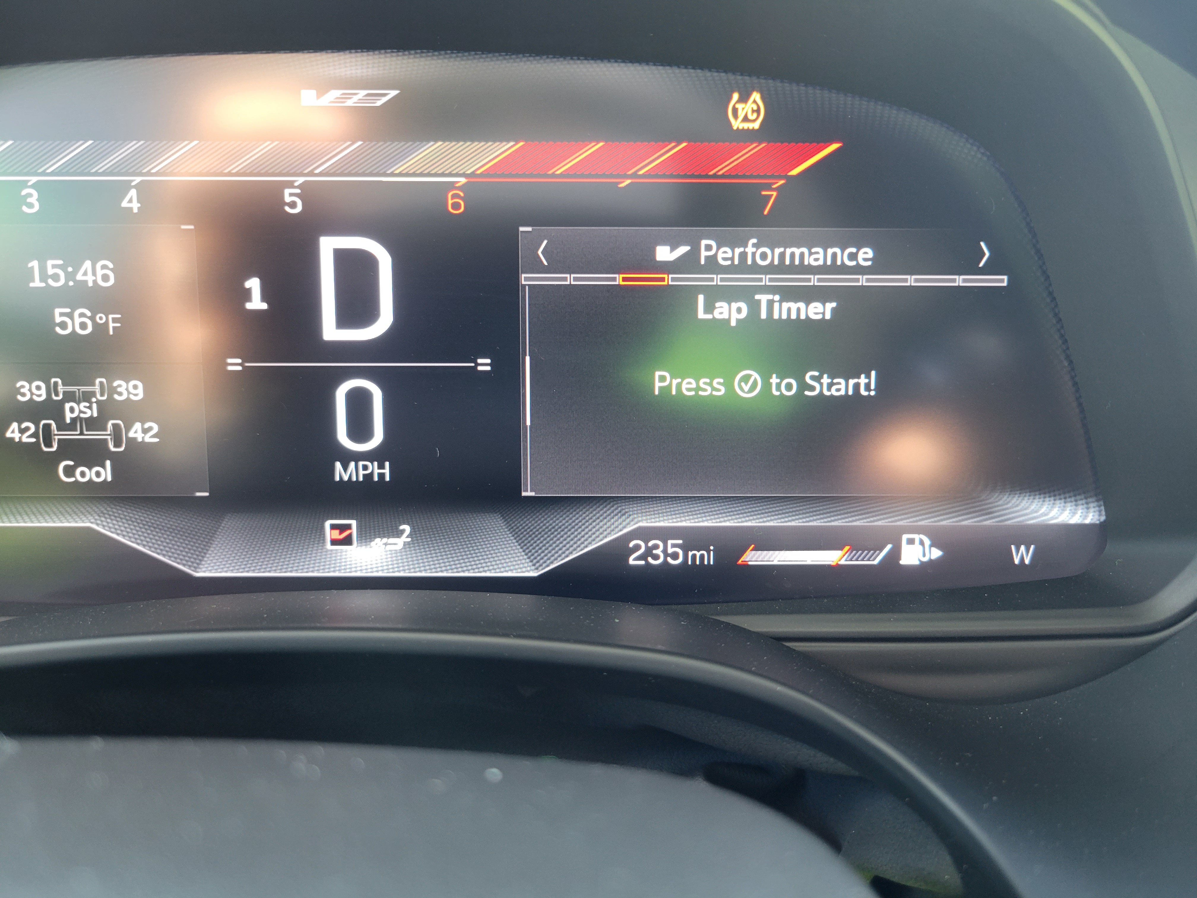

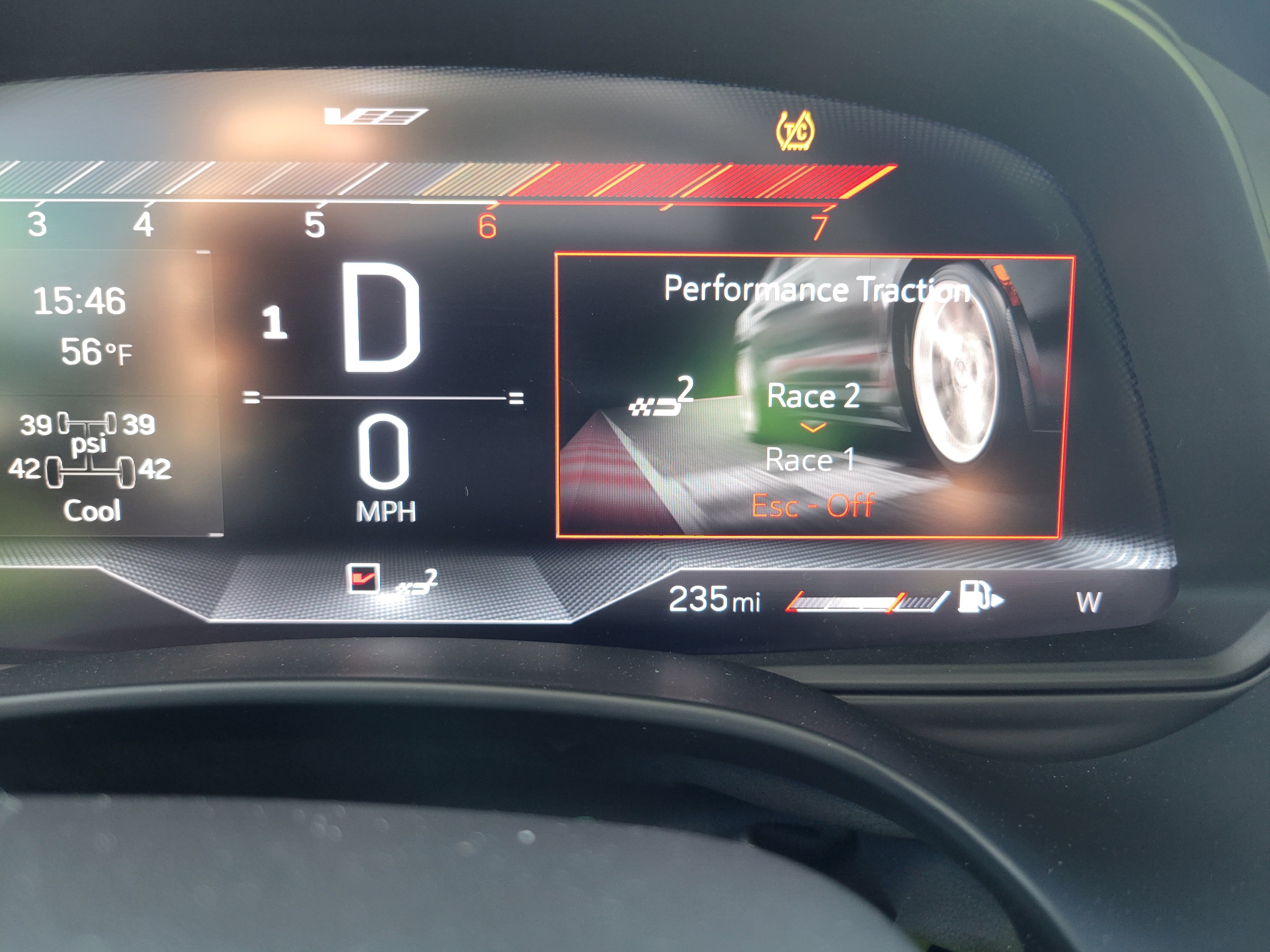

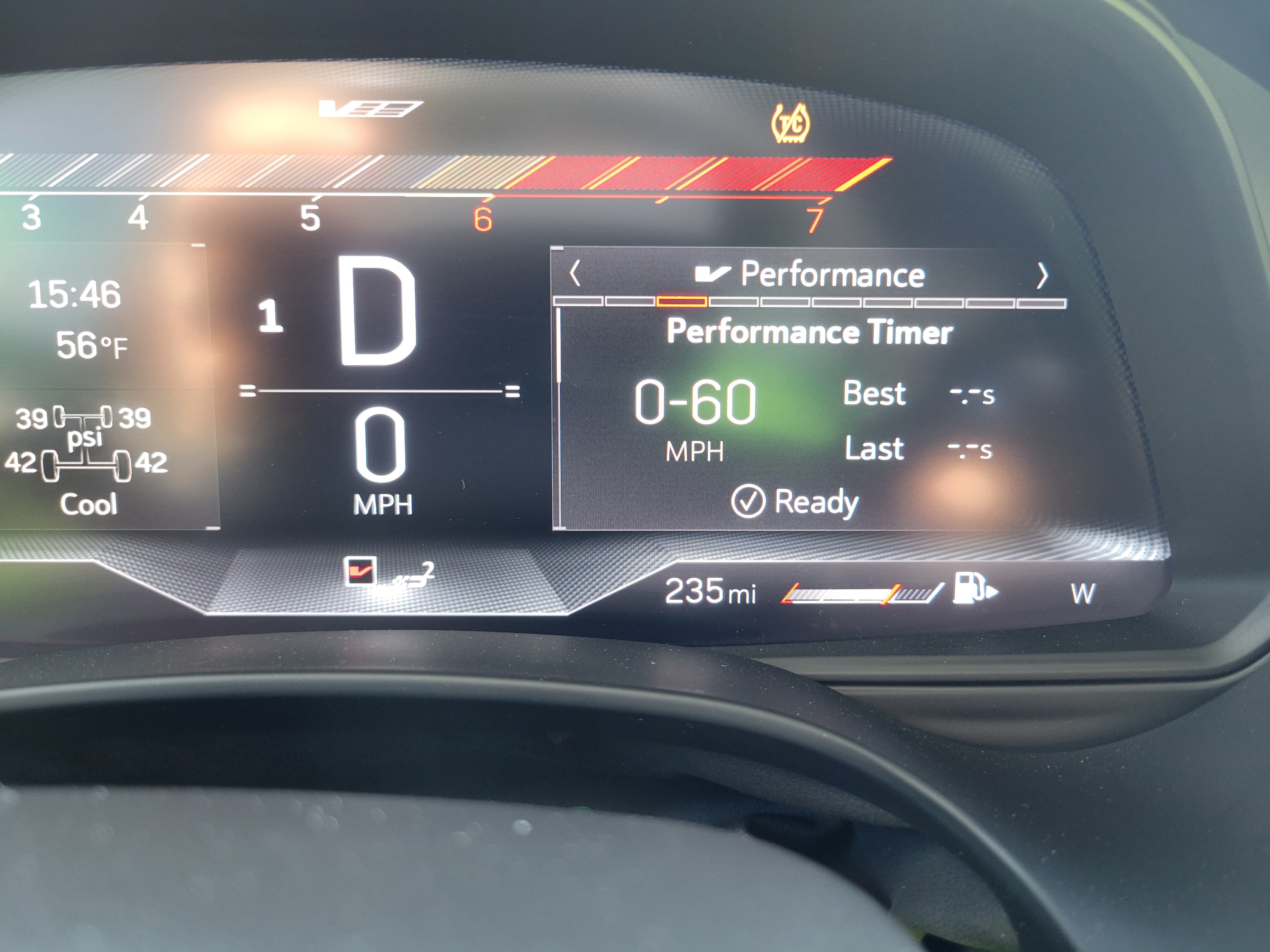

Thanks, tried it again today (only my instructions are on page 300. Still nothing showing after entering competitive driving mode and PTM. Maybe I was lied to and the VIN is showing an RPO that another option overrides?

Nothing will show up specific for setting or enabling Launch Control.
Once you're in Competitive Driving or a PTM mode, you push the brake pedal as hard as you can, floor the throttle, wait for the RPMs to level off, then release the brake pedal.

I made a YouTube video from my car just now. If you want to customize launch control, you need to get into a PTM mode, go the Performance tab and scroll down to Launch Control. You'll see in my video that it initially shows unavailable, but once I put the car in gear, it becomes available and the ability to set the options becomes available. My understanding is the only item in the options you'd be missing is line lock.

That's what I was trying to find before, I don't have that option under the performance tab...
