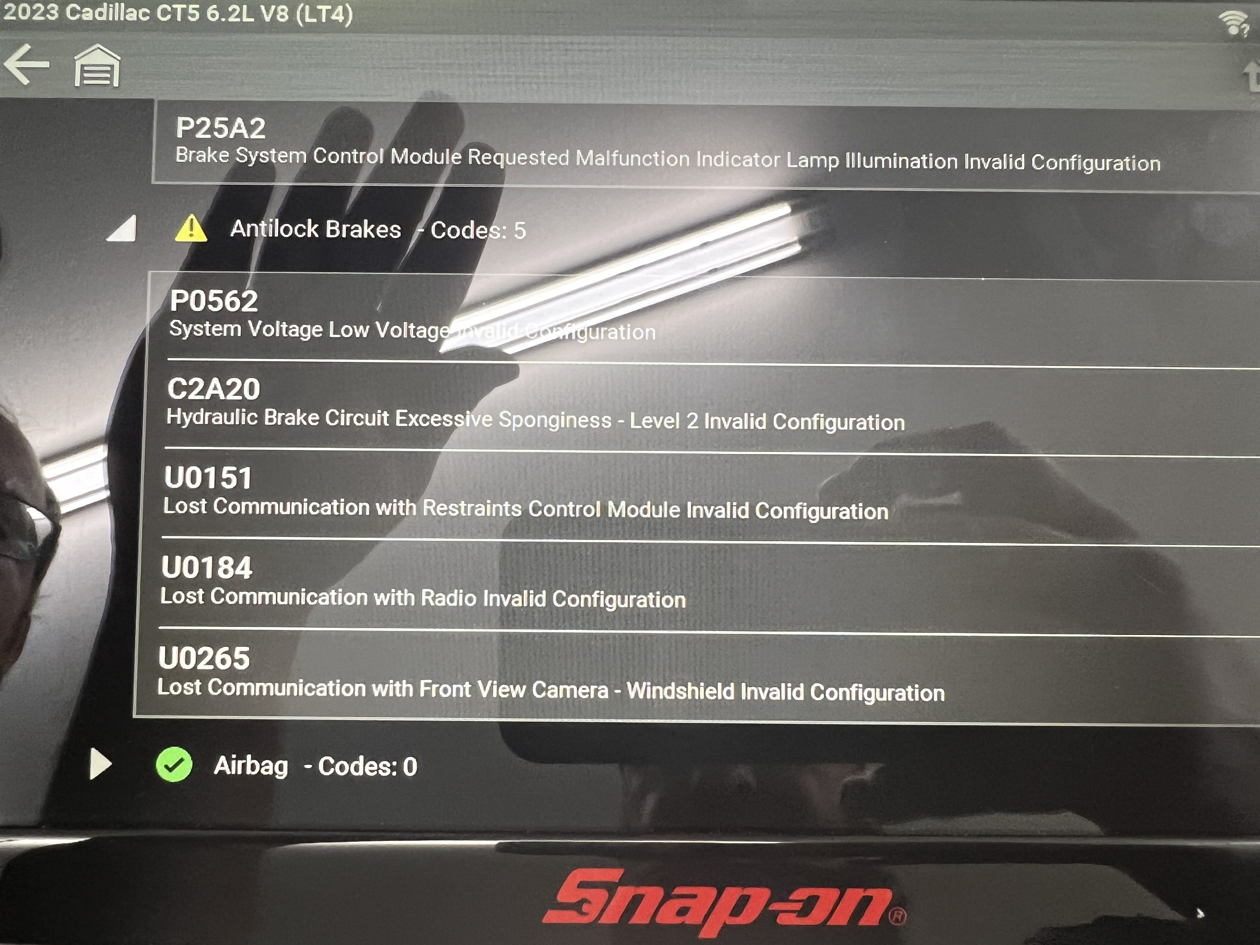

Left there and went to a performance shop to have the brake system flushed for Castrol SRF only for them to come back 2 hours later and say they’re not capable of doing it, and now they’ve been back there another 20 minutes with their computer hooked up trying to clear a bunch codes for whatever they messed up before they pull it out…
Not the best day and now I’m not even sure if I’ll make it to VIR
Update - they say that they sucked out the res and opened a bleeder screw (didn’t disconnect the battery) and when they couldn’t figure out how to use their snap on computer to turn off the ABS, they came out to me. Now the brakes don’t work, they car won’t go over 40, and neither Chevrolet nor Cadillac can get to it before Monday. FML…
It clearly says in the owners manual to disconnect the battery to do a brake fluid flush.
Sorry for your misfortune, this is the reality of new brake-by-wire system, it was the same in my M3..

Should have supervised but thought it was in good hands… will be sending them the bill from GM

@PL69 would you believe me if I told you that the “service manual” doesn’t say anything about disconnecting the battery? WTF GM?
There should be a warning on the cap of the brake fluid reservoir to tell the tech to disconnect the battery before a brake fluid flush. I was reading my manual and saw that, somewhat buried deep in the owners manual.
Yeah it’s clear on pg 224 of the owners manual but techs don’t read the OM, they read the service manual. Can’t believe it’s not in there
I am not that surprised since GM techs are supposed to have access to the tools to put the car in service mode.
