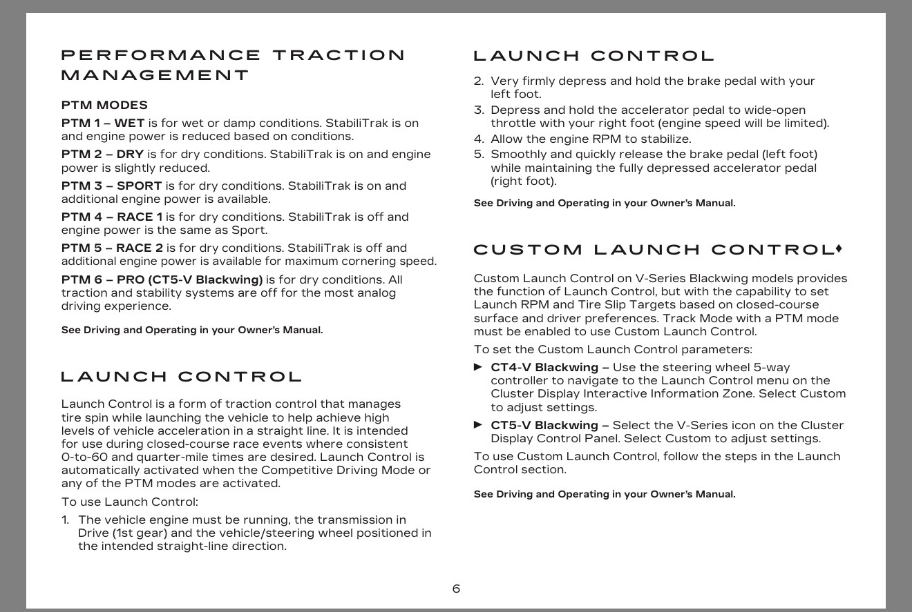

Just to pile on - the 2025 “V-Series Convenience & Personalization Guide” states that there is a PTM 6 - PRO (CT5-V Blackwing). “Is for dry conditions. All traction and stability systems are off for the most analog driving experience.” I’d really like to use this.
When I had a ‘25 I raised a question to the dealer pointing out the mode is unavailable. They said it would come in a future software update but I am not sure who they spoke to in order to learn that. Apparently Cadillac hasn’t been able to get to it yet as my ‘26 precision pack car doesn’t have it either.
On the ‘26 cars, I don’t think a V-Series Convenience & Personalization Guide even exists. One didn’t come with the car and I don’t find anything online, Cadillac or otherwise.
I suppose one can’t complain that the car doesn’t have the mode if they never told you it has it.
