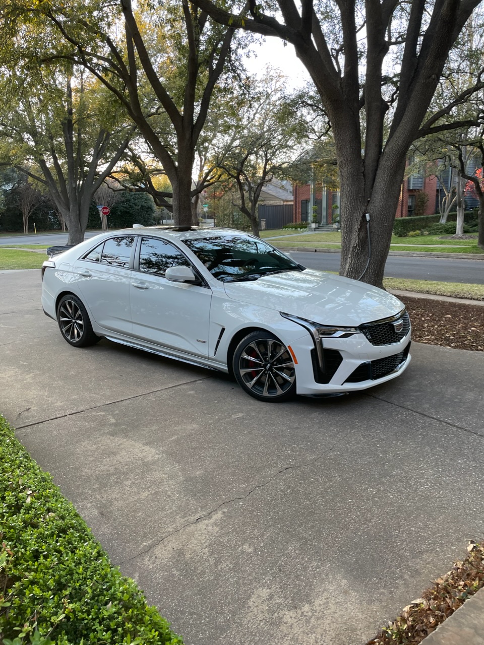

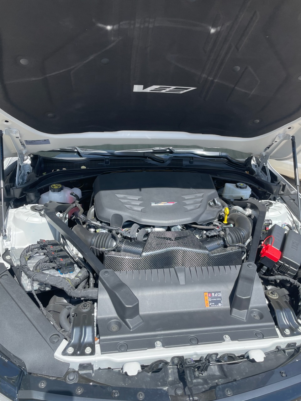

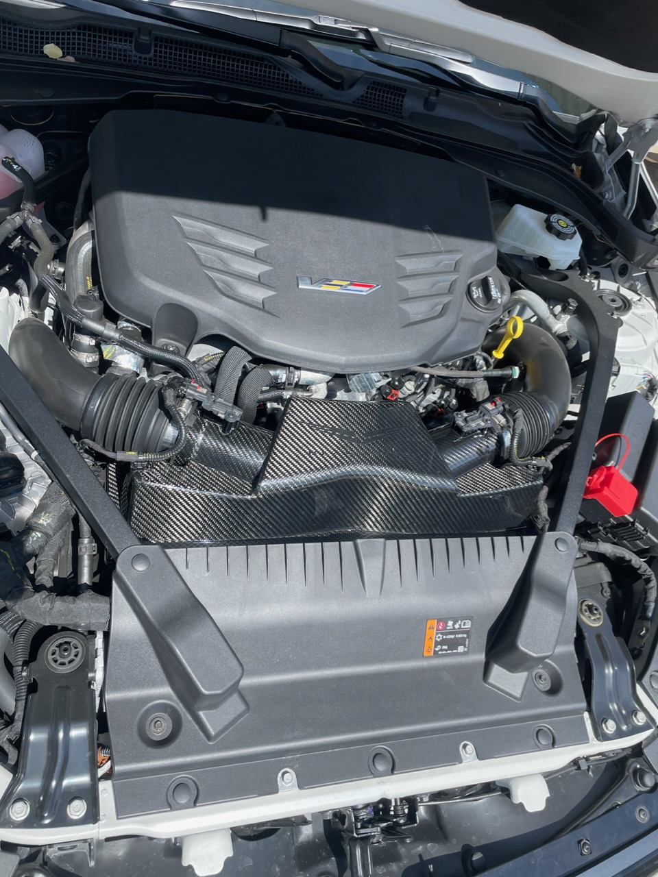

Posting to show my install. It’s really easy to do. There’s one screw on the passenger side that was annoying to get to. I love the look of this CF lid. I think I’ll start planning for the CF engine cover to complete the look under the hood. The BW pulls really nicely with this added. I’m not sure how much of a difference I can feel because I’ve been pretty gentle these first couple thousand miles. My story on the CEL: yep. It hit me too. The first start the idle was rough and I expected that. But computer caught it and it’s been good since. Later Saturday evening for my second drive it popped on at some point. The light is behind my steering wheel so I didn’t notice when it happen. The CEL was still there Sunday morning. But the second half of the day.. it was sunny here in Dallas. Was driving home from the gym and noticed the light was gone. Was that way for the rest of Sunday. This car isn’t my daily driver so I haven’t tested it today. But it’s interesting with this light popping on and now it’s not showing.
Side note: I also installed the CF spoiler and love the look.
