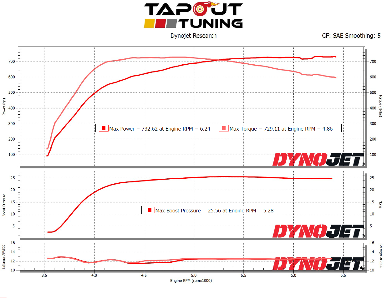

As previously stated, there is no additional turbulence in our design. Based on our innovations and performance track record, we feel that we are more qualified to discuss higher power level LF4s than any other tuning company. And on that note, we just reset the CT4-V Blackwing horsepower record last week running this 'design failing' of an intake.

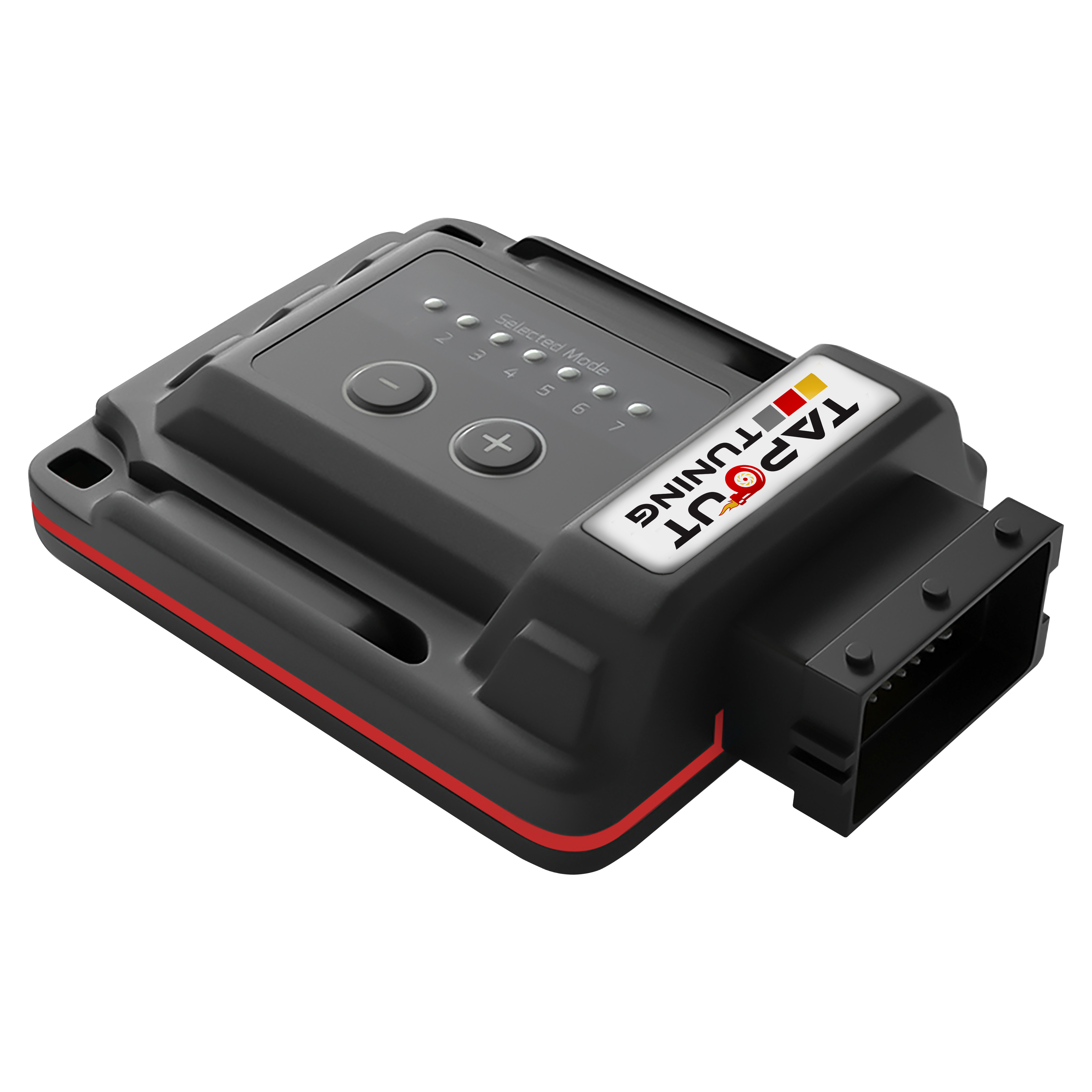

Our Tapout Tuning Module allows for electronic 'tuning' via MAF, MAP and TMAP signal manipulation. And we can go all the way to idle, where the codes are triggered. However, we need to get cars on the dyno in order to properly set this up. The Tapout Tuning Modules sell for $895, plus custom dyno tuning is required. And yes, factory spark plugs should be fine at the lower power levels.
Tapout Tuning Module (TTM) is available now, in conjunction with in house dyno tuning. Within the next few months, we should be able to start offering it for shipment with seven calibration maps preloaded.

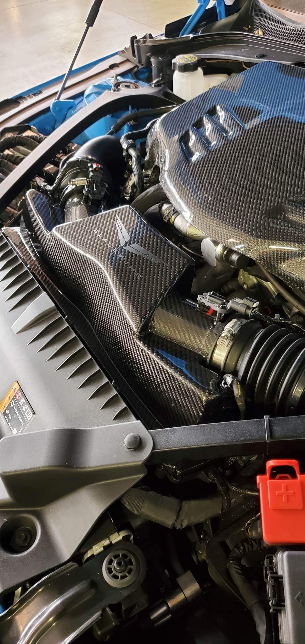

For those of us wanting to preserve the factory warranty for now

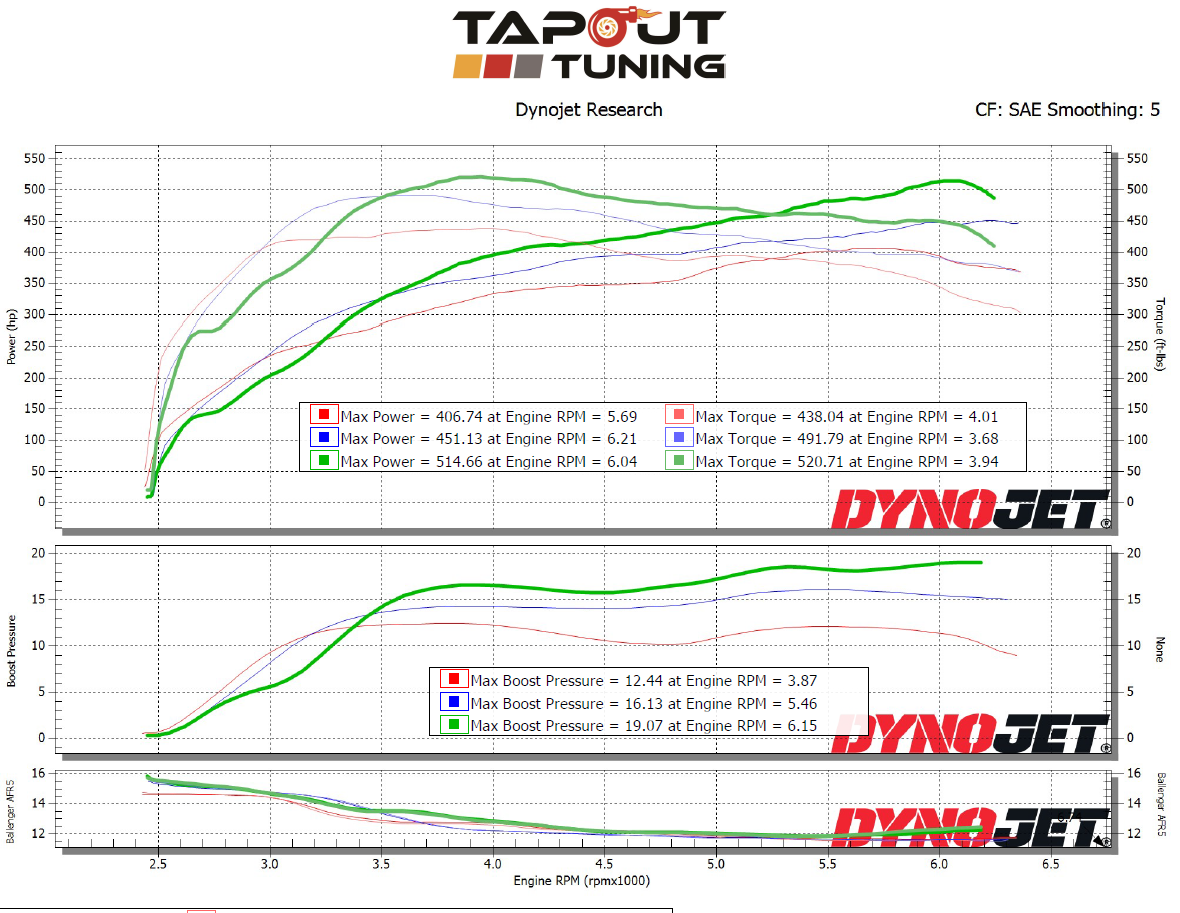

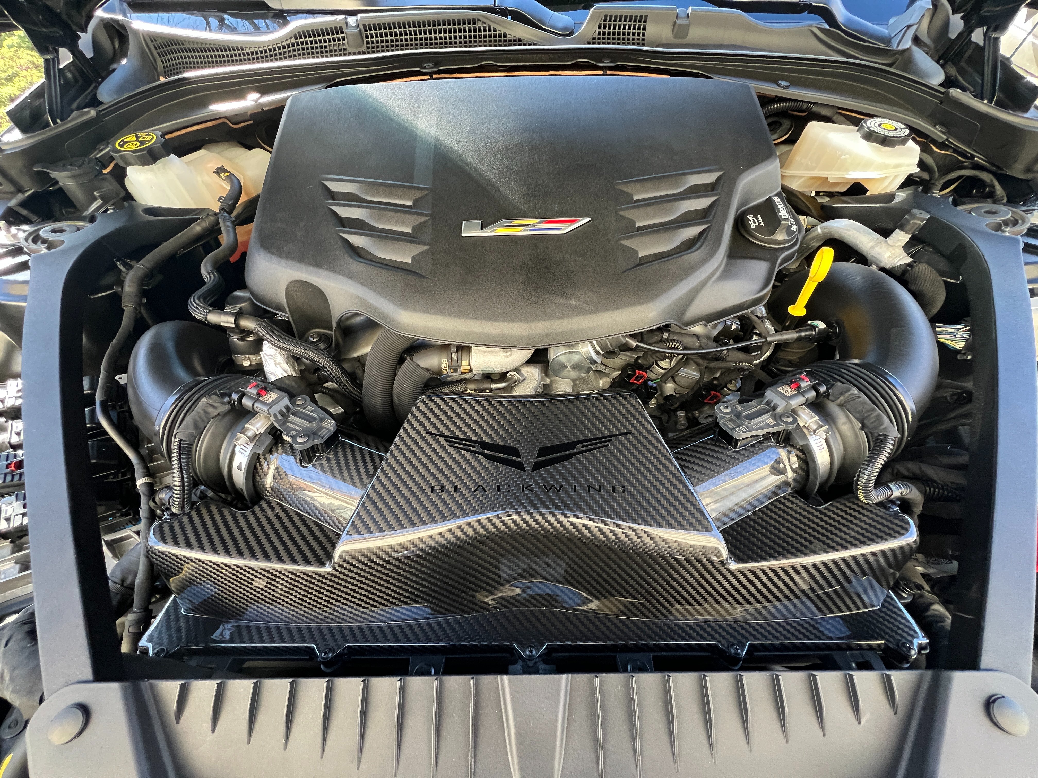

Our new carbon fiber intake system for the CT4-V Blackwing is a work of art. And it also performs! Internally, this revolutionary new airbox design functions in a proprietary manner that increases airflow and boost, without the ECM being aware of the changes. If you bolt this intake to your completely stock CT4-V Blackwing, you will instantly gain 30 to 50 peak whp. Even more impressive is the 70 plus whp gains you’ll have near redline!
These performance improvements take place with no other changes, and no tuning required. Idle, drivability and fuel economy will all remain the same as stock, as long as you stay out of the boost. There are no DTCs or Check Engine light issues. This intake system is safe for any fuel octane from 91 on up. If you’re currently running the JB4, you will need to work with us for some custom settings at the time you install the carbon fiber intake.
Coupled with custom JB4 tuning, you can expect to see gains of approximately 100 whp on 93-octane. Colder spark plugs with smaller gaps are required at this level, and when you add on our downpipes, you can make even more power!
2022 CT4V Blackwing M6 on 93-octane: stock (red lines) versus Tapout intake (blue lines) versus intake with Tapout custom JB4 tune (green lines).

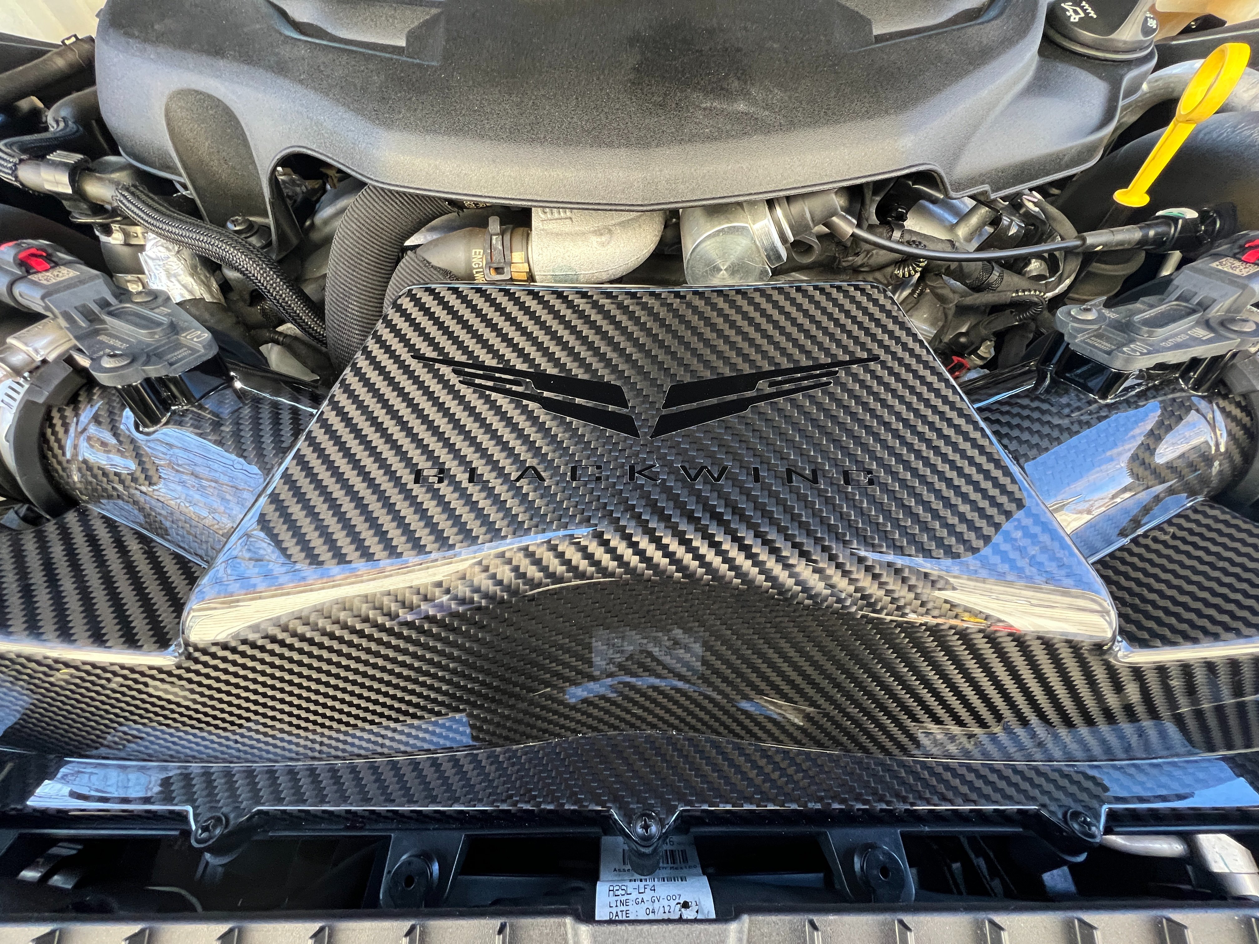

Yup, Purchased and got a constant CEL display.
Had to return back to TOT, Scott was good about it.
Had codes as well,
P1400 - cold start emission reduction control system
P0171 - Bank 1 system too lean
P0174 - Bank 2 system too lean
P0300 - Random misfire detected
Your mileage may vary...... : )
Over all, while I had it on, it seemed a bit more powerful, but not enuff time to truly evaluate.
So now, instead of mechanically/physically gaining power from the CFairbox, I will get it digitally through a ECM tune.
All said and done, it should give me about 525 WHP according to Scott @ TOT.
As for different sounding....., it really sounds about the same IMO.
For whatever reason, it didn't seem to want to work with my vehicle. Maybe because my vehicle was a APM?
