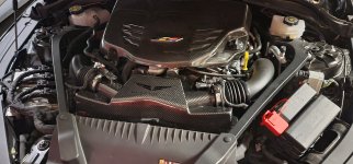

I received the intake lid today and put the blackwing sticker on. Looks really good!
Hopefully I'll have some time to install tomorrow.
It will probably be a few more weeks before I drive the car to test it out though. Only driven it once since early December for about 20 miles. Almost spring though!

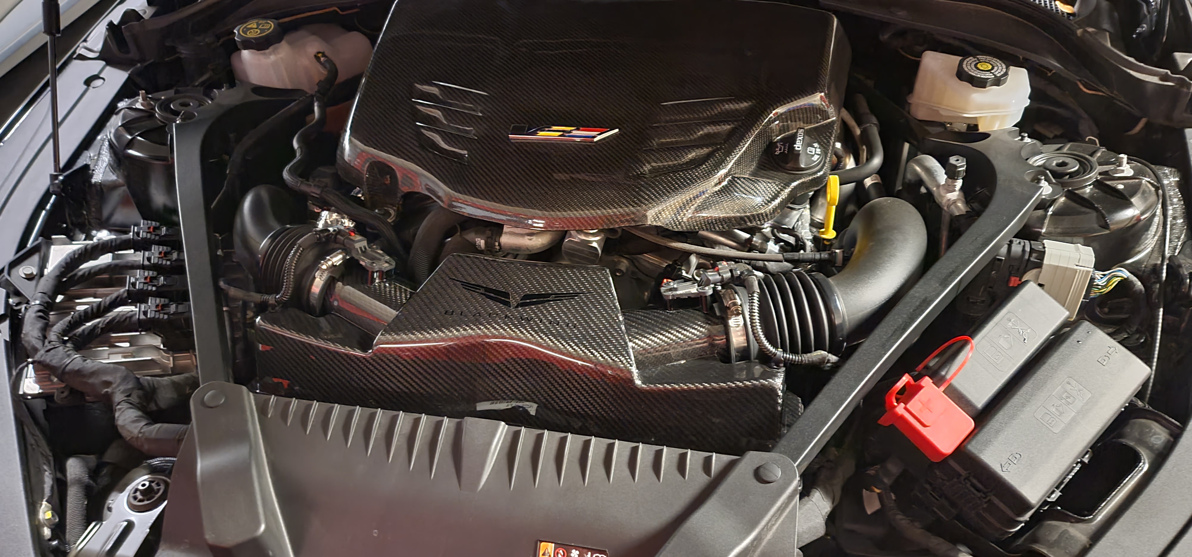

Be ready, the rear passenger side screw is a total pain to get to.

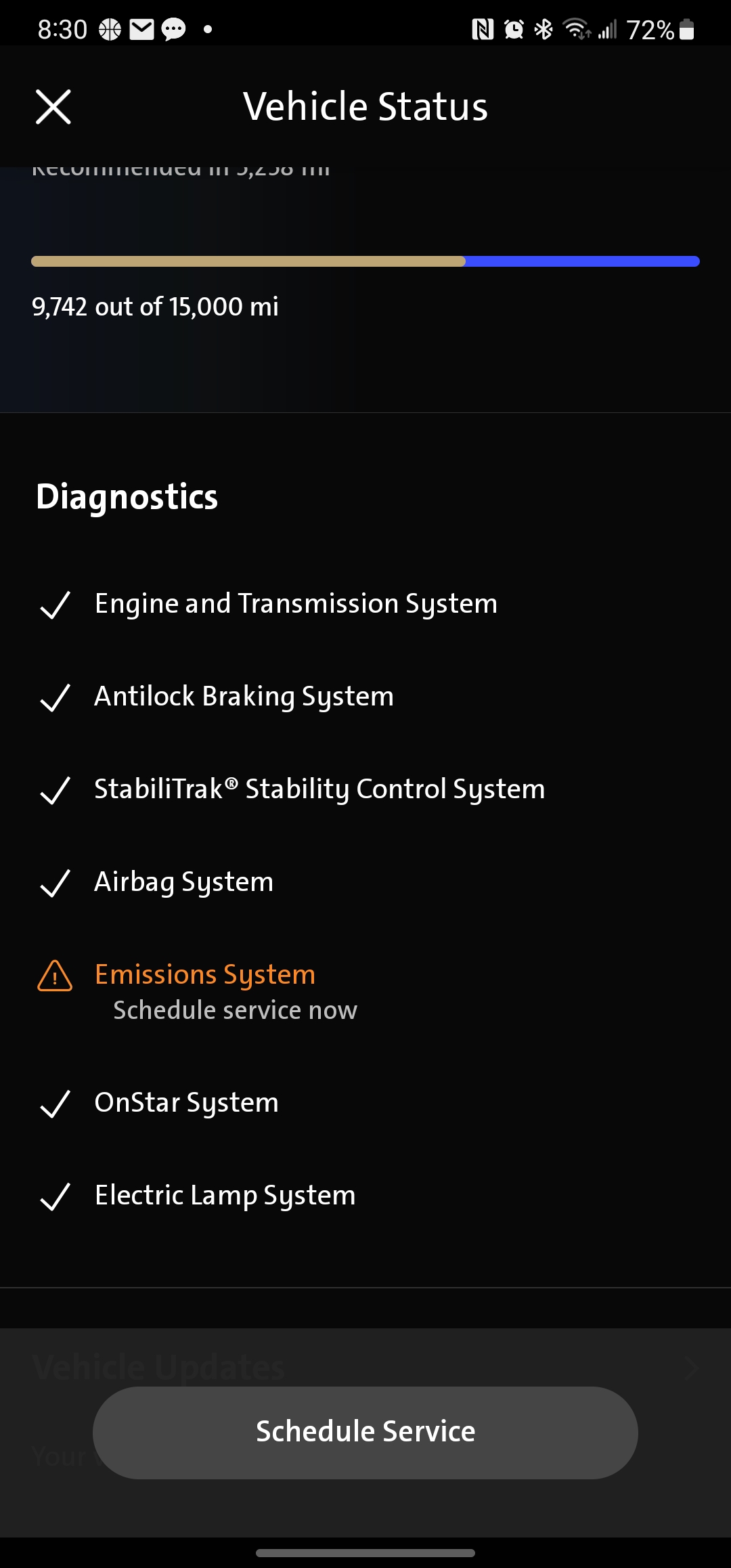

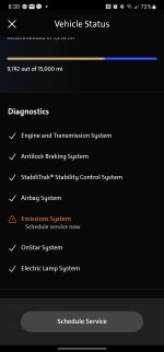

Whelp, the temperature dropped and she started throwing the CEL. Drove fine but yes it looks like in cooler weather it will throw a CEL .
