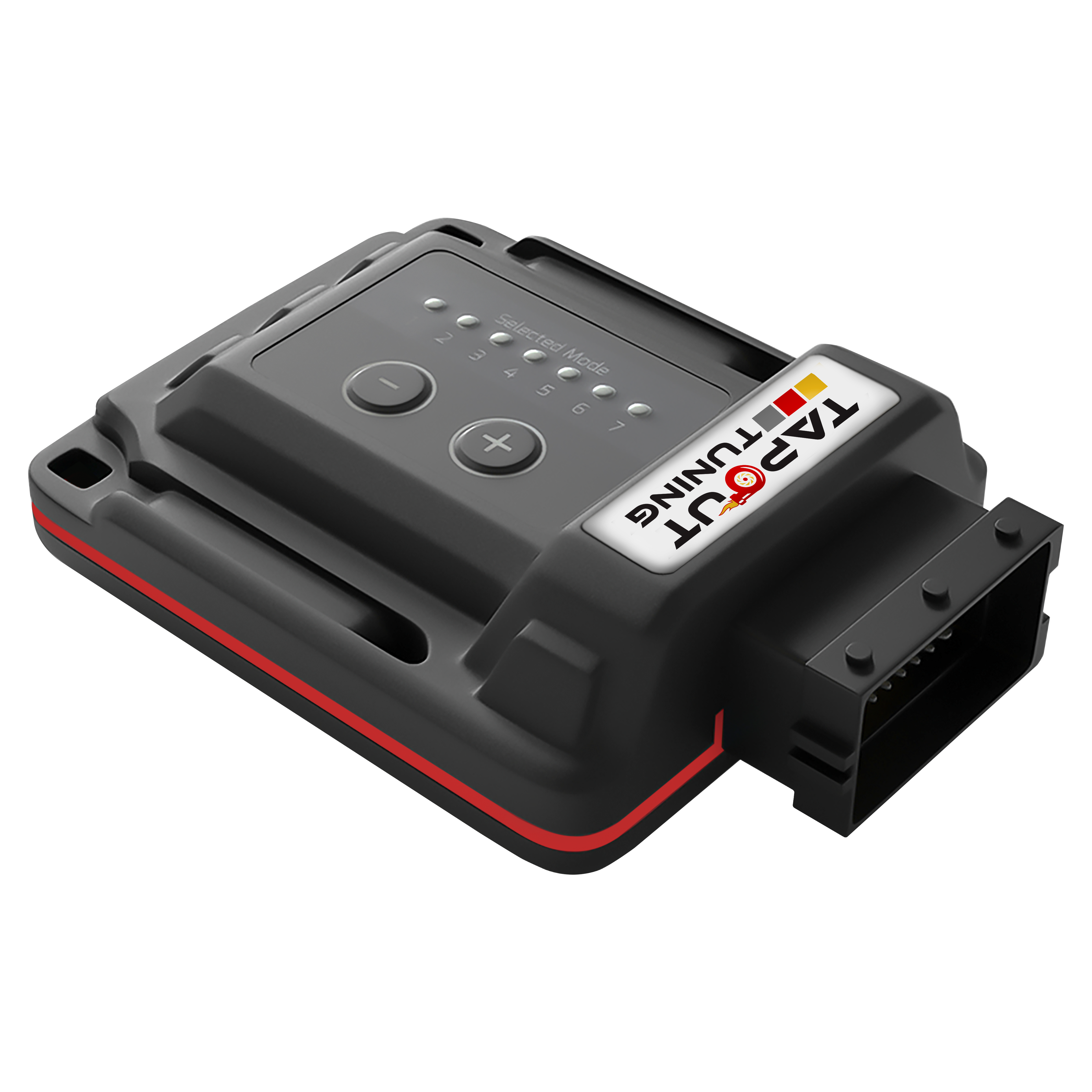

Our Tapout Tuning Module allows for electronic 'tuning' via MAF, MAP and TMAP signal manipulation. And we can go all the way to idle, where the codes are triggered. However, we need to get cars on the dyno in order to properly set this up. The Tapout Tuning Modules sell for $895, plus custom dyno tuning is required. And yes, factory spark plugs should be fine at the lower power levels.
I think they said in one facebook thread , they expect to release it in the next few months
Tapout Tuning Module (TTM) is available now, in conjunction with in house dyno tuning. Within the next few months, we should be able to start offering it for shipment with seven calibration maps preloaded.
