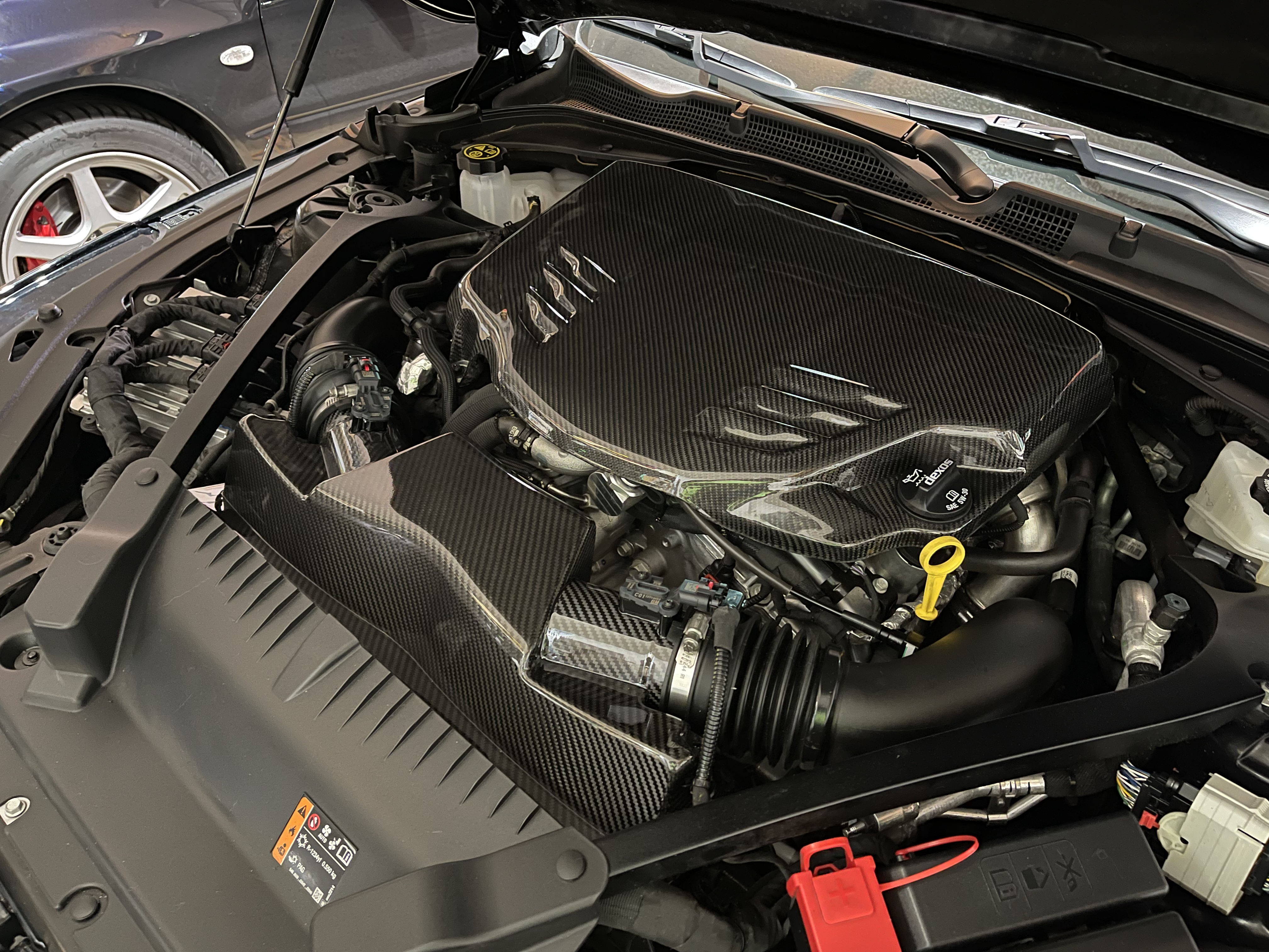

It all comes together with the engine cover. Now I want a matching radiator shroud 😭
I installed mine over the weekend and drove it for the first time today. It definitely feels quicker to me, even in the lower RPM range. I wasn't able to really get on it due to too much traffic on the road.
