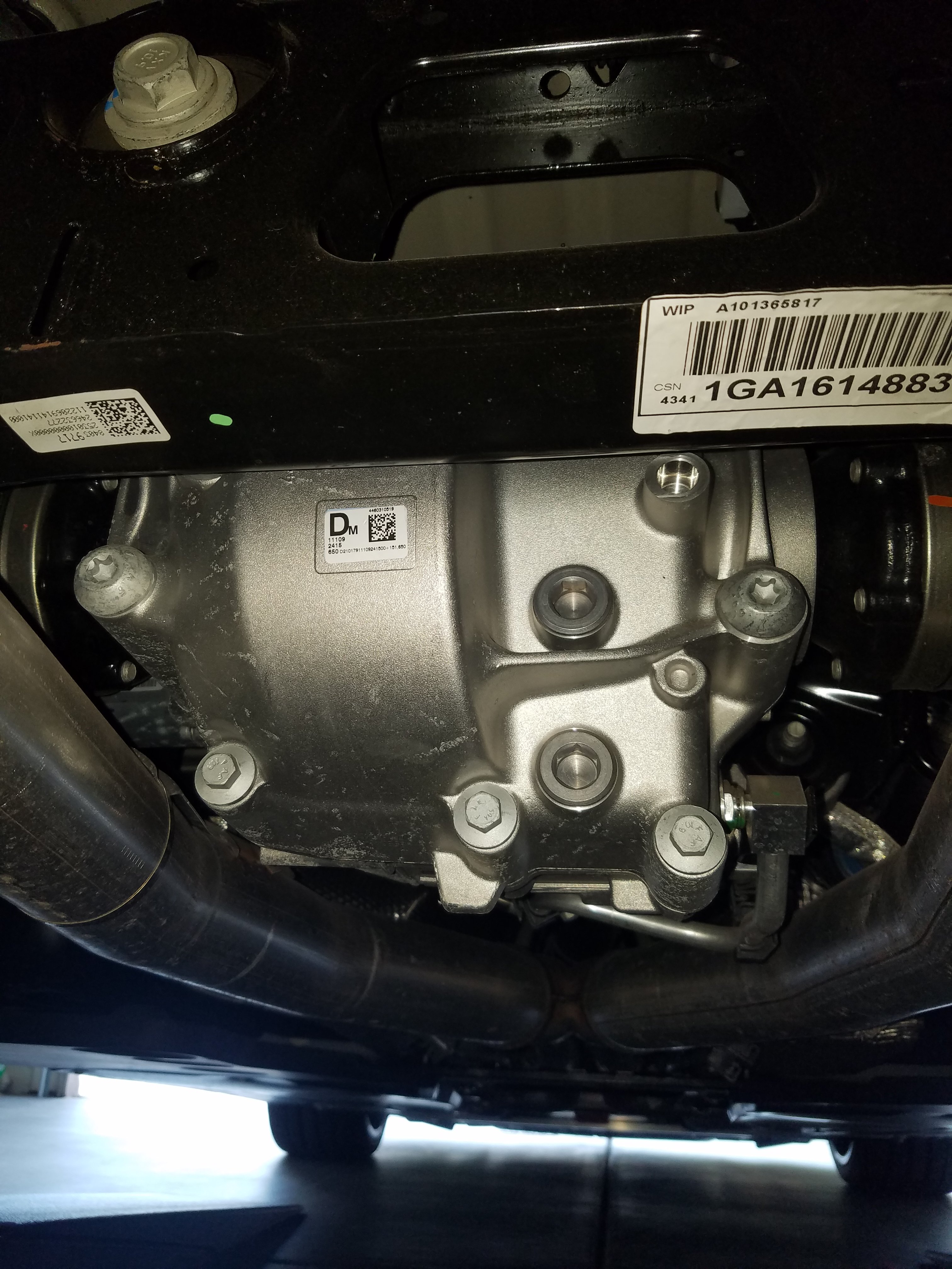

Rear Diff done today? Anybody know why GM is not using Magnetic drain plug on these?

I suppose I could? Most OEM Diffs I have take off have Magnetic drain plugs? Anybody know WHY CTV BW don't?

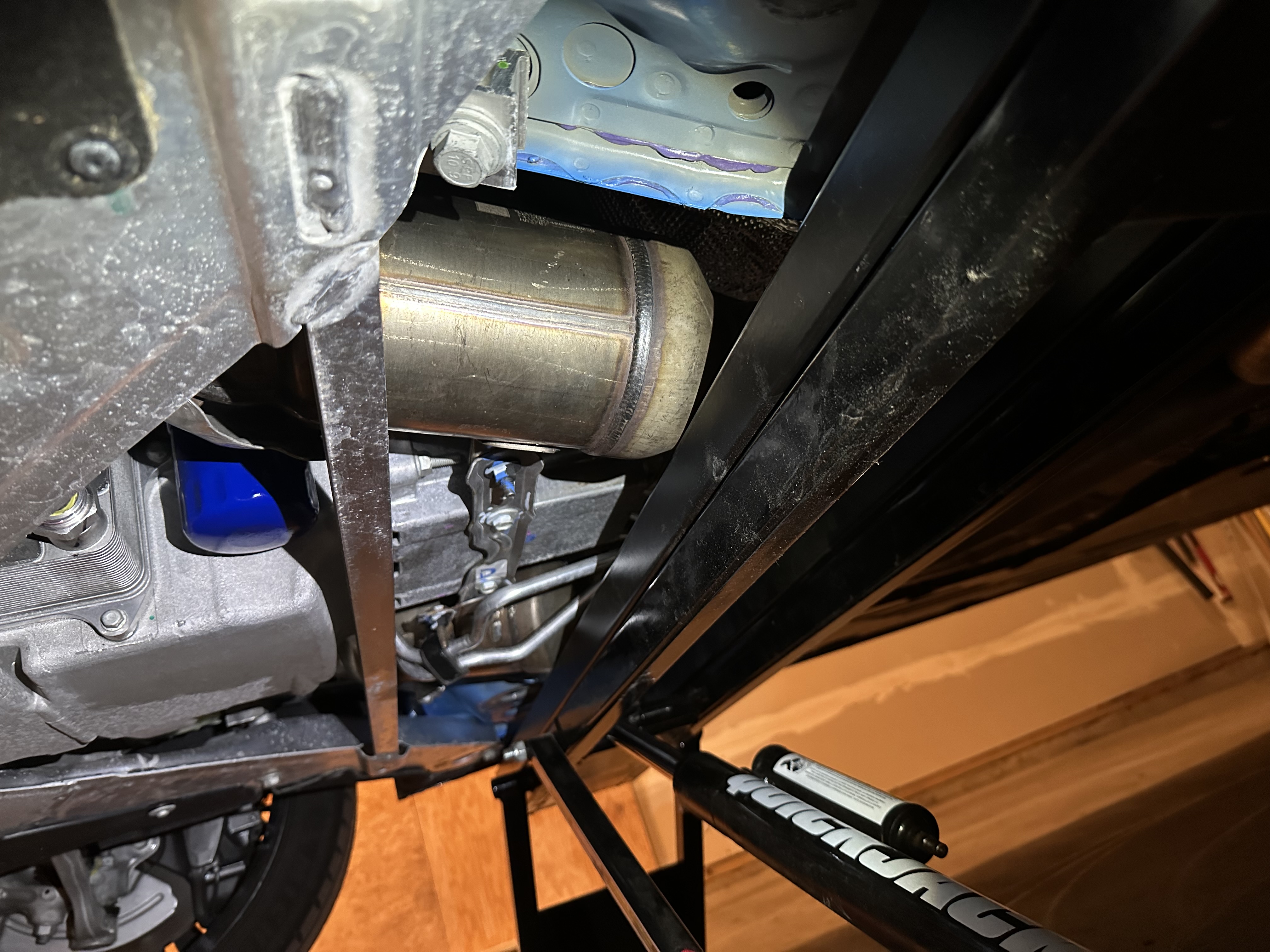

Just did my 5BW diff flush. Got the fluid from my local dealer which services approx 1 5BW per month so they gave me the fluid that match the picture listed on this thread. Stuff isn’t cheap! I got my car jacked up using quickjack. Took a while to figure it out. I have a 6000 series that was short 2 inches lifting the car perpendicular. Such then I had to add onto my 7000 series extender that I use to lift my bmw x5 perpendicular. Yes, you can use your quickjack this way and is confirmed by the company. They even have a video on it. I used the smaller rubber block with the quickjack and you can see the jack almost touched the catbacks. Need to see how to use the taller blocks next time. The oil filter and bolt can be accessed even with the quickjack for oil changes which is good.

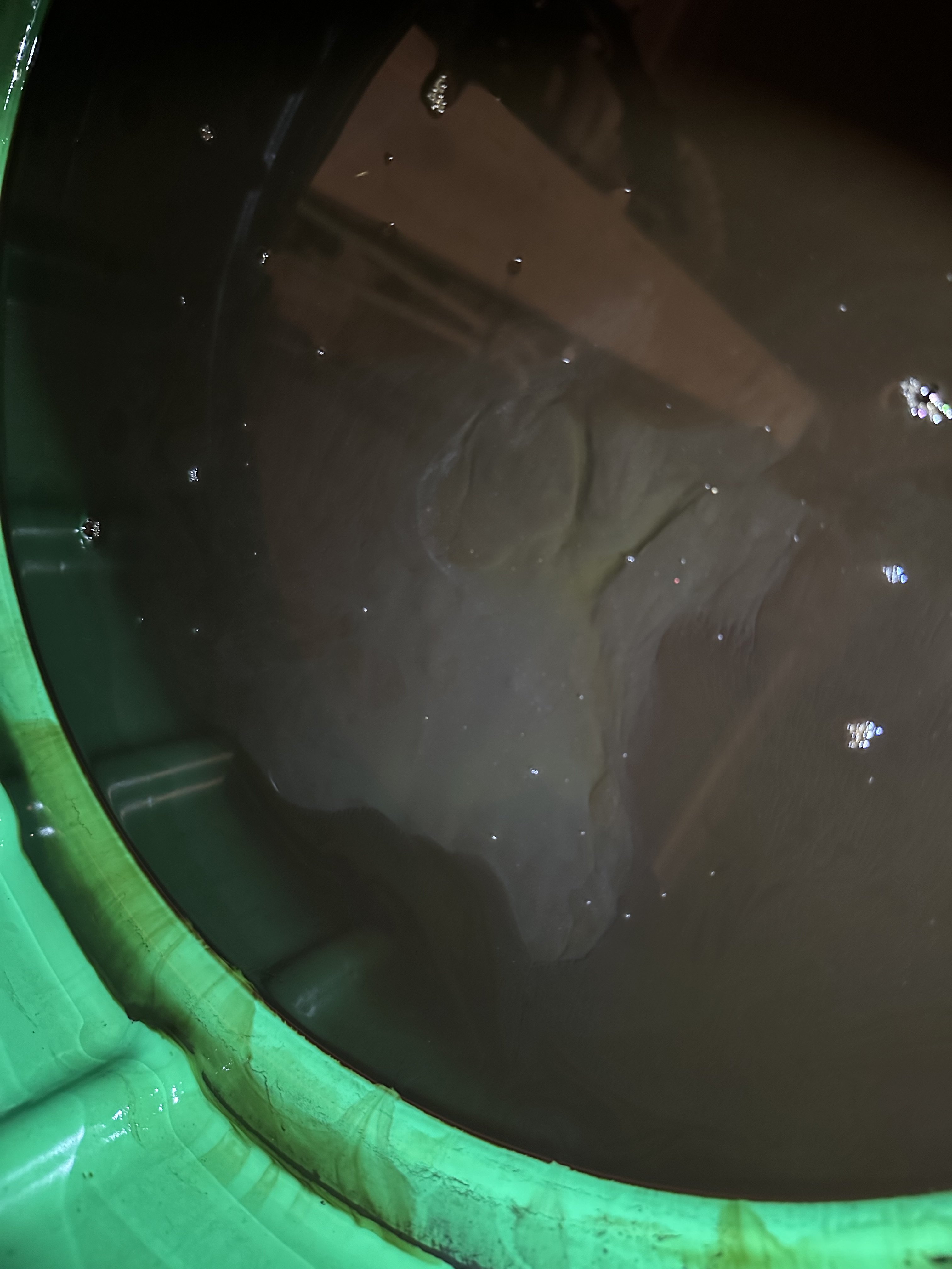

Anyhow, got a T70 and barely fit the gap to open up the two plugs with my socket set. I’m at 1639 and the fluid had a shiny metallic hue to it when it drained. Even though I haven’t tracked it yet, and kept it pretty mild to 1500 miles, the fluid was not clear. I did the diff in my Honda truck with 7000 miles on it and I could see that fluid was clear. This was not. Glad I did it early even without tracking.

Would you mind sharing a couple pics of your Quickjack with the extenders attached?

For those that care, Magnetic drain plugs are easy to find for these drivetrains.
I gave up on the Quick Jack's because they weren't quick.... switched to Esco jack stands and haven't looked back. I'll be adding a two post lift in the new garage.

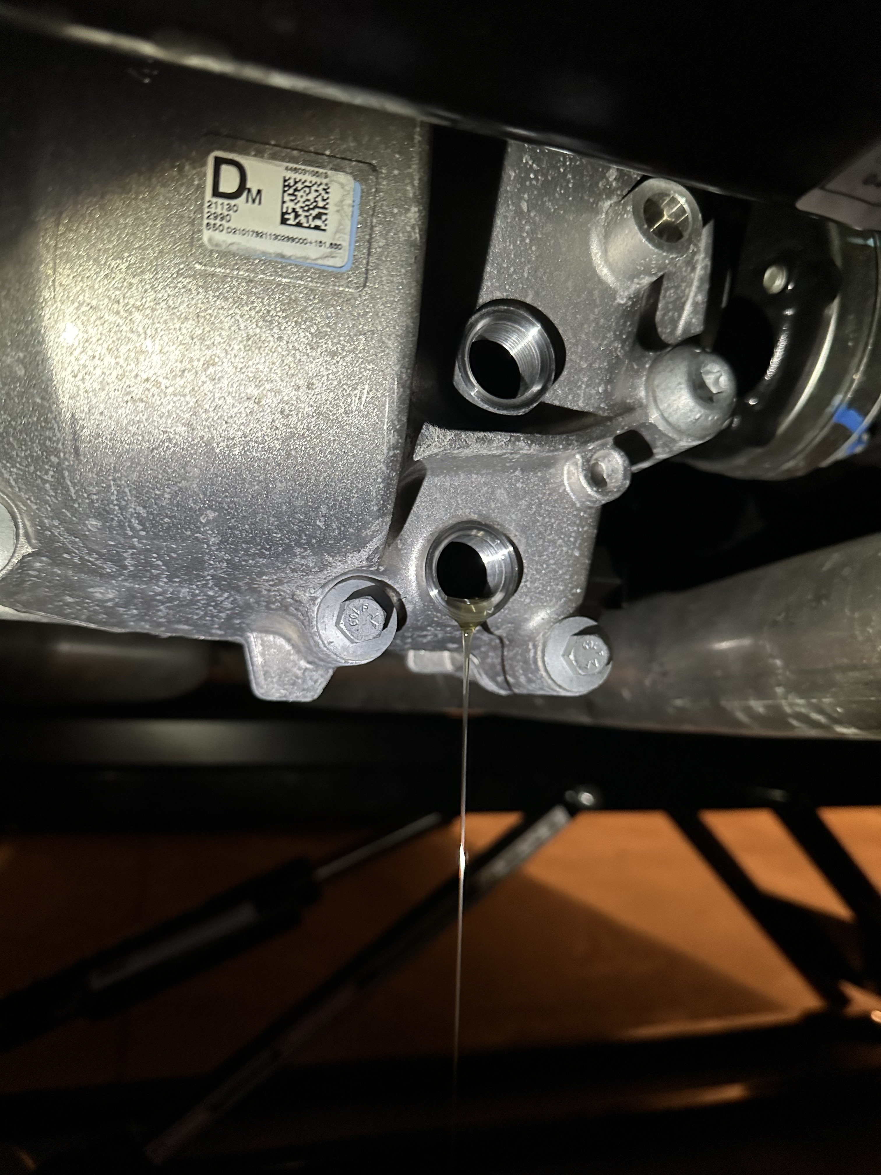

I did mine around 1,600 miles and it was clean, maybe slightly opaque but about as expected for so few miles. There is no crush washer and it's not pipe thread, rather it's a plug with a small oring machined into the sealing face.
