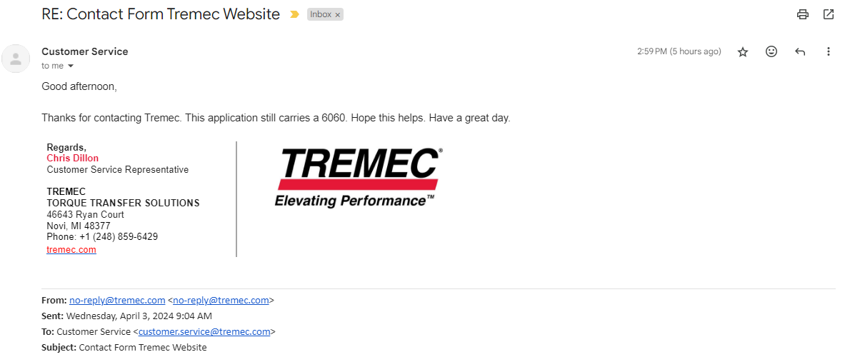

Exactly and as I recall I checked the Tremec website and saw ATF there as well.
I'm dubious on the whole "internet guy recommends this magic sauce" thing. OEM's spend millions validating fluids and just because Larry and his buddies all run some fluid cocktail without issue is not evidence of anything.
Of course. For me the essential part of the equation is: when you buy directly from TREMEC and they are responsible for the warranty, they recommend HP-MTF.

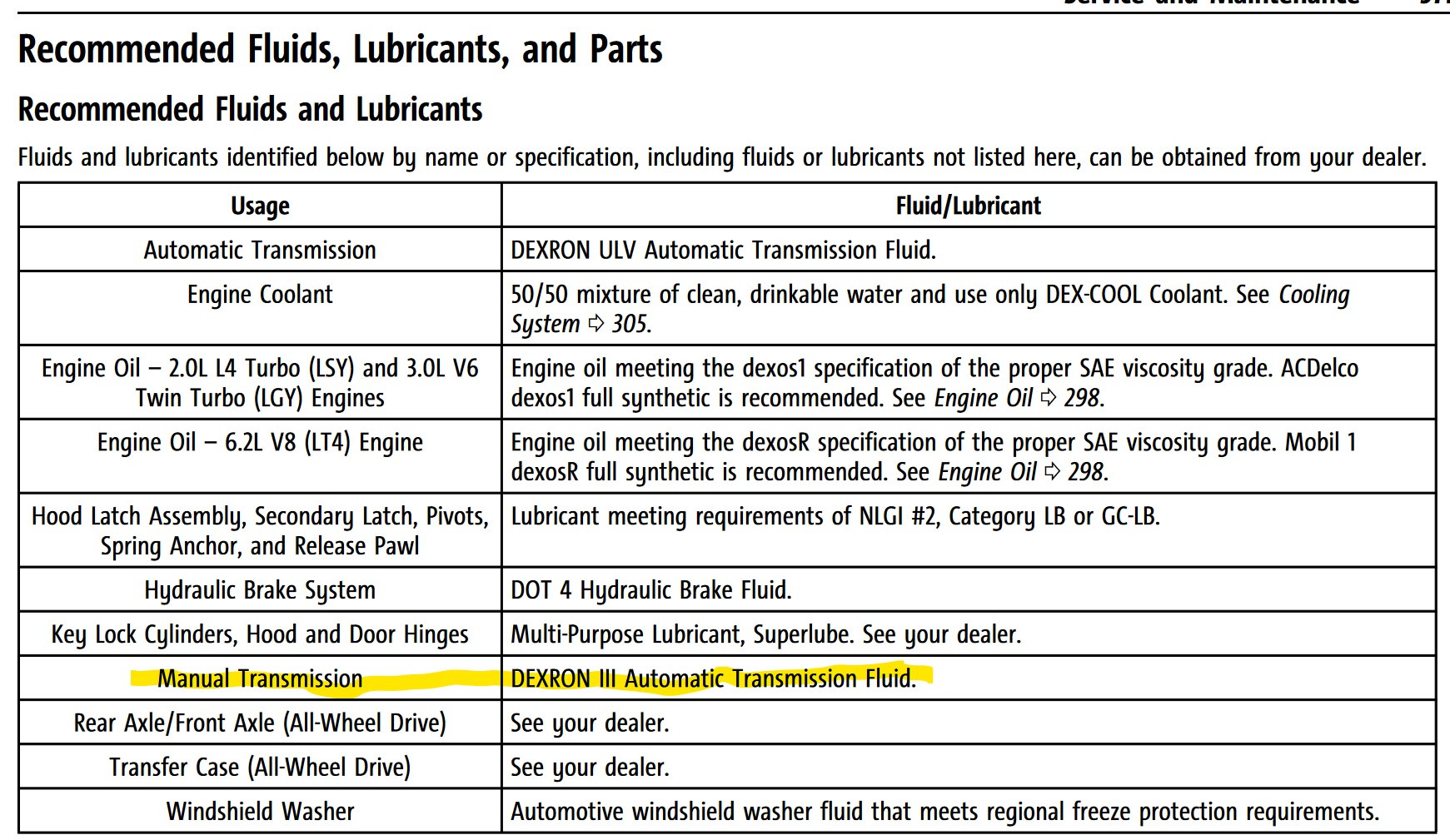

The owners manual for the 4 says to run Dex3 ATF in the manual tranny

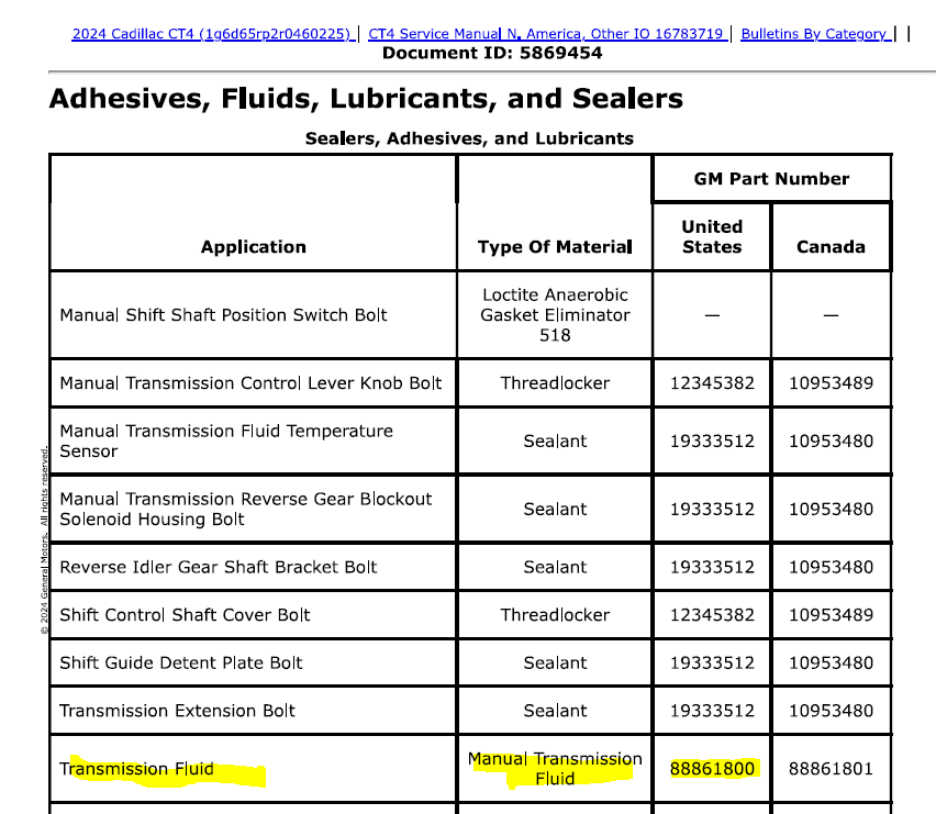

this is what is SO frustrating and confusing. Your image in exerpt from the OWNER manual. My CT4 OWNER manual also says Dex III. But my excerpt is from the SERVICE manual which specifically calls out the gear oil. I am shocked by how inconsistent and bad the documentation is. How do we find out for sure - 75W85 gear oil and ATF are VERY different!

Interestingly enough, I had not looked at the severe operating considering section of the owner's manual and it does specify a 45K mile change (same as the diff) for the 6MT, which I suppose is what I will follow.
I started to research the fluid for the 6MT in the 4BW. It looks like the "Manual Transmission Fluid" (88861800) is actually Dexron III. Which is an older ATF fluid. transmission oil type Z06 ?? DEXRONIII OR THIS P# 88861800 - CorvetteForum - Chevrolet Corvette Forum Discussion
I still see some discretion on the fill level. Some say to drain the 8oz and other's say it doesn't matter.
FWIW: When my transmission was replaced by Cadillac, the fluid used was 88861800 which is the ACDelco 75w-90 Manual Tran / Transfer case fluid.
