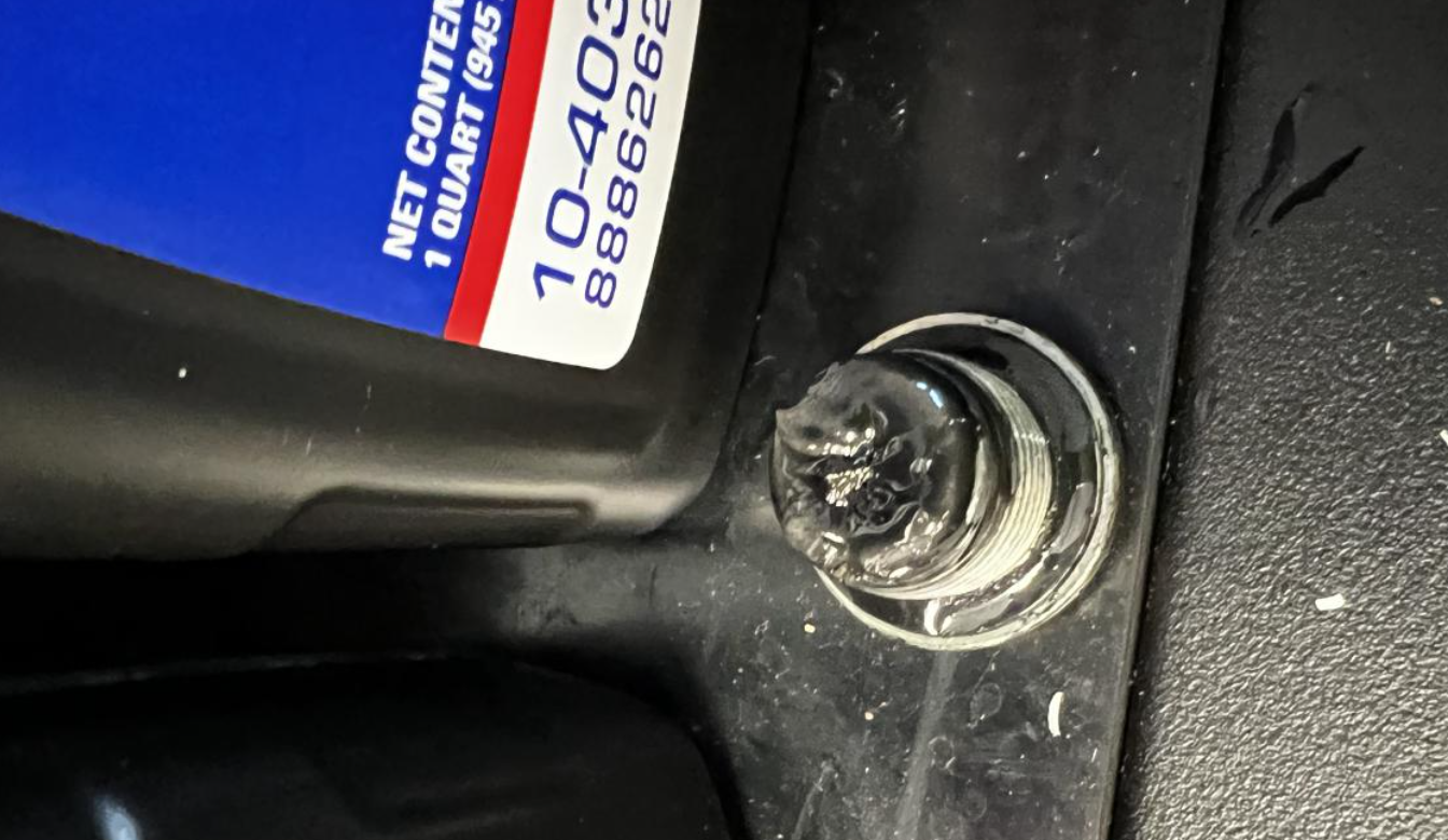

When I changed the E-diff fluid on my ZL1 after 1500 miles this is was the magnetic drain plug looked like. I was told this silver sludge is the clutch pack material that gets picked up. Did you notice anything similar on the 4BW drain plug when you drained and replaced the fluid?
My 1LE looked the same way, the blackwing was pretty clean all 3 times I’ve changed it.
I replaced the stick gears on my diesel with Yukon 4.56 to accommodate for the bigger tires I was running and when I changed the diff fluid after break in, that’s about what I found. Pretty normal for new gears to lose some material during break-in

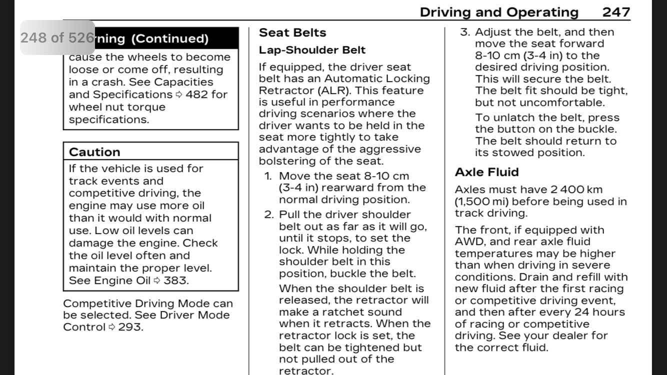

The owners manual actually says do it AFTER the first track day.

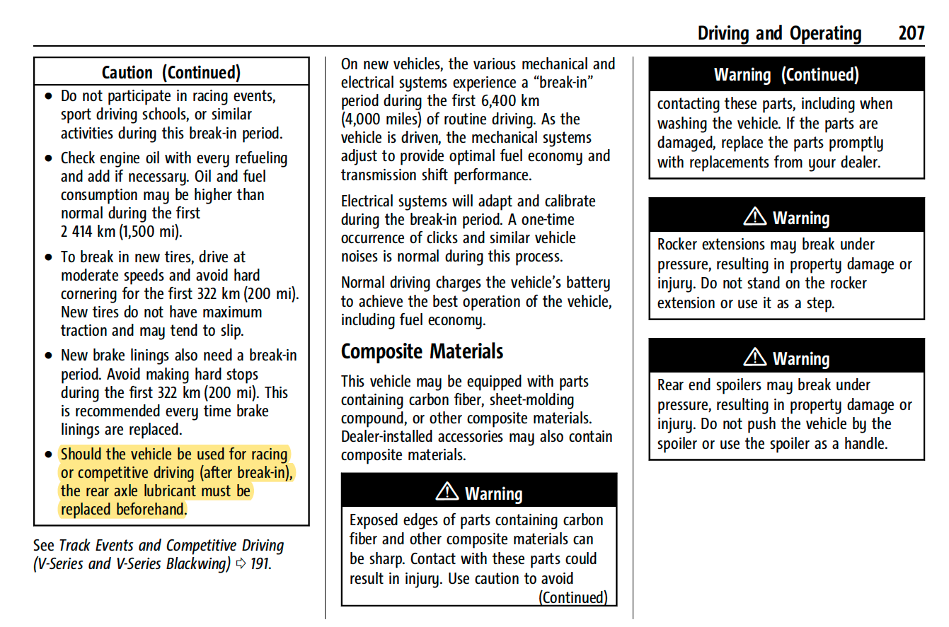

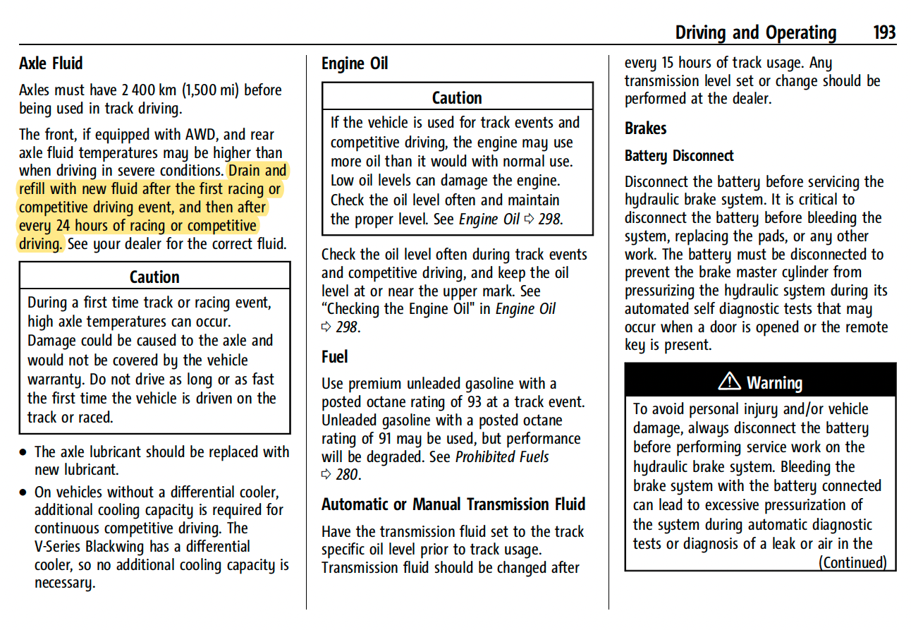

Owners manual for a CT5-V Blackwing says to do it both, before and after. (after 1500mi and before first track event, then again after first racing or competitive driving event and after every 24hrs of competitive driving.)
So is anyone changing their 5BW's diff fluid both before AND after their first track day? My gut feeling is that one or the other is necessary--what does the ZL1 manual say to do?
