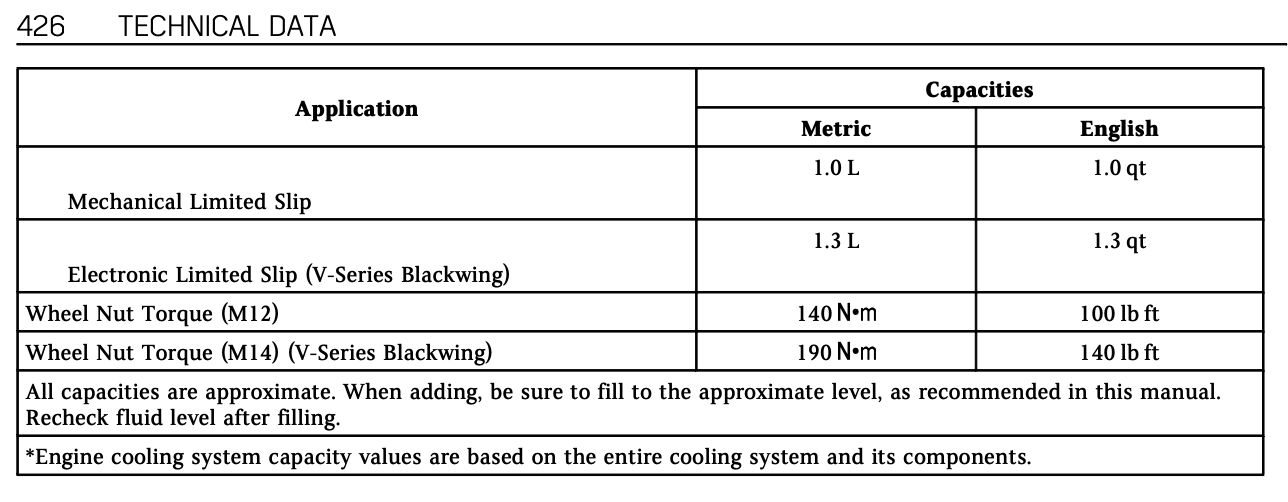

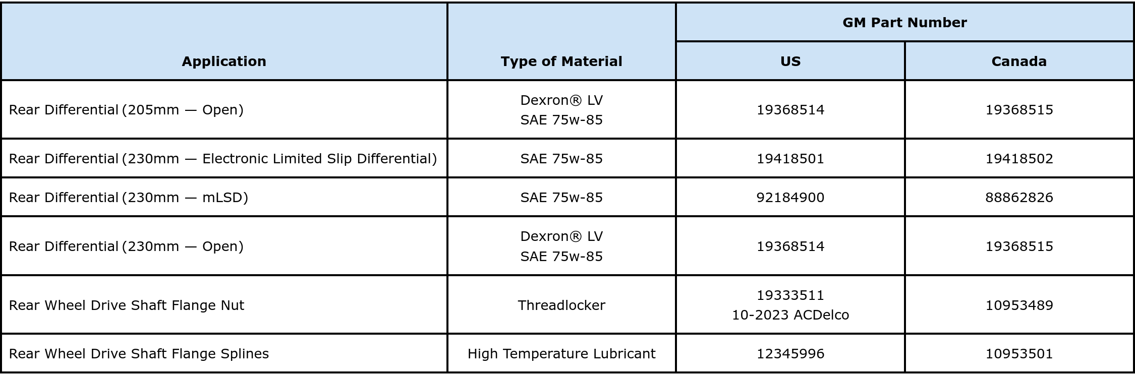

For the 5BW, I just filled until it started to overflow, then I re-opened the drain to pull some of the fluid from the bottom, capped, and topped off (that extra bit is just my OCD, not in instructions.)That could mean two different things. They share the same cooler, but independent fluid lines or they share the same fluid (highly unlikely).

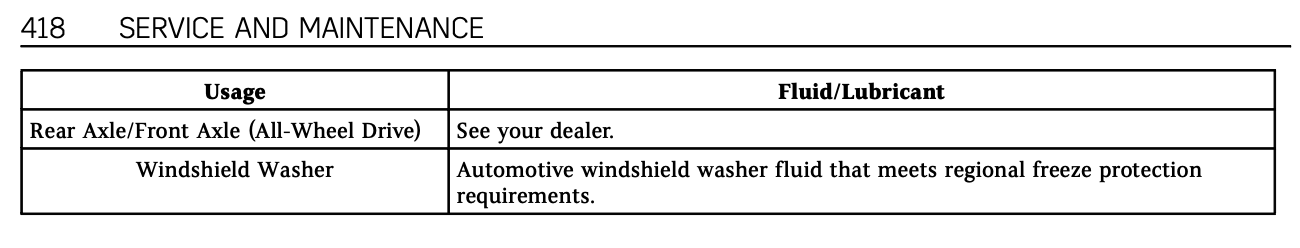

Regarding the amount of fluid to replace does the FSM say to add a the specific amount or to fill until fluid flows from the top hole?
