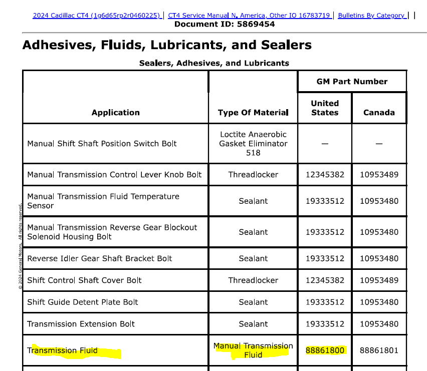

Thanks for your reply, but I am confused. Per the service manual 88861800 is specified as the transmission fluid which is a 75W90, not an ATF. On the Tremec website, the 6060 spec sheet lists Dexron III as the fluid - this seems to be the opposite of what you mention above. the OEM 88861800 is like $7 a quart, so I was just planning to do that.

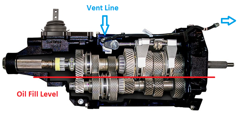

It's not that Redline or AMSOIL don't make oil suitable for the T-56 or TR-6060, or that Dextron III and HP-MTF oils contain some special sauce; the root cause of the problem is lazy research. Ultimately, if you want to run Dextron III or HP-MTF, do it. If you want to fill your transmission per Tremec recommendations, do it. It doesn't matter, but be my guest.
Overfilling doesn't help or hurt--the T-56 and TR-6060 have a vent so there's no overpressure potential. All fluids expand under heat, and as long as you don't lose the bubble (e.g. by rotating the transmission and literally filling it up so that the vent can't operate) it doesn't matter what the coefficient of thermal expansion is.
The discussion about churning and frothing due to overfilling is unbelievable levels of stupid because if you have any oil in the case (well, beyond a half a quart), the gears will be immersed in fluid and churning it up. That's what the antifoaming agents (e.g. silicon) are for.
How do you think the oil gets to the gears on cars without an oil cooler pump? What happens when you accelerate hard or corner hard? Where does that oil go? Clearly it's not a problem for oil to get everywhere--in fact, it should and does get everywhere. Obviously this is not to say that you should roll the transmission onto its right side and fill 'er up. The losses from submerging the gears would be stupid high and you would be stupid for wasting your money that way.
The point is, if you're worried about transmission failures or accelerated wear, you should be worried about having the right friction modifiers in the oil and complete lubrication (as opposed to starvation)--those are the things that kill transmissions.

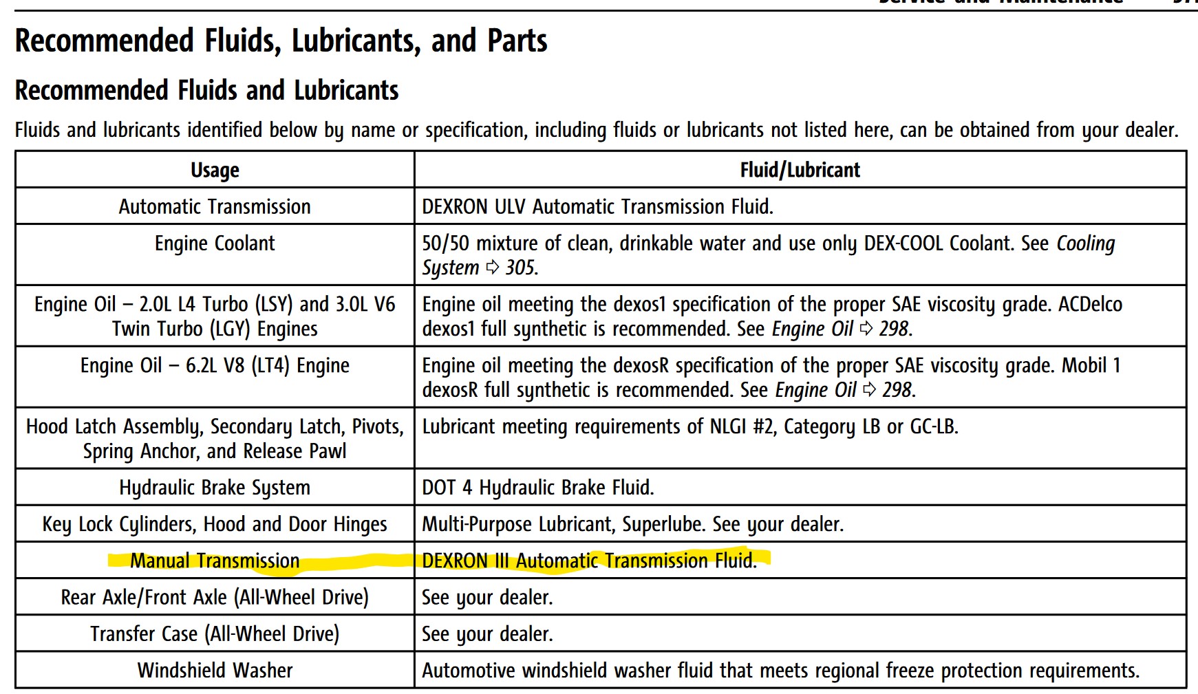

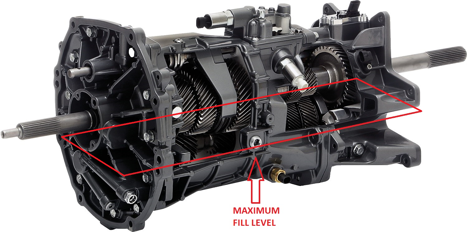

When I got my 6th Gen, I bought the service manual (pg 12160 in mine). It was emphatic about the procedure to not overfill the case. The whole 'bend mechanics wire 1/8' in length' or remove 8oz once you fill to the bottom of fill port.
When researching best care and feeding of the -6060, I called TREMEC and the person who I eventually corresponded with said the overfill precaution was due to the expansion properties of ATF/Dexron. He said when you buy the same transmission directly from TREMEC or a supplier like Summit, they recommend their HP-MTF (or equivalent) and there was no need to do the 'overfill procedure' since MTF does not have the same expansion issues as ATF/Dexron.
What is interesting (anecdotally, perhaps) is the manual transmission in the V6 6th Gen does not use Dexron and has a fill/drain procedure that is 'fill to the bottom of the fill port and call it done'. The M6 in the V6 is NOT a -6060.

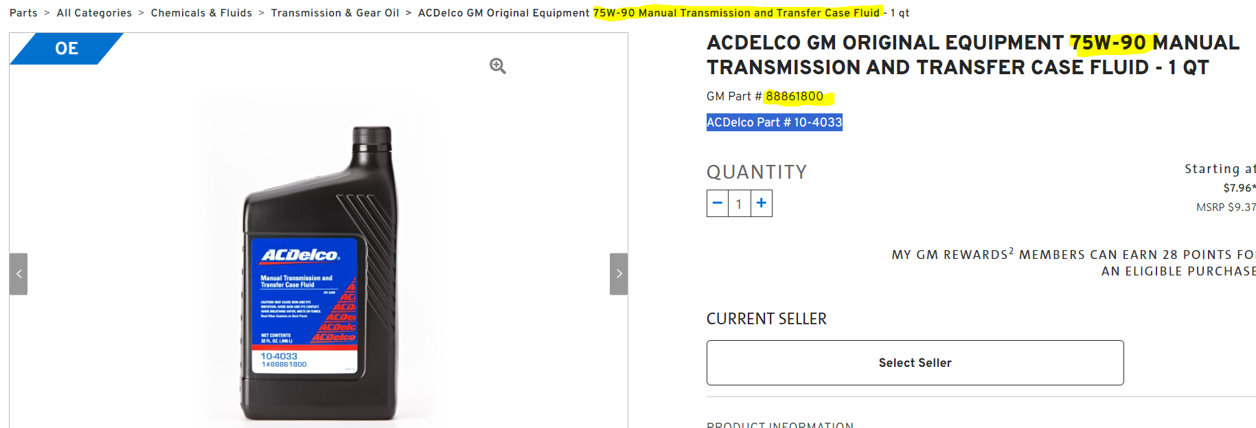

But this is where I get REALLY confused by this thread. The service manual indicates 88861800 of the MTF. Per GM / AC Delco 88861800 is 75w90, not ATF.
Right, the OEM fluid is NOT ATF. It is gear oil. Running straight ATF is bad. I think people are confused by that last statement because the internet is saturated with threads recommending Mobil 1 ATF and straight D4 ATF. Those are bad recommendations, and if you dig, you'll find out that those people later reverted the oil or ghosted.

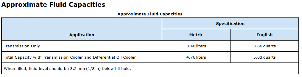

Got it. Thank you! But then based on your prior post, if I drain and fill with the OEM AC Delco gear oil, should I still under fill by 1/8" or fill to run out? The maintenance procedure indicates to underfill, and presumably they assume use of OEM fluids, so that's probably what I'll do.
