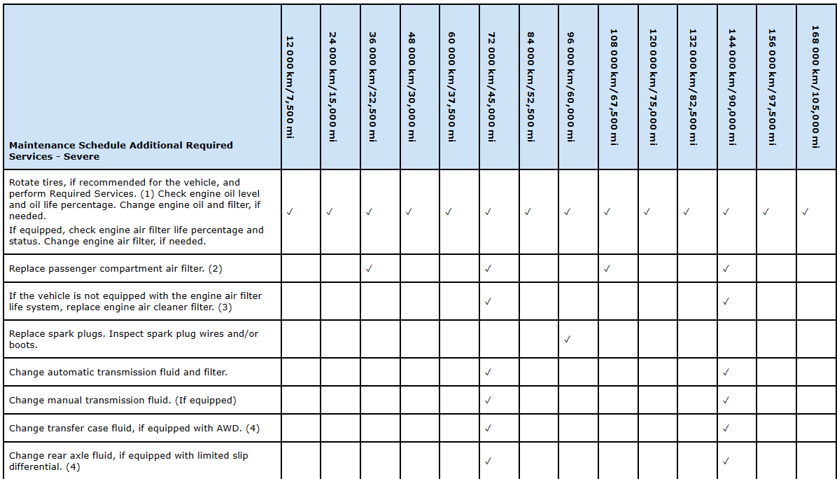

What is the schedule? On my ZLE it was 1500 for the first. I can't find it for the CT4 in the high performance supplement unless I missed it.
My local dealer recommended changing the diff at 30k. So I would assume do it again at 60k and 90k.

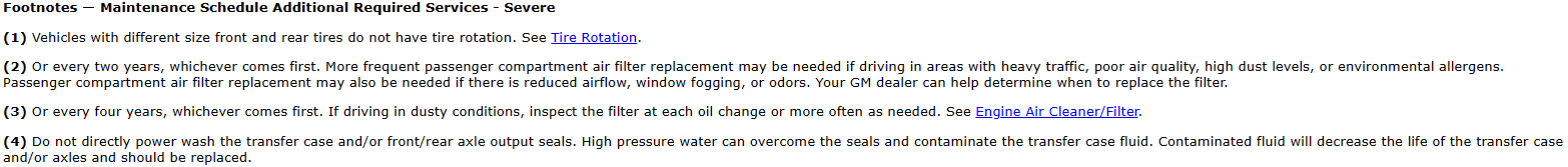

Both the normal and severe maintenance schedule show 45k for the limited slip differential. I show the severe below because that should be the shortest time period, but in this case they are the same. I don't know about any supplemental instructions for such things as racing use, but this should apply for typical normal use.

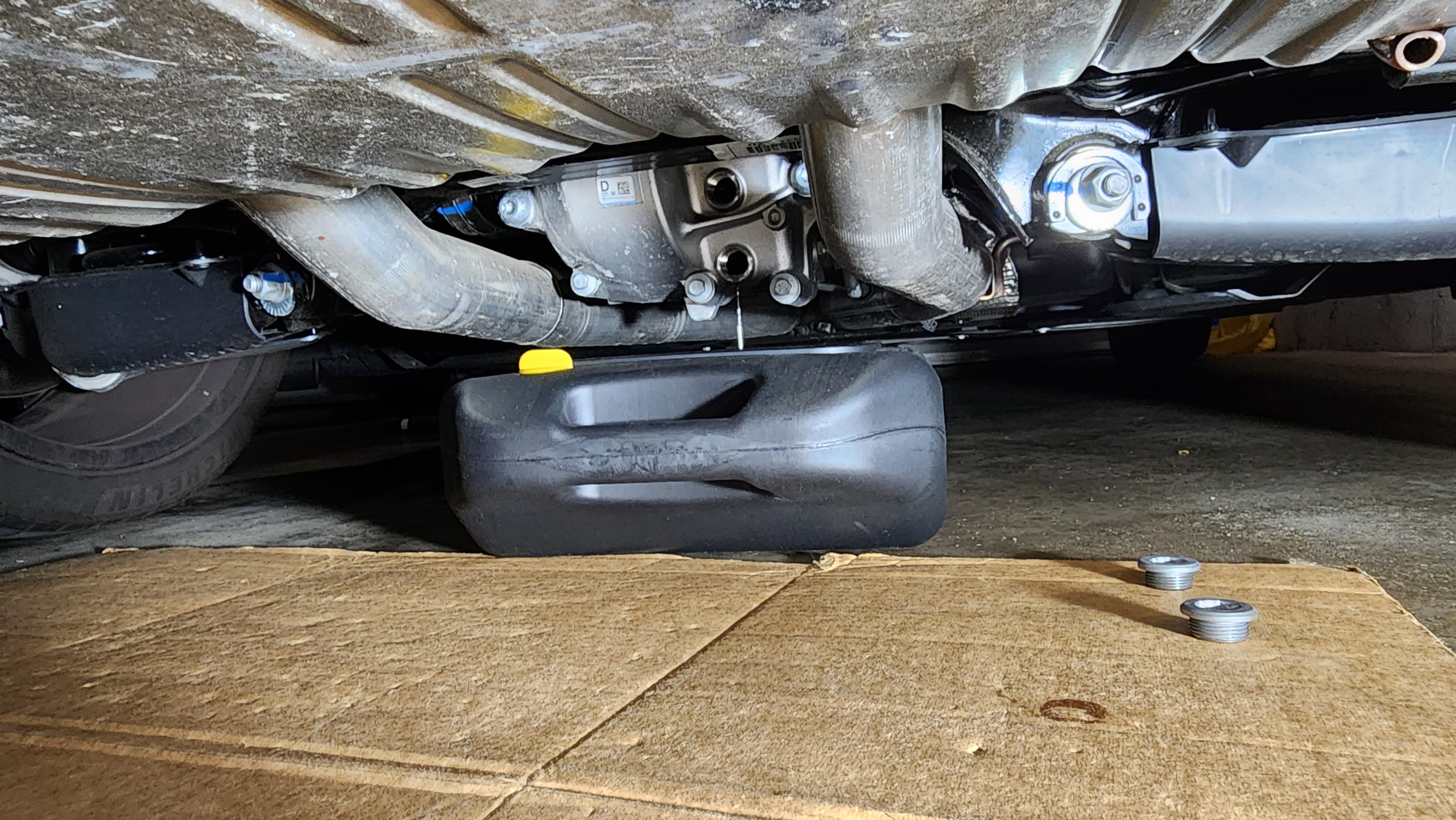

I changed my 4BW rear diff oil out tonight at just over 3k miles. I did it without jacking up the car (and I'm a big fat guy). Just needed to scoot under the back as far as i could go and stretch out my arm + use a 6in extension. Mine took about 1.5 quarts before it started dripping from the fill hole.

Changed out rear diff fluid with the AC delco product shown in here with the proper part number a few days ago. Easy peasy. Used about a bottle and a half - until it started weeping out of the fill hole then torqued everything down once it turned to a slow drip.

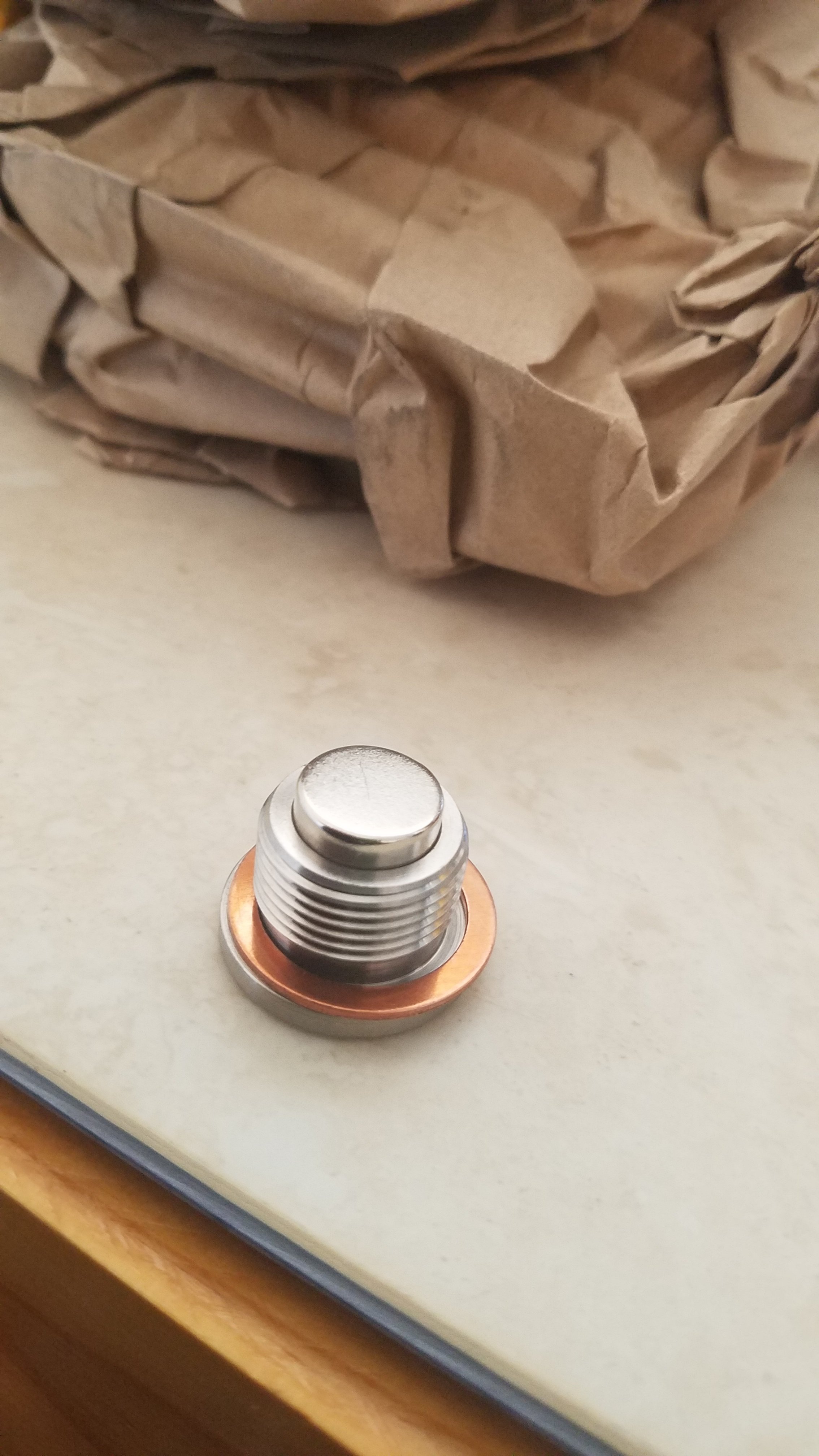

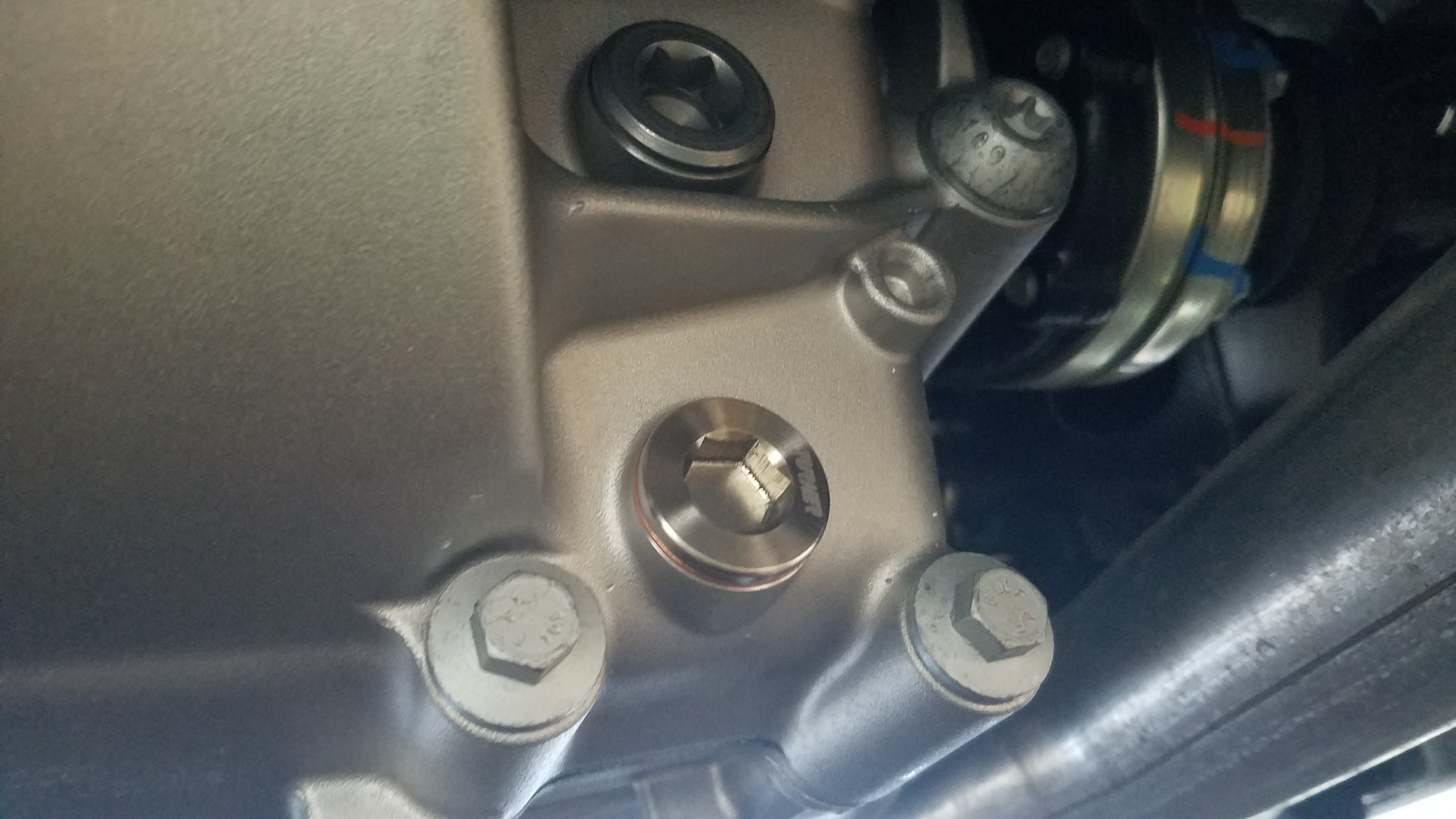

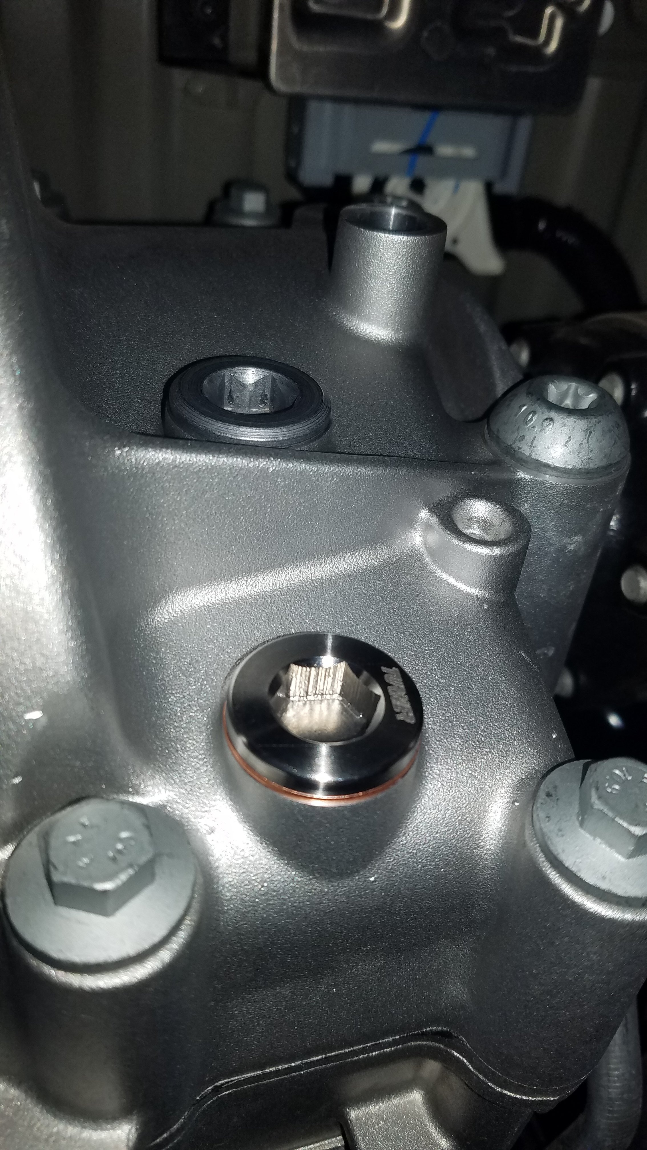

I commend your due diligence! I will now show you what I did!
Here is mine after the new plug installed. Absolutely, remove that crap fluid and install a proper plug people! Is there a factory magnet inside on the case? I would bet 100% there is but this guy goes 100% above and beyond 100%

What model number Turner plug is that? Is it this one?
I personally use a Gold Plug AP-04 on the LF4 drain port, which is great. On the TR-6060, I wasn't happy with what was available (nothing in stainless or titanium with a really strong magnet) so I wound up getting the Gold Plug IP04X, which protrudes from the side of the TR-6060. When my next batch of oil comes in I'll see whether it clears the trans tunnel.
I will have to look? I have magnets all over my vehicles and somebody awhile ago chimed in. All you do is just buy one on internet and use it what's the big deal? Hey, it's a big deal and actually a really big deal to somebody like me who cares about Break in processes on mechanical devices. The plug I used is modified along with heavy duty copper crush washer. Things just aren't good enough in my world.
Correct, I just cross referenced your plug to my invoice! That's the one!
