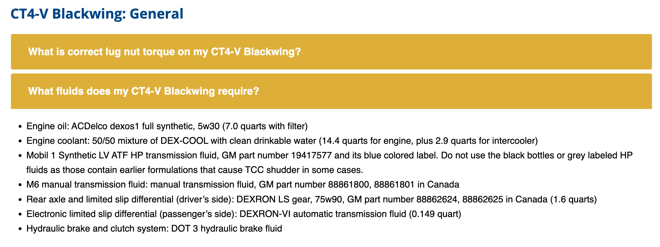

Thanks, that is what I thought but I saw this on the Tapout Tuning site and I was wondering if there was more to it on these cars since I saw drivers side and passenger side...
For the transmission, 88861800 points to standard 75w90 gear oil, but owners manual say it takes Dexron ATF?
