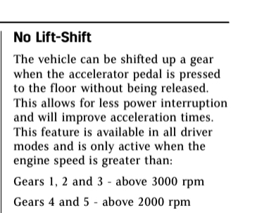

Manual states:
No Lift-Shift
The vehicle can be shifted up a gear when the accelerator pedal is pressed to the floor without being released. This allows for less power interruption and will improve acceleration times. This feature is available in all vehicle modes and is only active when the engine speed is greater than 5000 rpm

It only works 1) with rev match on 2) certain throttle percentage 3) above certain rpms. The parameters are in the manual.
Hm. Manual doesn’t state anything about rev match. And I’ve been doing it flat foot on the gas within specified rpm ranges. It’s not working (unless revs are supposed to jump like in my video, but I thought that not happening was the whole point)
