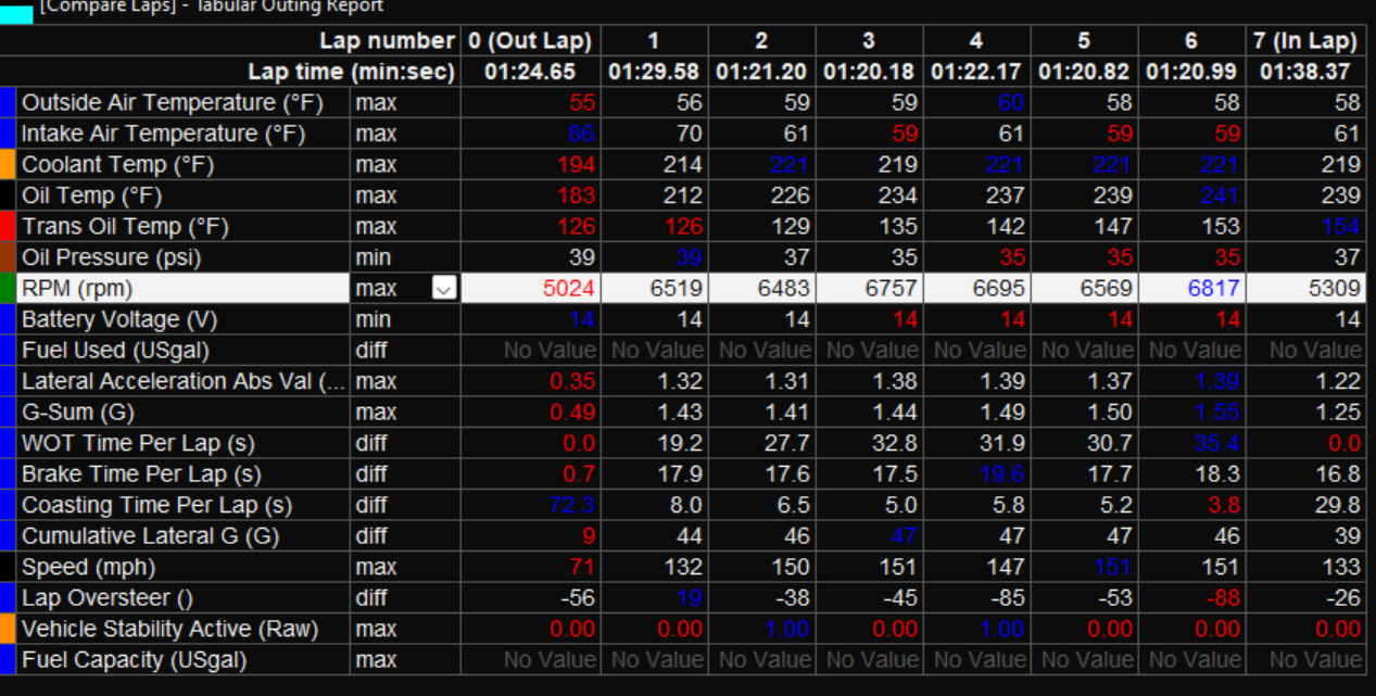

I believe that is normal. Once you push the clutch in the engine will continue to spin up, even though there is fuel or spark cut. It's just the momentum of the engine components once they are decoupled from the drivetrain. Even if you lift on a shift near redline it's pretty common to see the car hitting over 6800 RPMs in the data.
This is from my 5BW at the track and wasn't using NLS (or doing this by mechanical overrev on an early downshift).
I understand what you're saying, but look at my PDR video. The opposite happens- revs drop (slightly) during an NLS as opposed to Seth's video where they jump to redline.
