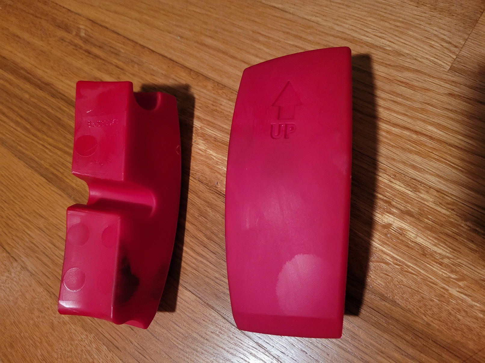

My dealer corrected it before I left the lot, so I can't speak from personal experience. Judging by what they look like, they wouldn't be difficult to remove at all. Take the load off the suspension and they should pop right off with no tool.
Mine came in the glove box. Yellow in ct4. Keep them in back if u need to get towed. You raise car with jack and pop em in one side at a time. You get 25mm or 1" lift.

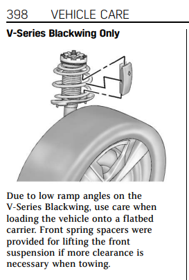

If you check the owner's manual, there's a section about using them when towing or trailering the vehicle. Specifically says that you should keep them and use them when loading and unloading the car from a trailer. It's on page 394 of the 4's manual, not sure about the 5.
