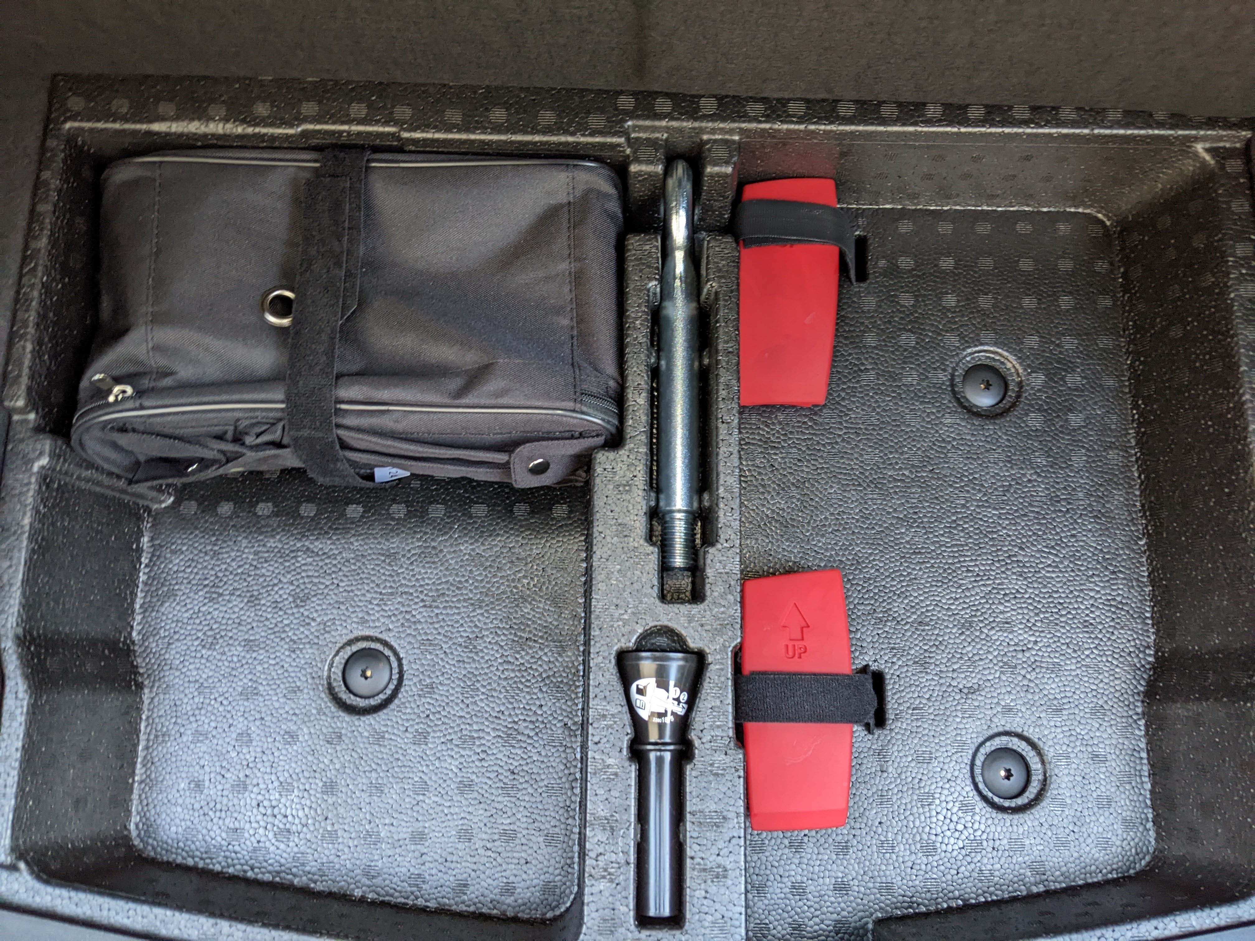

Here is what my dealer did with mine..

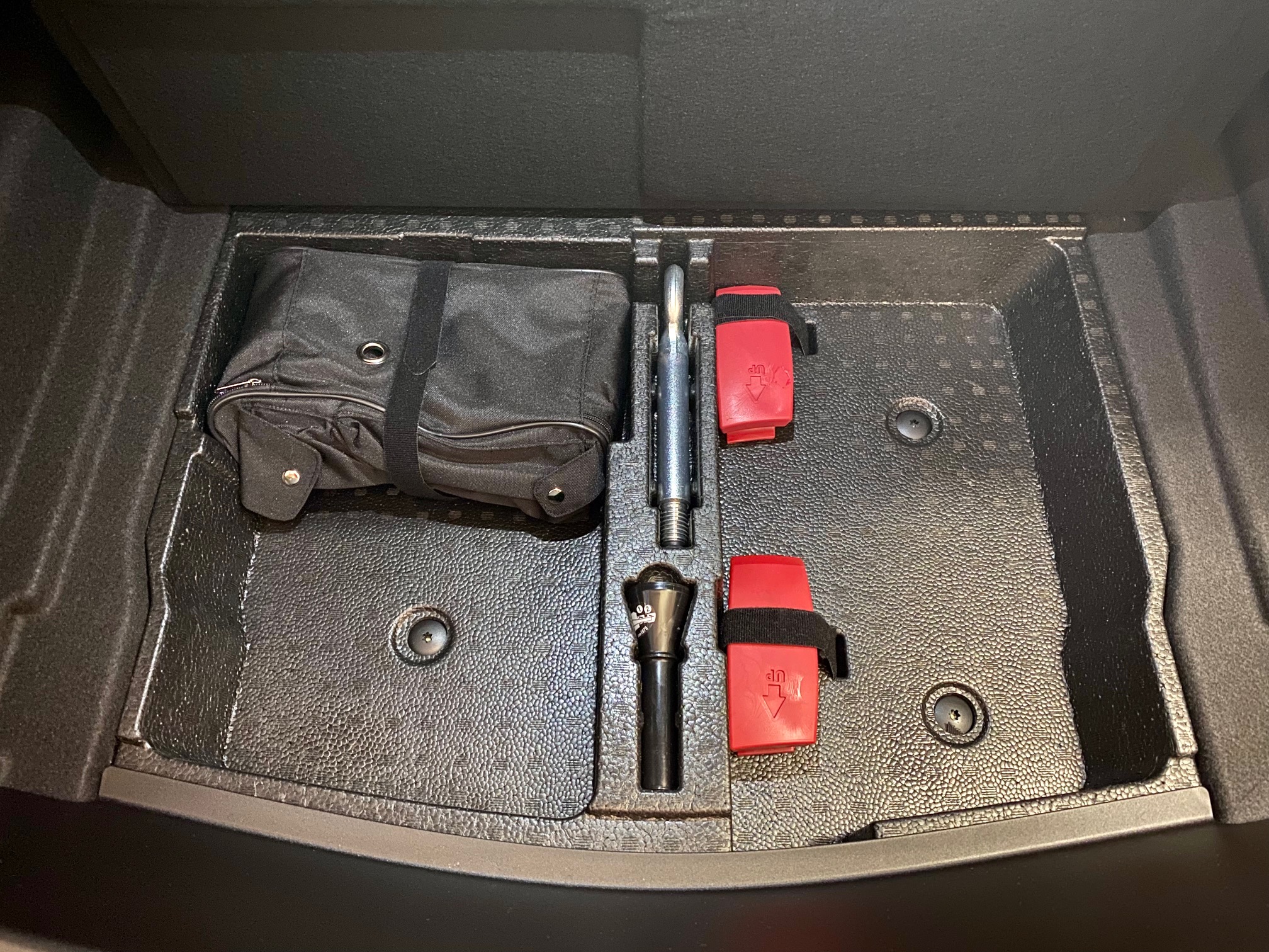

Yeah, pretty sure I got some bad karma for that joke because then this happened to me:
Been trying to get my discarded Spring Spacers replaced....
After much fuss, I believe I was given the wrong [Red] spacers.
From what I've seen:
Yellow [84929633] = CT4 (what other CT4 got)
Red [85539973] = CT5? (what my dealer replaced mine with)
For those who have CT5:
Is the Red Part# (above) what came with your car?
For those who have both Cars/Spacers [CT4 & CT5]:
Are the Red & Yellow Spacers different?

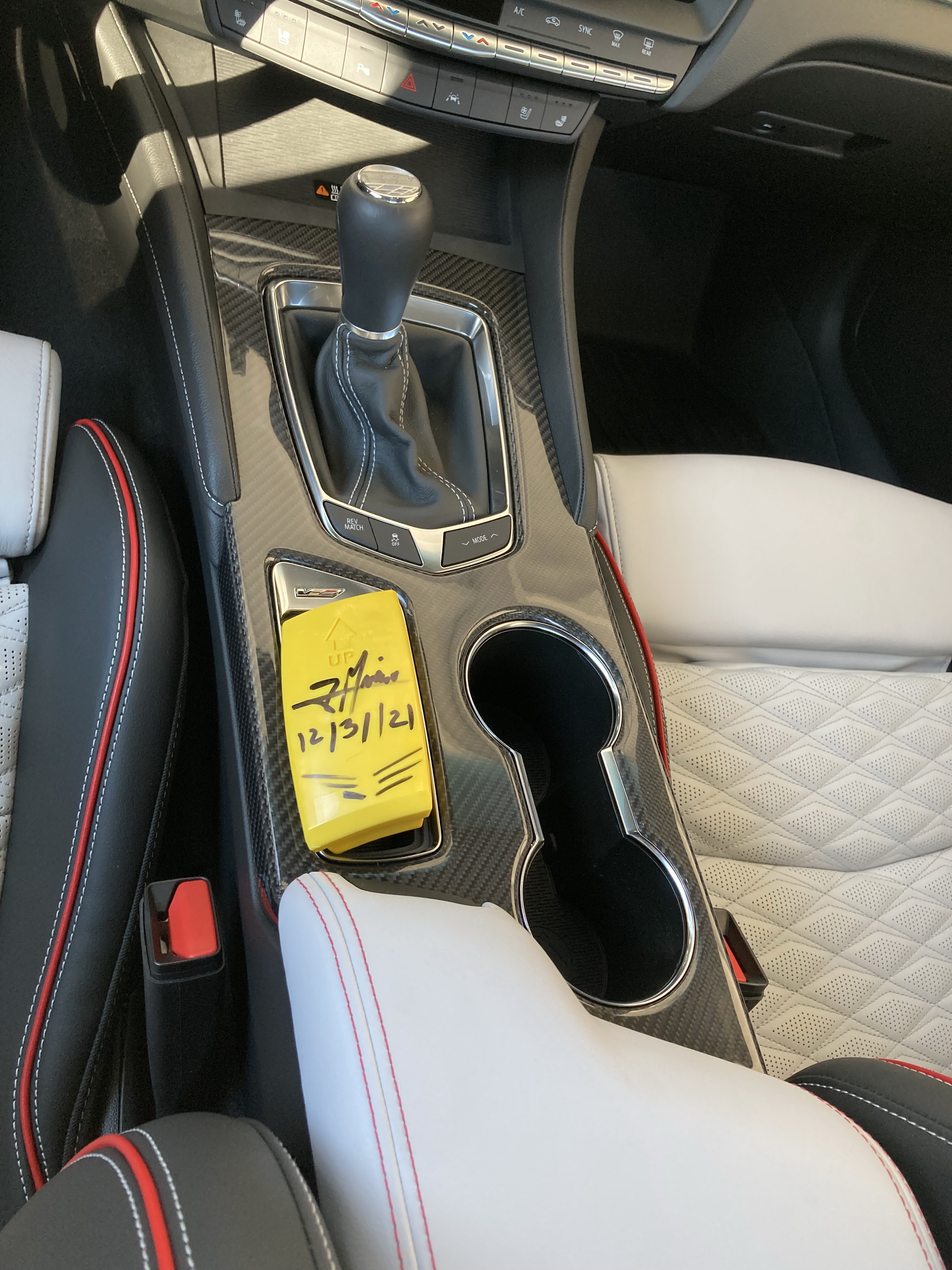

^ Wow Mirza, you're the coolest ever.
I'd have to keep one of those signed Spacers, on the Center Console, no way they could be buried in the trunk ; )
Please assure me you can get yours replaced, before parting with them.
I'll hit you up, on PM.
Thanks!

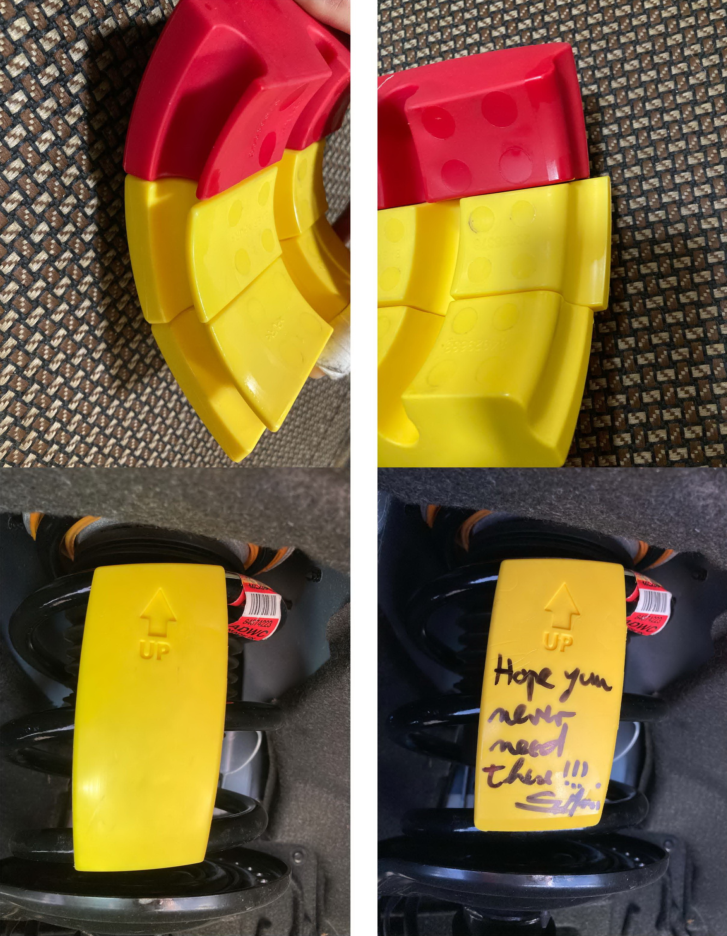

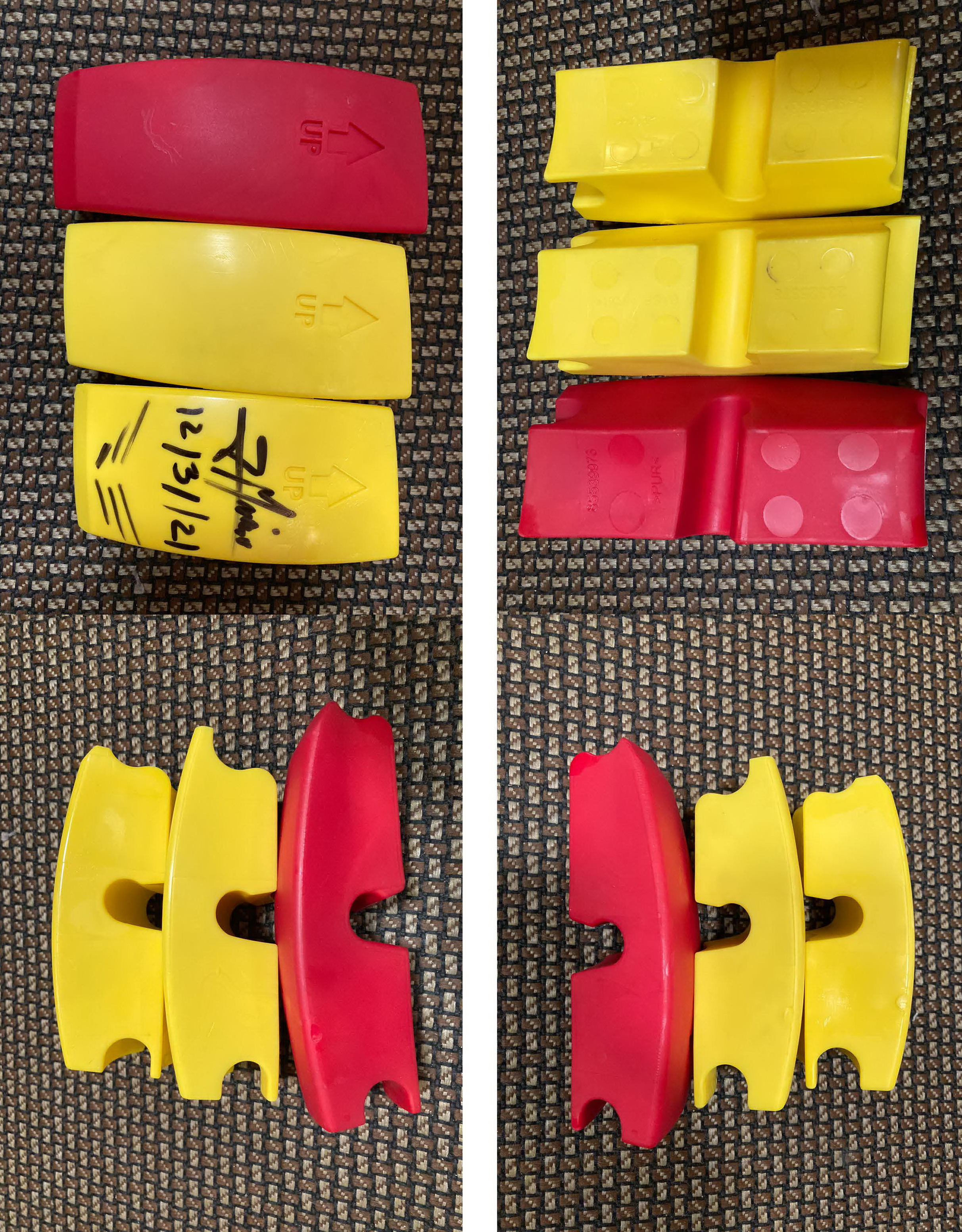

Got the spacers and now that I have a collection of all 3, thought I'd post pics for comparison.
(Pictures are arranged in order listed below)
CT5 [85539973] Red = Orderable
ATS [23325378] Yellow = Orderable
CT4 [84929633] Yellow = Non-Orderable (at this time)
Looks like Red Spacers won't fit a CT4 (so my dealers ordering effort was futile).
ATS Spacer has extra Wall Height, at the bottom, which might contact the Lower Spring Perch.
Also, the ATS Spacer has slightly shorter Wall Height on the top (but I see no issue with that).
I believe the Spring Spacers should be installed on the rear part of spring (not middle, as pictured) which would give a bit more clearance, to the spring perch.
ATS Spacers seem like a good interim solution, until the CT4 Spacers are orderable.
If anyone wants this set of ATS Spacers, LMK and I'll send to you.
Happy to return the favor, done for me (except for the cool signature from BW Royalty).
View attachment 6390View attachment 6391View attachment 6392View attachment 6393
Install is in middle so that you can access and pull with just a little bit of jack support. Finally some of those walls were shortened and changed for install efforts, imagine the guys at plant that hve to install a hundred or more of these a week, hence ATS one was a lot harder to install but more potential of coming out when you ship a car from here to middle east or california. Enjoy the spacers and tx for pointing out the ordering issue again!
