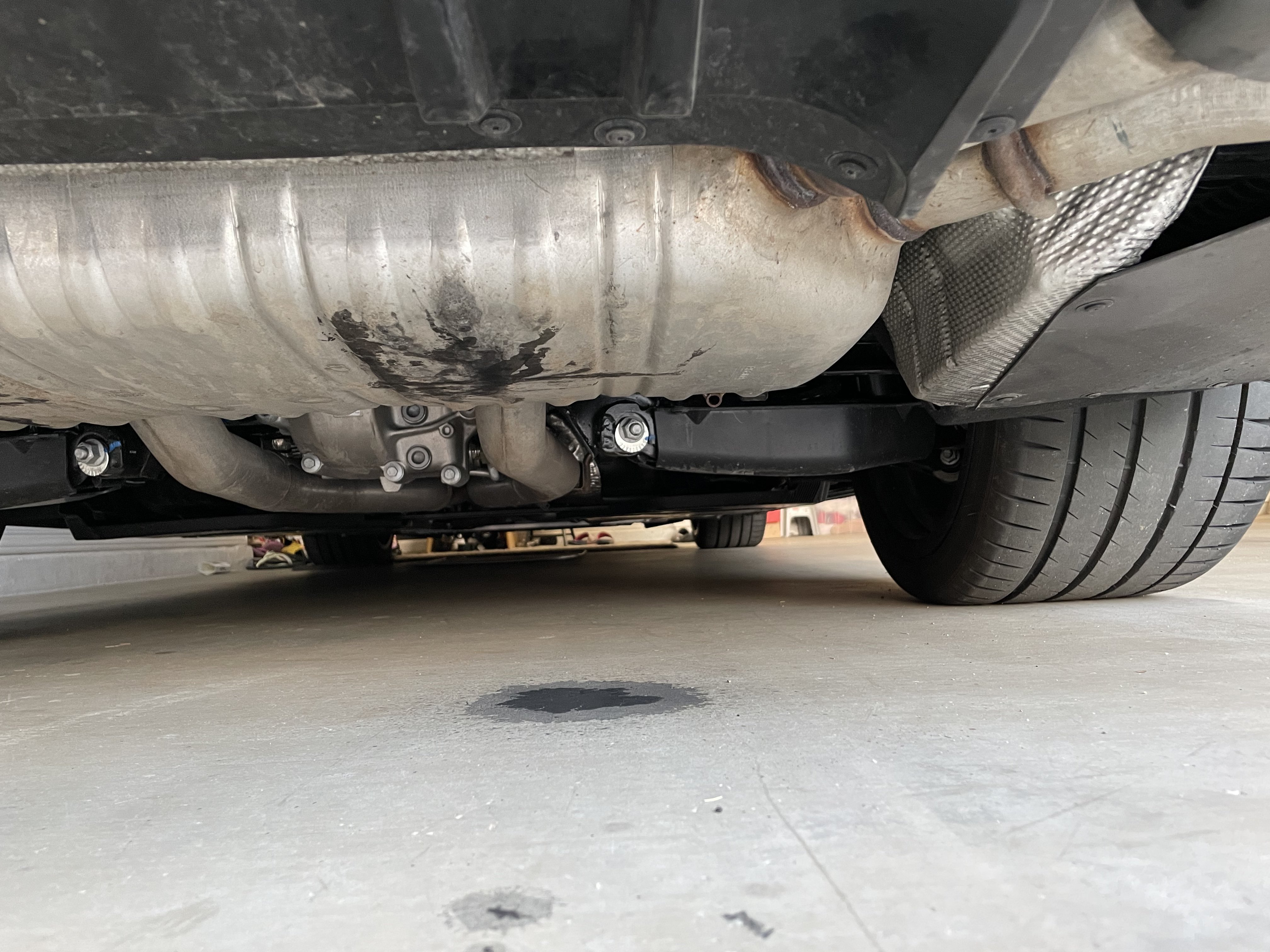

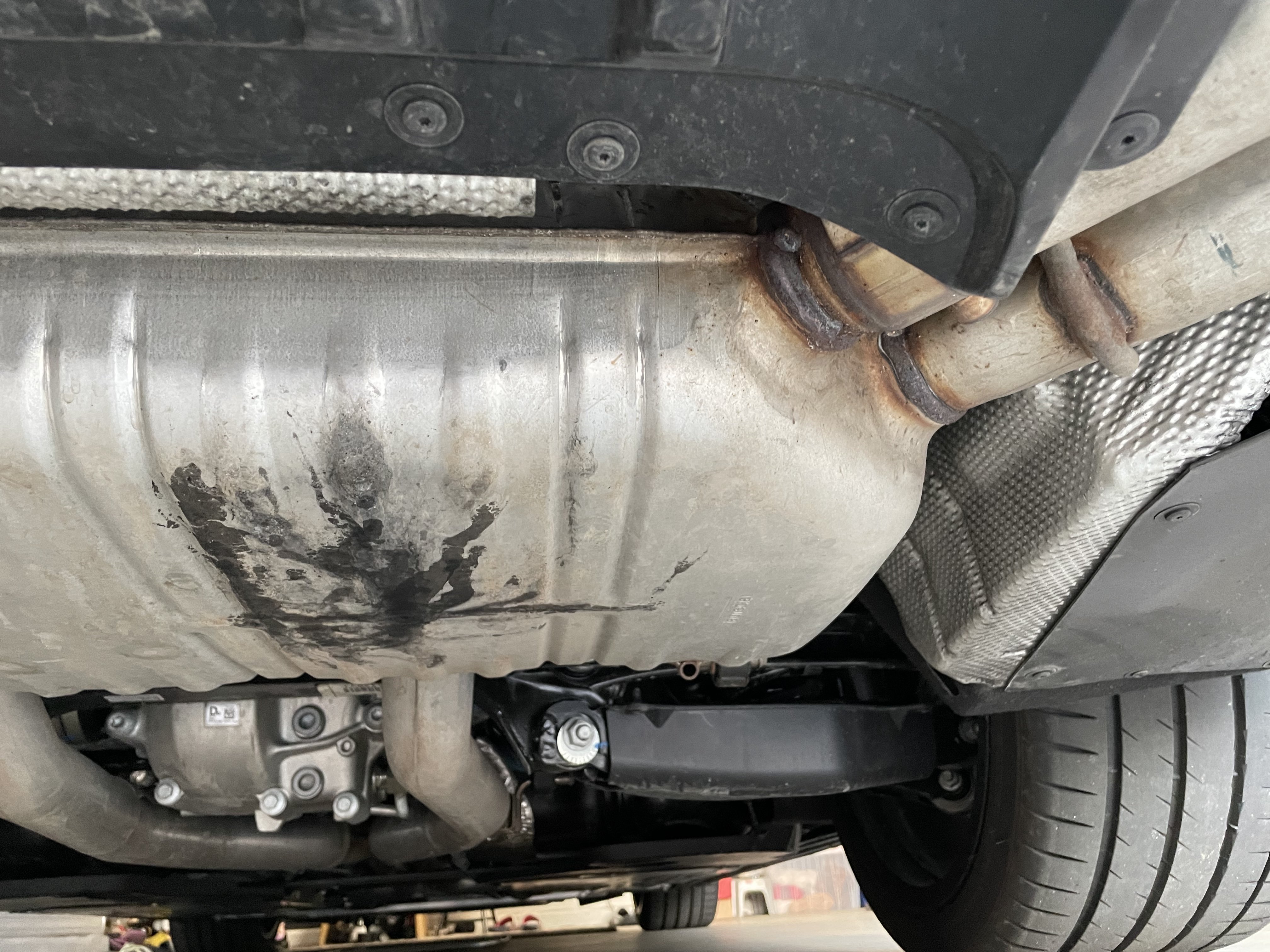

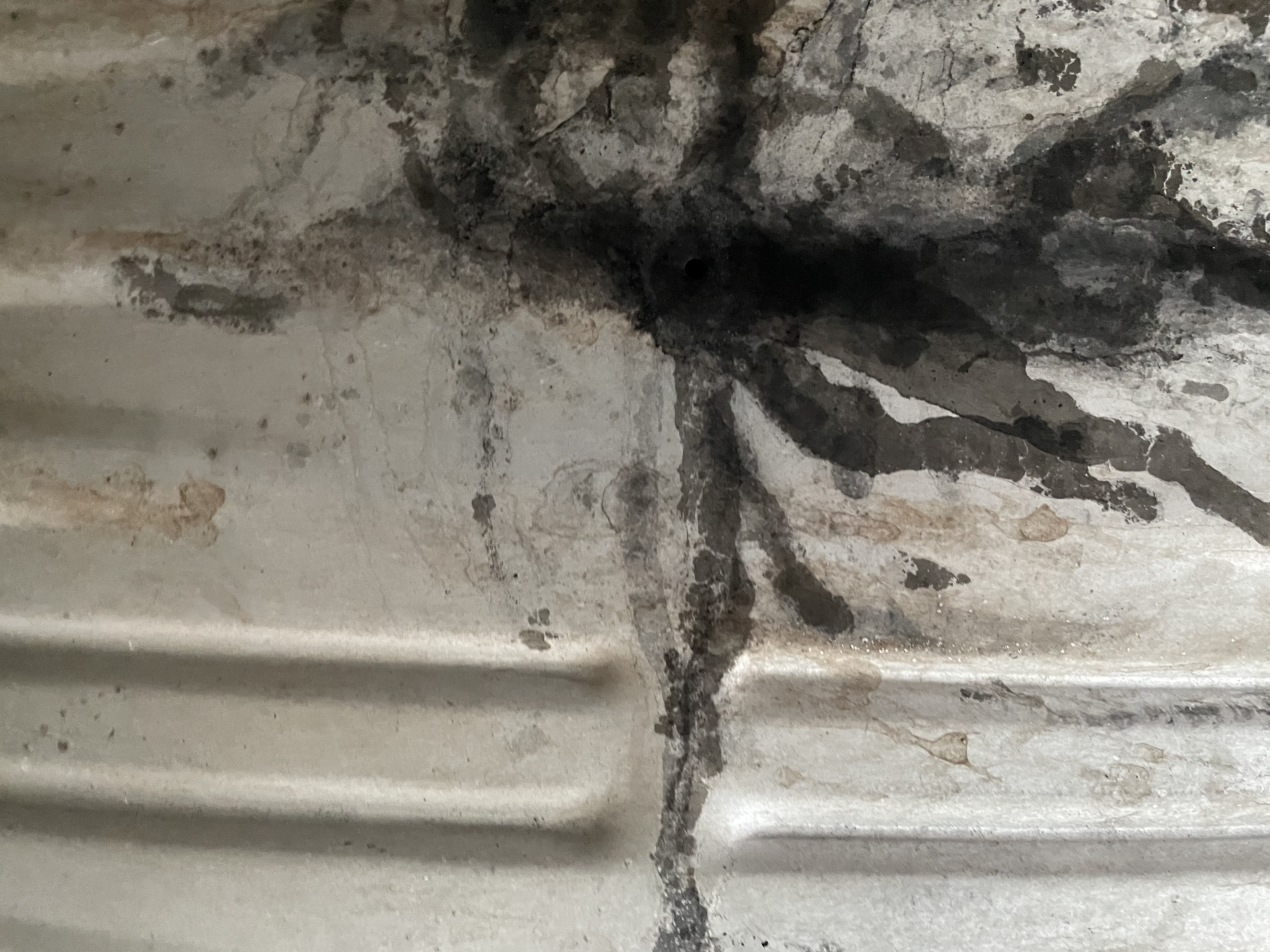

Hi all…
Have a 2023, took delivery Jan 2023.
2200 miles on it.
Anybody every had this before? I don’t recall hearing or hitting anything?

Mine has a single hole like that on each side of the muffler, but the black is in a straight line to the back, entirely on that raised ridge. Maybe you should drive faster? :chuckle
I know jack about mufflers but I assume it's there because otherwise the mufflers are accumulating moisture?
edit: The Tappet brothers say it's a weep hole.
Thank you soooooo much!!! I guess I didn’t use the right search words on google.
And you’re right, I might have to drive faster. 🤣
I can maybe see that happening if you are short-tripping a lot and the moisture is not burning off fast enough because of lack of heat in the muffler.
