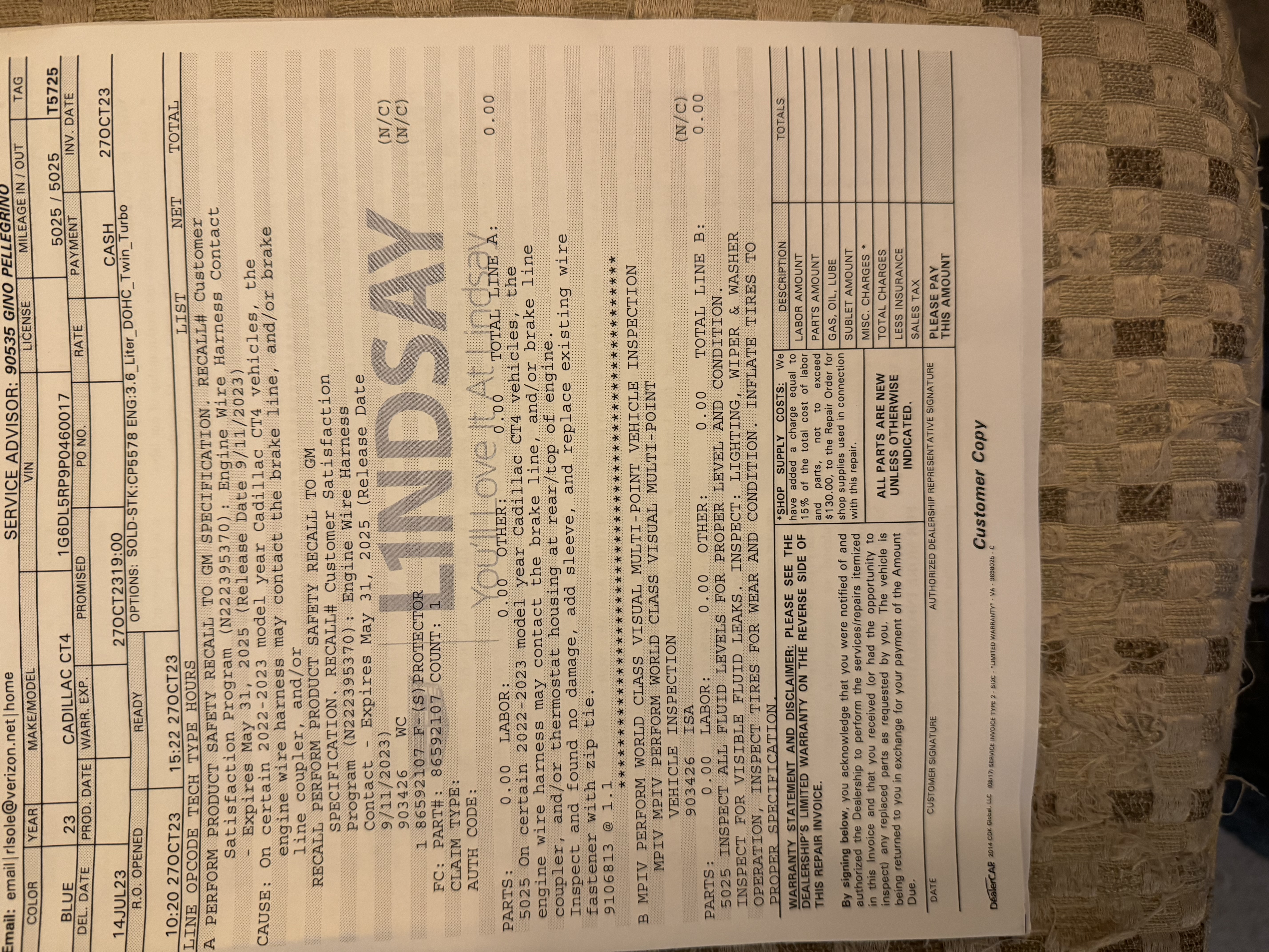

Looked at the procedure for the recall and that is the area of concern. Weird thing is they are not concerned with wiring rubbing through, rather they are concerned with the wiring rubbing through the brake line. No mention whatsoever of checking or repairing wiring, but if the brake line or fitting has a rub mark, replace it.
I don't believe this would be the problem. The recall is to prevent rubbing of the brake line which would result in total brake failure, rather than intermittent loss of power brakes. I could see a scenario where such rubbing causes the wires and the electrical system to throw a code causing the limp mode. Anyway, I got the letter too so I'll have them address the issue the next time I go in.

My parts came in and I get mine fixed this Friday at Lindsay Cadillac
