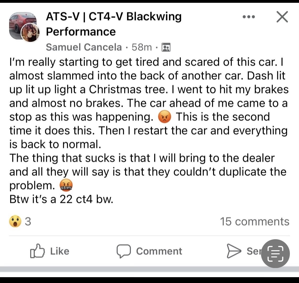

Here’s another guy from today. At this point, I’ll be likely reaching out to everyone and going the class-action legal route to force a recall before one of us is seriously injured.

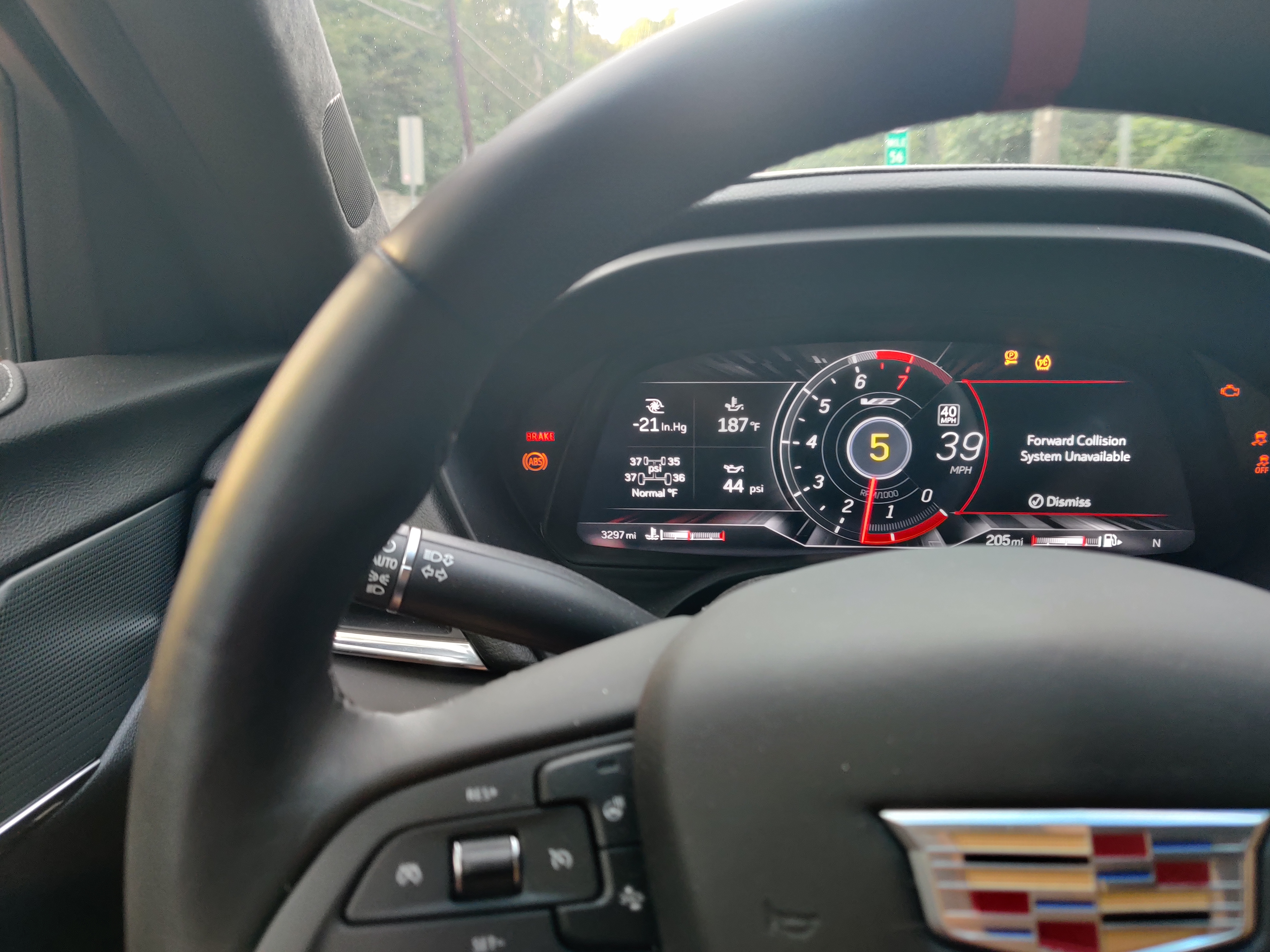

Happened again to me today. Strike two. I'm calling the dealership. This was less than 1000 miles after they "fixed it". I may mention the replacing the MAP sensor but I honestly don't feel like the techs want to see my face. The service manager didn't let me see them last time to discuss what the issue could be.
