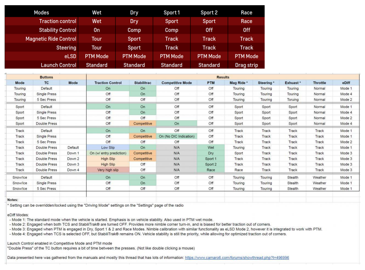

Do you have some level of PTM on? It's purpose is to allow some amount (depending on the setting) of wheel spin in the corners. The default setting without any PTM engaged has all the nannies ready to clamp down on any fun you might be getting up to.
I had a chart from Spring Mountain that shows the differences in stability control by PTM mode but I can't find it. Does anybody have a version they can post?

My interpretation of the many discussions here of what the various modes do (necessitated by the absurdly vague and contradictory descriptions in the manual) was that PTM progressively reduces and eventually eliminates ESC while retaining more of TC, whereas Tour - Sport - Competitive Driving do the opposite. I want to retain some ESC and don't care at all about TC, so the Tour - Sport - Competitive Driving series is what I use.
I don't think this is from SM and apologies to whoever came up with this for not giving cred, but I find this chart a huge help.
