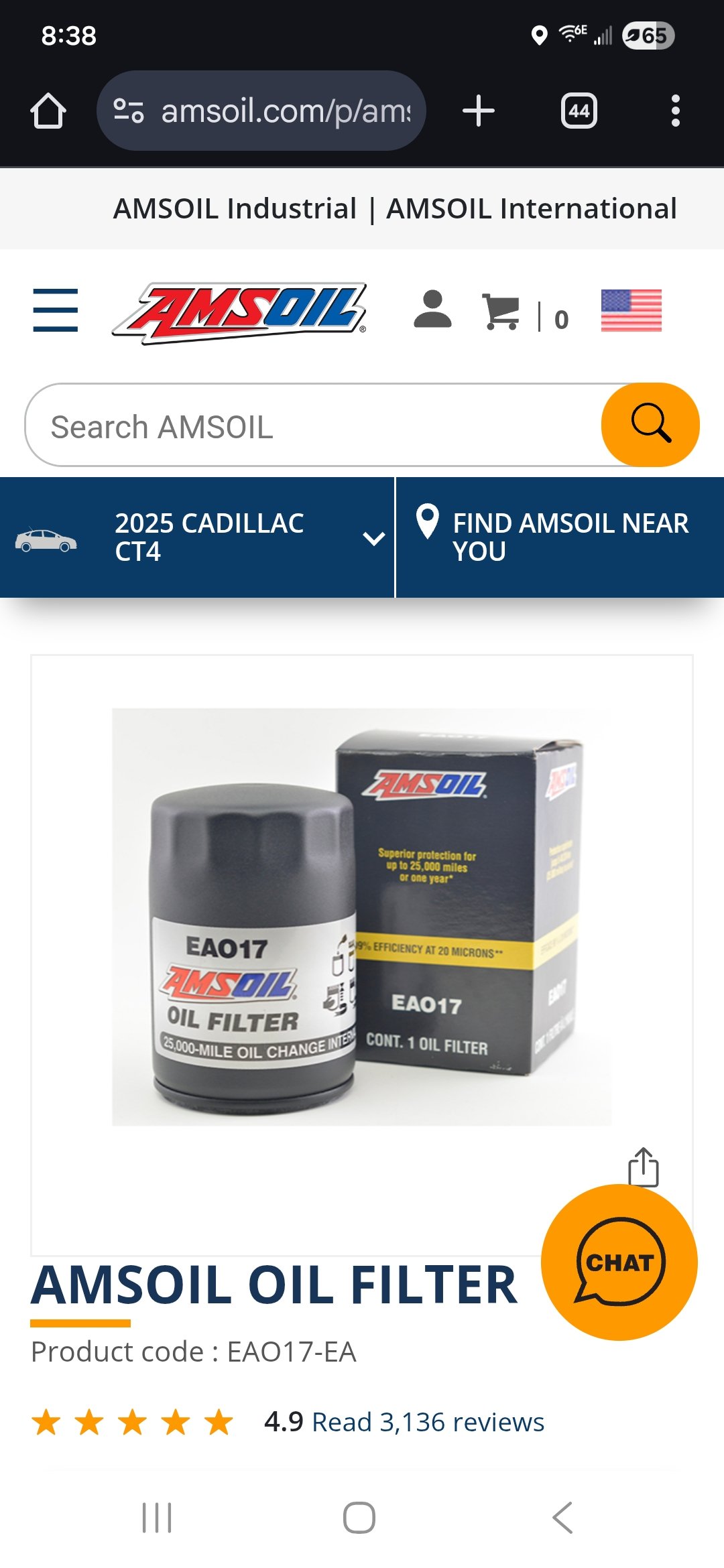

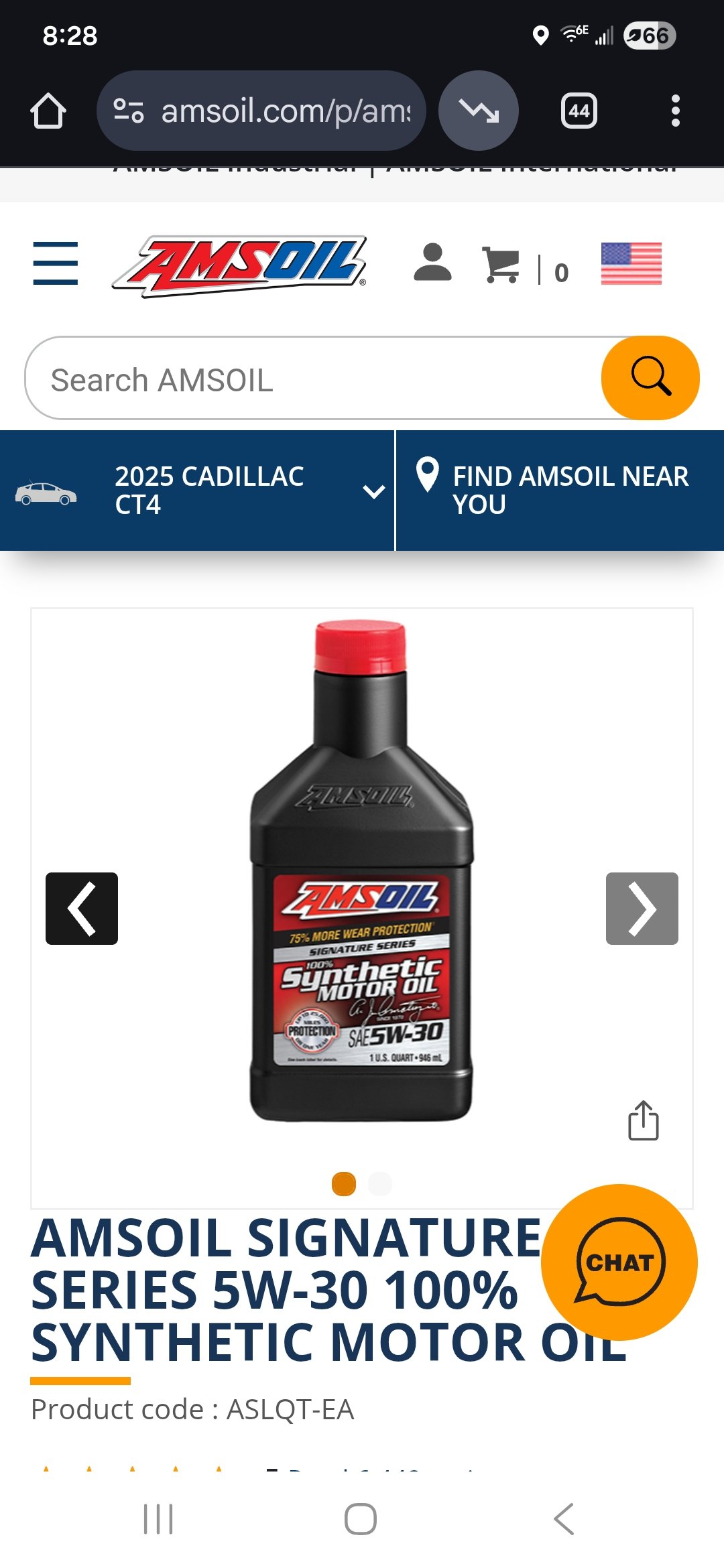

I'm considering switching to Amsoil Synthetic 5W30 as their website recommends for my 2025 CT4V BW along with their recommended oil filter. I've been having oil consumption issues and there are no leaks or smoke that I can see (Working with dealer on this). I had my oil changed with OEM recommended AC Delco 5W30 and after about 1500 miles, I lost about half of what was put in by the dealer. I did check that it was full prior to leaving the dealer. I do drive pretty aggressive with RPMs over 3000 quite a bit. My last oil consumption issue happened over a 3000 mile road trip in the mountains driving aggressively.
I live in SE Louisiana, so I don't drive in extreme cold.
